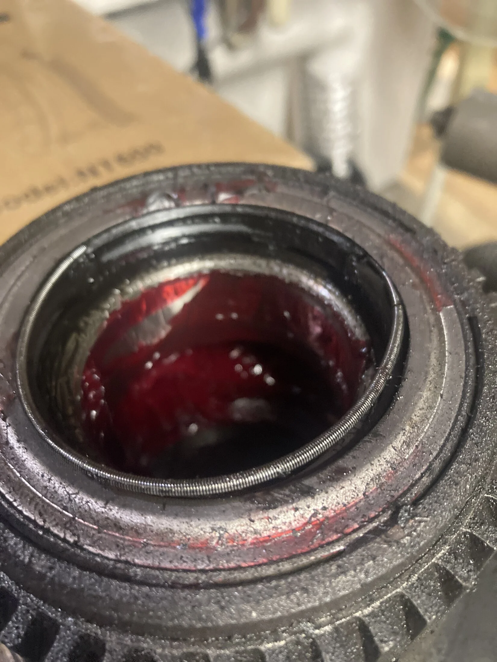

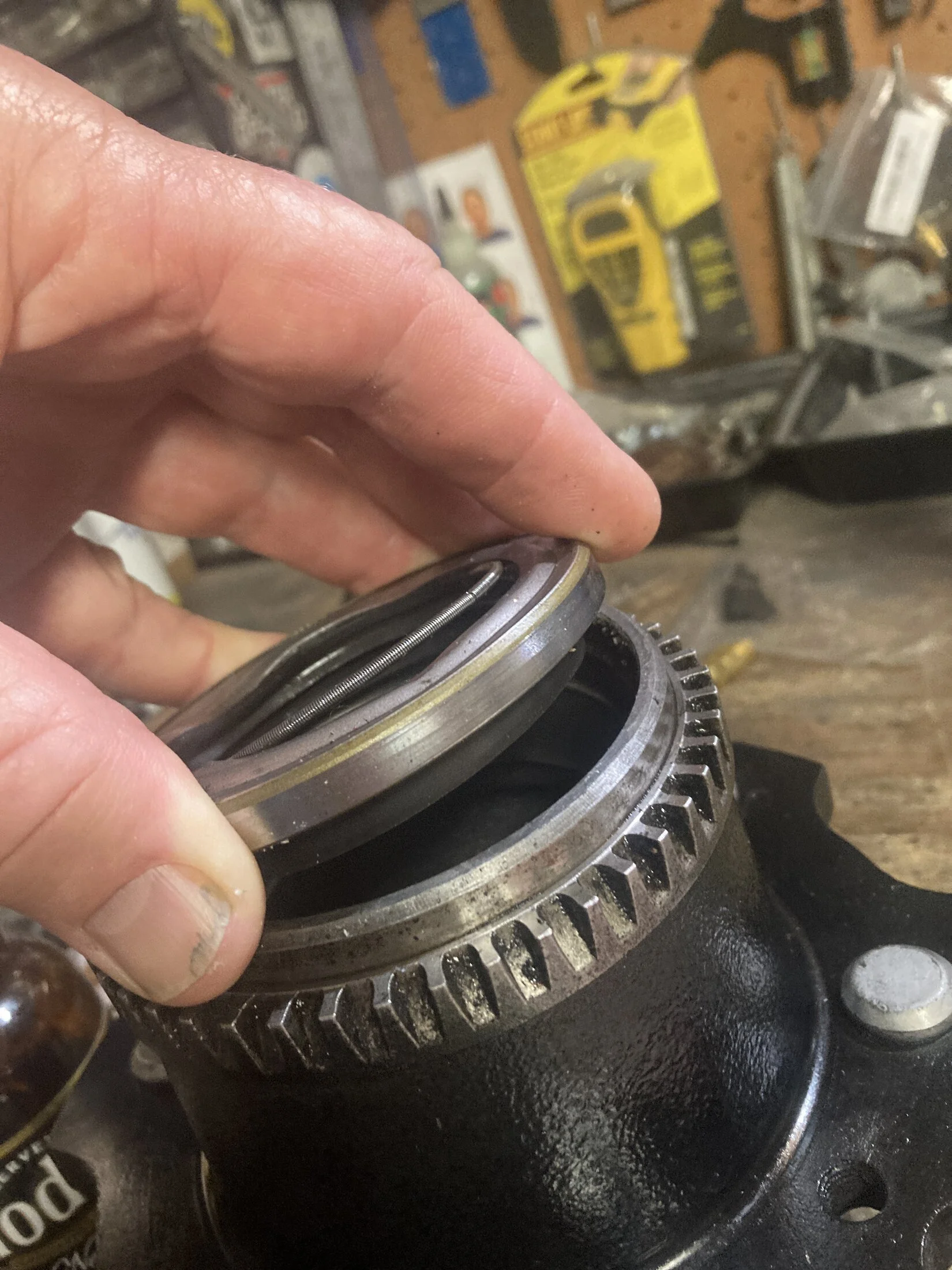

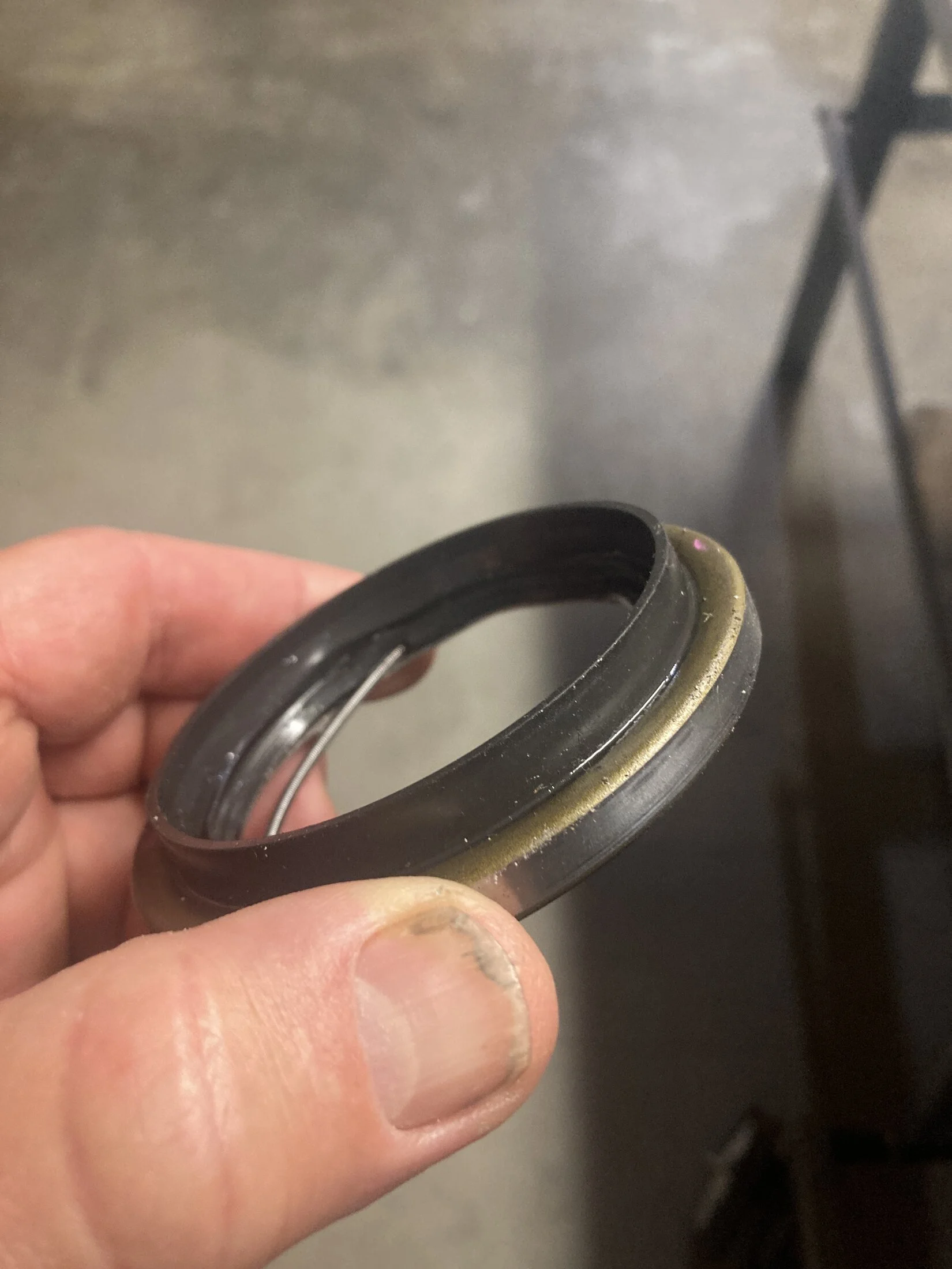

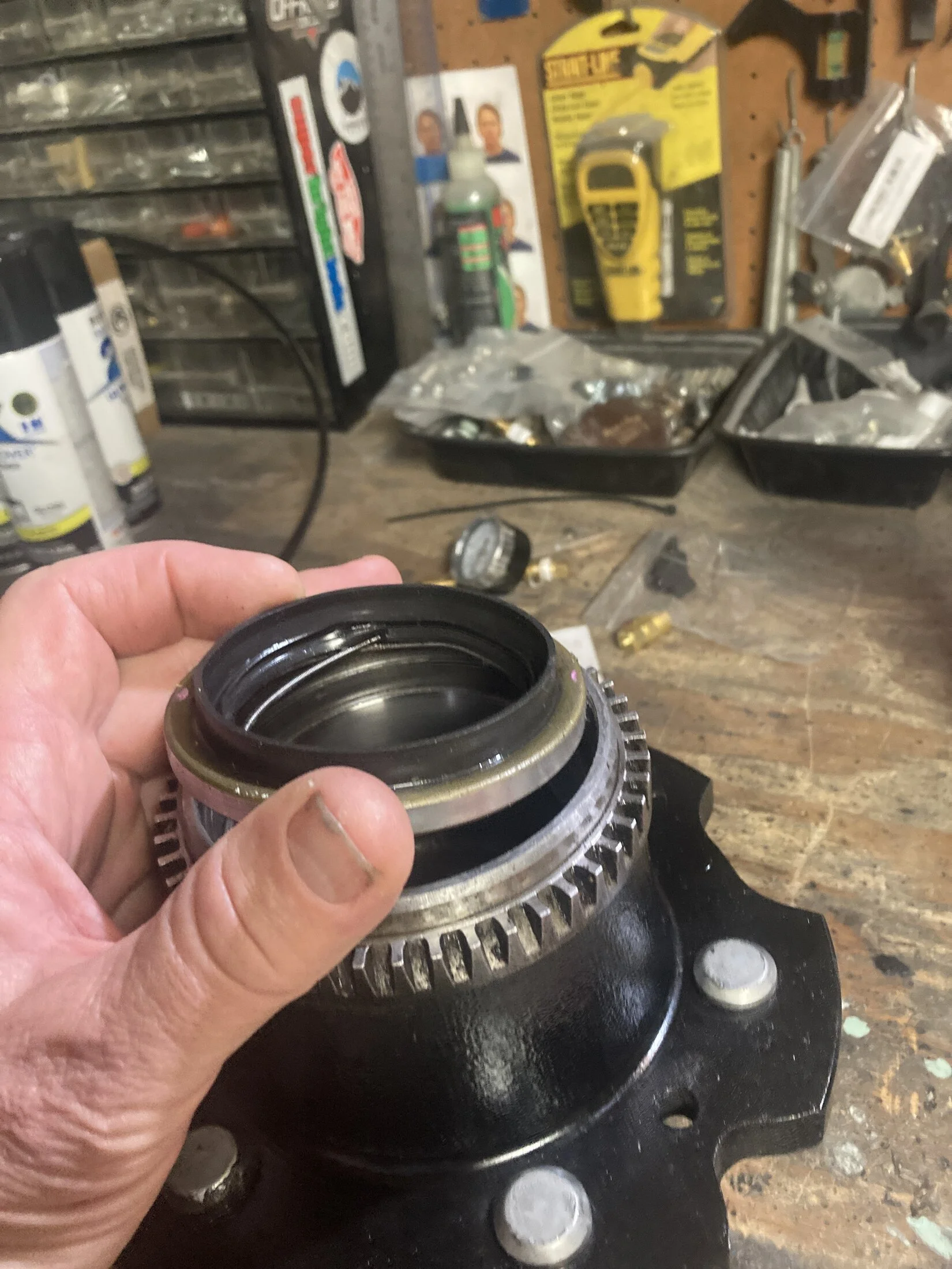

So spring a leak on my rear inner hub. Yucky yucky yucky clean up project, but why with no more than a 1000 miles did it poop!
I rebuilt these guys waaaaaaaaay back. Did the normal for me. Watched a couple youbtube videos to review and went to work. Now one is leaking! What gives?!
Did some reviewing with these guys.
When I pulled the hub off it was obviously marred. But why?
The video I had settled on showed putting these guys in like this.
Now I find out that they go in like this.
Pooey!
At least it is getting fixed now.
So do I pull off the non leaking side or wait till it leaks.
Pulled that bastard off and it was completely dry in side the drum, but the inside of the wheel hub looked like
A ticking greazi time bomb!
Glad I pulled it!
As simple as it sounds, you have to get the seal facing the right direction!!!
