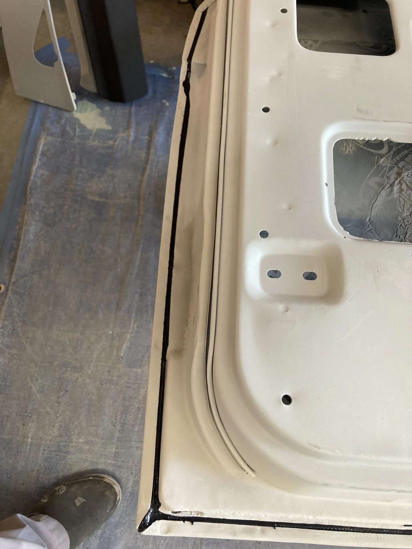

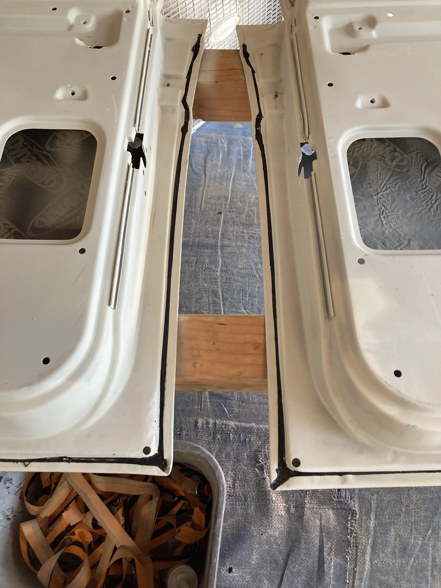

But if you seal the outside with a good seam sealer then coat the inside with an undercoating or good rust preventer made for interior panels you'll never get the rust line that will form along that edge.Probably not absolutely necessary,
Ibwould drag that drain hole further down in the corner. Almost Obround
Agree 100%.But if you seal the outside with a good seam sealer then coat the inside with an undercoating or good rust preventer made for interior panels you'll never get the rust line that will form along that edge.
