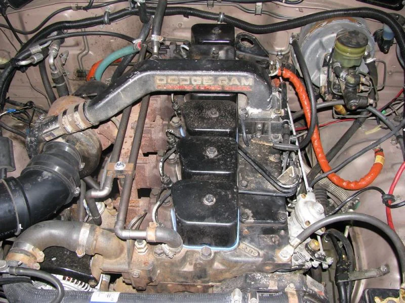

After 5 months of work on a doner FJ60 its running. Engine and drivetrain pulled out of our wrecked '85 and put back togeather in a '87. A couple of rattles left but running.

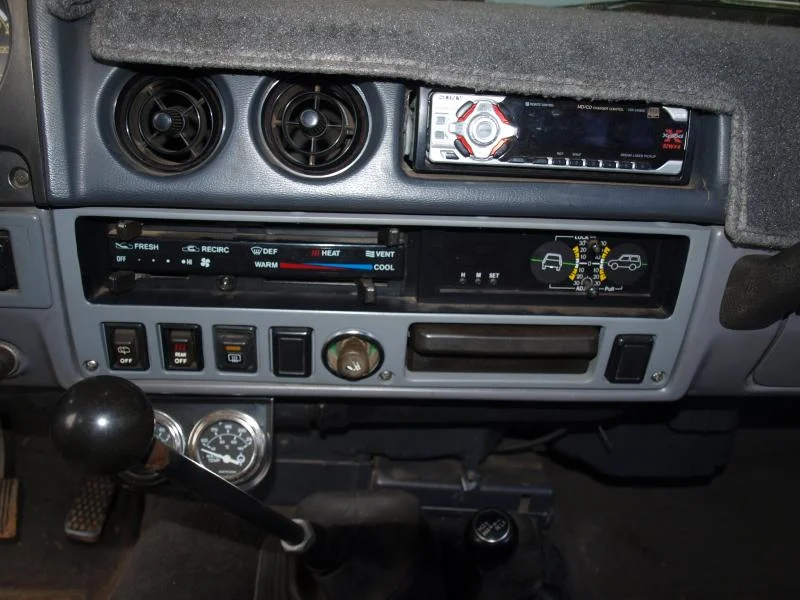

Any shots of how the NV4500 is mounted or what it took to get it bolted up to the chassis? Interior shot of how the shifter works out in the cab?

I've been driving the old one for 15 +/- years, I love it. So after the wreck I just had to build another. Initially I just had to take it to the Referee station and it passed becouse the engine came out of a newer Calif. smogged vehicle. Shifter comes out of the stock hole.

Judging by the first pic, I would say SOA is required, along with some bump stops. The diff looks like it's about an inch from the oil pan, and that passenger side tire doesn't look fully tucked yet.

The transfer case for the first 10 years was the stock FJ60, I did replace it a couple of years ago with a FJ62 tcase, it has larger parts, gears, shafts etc. Front and rear axle FJ60. The cruiser has to be sprung over for the oil pan to clear, the axle does not hit the oil pan becouse you have to put another leaf or two in the spring pack for the extra weight of the engine and that limits the articulation. This is our everyday driver and we take it off road as well, I have front and rear sway bars to smooth out the freeway curves on winding mountain roads. I don't take it on trails like Sledghammer, that's for the truggies. This one is built for the long trips and still capable of trails like the Rubicon. BTY I get 25 mpg.

Motor mount mods: 2000 dodge cummins engine mounts
Trans to T-Case adaptor: Advanced Adapters
Electronics mods: None
Fuel system mods: Drain the gas and fill with diesel
Cooling system mods: None stock FJ60 rad. move the botton port and add two Mercedes cooling fans.
