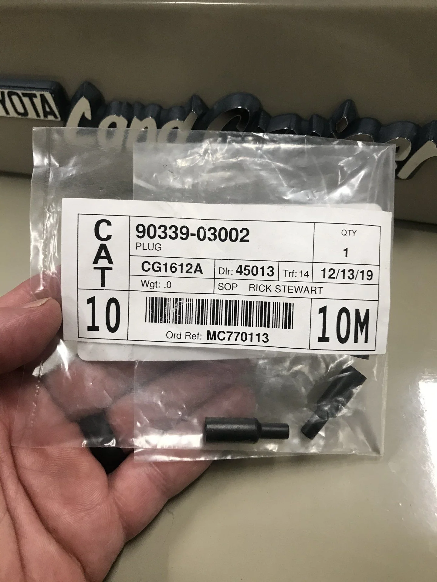

Going OEM is always good. If you need various sizes:

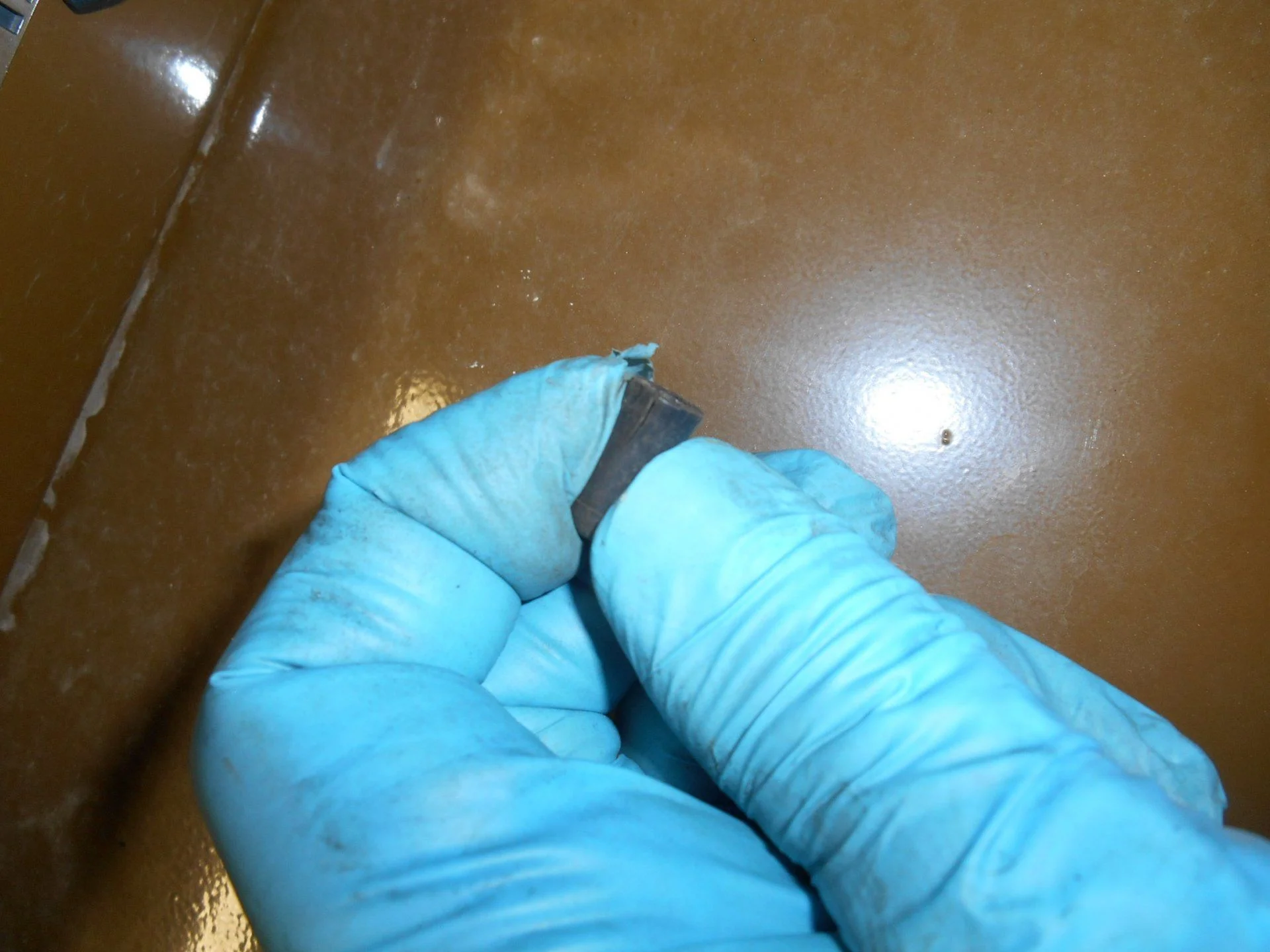

You can also use heat shrink tubing. Leave some stickout and shrink it down until it is just a narrow tail, then close that end with your fingers. It will seal to itself.
Thanks to you all - some good ideas there. I had no idea Toyota sold stuff like this.

Those part numbers for the OE caps are gold, I'm going to have to put some on my next order. They pretty much last for ever, I'm using some that have been gathered from various spare carbs and such and they are just solid. The variety with the little tit on them plug two lines on the manifold of my T100 (for the auto trans option) they are 20 some years old now and look brand new.
