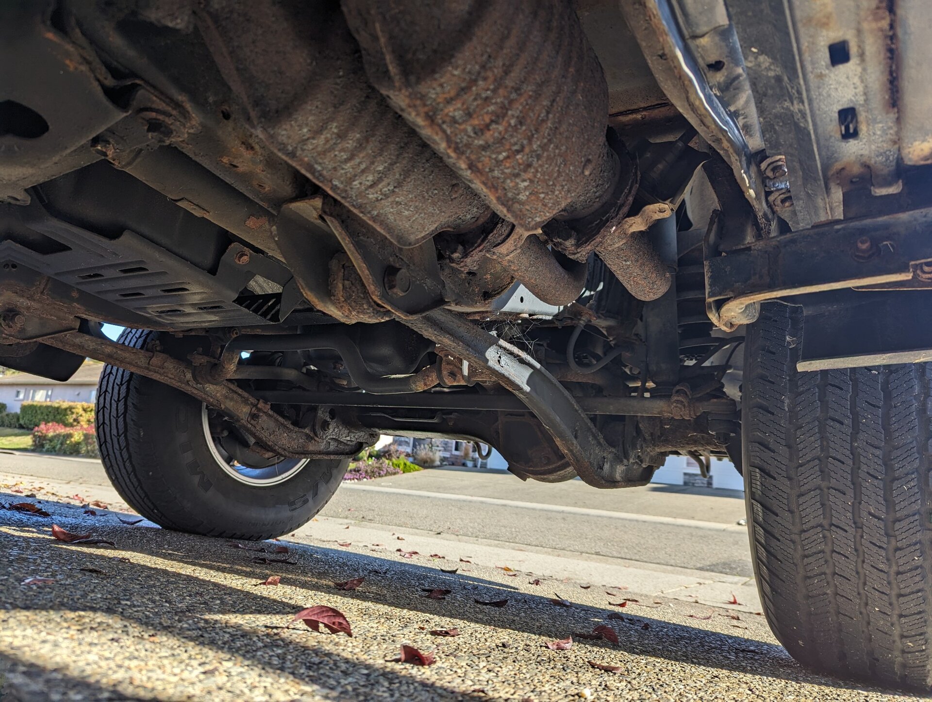

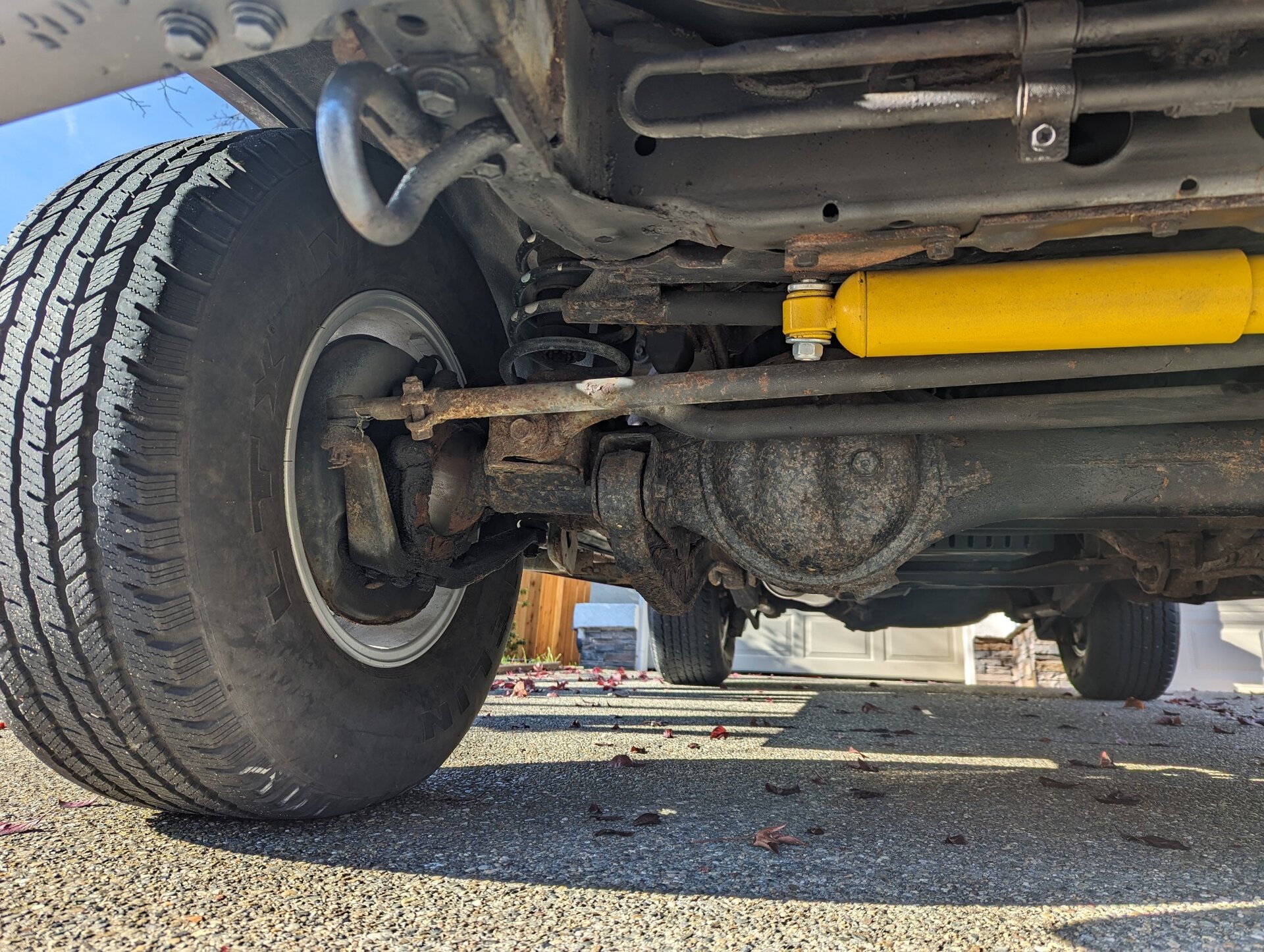

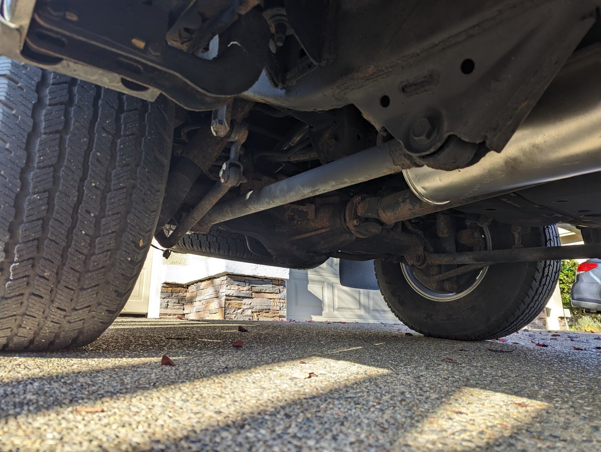

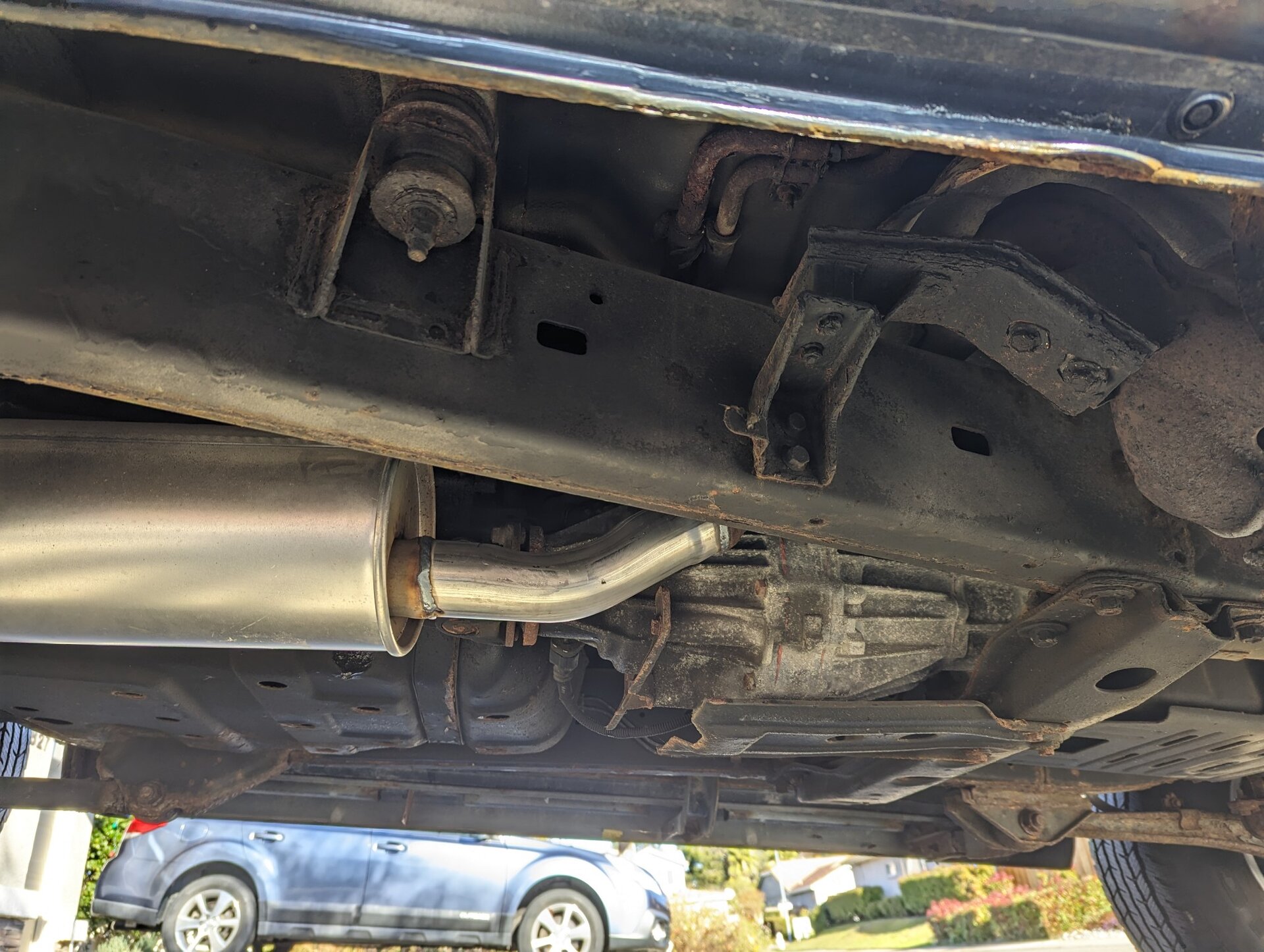

Looking to purchase a FZJ80 remotely for about 22k but mostly stock at 153k miles. After checking car fax looks like it was in Illinois for its life before coming to California. Just wanted to get your thoughts on how bad this rust looks in your opinion and what parts are the biggest issue. Most likely I will be putting a small lift on it but concerned about odd part replacements.

I think you can get better for less? Asking $22k for this is crazy. Take about $10k off, and that'll be the current market for LCs. The rust doesn't look "that bad".

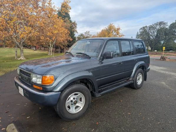

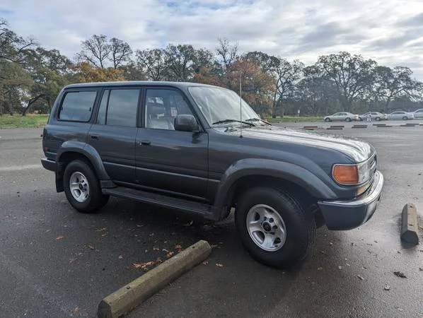

This is a 94 with triple lock and 153k miles. I will mostly buy for a trail and camping rig. Can't bring myself to buy a jeep.

I live in the Northeast where the roads are salted so I've lived with rust my whole life, and can tell you from painful experience that you will hate that rust when you go to do any work. I can feel bolt heads snapping when I look at that thing.
I bought my last one in Colorado. Do yourself a favor and start with as rust free an example as you can find that fits your budget.

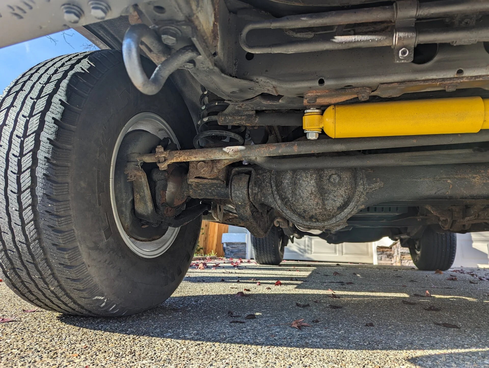

Seriously though, other than the rear heater pipes, that all looks superficial. Even the rear of the front control arms look bad, but if you cleaned them up and painted them, they will be good as new. The significant parts like the frame, control arm, and sway bars are still solid and minor parts like brackets can easily be cleaned up and re-painted (steering damper bracket) or replaced (front sway bar brackets, tie-rod clamps).

How's the body? Bottoms of doors, rockers in front of rear wheels, around windshield?
Ditto: too much rust but also multiple signs that it hasn't been taken care of and will need thousands (5-10k) of mechanical repairs and service, and I'm not talking about changing the fluids.

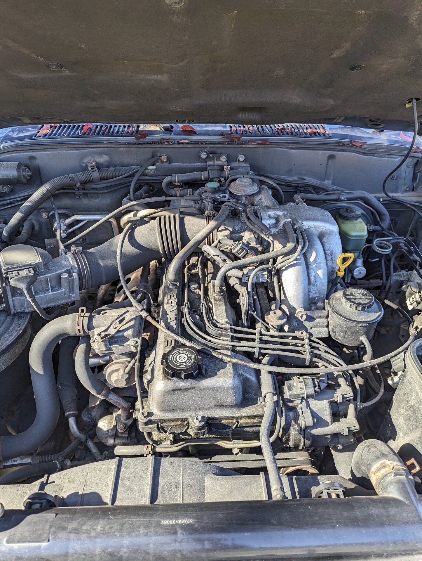

Just looking at the few photos tells you everything you need to know. The owner didn't take even one minute to clean off the engine bay (or the leaves).
The dry rusty axle swivel balls (at each end of the front axle where the steering knuckles attach) show that the owner didn't know and/or didn't care about getting them serviced. A complete front axle service will cost you bare minimum $1500, but that cost could double or triple if you have to replace hard parts.
And then besides the rust there are cob webs on the undercarriage, that shows that the vehicle has probably been sitting a long time, so the question is, why has it been sitting?? Has it been overheating?? Did they get a $5000 estimate to replace the head gasket, so they just parked it??
A big potential cost for all FZJ80's with the original head gasket is when the head gasket leaks (internally) ie: there generally will be no signs outwardly that it is leaking, then the engine overheats and then starts blowing coolant vapor out the tailpipe. Or maybe the owner has already dumped a bottle or three of head gasket sealer into the cooling system??
Cost to repair a head gasket along with a few other while-you're-in-there service/repairs: $5000 minimum to $10,000++ for someone to install a new/rebuilt engine.
Point is you have to be aware of current or past head gasket issues.
Looks like it has locking differentials so that could be seen as a positive
assuming they work.
If you look closely in one photo of the undercarriage near the Cats you can see the bottom of the right rocker panel which shows signifcant rust along the bottom edge with rust "bubbles" (rust holes under the paint).
Bottomline: Even a "good" 80 series without any rust and that's been taken care of most of it's life often needs a few thousand dollars of catch up service and repairs. The seller of this one likely looked on Fleabay and came up with the asking price. IMO you're looking at maybe a $1500-2500 that's without seeing most of the body.

One of the first places to rust is under the rear hatch dust deflector mounts (if it has the deflector, most in the US do). Then check the rocker panels down low (partially hidden by the running boards), the bottom inside of the doors, the rear wheel wells closely, the inner aspect of the front (nose) of the hood, ---. Anywhere on the body that has a ribbon of seam sealer (ie: where skin panels are sealed) tends to show rust first in vehicles from the rust belt, IME.

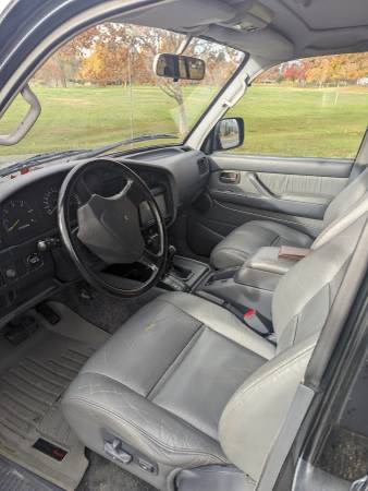

To add. Time "wears" stuff out in different ways than mileage. In fact, seals, Bushings, etc. Rot with time and heat cycles. The seats look great for the age, but yeah, rust - oh my, what you don't see can get scary/expensive.:bang:
