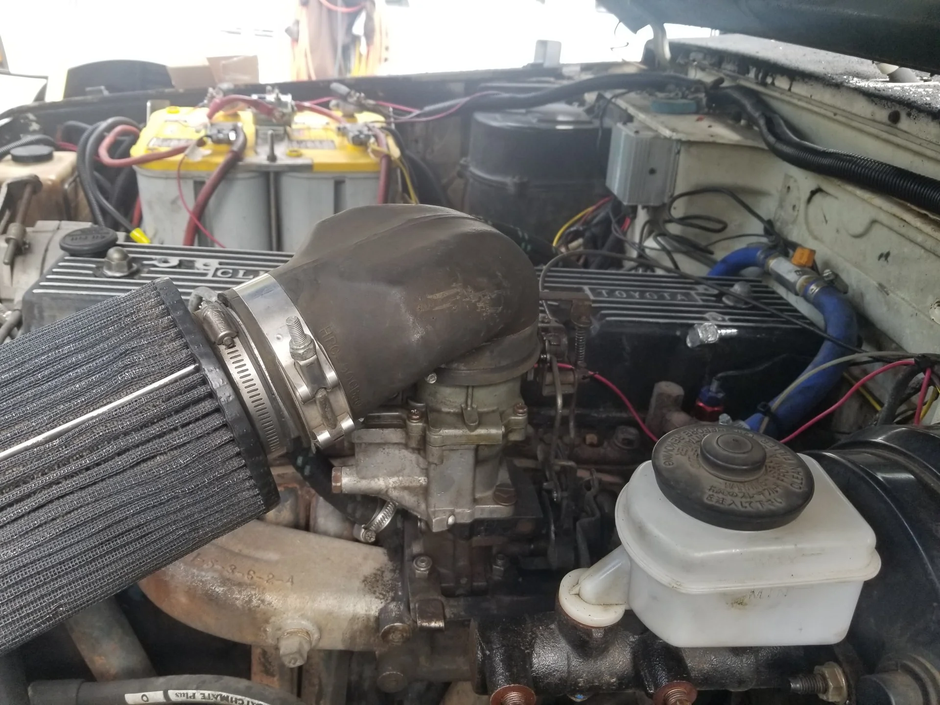

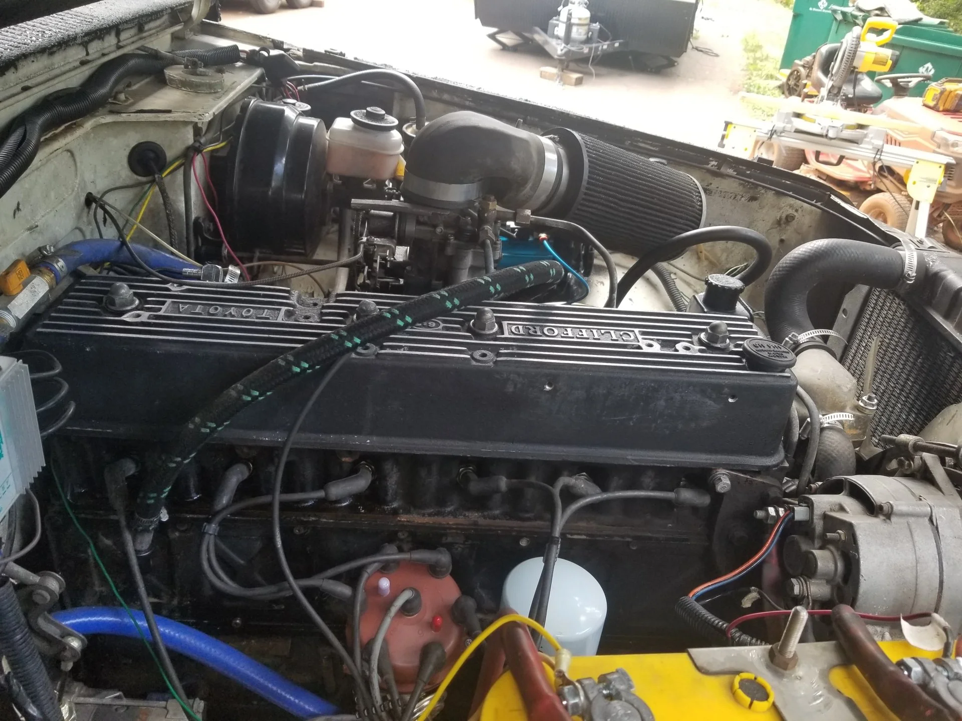

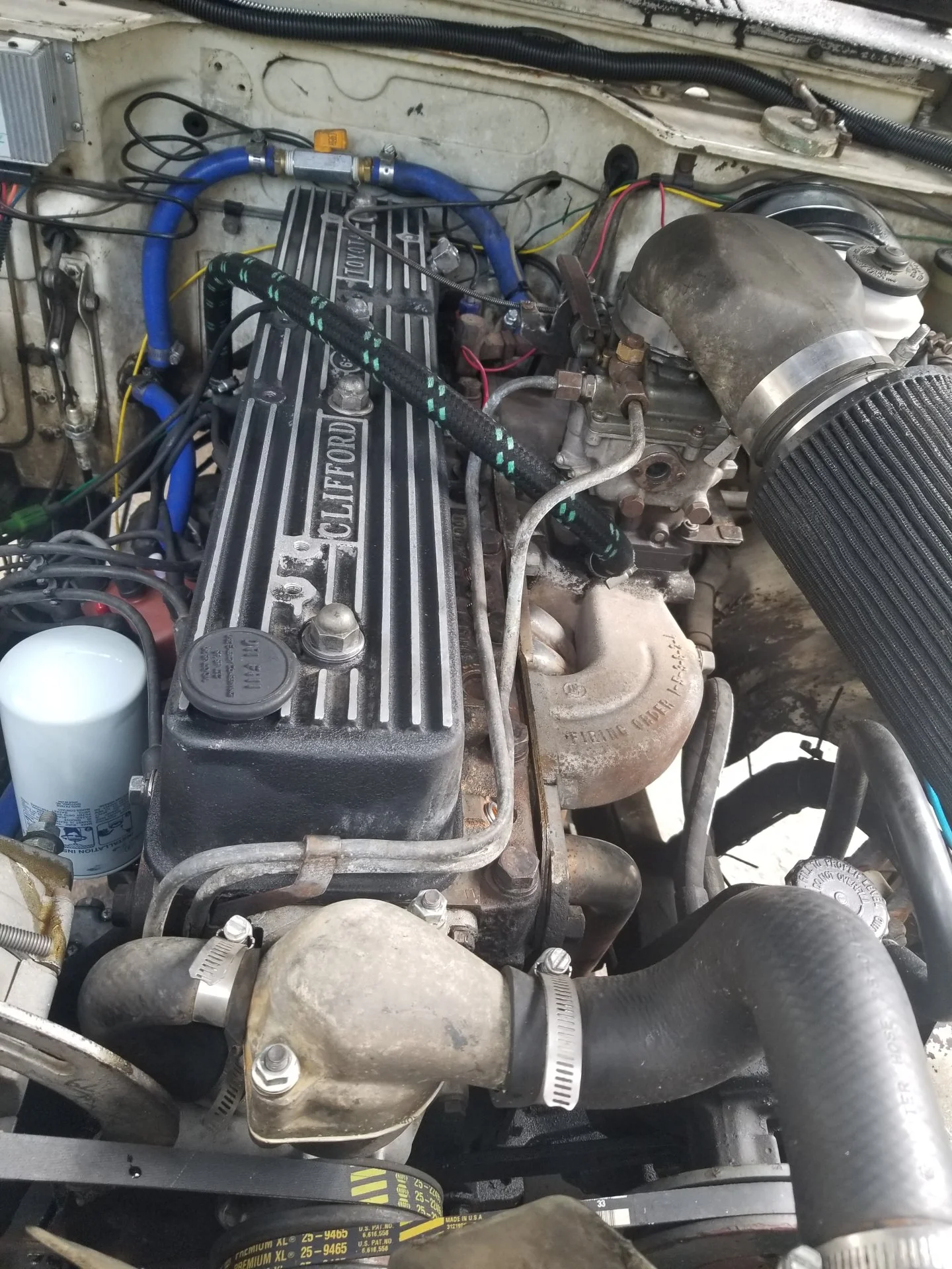

Desmogged my (non-CA) '76 and installed a Sniper - everything is reversible if one ever wanted to go back to full-stock for either legal or restoration purposes, provided you bag and tag things and box all the bits up.
I do like my Sniper setup, but whether you'd see gains from desmogging that are worth the time, that depends on your rig.

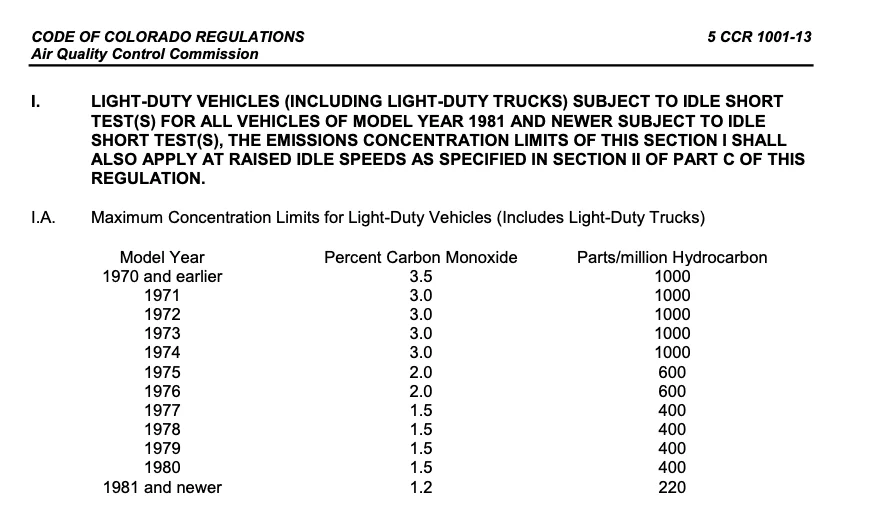

I also wonder on the Sniper vs original, but we don't have checks here so I have no clue what the rig does now with the ECU controlled fuel and spark. I still had the factory-new results though from pre-delivery checks - that would at least tell what an OEM setup did in "as new" condition for an early '76 (9/75). I can't tell what the actual value is for CO - 14% seems high, but who knows. Found the specs for Colorado's testing, and they'd look for 2% and under 600...maybe it's .4%? 🤔
