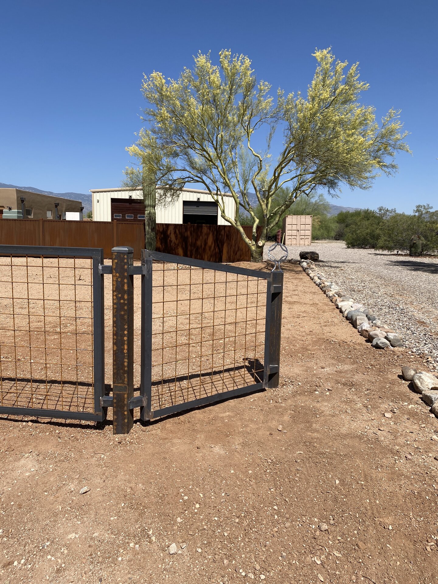

Finishing touches on the decorative fence.
I wanted to top the end wings with a unique crown. I had seen this cross many years ago at a church built in the early 1900’s. The campus was adorned with wrought iron forged creations. This design caught my eye back in 89 when I first saw it.

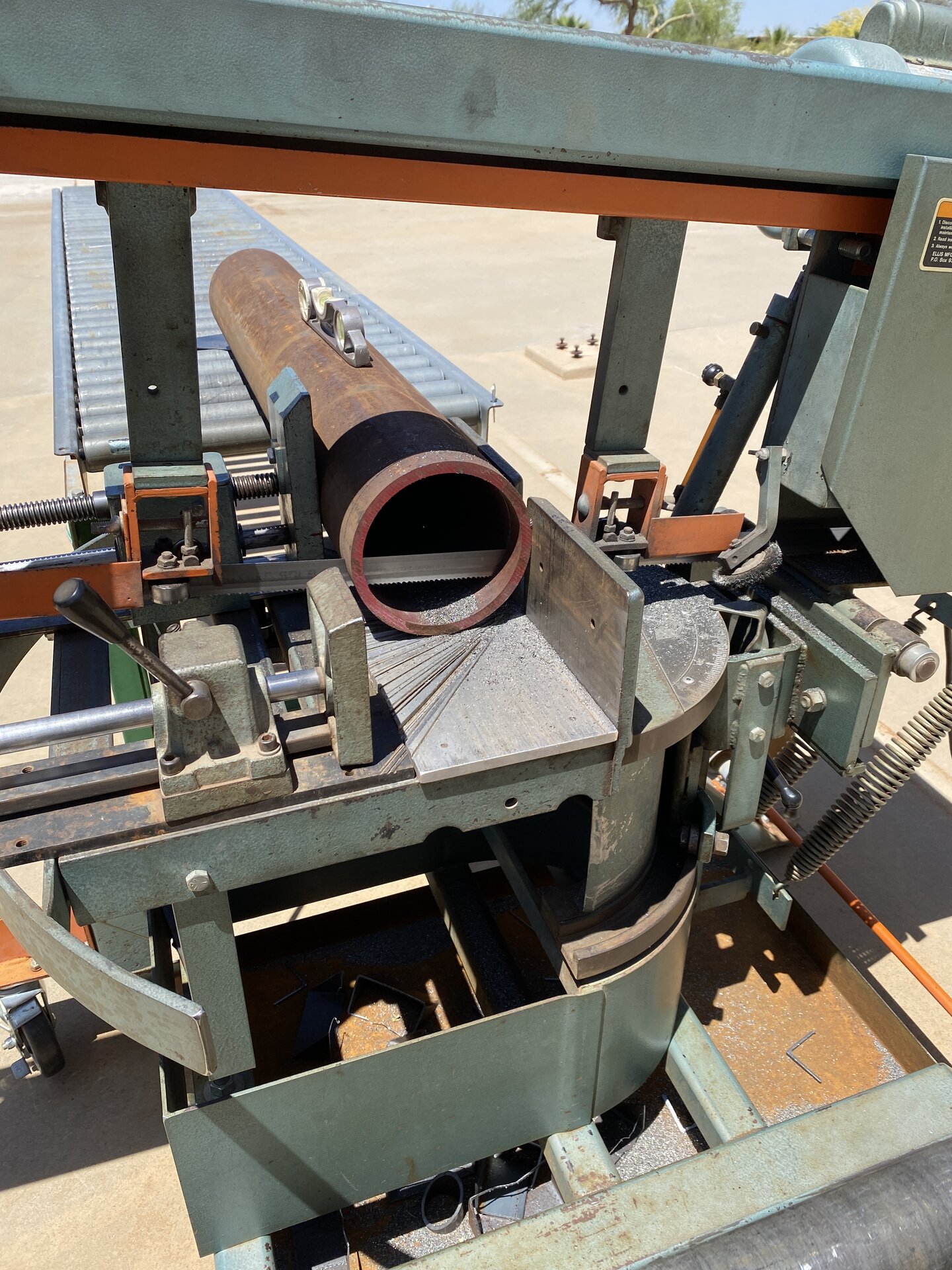

Sourced a section of 5-5/15” schedule 80 pipe.
Cut six 1” wide rings.
Sectioned one ring into six pieces to create this.
After grinding and blending we have this.
The far end of the fence.
The driveway side wing also got a crown as well as address numbers and the community logo for “Rocking K estates”.
Using peroxide, vinegar and salt in a handheld pump sprayer and the entire fence is now rust patina.
The third crown was welded atop of the lamp post.

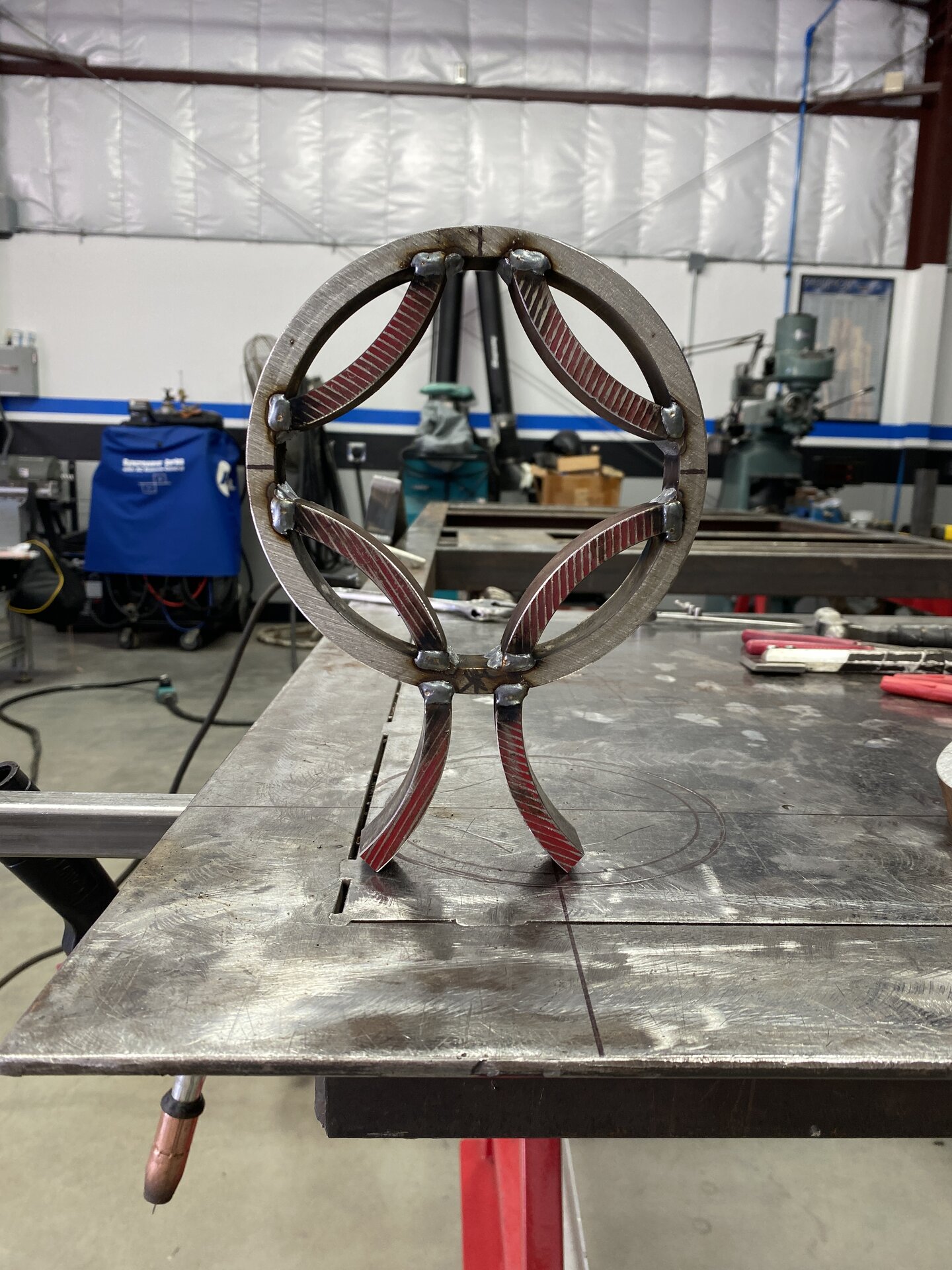

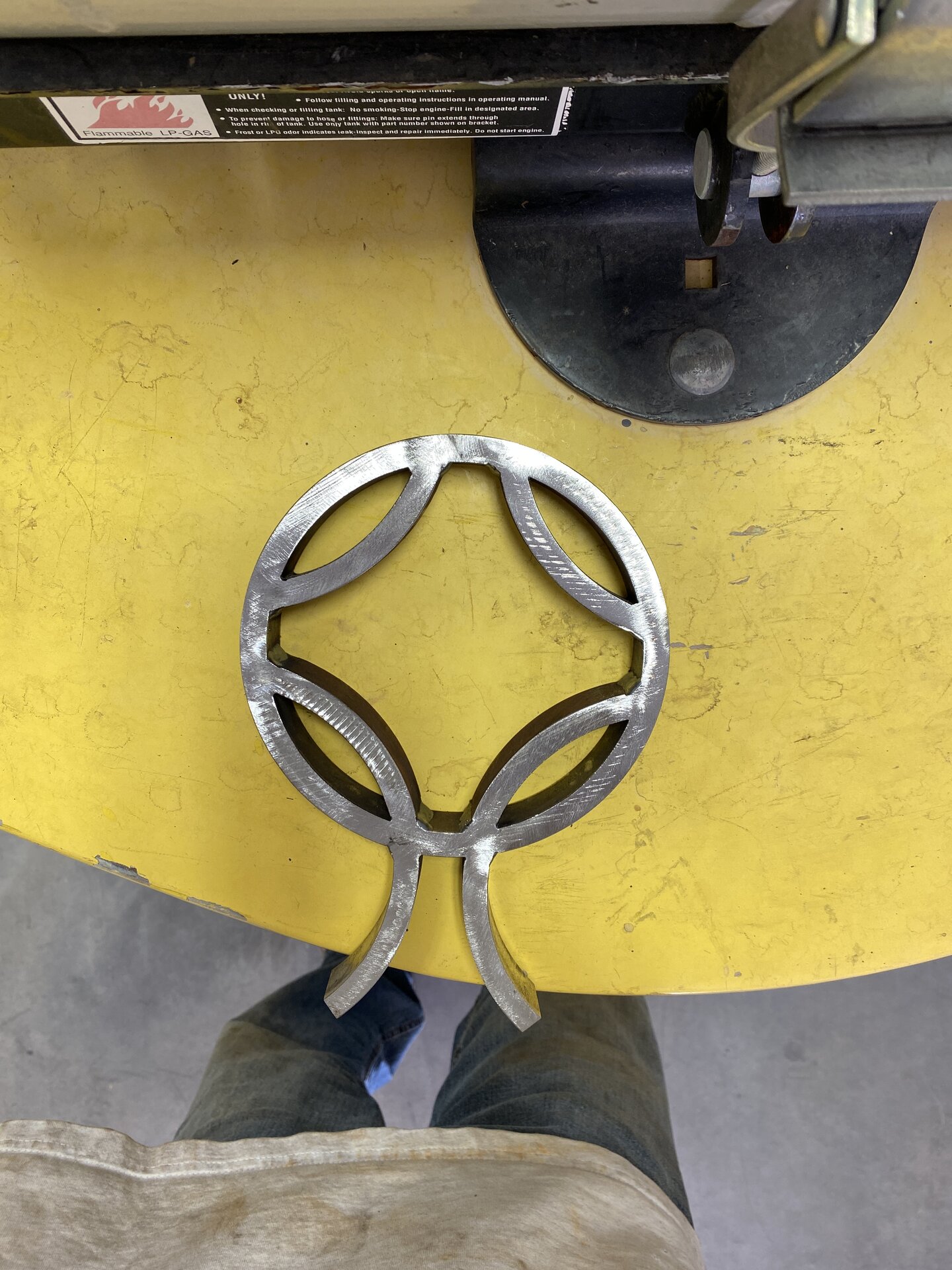

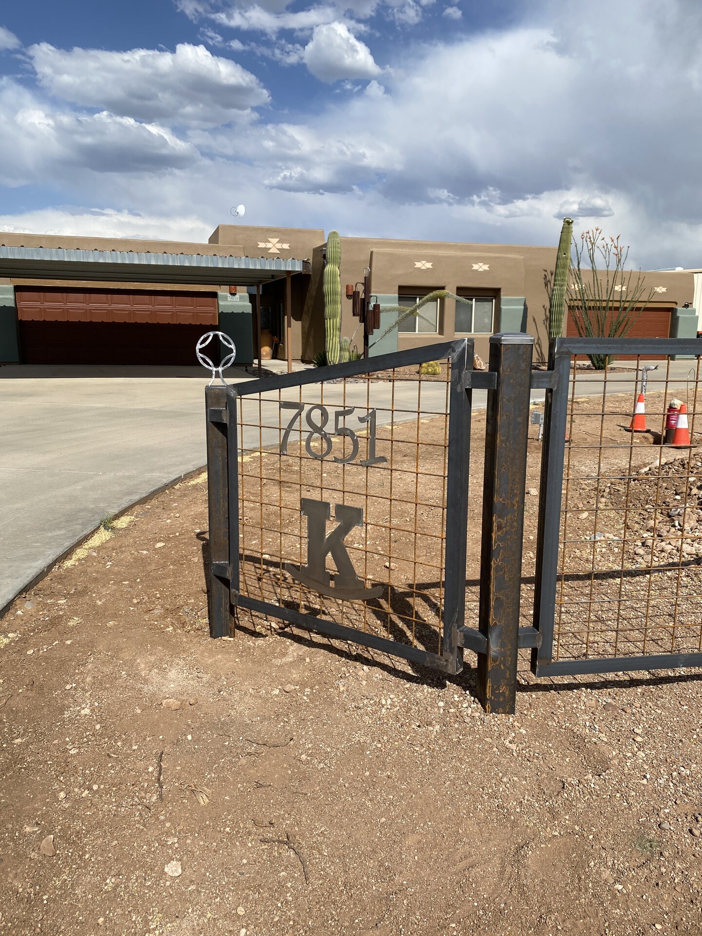

the far side wing.View attachment 3331125
The driveway side wing also got a crown as well as address and the community logo for “Rocking K estate”.

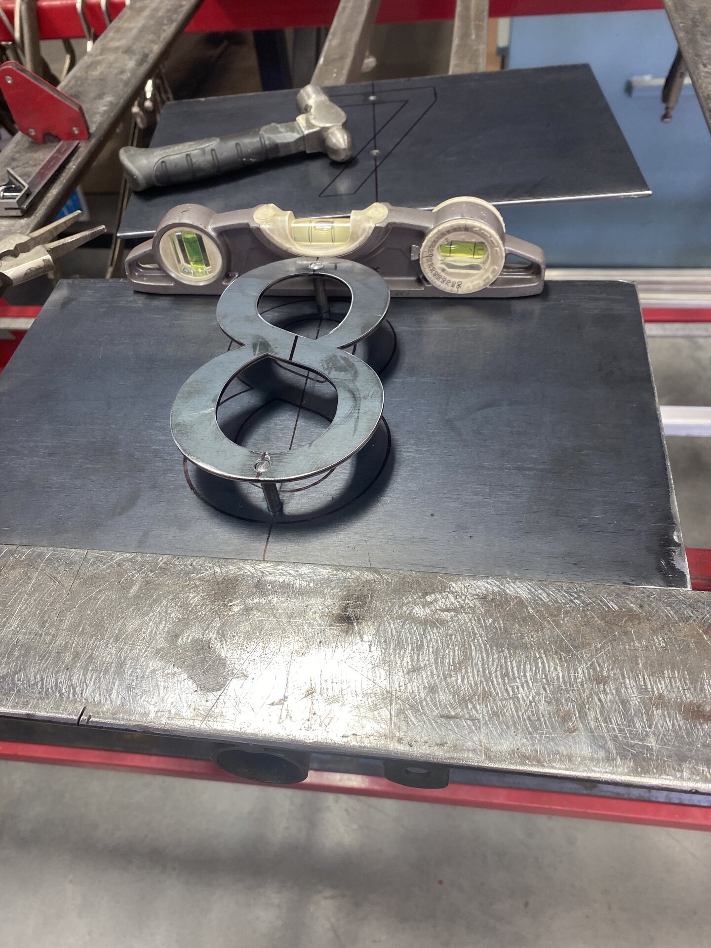

Made a address marquee for a friend.
The base plates were cut and laid out with a centerline (CL). The numbers also got a centerline followed with two .248" holes. The numbers were then placed over the base plates with the CL lined up. Transfer punched the hole locations onto the base plates and drill using the same bit. 1/4" round bar was cut 1.250" long. The idea was to tap in the small rod sections into the base plate hole keeping the end of the rod sub-flush for a rosette weld aka plug weld. This way the weld can be ground smooth and blended in without removing the entire weld. This technique will give a clean finish with no visible weld joint.
The layout.

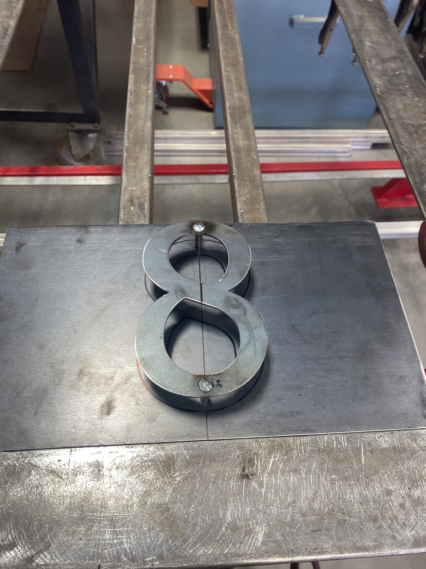

This shows the eight being set up for plug welding. All the rods were placed along the CL to maintain a clean finish. Each number got two rods.
A close look will show the number just proud of the rod allowing for grinding and blending and still have integrity. The torpedo level kept the numbers matching the base plate in both directions. The slight press fit by using a .248" drill allowed simple adjustments to hold fast until plug welded.
A hot rosette weld is required for good penetration.

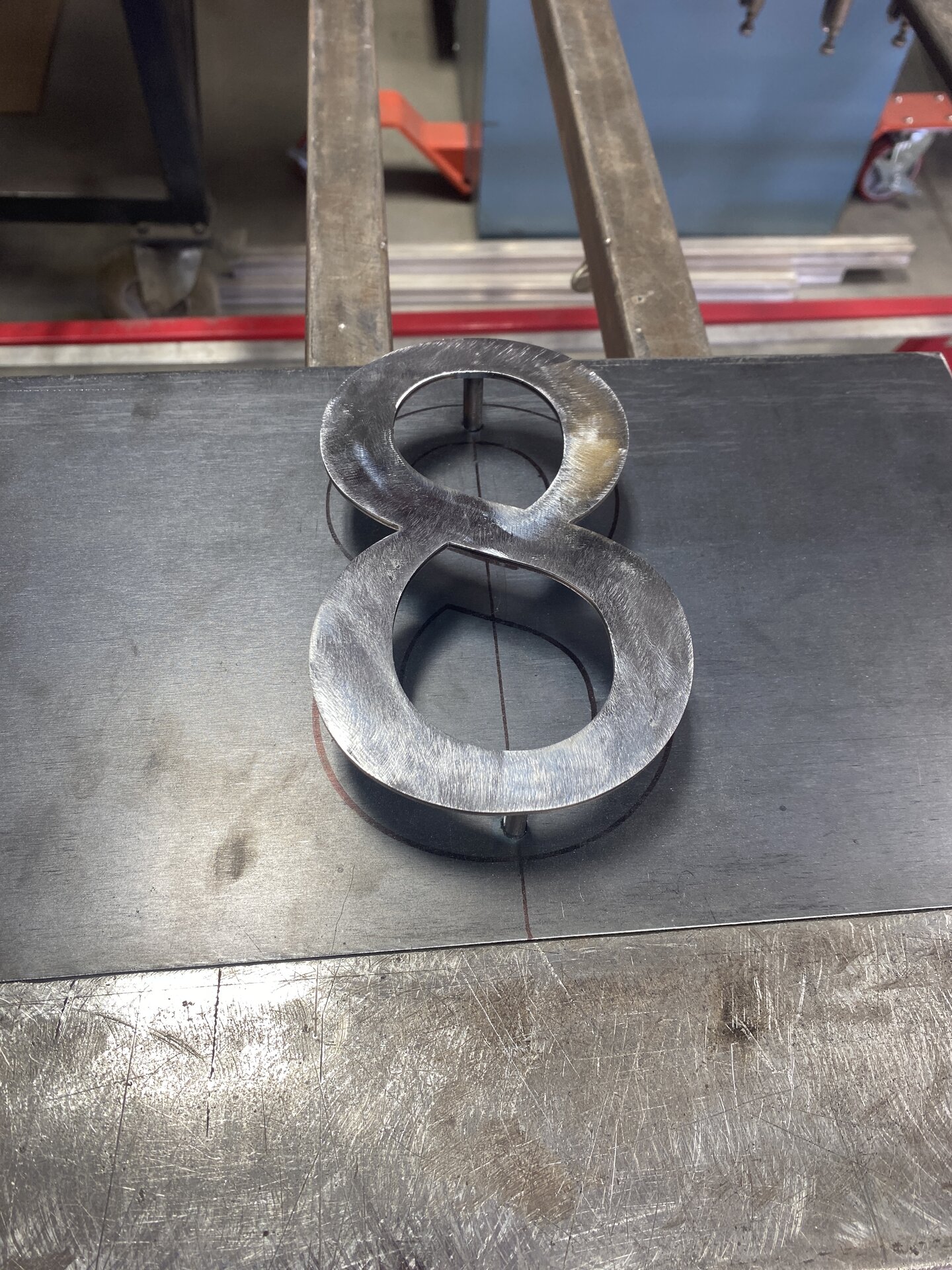

After grinding and blending the number looks clean.

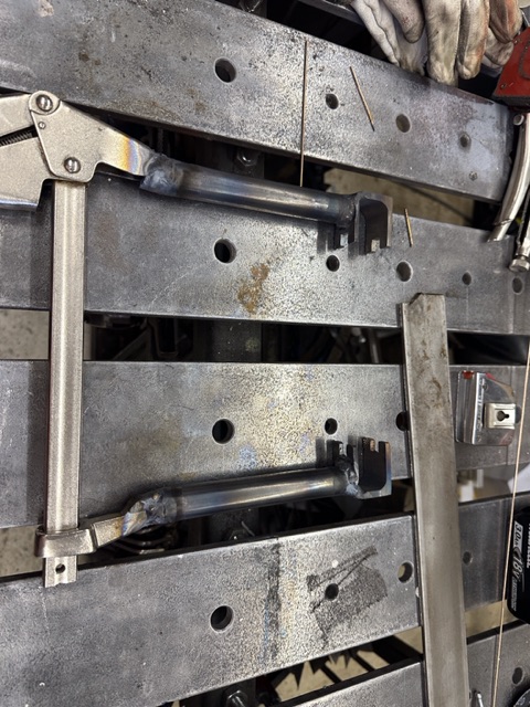

Needed an odd size E-wheel, we got one with tiny wheels.
Then modified some extendable grip pliers and created this.
And here is the tiny wheel.
It works even better then expected.

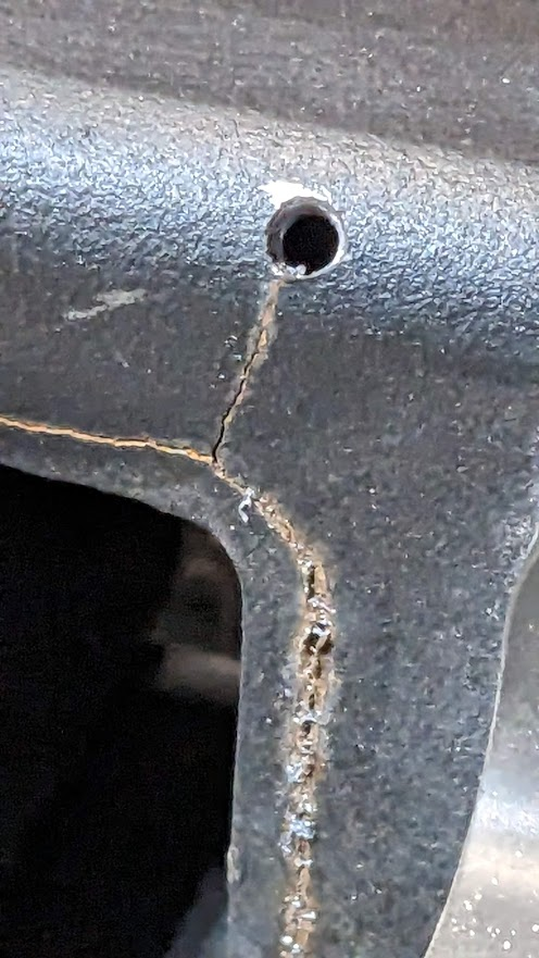

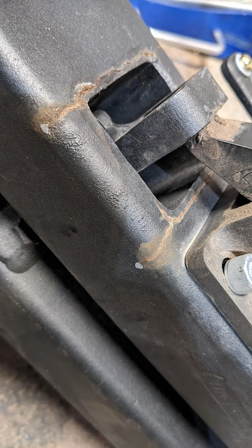

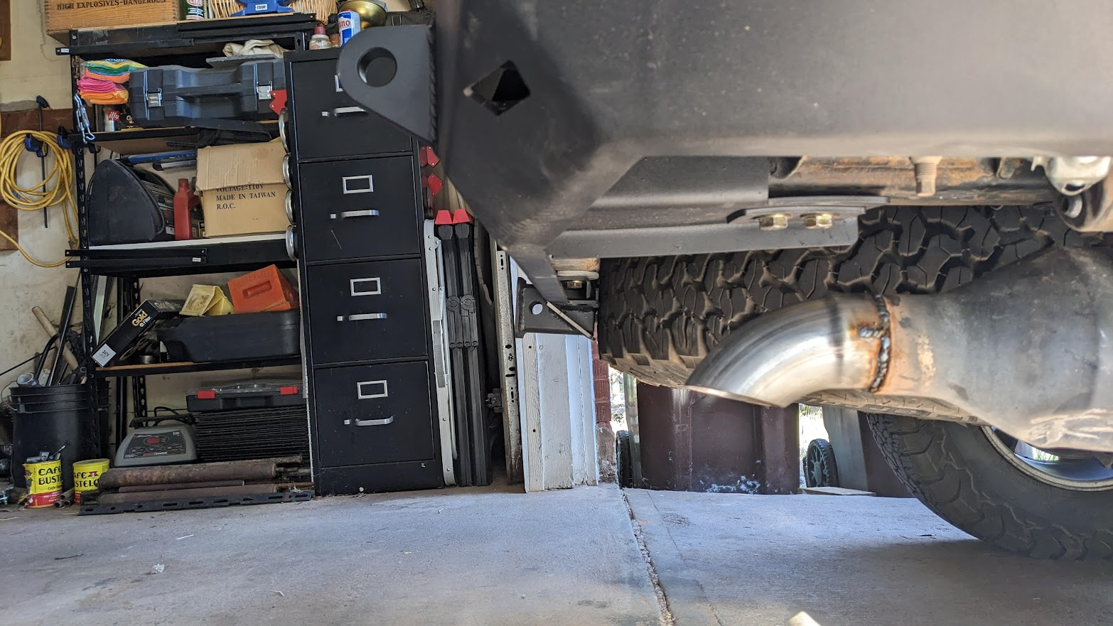

so, I got a weakened Rig'd tire swingout (megafit for full size trucks) from a buddy on a steal. (Sure it's a bit big for the GX, but wutchyagunnado :flipoff2: )
But it has stress cracks they've never before seen.
So ... I'll drill out to stop the cracks,
then cutting wheel the cracks, clean them up, sand off the PC and weld them up, then add plates to reinforce it and glob them on well, grind, paint, enjoy!
(TBC)
Oooh, oooooh, oooooooohh
And and I also scored a 1st gen rack attach missing the hook! Nice easy fix!!
Solid!!!
But there's always something,. Lol!
AND then, fixed the tip (with the bumper install:poof:)...

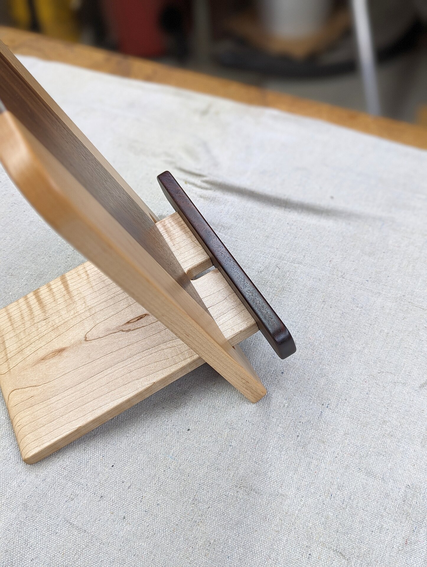

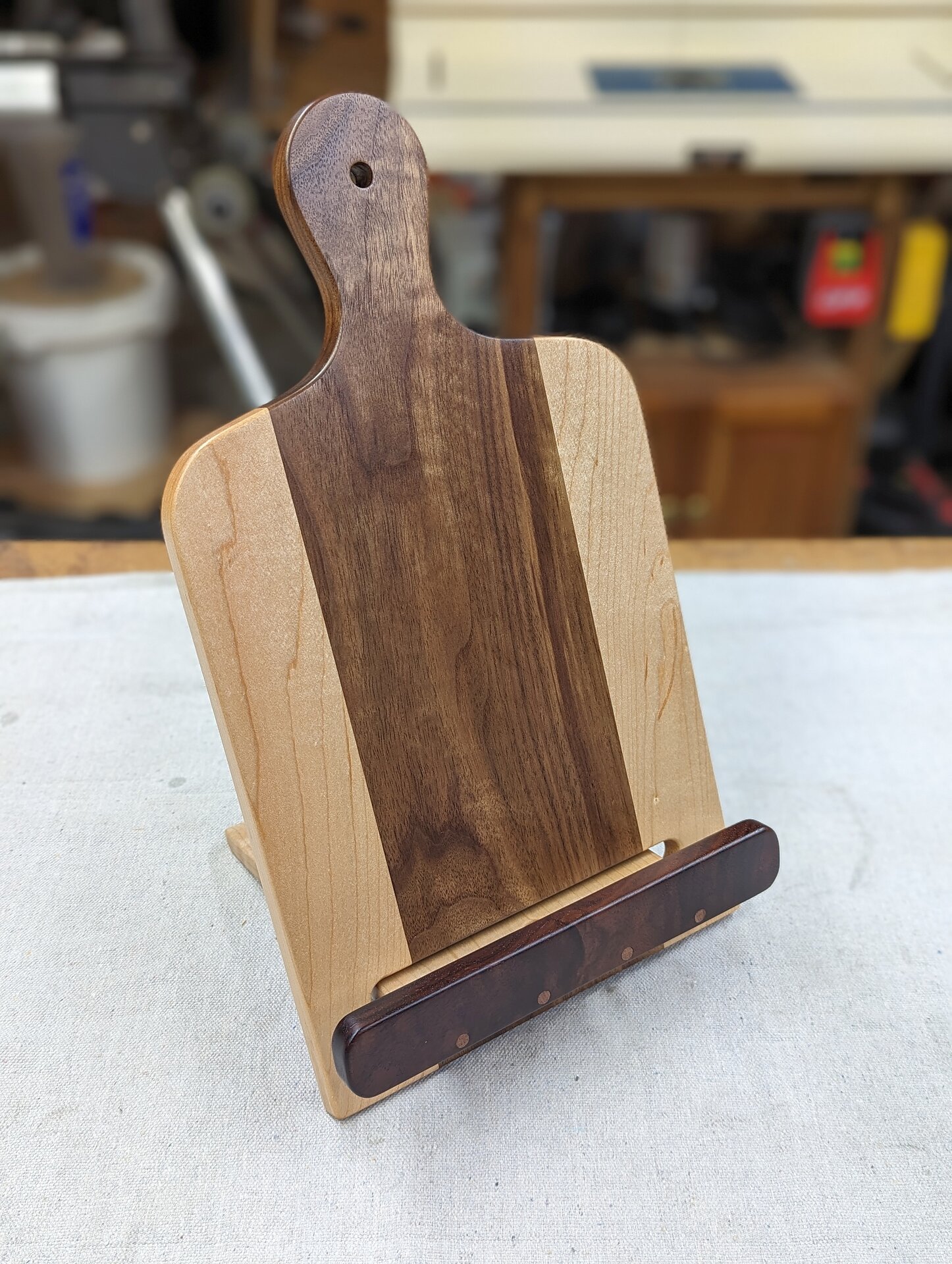

Another woodworking project completed today. Cookbook holder for my daughter, for her birthday. Vertical is curly maple and black walnut. Rest part is adjustable to thickness, or it can also hold an iPad/tablet/phone, so I made a slot for charger cord. Front piece is rosewood.
this is awesome!!!
Daughter going off to collage or fledging the coop? This is an amazing gift for the burgeoning life!!! 🤙 😍

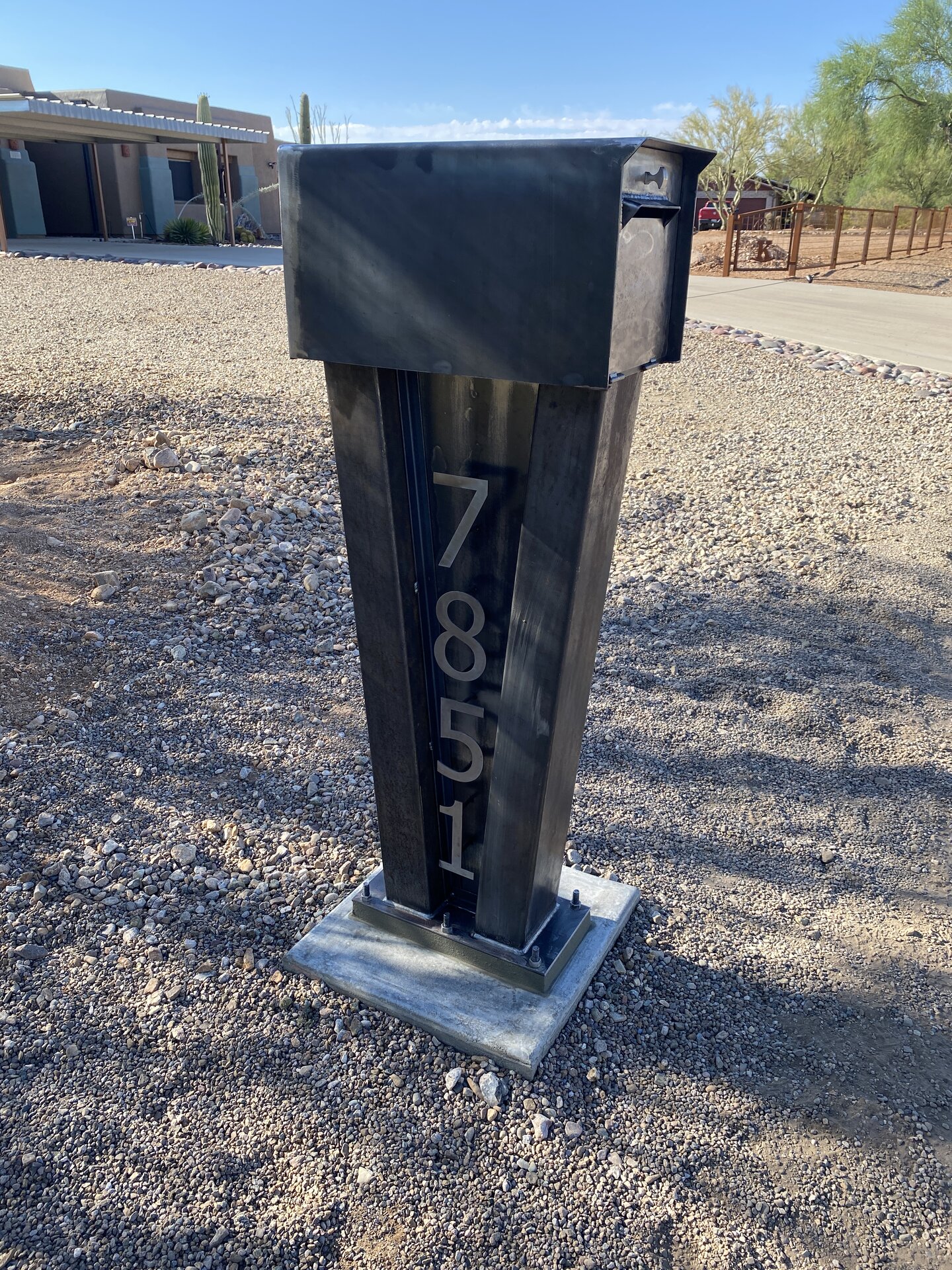

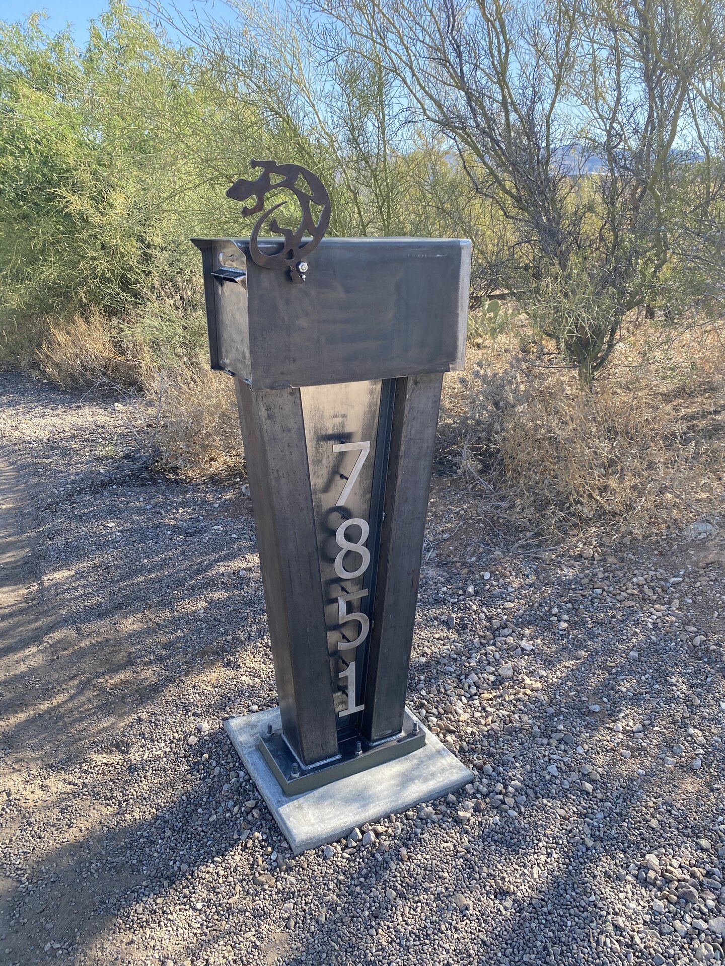

Built a mailbox for the homestead.
The base plate was punched and J-bolts attached for a wet-stab.
12-60 lbs bag of hi-strength premix.
Mounted the new box and dry packed the base with non shrink grout.
The out going mail flag nested.
House numbers on both sides float 2” from centerline.
