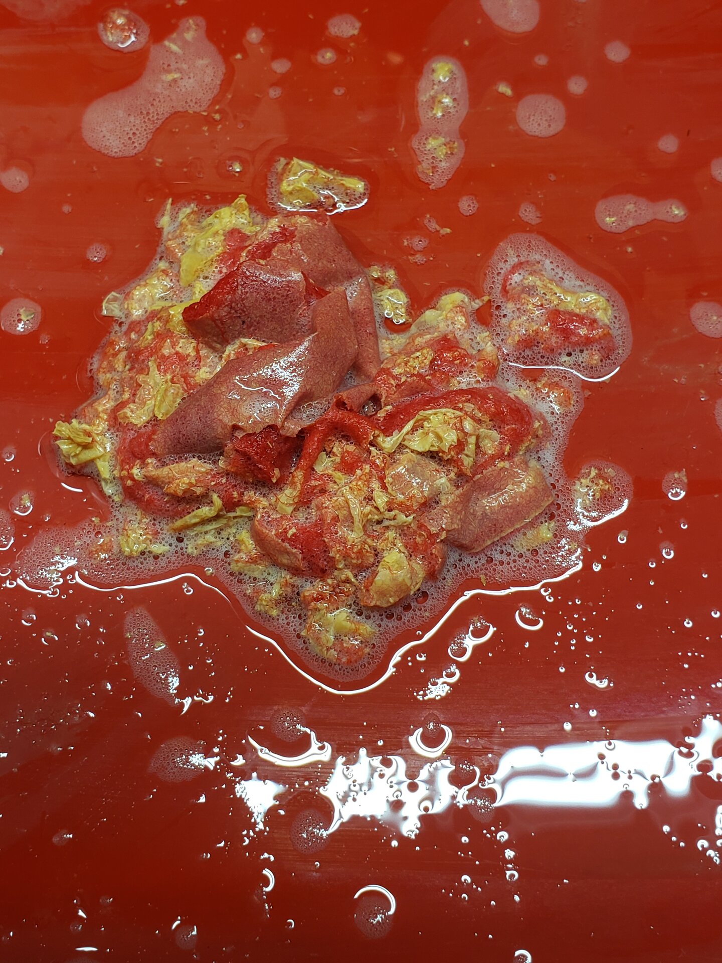

No. That's how clean this box is (once the red fuzzy stuff and glue is removed). Sort of remined me of skinning a small red haired rodent when scrapping off the goo...
I'll be cutting some Olsa drawer liner, which is what I've used in all the other boxes:
Tool Box Liner
Name that Goo:
Sort of looks like tomato skins, mixed in human skin. Yummy....

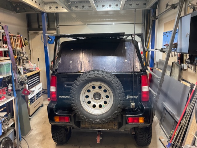

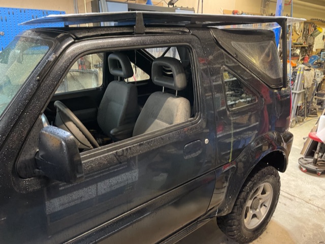

It is not a Toyota but….
It is from Japan,
And it is ….
loosing some weight,
and getting something done about his small size syndrome.
Anybody here interested to follow this?

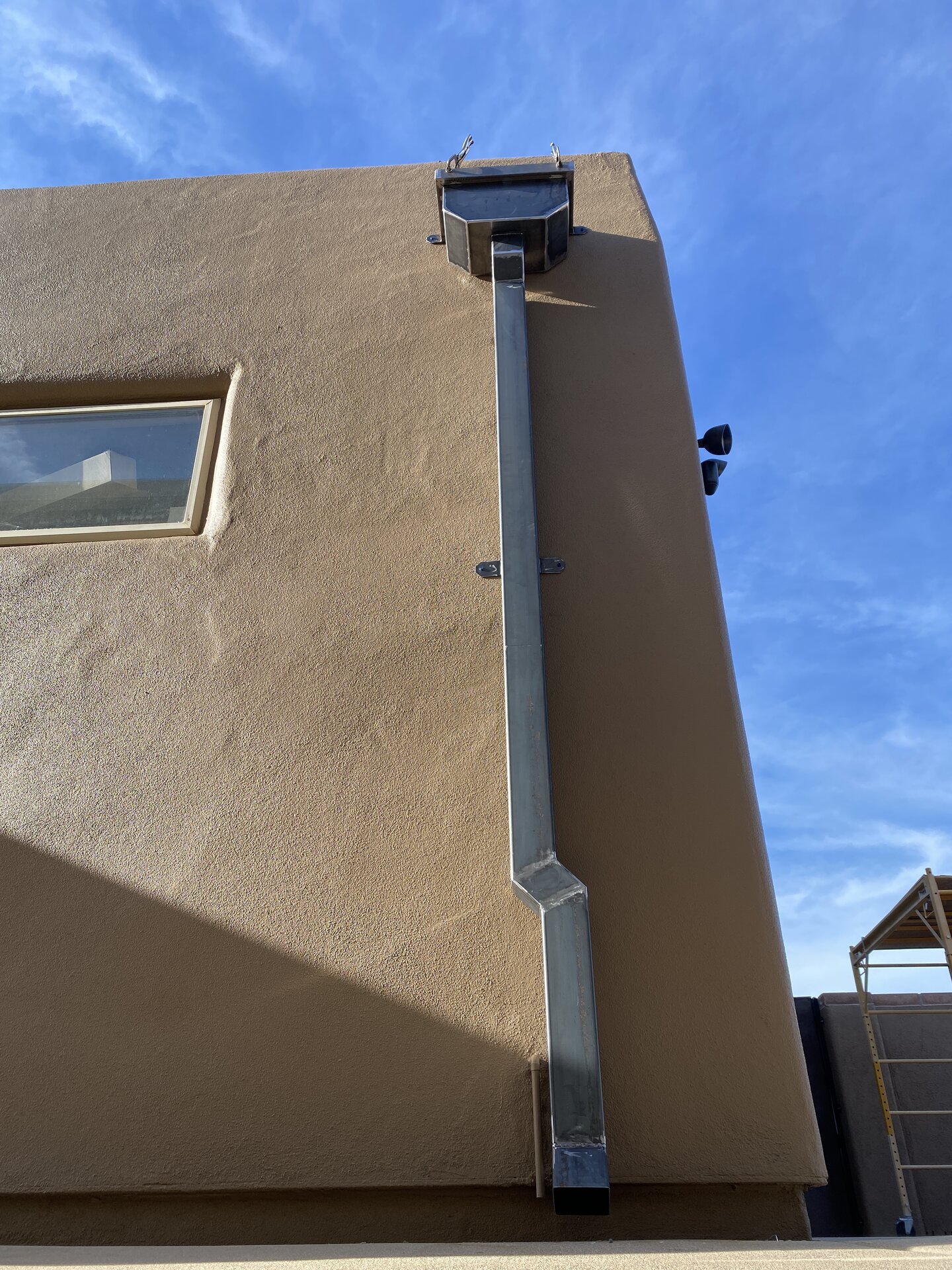

Completed the installation of the distribution boxes and down spouts.
Starting from the south side of the house the three scuppers were a good starting point since it was next to the shop.
The first scupper down spout require a slight jog to clear a drain (fire protection).
The second and third were straight forward.
The third downspout worked well with the dumpster rack (javelina proofing) and shared hose saddle.
All three.
Working around the front (west). This scupper drains a different roof section and is taller.
The next box and downspout is located at the main entrance and drains the same section of roof.
The last four are located on the north end and drain two separate roof sections and shed the most water.
The one took a few angles.
All the mounting tabs were broken to allow for any stucco variations. That 17 year old 1800 Ellis saw cuts nice angles.
The crazy downspout.
Overall shot of the last four.
The tabs were caulked along the top and sides followed by paint to match the house. The rest will be left to Mother Nature to provide a natural rust finish. the boxes and downspouts are slightly gapped from the house to prevent rust staining down the walls. That was the reason for bending the tabs, caulking and painting.

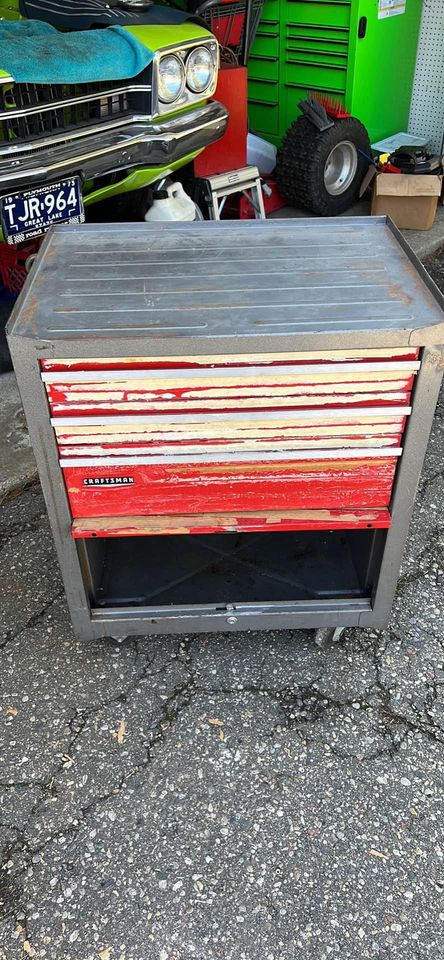

Drove over an hour (each way), battling rush hour traffic for this beauty. Like a few of the other boxes I've acquired, this has a few previous owner mods. I'm sure there must have been a good reason to put all that masking tape on the front of the drawers. Just don't know what that could have been. I do know that it'll take me about two hours per drawer to get it all removed without compromising the paint. Probably looking at 6-8 hours of soaking/scrubbing/soaking/scrubbing/etc. per drawer and bay door.
There's also an eye bolt fastened to the case. Another 'mod' of unknown design/engineering benefit. Kind of visable in the first pic, left rear, if you're not staring at the good looking Road Runner the seller had in his garage... Biggest downside, is that someone lost the key, and decided it was faster to drill out the lock cylinder, than take the key code (stamped into the lock cylinder) to a locksmith and have one cut.
It'll be a while before I get around to this one, the wife has decided 'we' should replace all the carpet in the upstairs bedrooms, stairs, and landing, with hardwood. Or course, that also means a new stair rail, etc. And probably a few hundred feet of baseboard and shoe (that this old guy gets to do). I'm not doing the flooring or stairway. Material is too expensive to be scrapping out while trying to learn all the tricks to get it right. I'll leave that to the pros.

Whoa hold up. You need to explain and show more photos of that bright green beast sitting behind.
Well, it belongs to the guy's son, but he's helping to resto/mod it. Didn't ask permission to take pics. From what I got him to talk about, it's a 360/auto. The engine has 'a few mods'... The body, from what I could see was primo, paint is all new. The engine bay is way nicer than it was originally (I'm old, so I know first hand about old cars when they were new...). They've got a new interior ready to install this year, so it should be tearing up the roads before the end of summer.

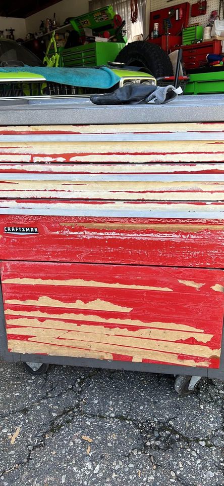

Three days. That's what it took me to get all the petrified masking tape off the drawers and bay door.
Before: After (drawers only):
They came out remarkably well, considering the layers of tape that were on them.
I found the best method for removal was to use scalding hot water, and flush the tape repeatedly. Take a stiff nylon brush and scrub aggressively to remove as much of the paper as possible. Repeat, repeat, repaeat. Soak with Purple Power, and scrub, scrub, scrub, again. Rinse, pat dry, then use a paper towel with some lacquer thinner to remove any glue residue. The lacquer thinner worked the fastest to remove the baked on glue. I tried Goo Gone, and it worked eventually, but you had to clean it all off with more Purple Power afterwards. The lacquer thinner was pretty much wipe on, wipe off.
Cut new Olsa Tool drawer liners for them, and now it's on to pressure washing the case.
