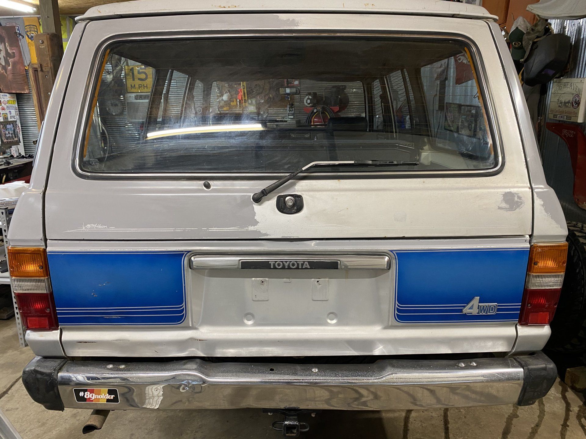

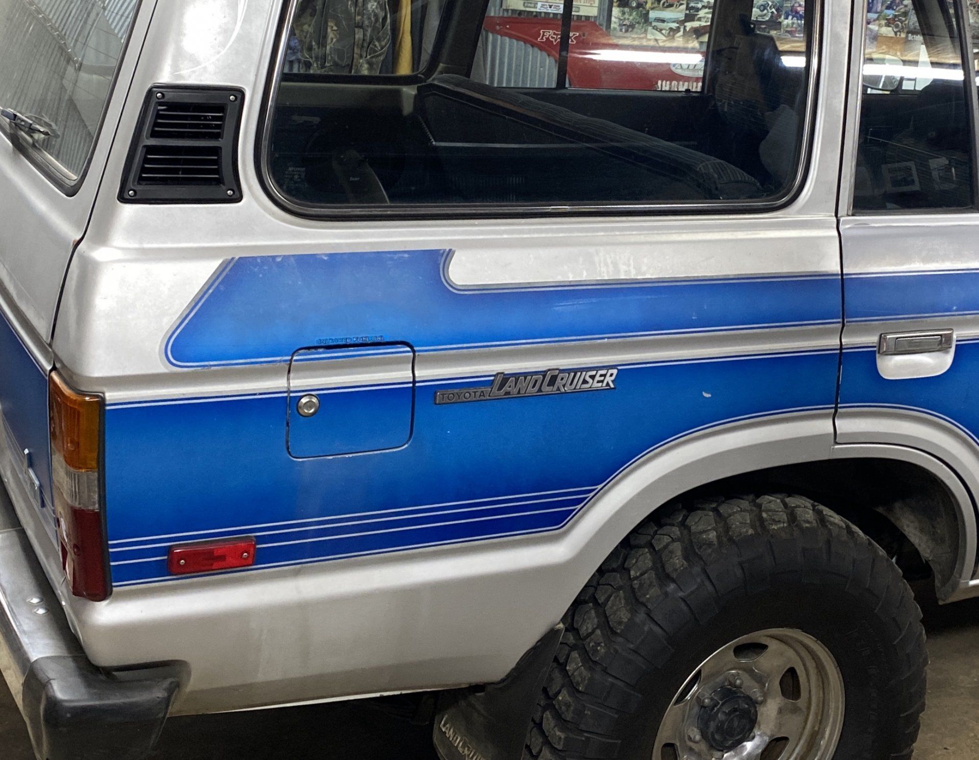

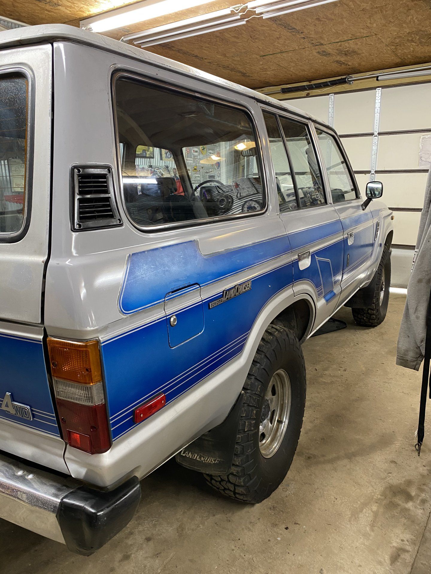

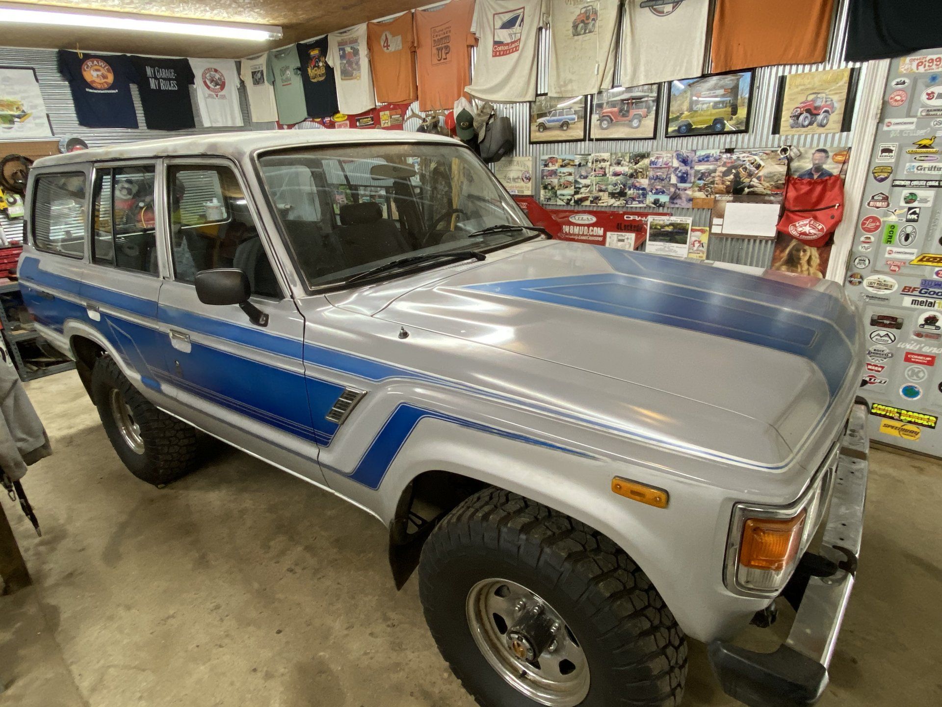

My painter came by and we made a plan. He is taking it the first week of July so I still have time to chip away at rubbing off the funky silver
I have a new weapon in my war against this stuff. I’m still trying to figure this out stuff but I will say it made pulling the paint off WAY easier.
I sprayed it on. Let it sit about 30 seconds then I wiped it off and then hit it with CLR and the steel wool and it came off so easily.
Less work but I’m being real deliberate. This stuff is strong. Don’t want to mess up the gray
So, this is the plan. Get the areas all around the graphics cleaned of the old spray over silver then tape off the areas where it’s been cleaned and then repaint the rest factory silver. Rockers. Roof. A/B Pillars and door frames. Should look cool and keep the retro stripes looking retro and protect and preserve the rest

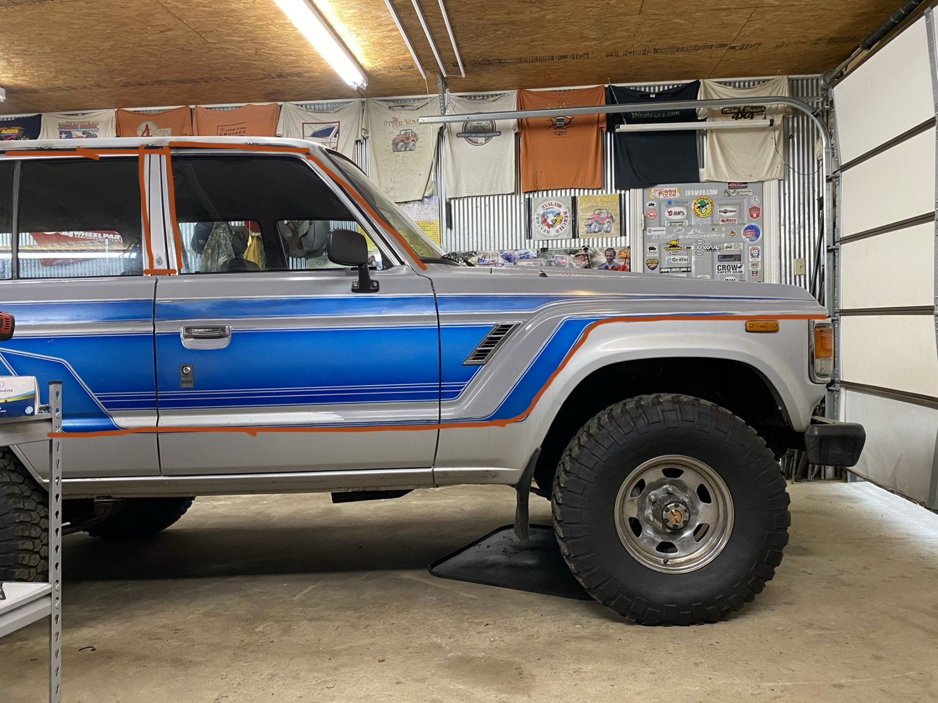

Funny you ask. I’ve been on R2D2 today for about 3 hours working on the areas between the stripes. I am happy to say I’m getting to the end of this journey.
The painter is taking it next week for roof repair and chrome install so I want to have my end as compete as possible so it looks like new money when he gives it back to me.

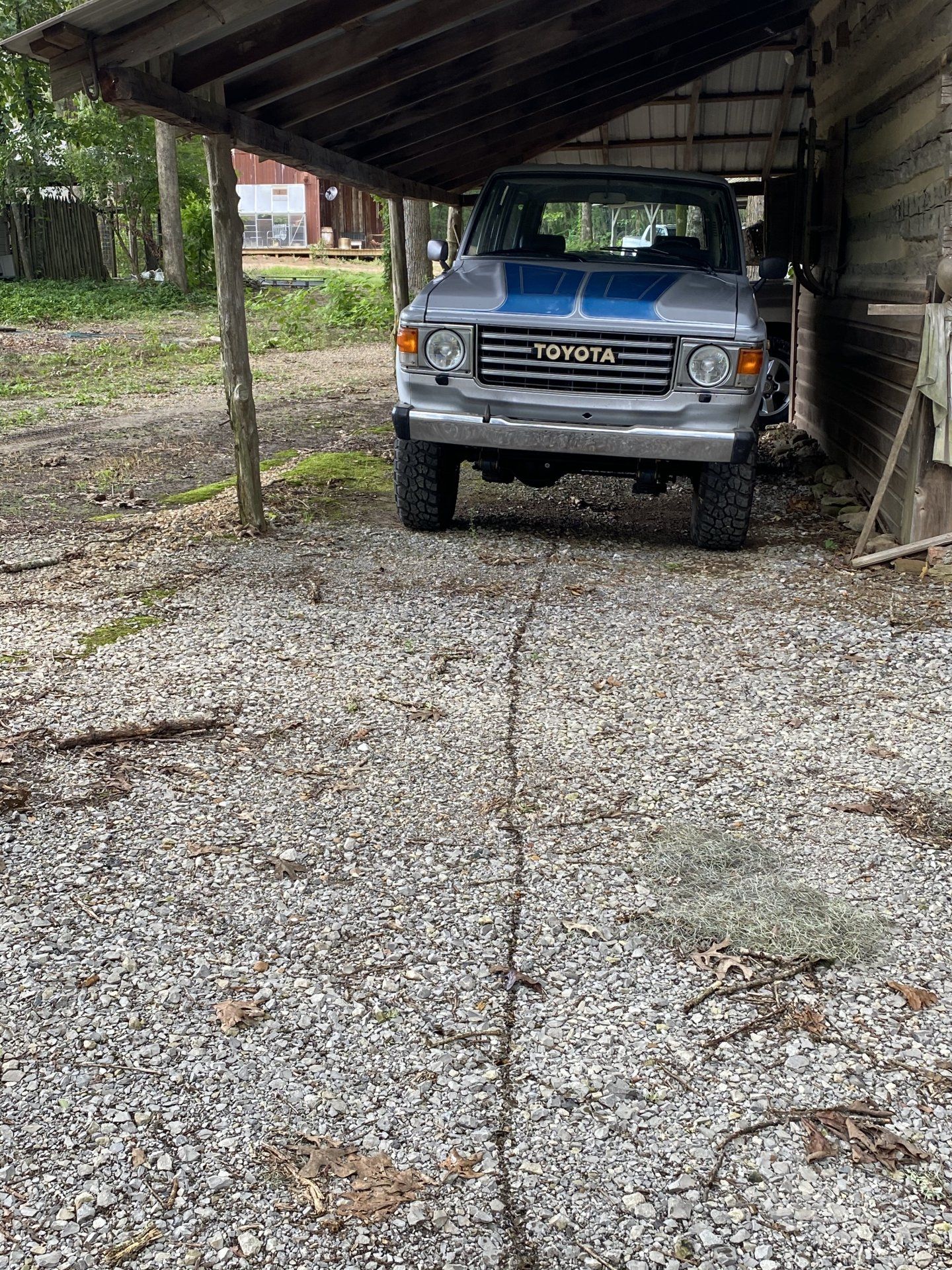

I was playing musical 60’s today and fired up R2D260 and moved it 100 yards.
As I was walking back I found a trail.

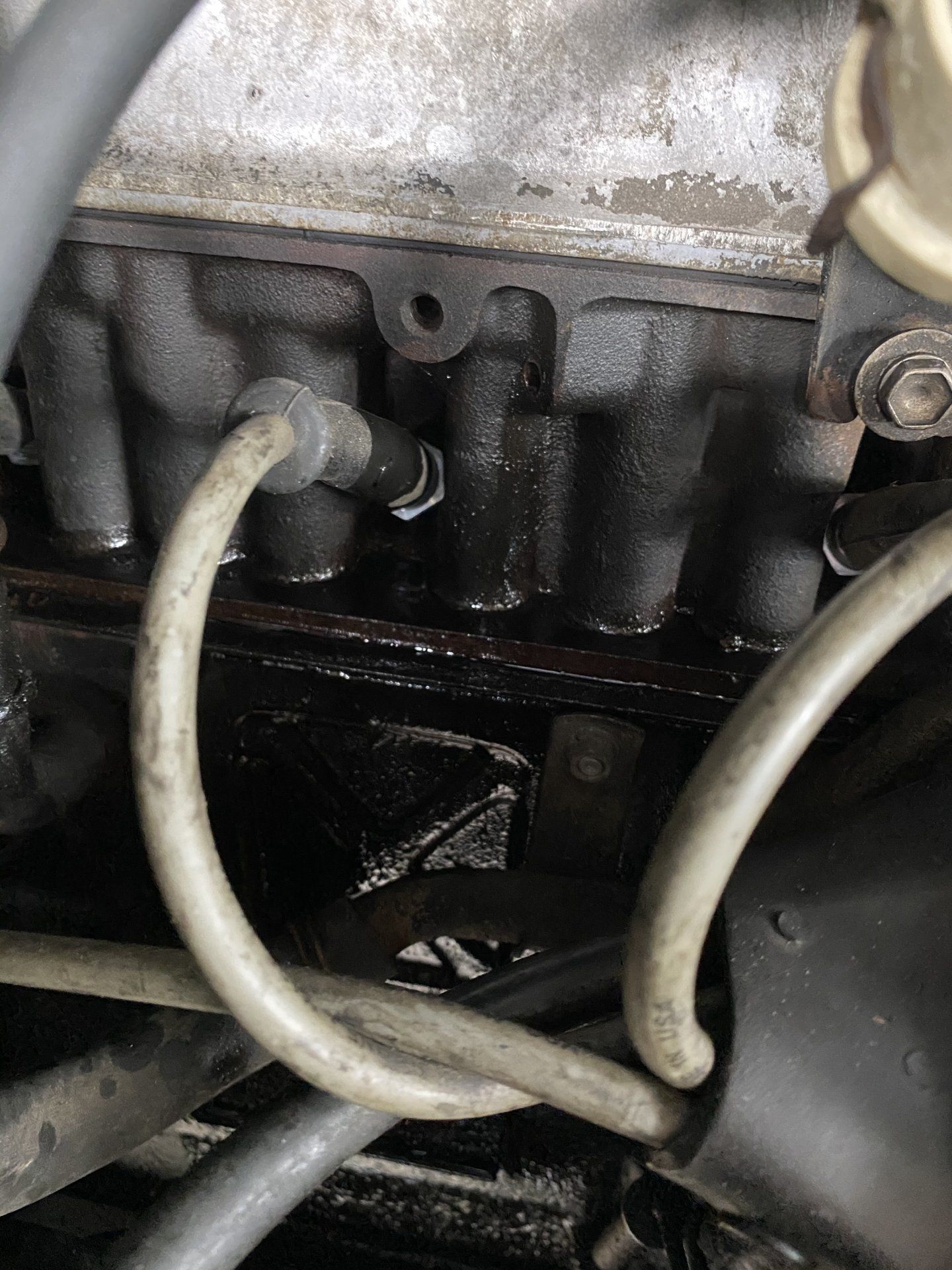

Holy hell I got lucky on this one. The oil galley plug blew out. I was not planning on driving it until the painter called and that means it would have happened on the road and I would not have noticed until it was too late.
Ugh.
Ugh.

100% would have blown the motor had it not been that tiny trip. I want to cry and be thankful at the same time

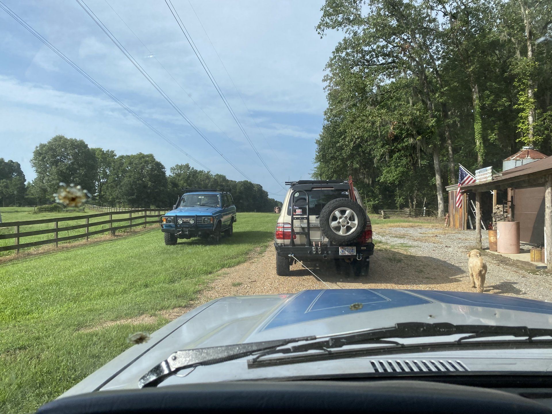

I’ve ridden the rope of shame in the last 30 days 3 times in 3 different Cruisers.
I’m tired of it.
