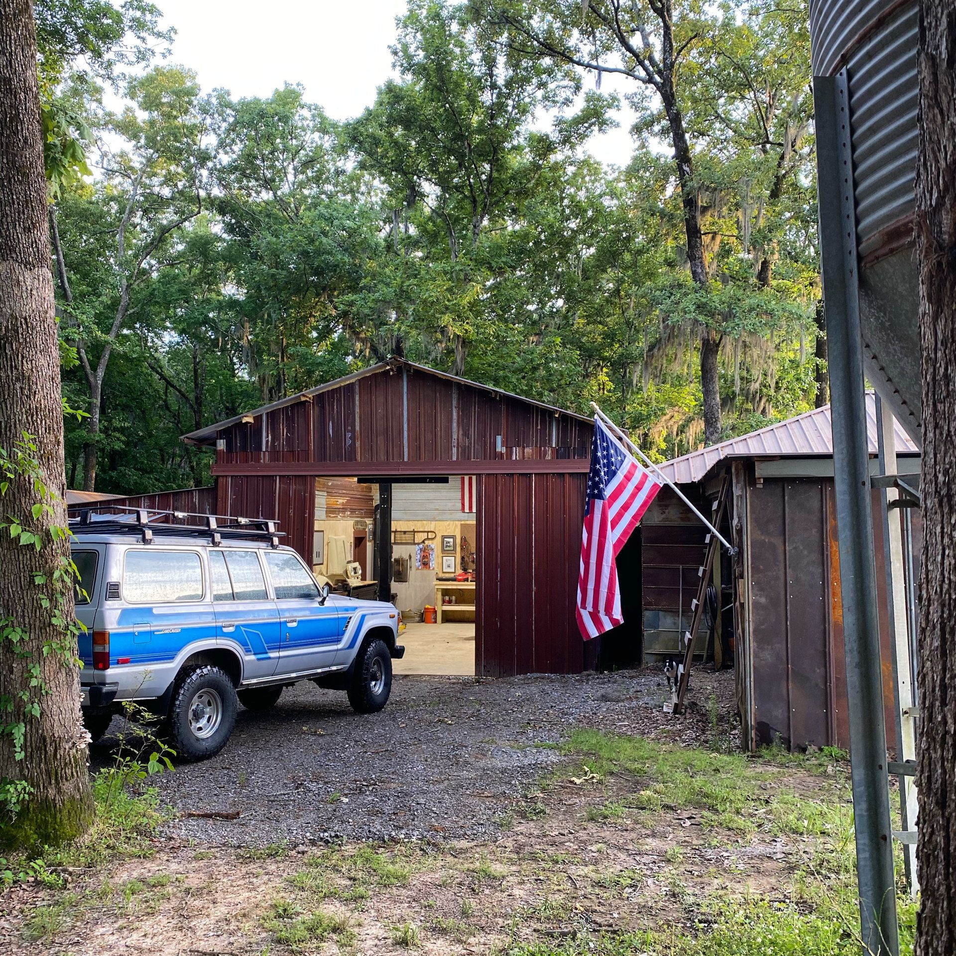

Look who is back in the shop.....

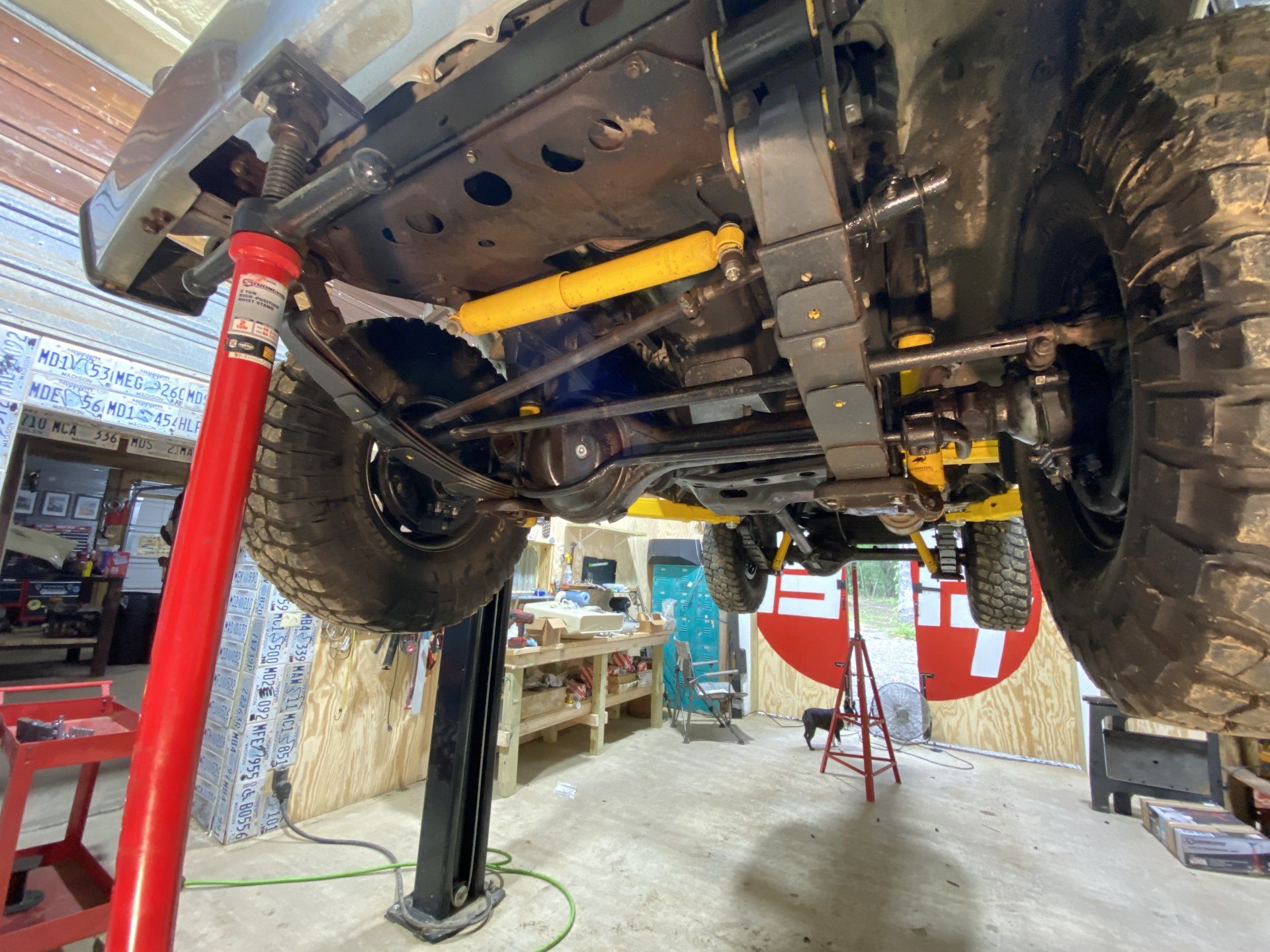

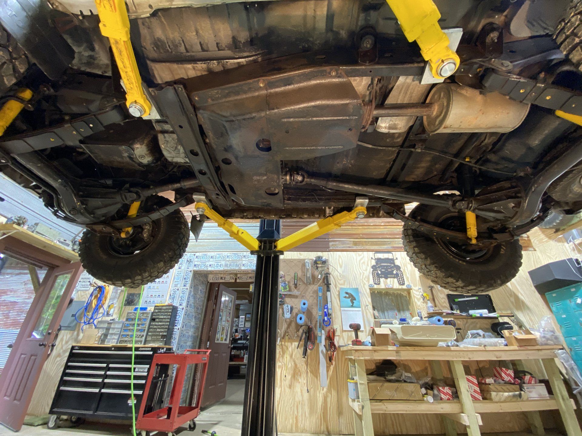

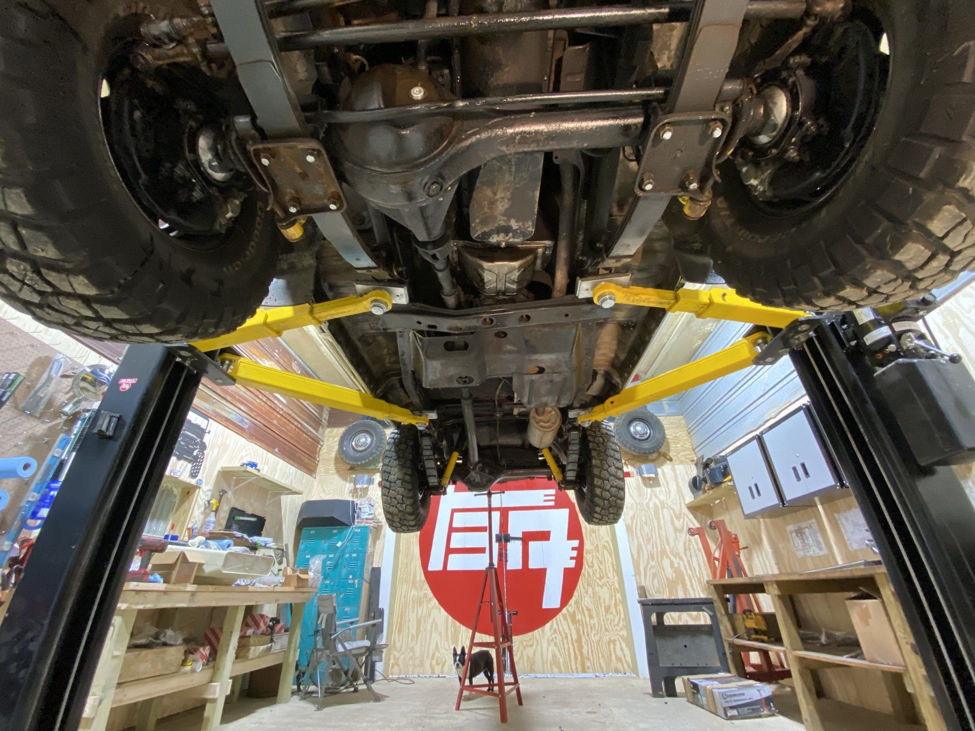

I’d not yet put it in the rack so I wanted to get it in the air and make sure all the fluids were good. Bolts tight. Shafts greased. Etc.
After washing off a coupe or three weeks of Mississippi pollen I pulled it in.
I let it sit overnight. Had two drip marks. Both look like they are either oil pan or rear main.
I added proper hex plugs while I was checking the axles. Fluid was clean so I did not drain either axle.
I got good turns on all the oil pan bolts so I’m crossing my fingers that that takes up most of the drip. It’s not near bad enough to warrant pulling the drivetrain out for a rear main.
The other good news is that there is zero. Zero rust on the lower body and frame. All the surface stuff is just coloring. So happy.
The great thing about this stuff versus paint is that after it soaks into that surface rust the frame will be black again. Not black like rust converter though. It’s great. I’ll show it before it leaves Tilda Bogue to show
All treated. I had to drop the spare to get above it. Turned out it was also flat and they installed it with valve stem up. It’s brand new so hopefully it stays full.

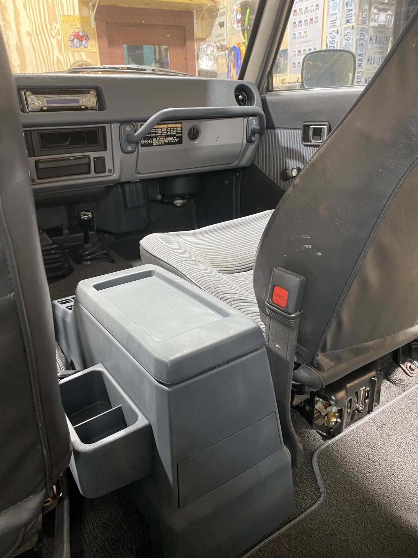

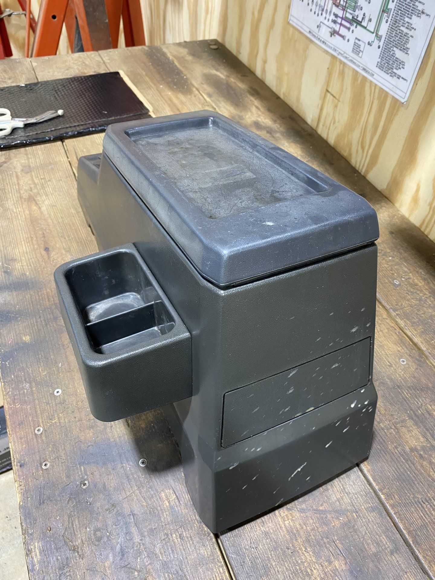

Heat gun on the console is actually a doable deal. Typically a hair dryer is going to not have enough heat.
When using a heat gun just remember that it’s easy to get it to hot and distort the grain or melt it so no drinking on the job!
We usually remove the consoles and use a good cleaner followed by grey scotch brite for a minor prep and then wiped with rubbing alcohol. NOTE: DO NOT USE THE ALCOHOL YOU ARE DRINKING AT THE TIME! It is in fact different!!!!!
After prepping.... Graphite SEMS interior color will be a dead on match to your dash cover. You can also use this color on any interior colors in the vehicle including upper vinyl on door panels.
Cordovan Brown is the SEMS color for brown interiors. PLEASE keep in mind that preparation is the key and just use enough color to cover. More color is not a good thing for flexible products / plastics,vinyl, rubber.

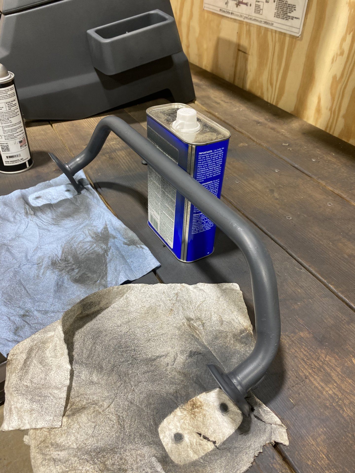

here is today’s life hack for y’all
Not only was the top of this console faded but the rest of the console was stained and the grab bar was a mess.
This SEM paint did the trick on both

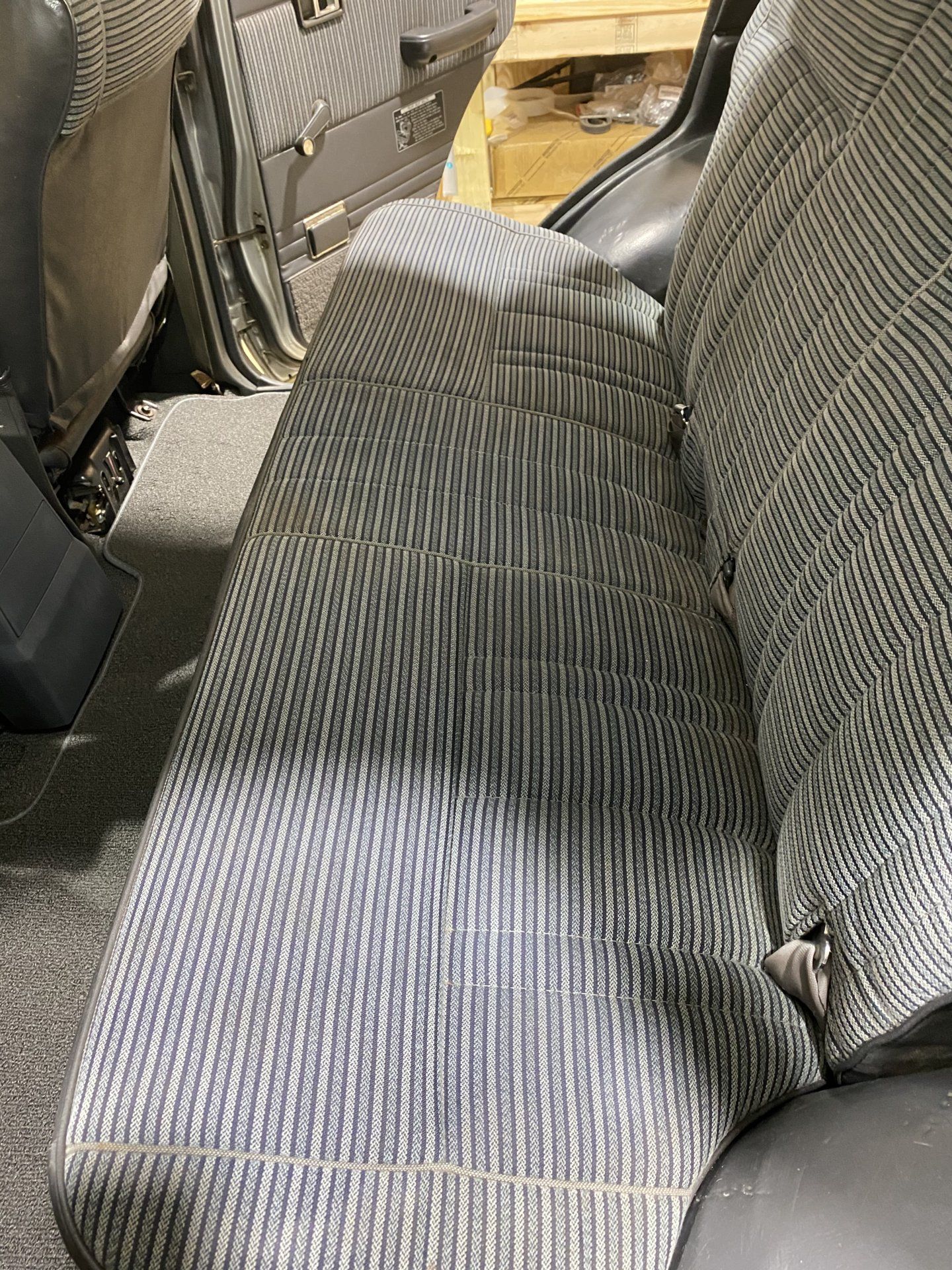

The seat bottom that came from @USMC22 got a good shampoo.
Then I installed the interior stuff back.

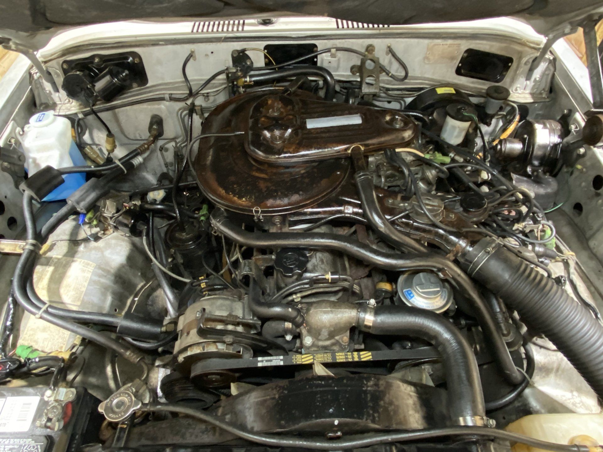

Then I cleaned up under the hood and made a little list of items it needs under the hood.
It’s remarkably complete. I got a new intake hose because the other one was yellow and highly offensive.

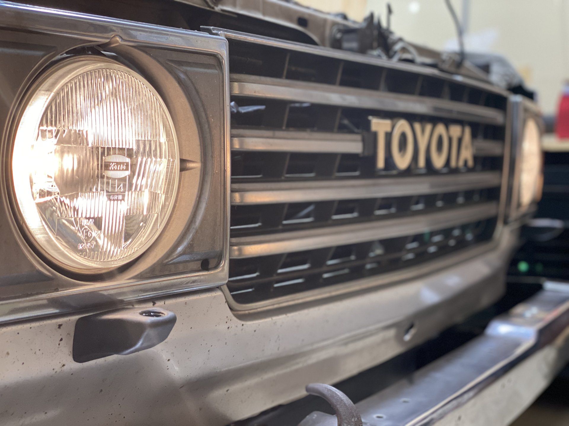

Best thing though is these superb Koito H4 headlight upgrades

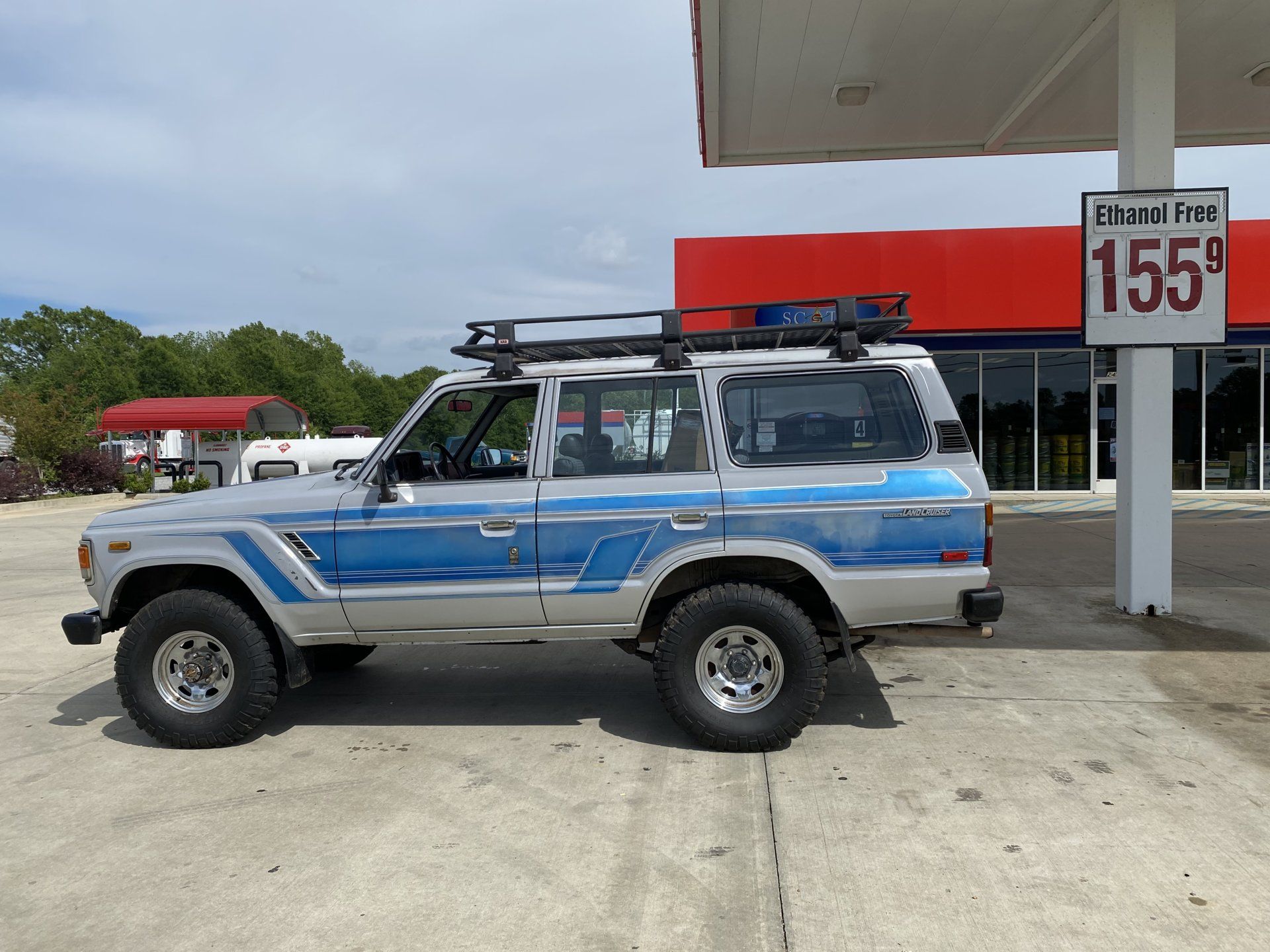

This was the first long drive I’ve ever taken it on.
Overall it was great. It’s dieseling when I kill the ignition. I need to check the timing. It’s possibly out of whack. I have zero experience with fully smogged 2Fs so hopefully that is all it is.
Still has a drip at the rear main.
This truck is fantastic. Hard to imagine it’s only got 149,000 miles

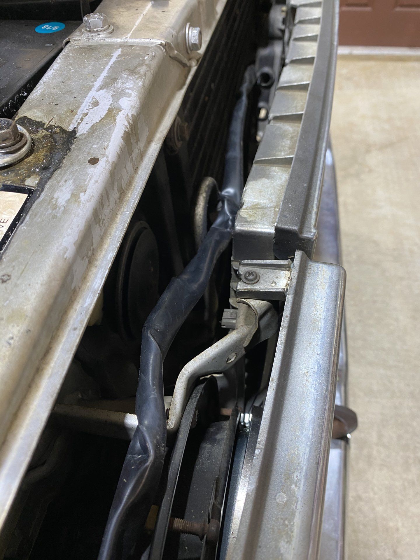

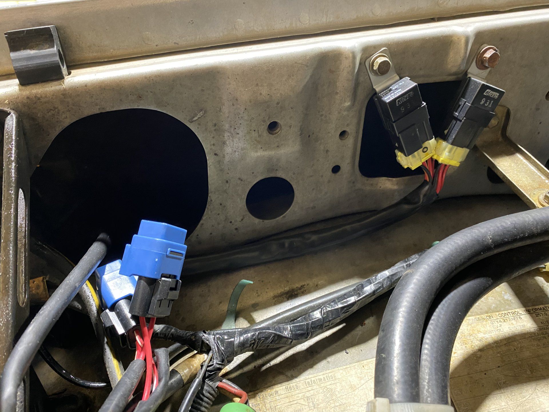

It’s a beauty! Was trying to see how you ran the koito harness and relays in the engine bay. Next time you are under there would you mind snapping a shot?
Super simple. Will do

Nice, I just did the Koito upgrade on mine as well. Unbelievable piece of kit for that price.
The parts guy called me from the place I ordered online to say I think it's just a bulb :rofl: he couldn't believe it was that cheap.
Makes me want to buy another 89nolder just to buy this light kit.

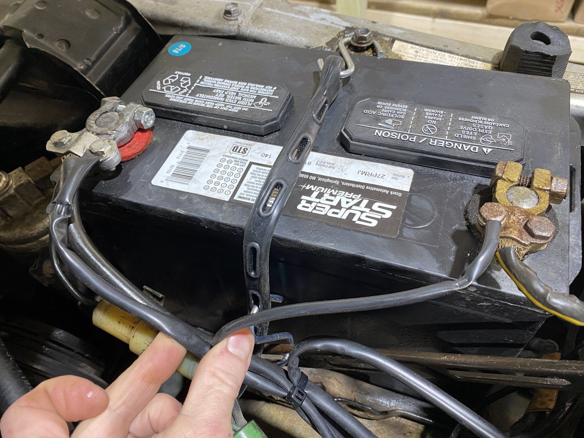

So, don’t laugh at the battery hold down. I have the J Hook and hold on order from @Onur

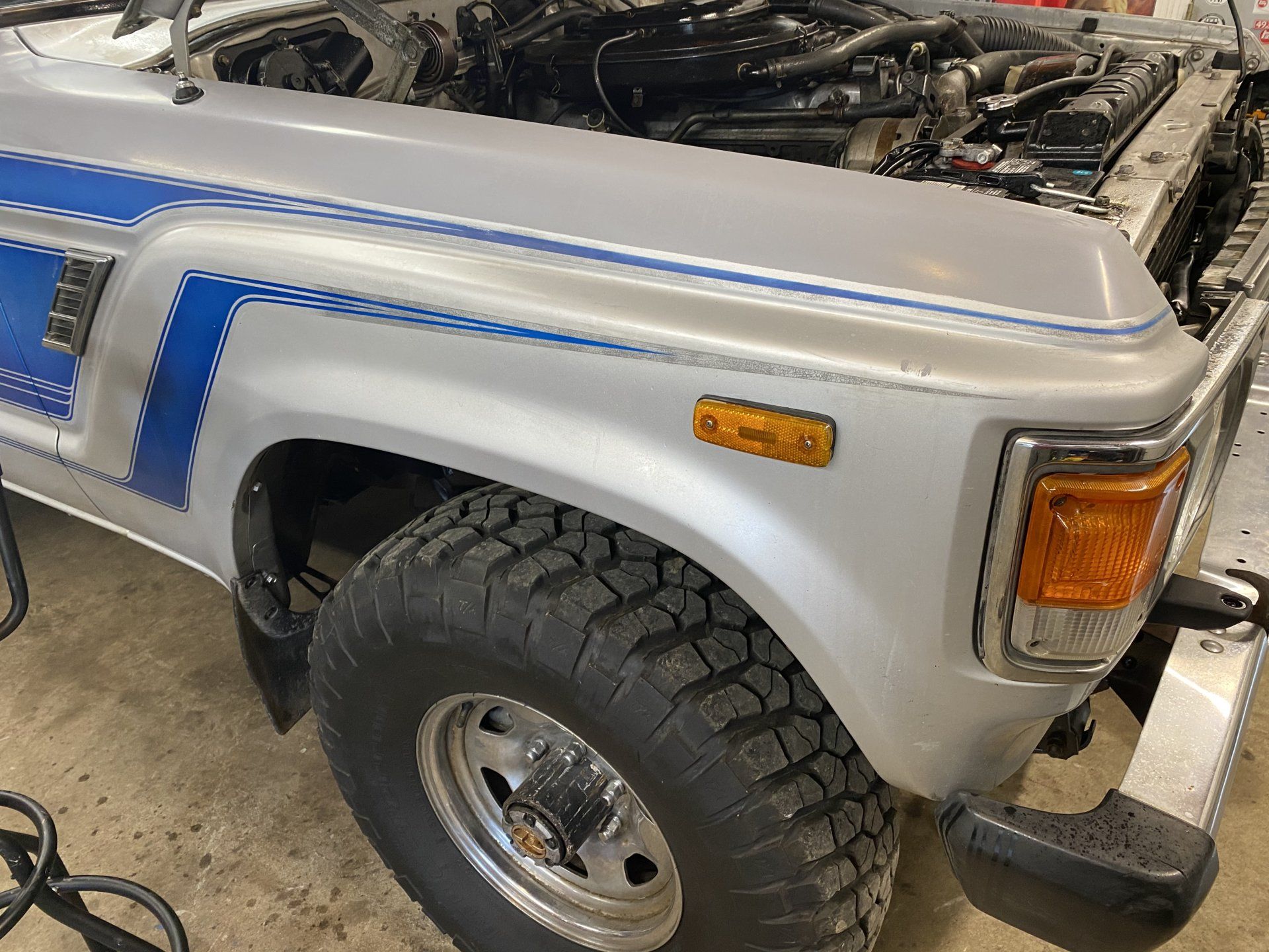

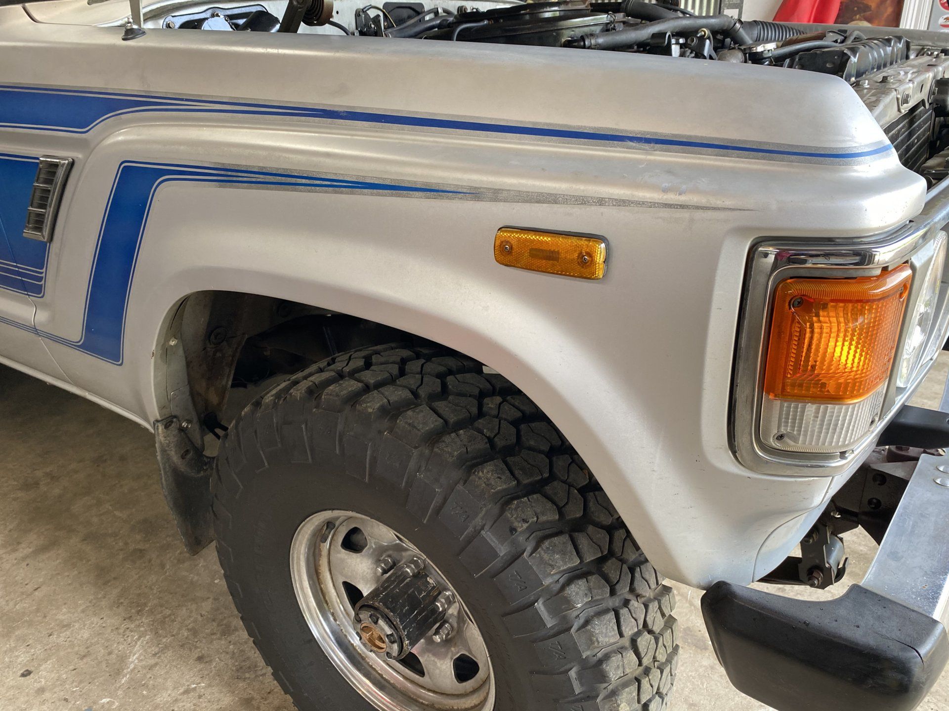

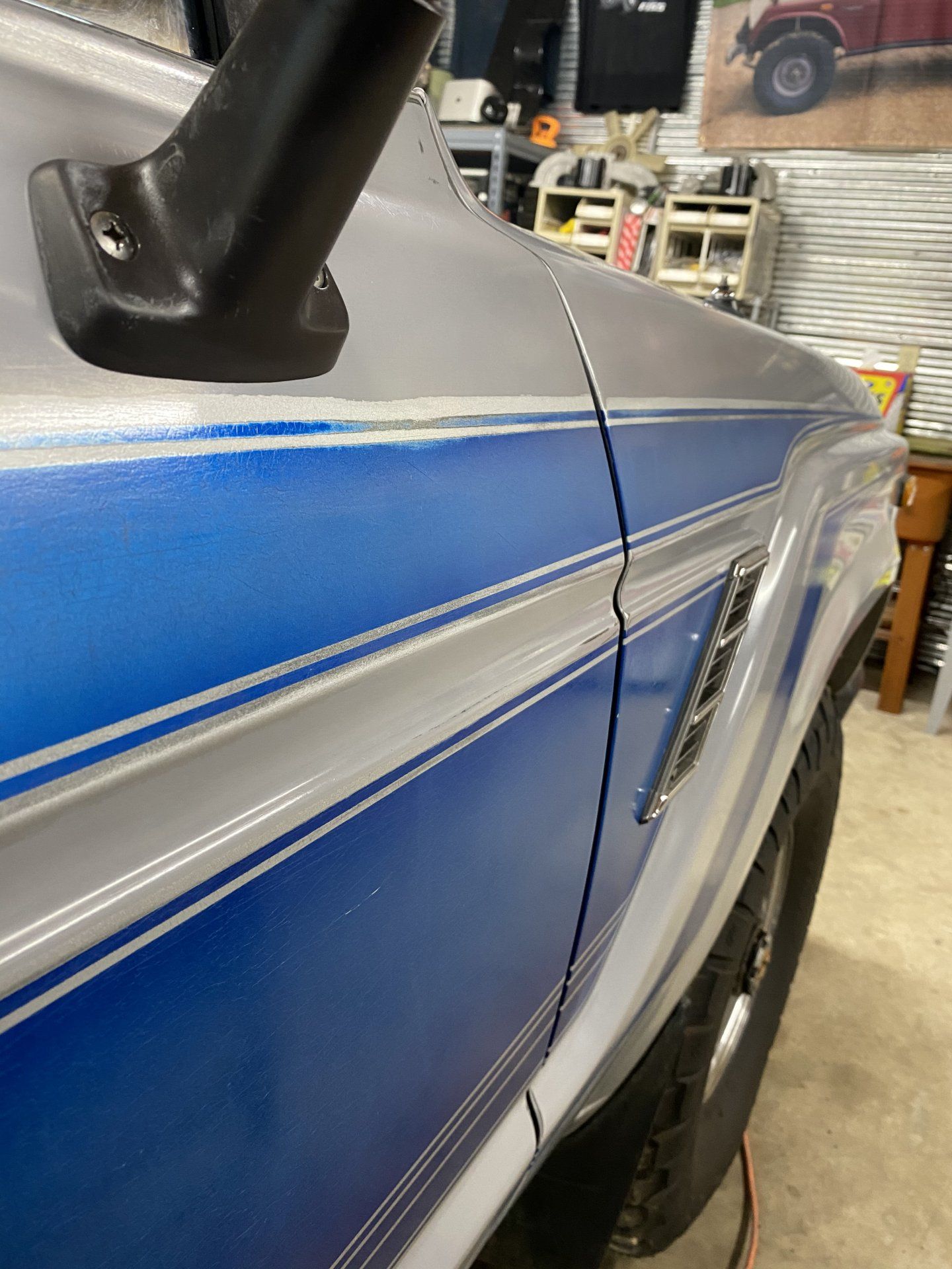

Started in on the passenger side today.
I think I’ve got a plan to blend all this together.
Forgot to take more pics but I got the whole fender done. This is before and after the top section

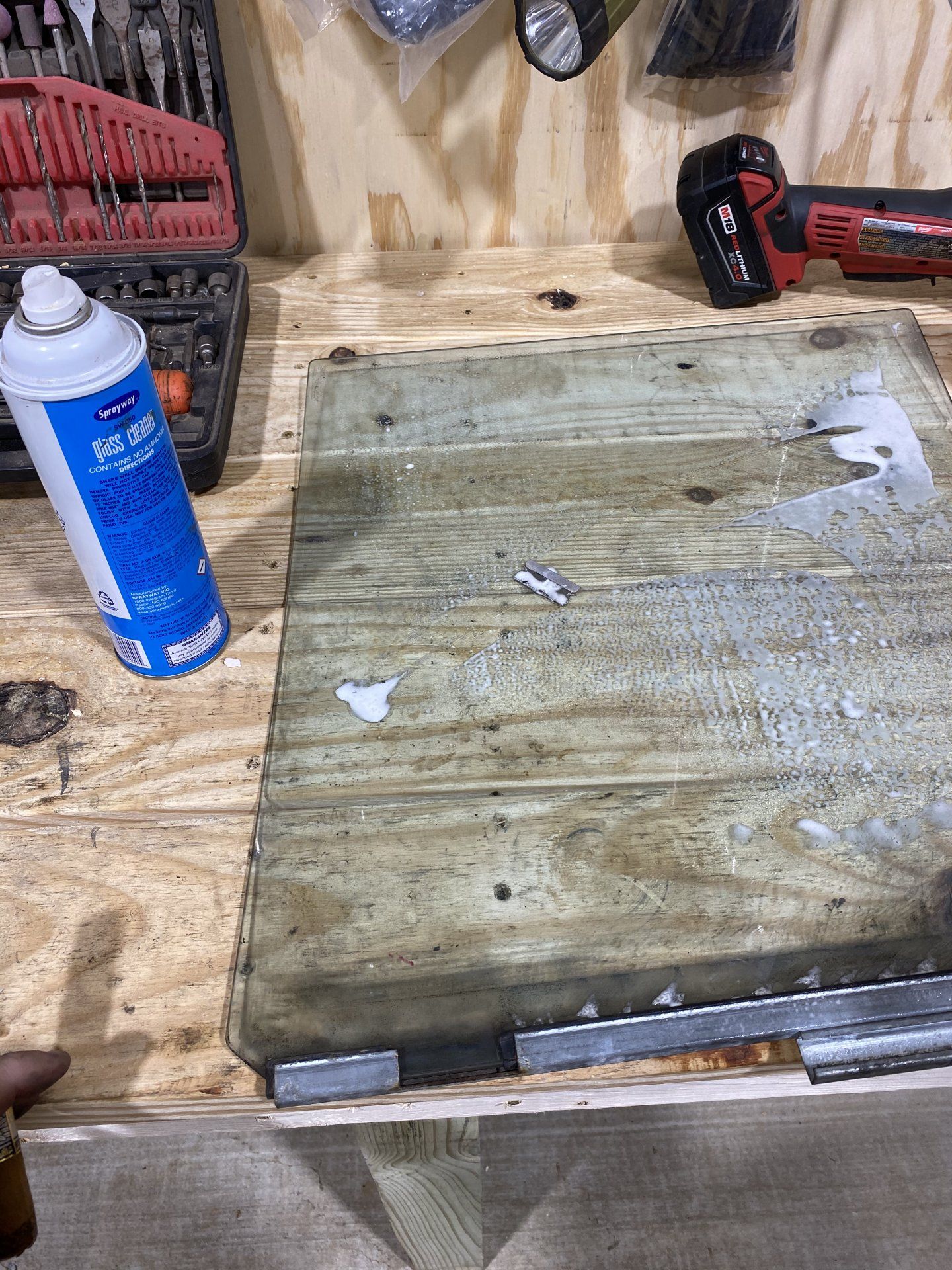

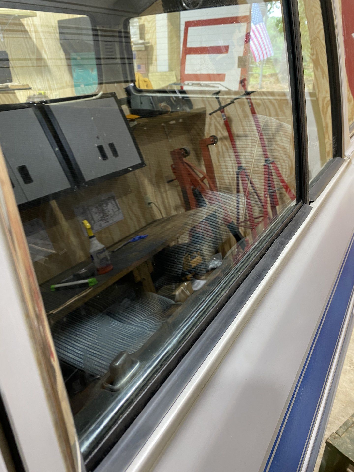

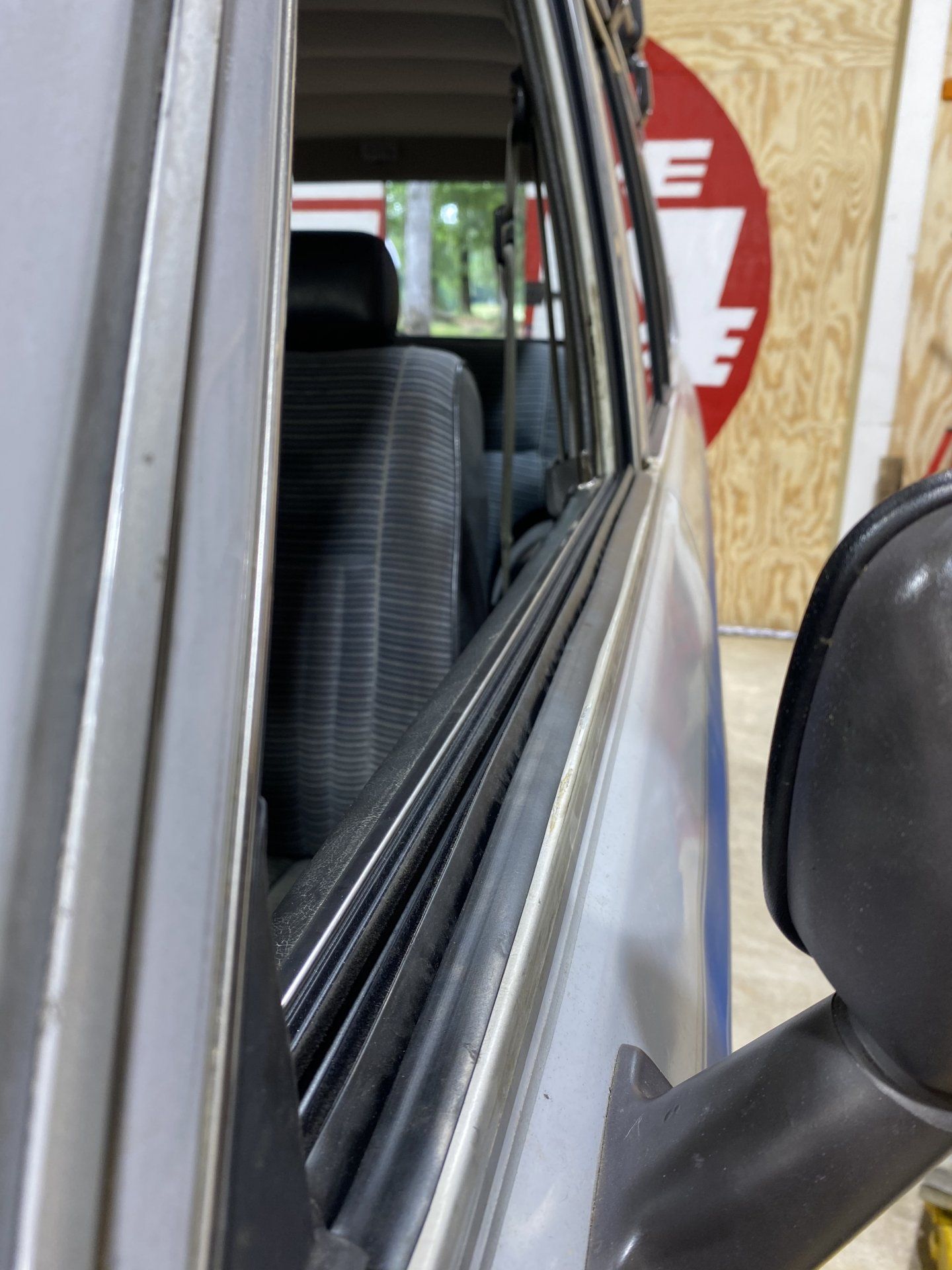

Whew. This turned out to be a big job as I’ve never had to do these seals and gaskets before.
The window chrome was messed up and the gaskets all nasty and pulled out.
Also, all the windows were sticky and pulling the runs out of the channels when you rolled the window down
Out all the glass comes. Razor scraped and the regulators are hit with some Toyota chassis grease and the sides filled up with Fluid Film on the bottoms and Noico on the sides.
Beno not only sent me the superb OEM gaskets, but he also sent me a link to the FSM.
There is an order all this has to go in and if you don’t know that order you might bash your head on the floor for :30
The bottoms of these doors are amazingly perfect. I just blew out some junk and made sure the drains were good to go and put a light coat of fluid film on them.
In the end doing all 4 doors with all new rubber and pulling the regulators and using Toyota chassis grease (also from Beno) took me all day
He also sent the proper battery hold down hardware.

Check the timing first. If it’s ok, check the idle control solenoid. Either it’s bad (it should click when you turn the key on) or the gasket at the end is bad.
I finally got R2D2 back in the shop. It was sitting at 18* at the BB :eek:
Dropped it down to 0 at the BB and it drives great. I’ve not put a long ride on yet to see if that killed the diesel but I’m confident it will.

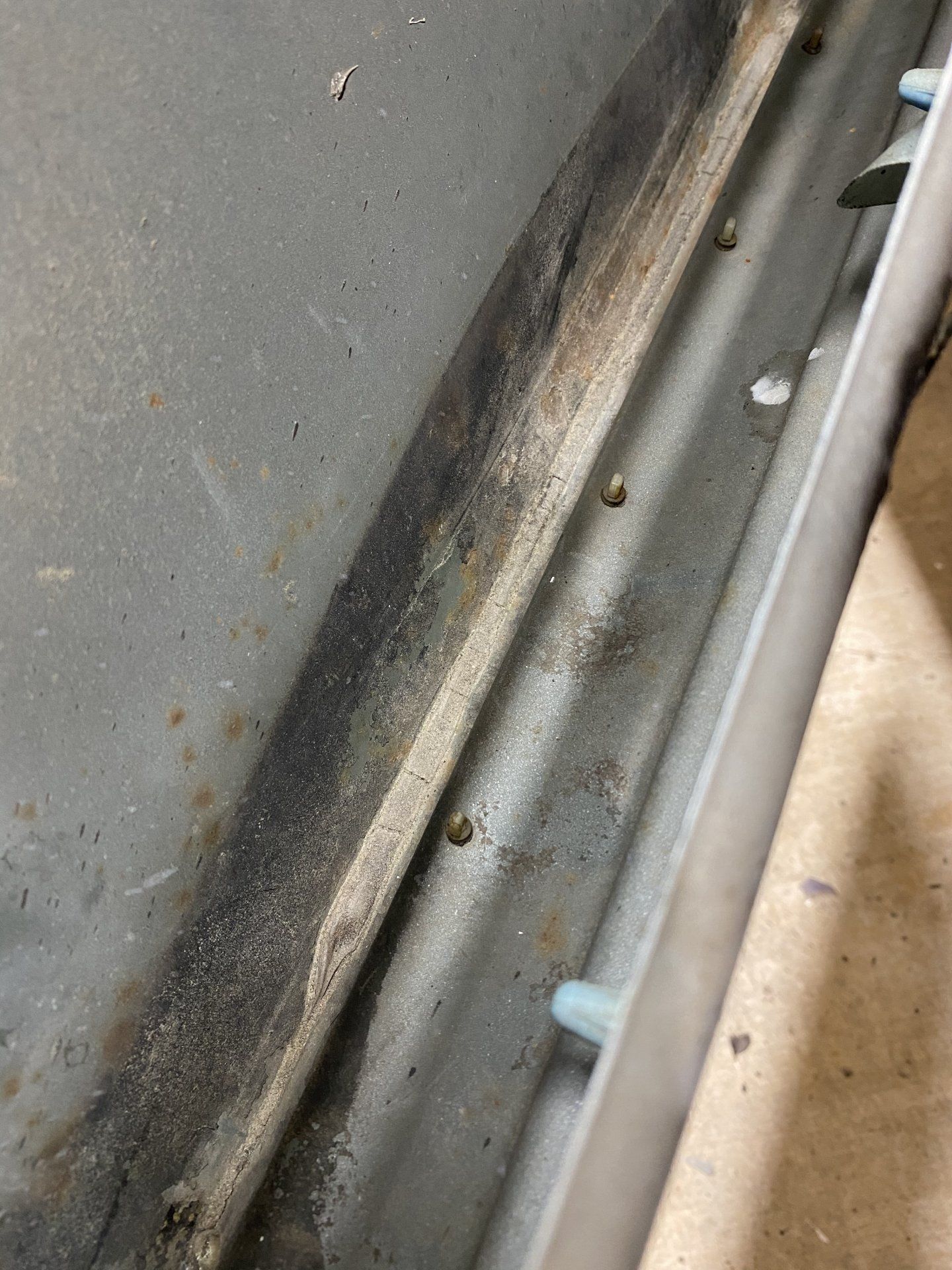

It’s amazing how much harder the passenger side is going versus the drivers side. My painter said that’s pretty common on vehicles that sit outside for years. One side often gets direct sun and the other side does not.
Coming out good in the end but it takes a lot of work.
