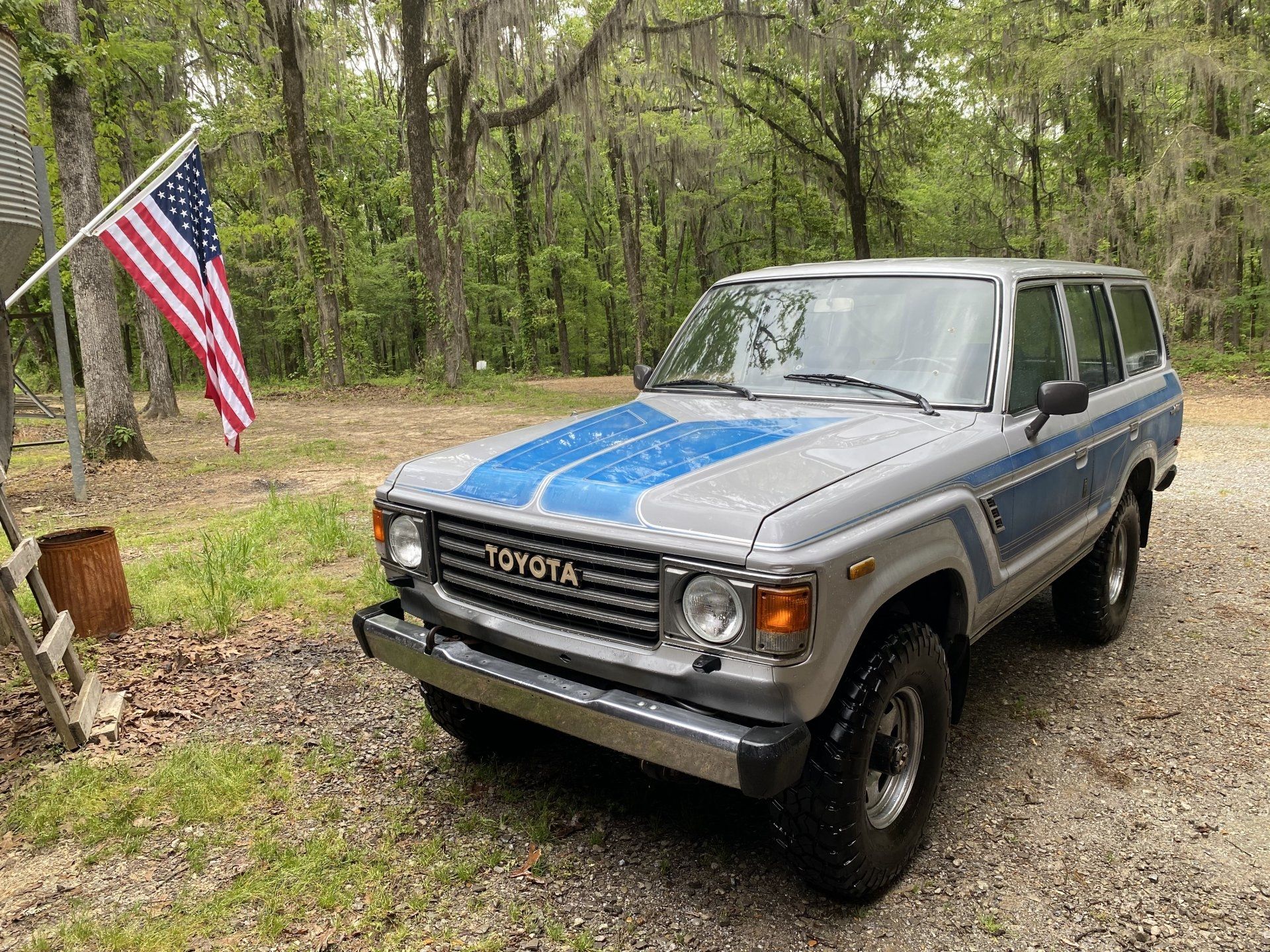

R2D2 has been sitting in the corn crib lot for 2 months. I was fully expecting it to be graveyard dead after the week of stupid cold weather and being ignored for so long.
I have a free day to work on it before I get back on a FJ45 I’m working on so I got it nice and clean so I can start picking my way down the line

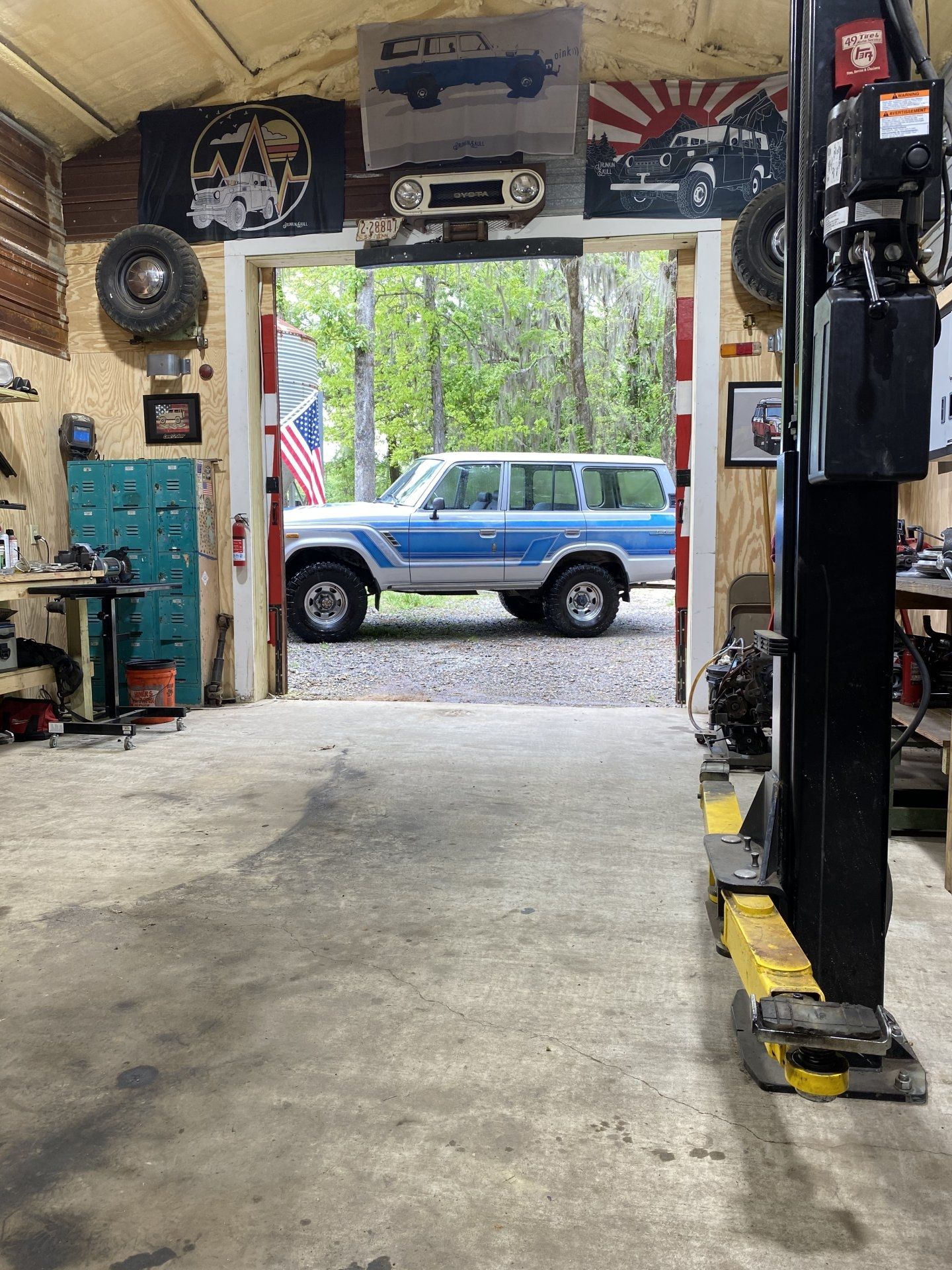

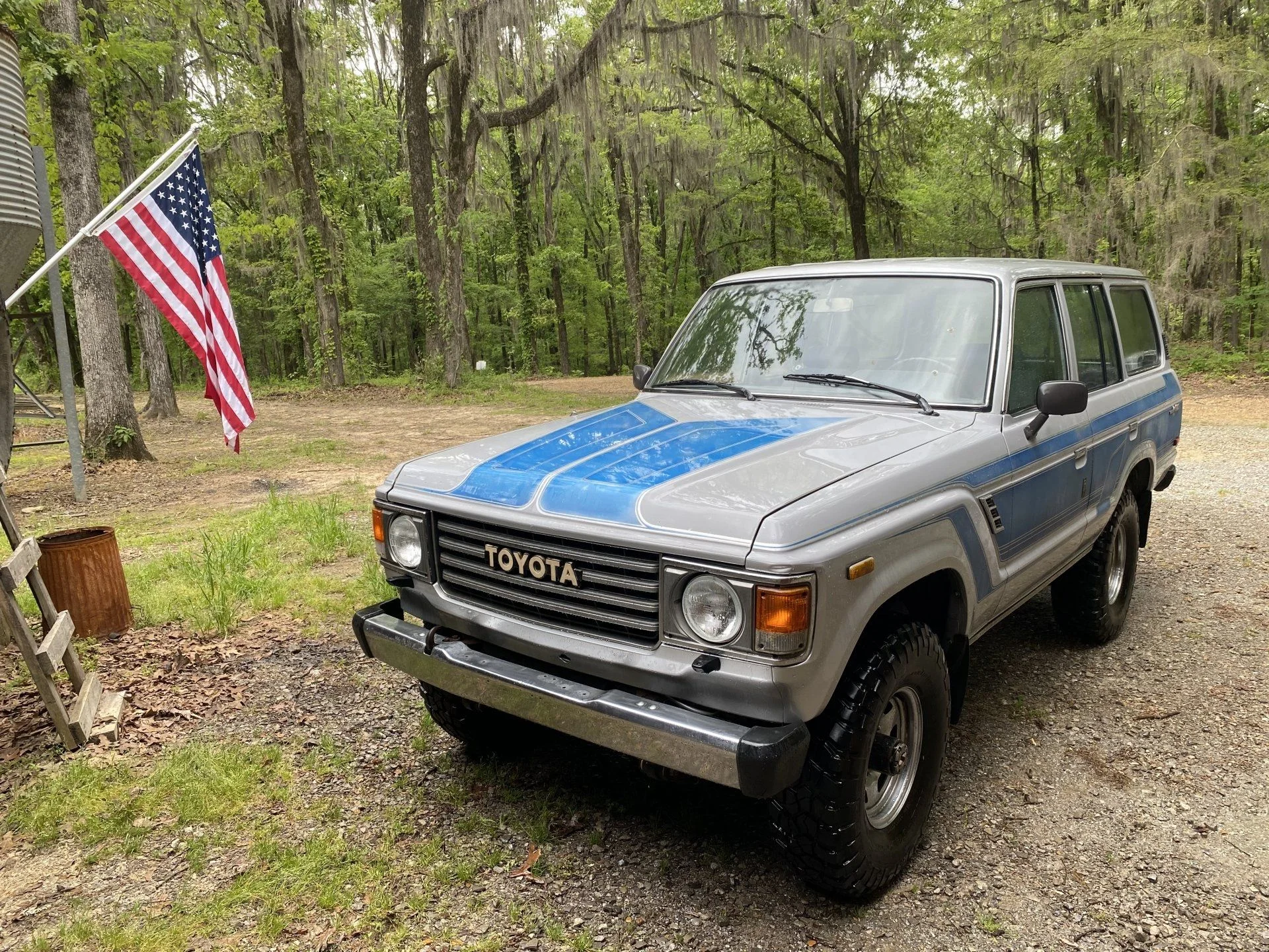

Gangster. Then, at least one pic, with striped 'ol Blue and R2D2 in the frame together.

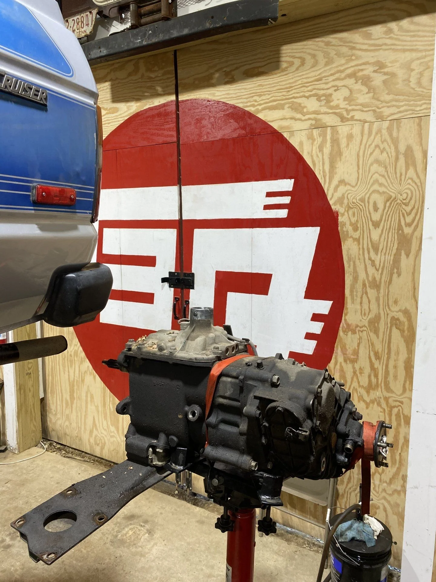

Drained all the fluids and sent them packing in the Smudge pot

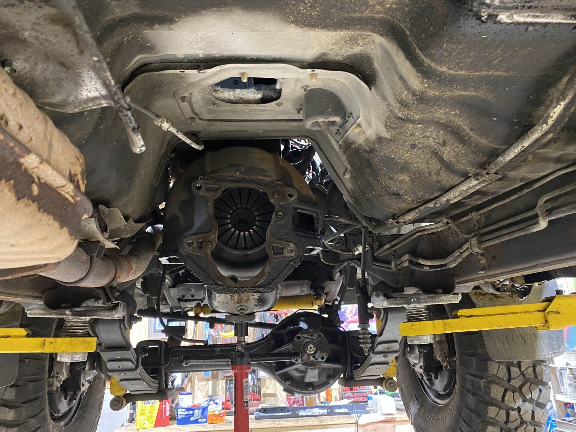

Pulled the shafts and skid and went to town pulling the driveline out.

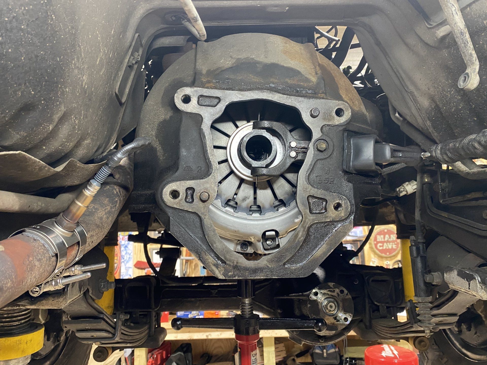

Buttoned up the clutch job today. It was shot. Glad I got it done.

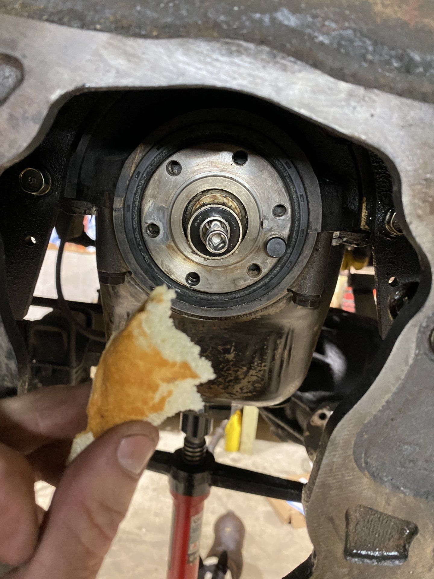

Busted my slide hammer pilot bearing puller and had to resort to the bread trick. I had to resort to the bread trick and it took almost an entire Hawaiian hamburger bun 😬

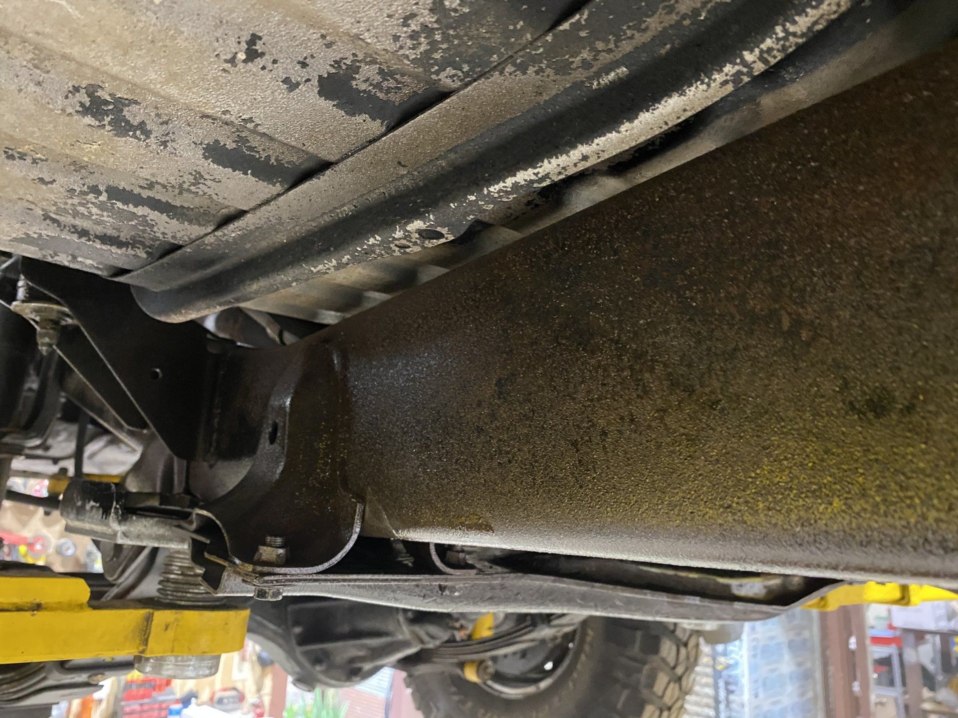

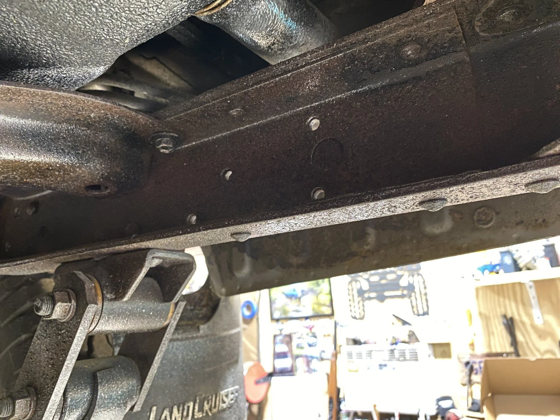

The underside was cleaned and got a liberal coat of Fluid Film to protect it from the Yankees
While I was in the air I added the O2 sensor.

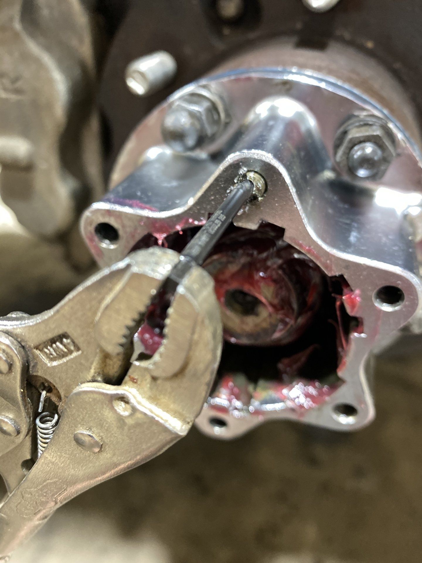

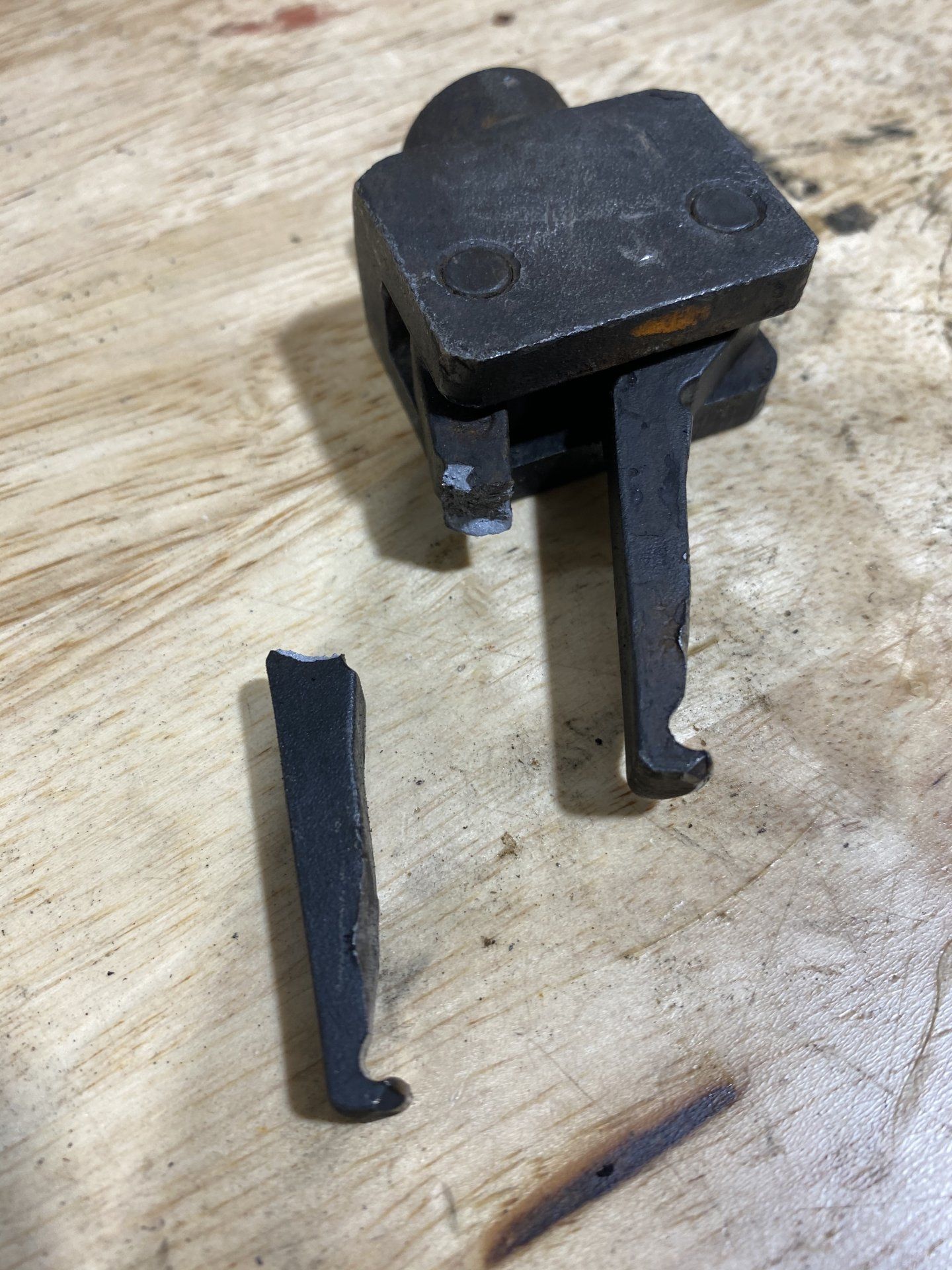

you have luck or skill. I am 0 for 5 with the easy out. I am 2 for 3 welding a new bolt/nut on.
100% luck. That’s the only small one I could find. The rest of the set was snapped off

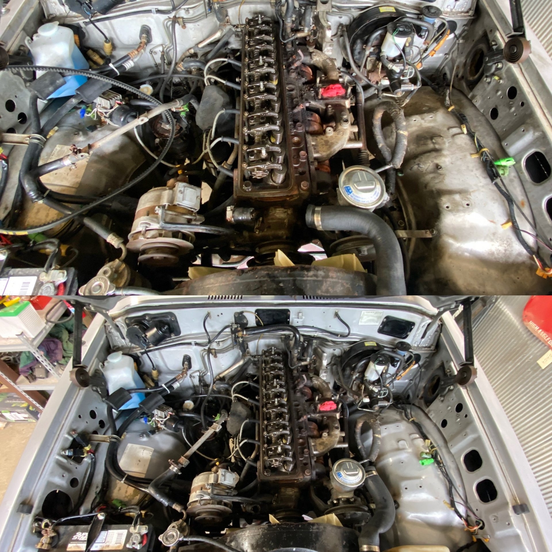

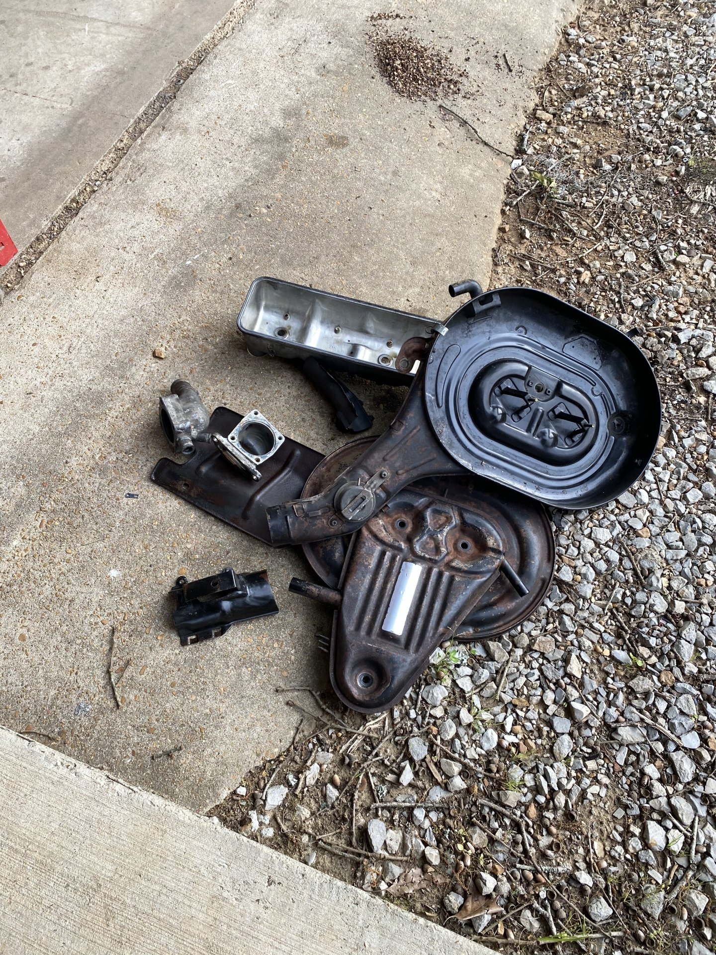

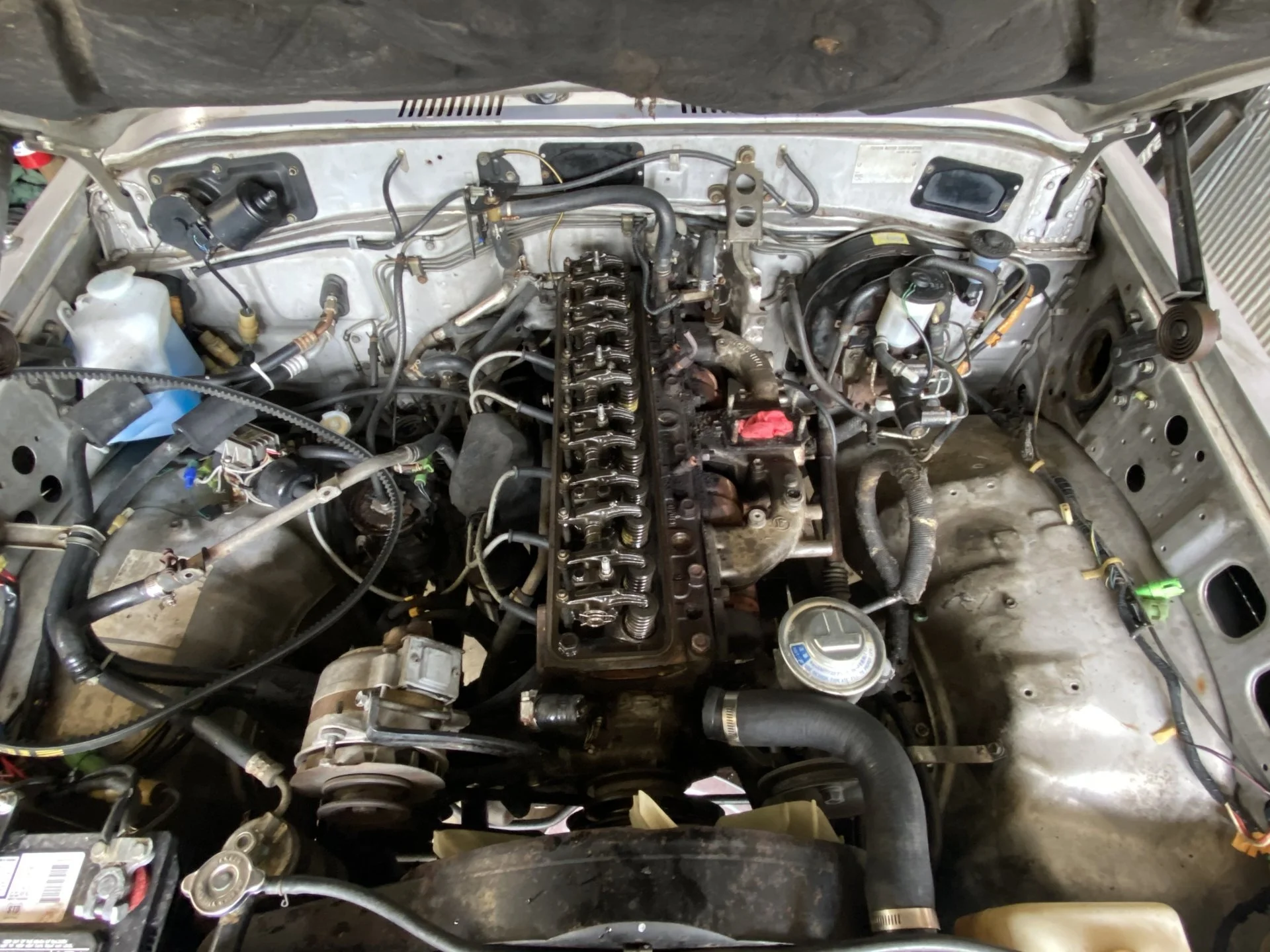

Desmog/Sniper has begun.

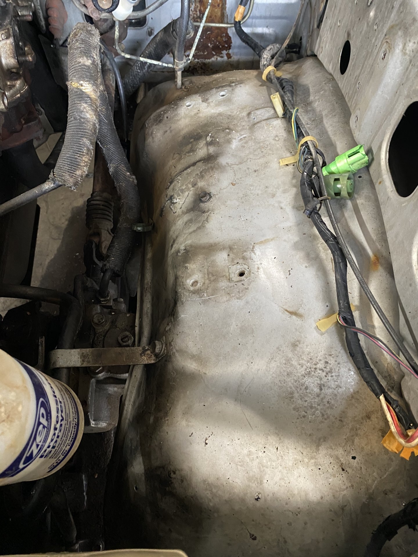

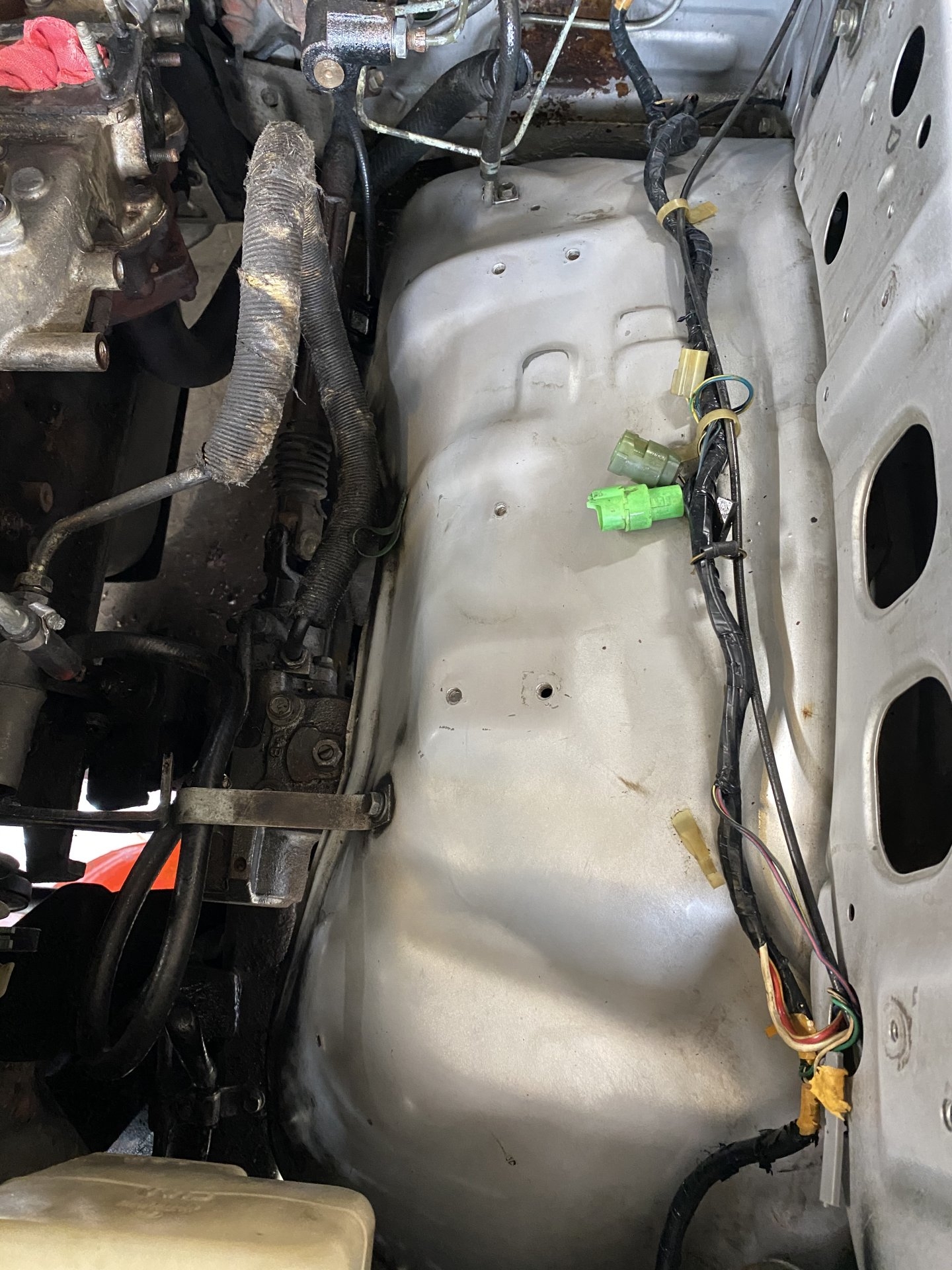

I blasted the engine bay as best I could with my pressure washer then went to work getting all this crap off the motor.

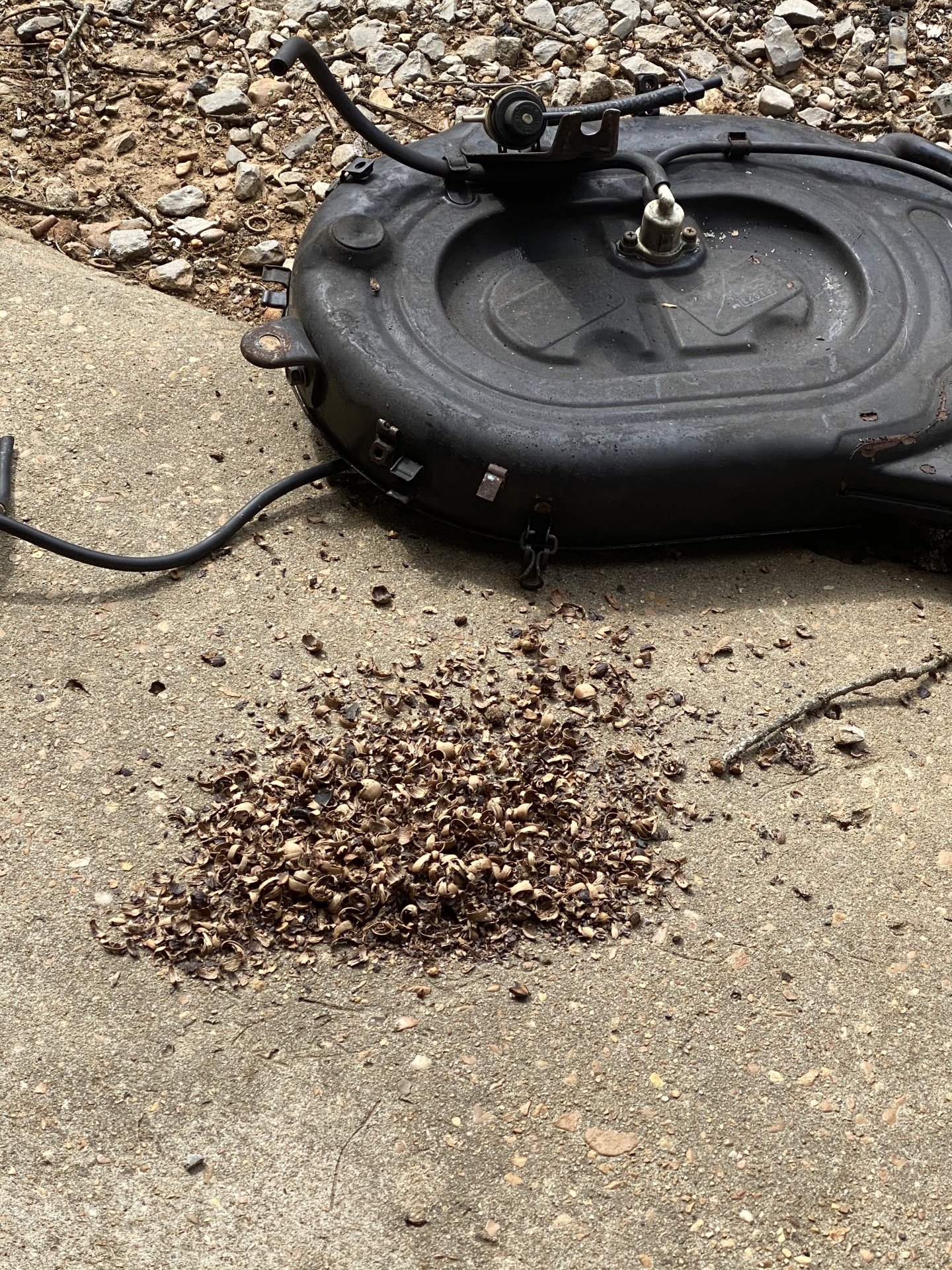

A mouse had lived in the air cleaner this winter.
I’ve got it down to where I can clean it up more. It’s amazing how much room you get under the hood without the smog crap
This pile goes off to Powder Keg tomorrow
