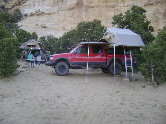

OK, so in the introduction of my build thread I explained the build plan based on the intersection of my wants and needs. Balancing wants with actual needs can be a foggy proposition, with some items clear cut and others not so much. As I started brainstorming the 200 build, I spent a great deal of time pondering my 100 Series and my Tacoma build before that. While I've had other Toyota's before and after those two, they were my main go-to vehicles and I'd put thousands and thousands of miles on them on adventures. I made a list of the things I would want in the end-all build and then prioritized those items from top to bottom. I do feel it is important to point out that I do my best to choose parts not because I sell them, but rather I sell them because I choose them personally. At that you will note that many of the parts come from a select few manufactures, all high quality offerings with a solid reputation in the industry. This isn't to say these are the only best options, rather I'm hoping my selections will prove the best option for my build.
The previous chariots I based my build plans off of:
2004 Tacoma

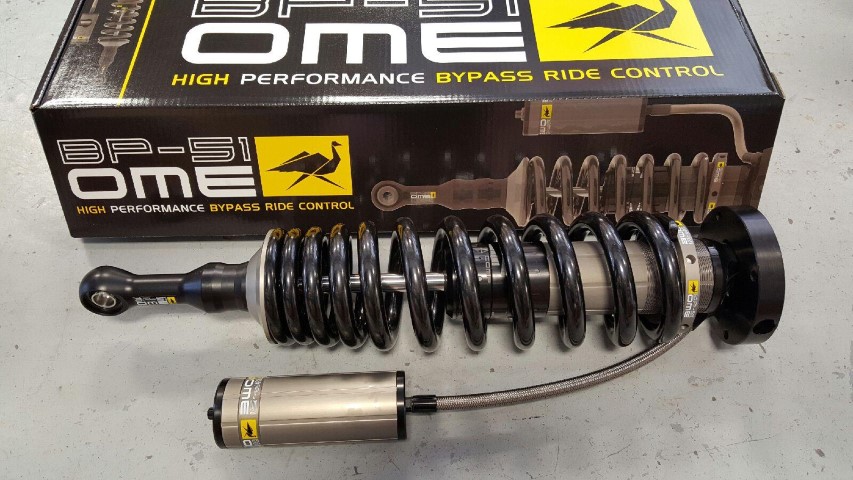

Old Man Emu (OME) Suspension - Ride quality, load capacity and vehicle height would all need to be adjusted with this build. I've put hundreds of thousands of miles on OME equipped Toyota's on 5 continents, I'm sold at this point. Other satisfactory options exist but for my planned uses the Old Man Emu setup is truly the best of breed in terms of performance, longevity and reliability. I was 100% resolved on installing the tried and true Nitrocharger Sport struts and shocks along with the OME coils appropriate for my planned weights. But, there is a new kid on the block... BP-51. I had heard long told rumors of OME's R&D on a new performance suspension, replacing their LTR systems that were around when I first started selling Land Cruiser parts in the late 90's. Finally at the 2014 SEMA show last fall, I was able to see a BP-51 prototype and discuss the product line with the engineer behind them. The BP-51 gets its name in two parts, BP for the bypass design of the shock and 51 for the 51mm bore on the shock internals. The fronts strut/coil assembly are fully adjustable height and both front and rear feature a remote mounted reservoir for additional oil capacity. You can get a full download on the details of the BP-51 lineup here. They are still very new on the market and with anything new you take the risk of it failing to meet expectations or just flat out not working but I'm up for some testing and with customers already inquiring about them... I had better get some experience with them. For the front I went with the BP5190003L & BP5190003R assembled struts (include coil) along with the KDSS specific VM80010003 fitting kit which consists of mounting brackets for the remote reservoirs. For the rear I went with 2 x BP5160003 shocks and the matching VM80010005 fit kit, again consisting of mounting brackets for the shock reservoirs. I chose rear 1" lift coils, whereas the front is a 2.5" lift, this will level the vehicle substantially. Along with the new shocks/coils I'm planning the use of the Light Racing (SPC) Upper Control arms (SUS25465). I'm a big fan of their sealed ball joint and their use allows 4 degrees of additional camber adjustment and 2 degrees of camber adjustment, thus even with a tall front end you can get your alignment specs withing tolerance and have a beefier high travel ball joint. We've been installing these on customer trucks for many years and have been completely satisfied with their longevity.
