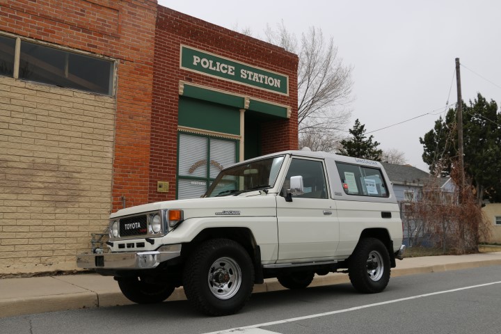

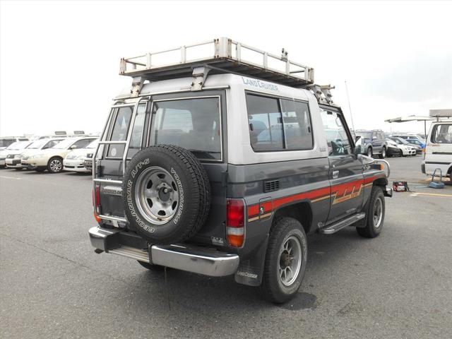

Project LXXIV as she sat in port awaiting transport to the US earlier this year
Check out all that chrome :D
That will clean up nicely!

Purpose/Scope: The purpose is straightforward, build a simple yet highly functional Land Cruiser while highlighting the JDM platforms. We have partnered with LandCruisersDirect.com to source these and other models and will be using this particular BJ74 throughout the year at various 4x4 events as a showcase of both their vehicle platforms and our product offerings. CruiserOutfitters.com is in the process of adding JDM specific parts to our growing inventory and we are now stocking parts ranging from tune up items specific to the diesel power plants to suspension and weatherstripping for these non-US rigs.

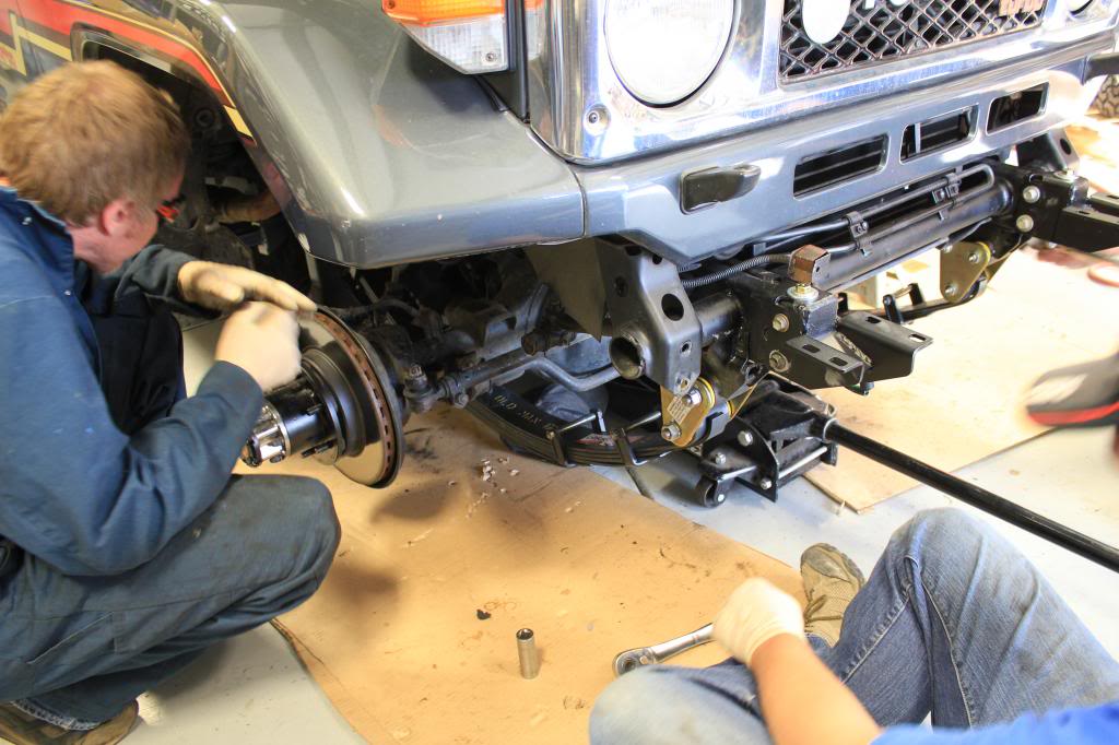

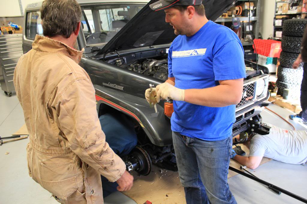

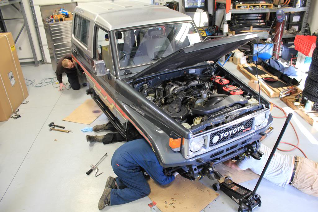

With that all said, it's time to get started on this build... after all Cruise Moab is next week! Thankfully I'm able to put the call out to my pals in the Wasatch Cruiser club and we'll have some ringers here tomorrow to help rock this thing out in Death Star fashion. Pics to come!

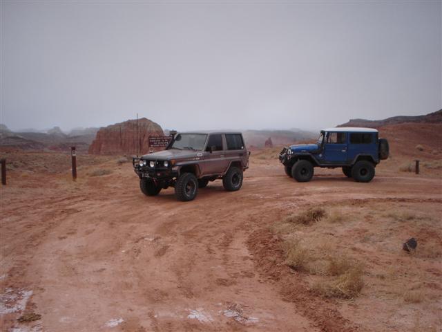

I am currently in Moab wheeling my BJ74 and my biggest complaints are:
1) Lack of gearing - the stock t-case is just to high for technical wheeling.
2) Suspension - simply not enough travel or flex in this setup.
3) Front shackle movement - The neoprene bushings allow way to much side to side movement.
4) Axle width - I really don't like how narrow the axles are for the height and weight of the vehicle.
I can't wait to see what you do with your build

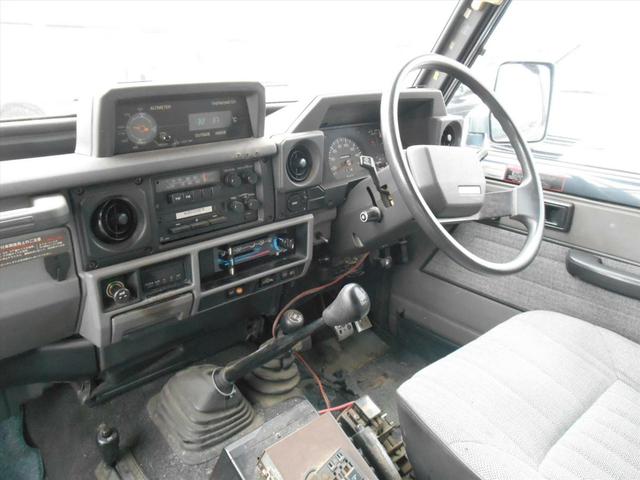

Nice find ! The roof racks a bonus. What are you going to do with the PTO,looks too cool to remove and its a great conversation piece?
4) Axle width - I really don't like how narrow the axles are for the height and weight of the vehicle...
All easily resolved with some upgrades you know :D
For example, this is my good pal Craig's BJ70. Low-range t-case gears, SOA with OME, tons of suspenstion travel. Poly bushings are tight and FJ60 axles for the width :cool:
Roof rack and PTO are gonzo, they will be saved for another project (we have 4 7x's here at the moment). The rack didn't make sense for this builds uses and the PTO winch was pulled in order to get a better approach out of the front bumper. We have a BJ70 here with the factory PTO and a custom front bumper that actually offers a fair amount of clearance but I had some other bumpers in mind. Fwiw my goal is to be able to offer customer a polarized viewpoint, I've got a 100% bone stock 88 BJ74 (auto) that I have had for several years, we affectionately call it "Righty".

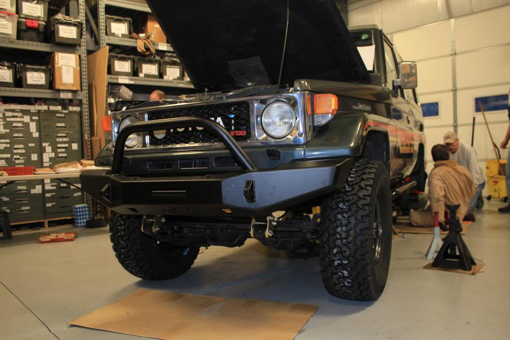

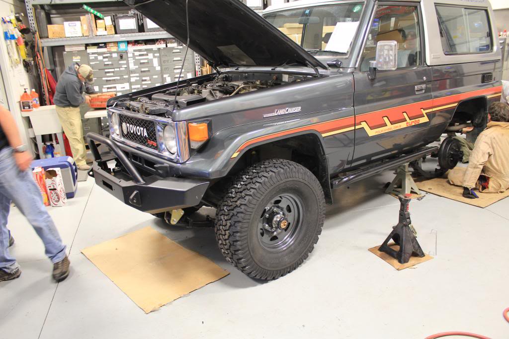

I'm bummed the Kaymar wasn't going to make it in time but we installed the ExpeditionOne prototype rear bumper tonight along with the other goodies. My good friend at ExpOne contact us a few months ago about borrowing a 70 Series, we let them take one for a few weeks to mock up bumpers. I'll use the Kaymar and ARB front for the next build project we have lined up in a few months that is going to maintain a true Aussie Outback look :cool: The Kaymar is an absolutely a fantastic bumper and it has some neat features this prototype doesn't have but this bumper turned out really slick and I'm excited to have more options for the market.
