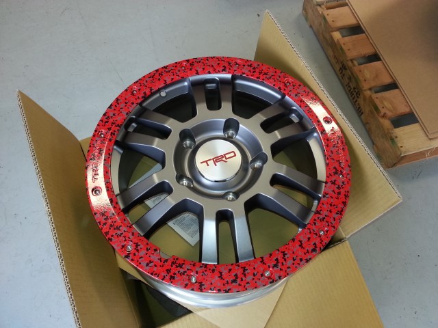

Project numero uno was getting rid of those nasty 22" wheels in favor of something more appropriate, like a lot more appropriate. The TRD Rock Warrior wheels feature a removable trim ring, some call it a bead protector (let me be clear it is not a beadlock), I call them beauty rings. You can either run them in their native bare aluminum finish or paint or coat them to a different flavor of your liking. Not if but when they get rock rash, you can remove them and re-coat, ensuring a nice finish for years to come. I opted to have mine power-coated with a little bit of flare, hydrographics. One of our local powder-coaters (Armor Coatings) is offering some neat hydrographic options which is basically a decal that is applied over the top of a powder-coated piece and then clear coated to lock the graphic into place. It has some really neat potential and adds a neat aesthetic flare, not typically my flavor but I figured this 200 needed something to make it stand apart from the other Sequoias on the road. ;)
We decided on a candy red powder finish with a black/grey digital camo hyrdrographic. A few days later they had them finished up and I rushed over to check them out. I must say I was super happy with the end product. Again different and not for everyone but I dig the flare and if my appetite for them wears in the future, I know a sandblast and powder-coat guy. :D

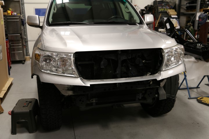

While the front suspension was coming apart for the suspension, the stock front bumper was coming apart as well. The 200 Series ARB winchbar fitment requires reuse of the upper portion of the front bumper cover. This allows for a tidy look and a winchbar that doesn't have to have an awkward top deck trying to match the curvature of the fenders, headlights, grill. We called it a day with the completed suspension and I picked up on the bumper install a few nights later that week. In the meantime, I needed to get some rubber installed. We work closely with our local Big-O, they've been taking care of our tire and alignment needs for the last 10 years and I can't say enough about their solid service. The mounted up the tires and those 22's were a thing of the past... finally.
Trimming the front bumper isn't much of a task with the supplied templates but as always, measure twice, cut once. A paint matched front bumper cover isn't cheap, measure a third time. I used masking tape to mark the template cut lines as well as protect the finished pieces that will be utilized to finish the install. The plastic cuts really cleanly without much effort and any exposed edges finish off with an edge trim included with the bumper fitting kit.
Marking the front bumper cover to trim
Trimmed bumper cover installed

Once the wheels are installed and the bumper-mounted spot lights are on, the graphic trim pieces look incredible! I love it, very original and totally awesome!
Heh. Up close the rings looked odd to me at first...but the wider shot of the truck makes it look like a good match with the ARB red-ringed lights up front. :)
