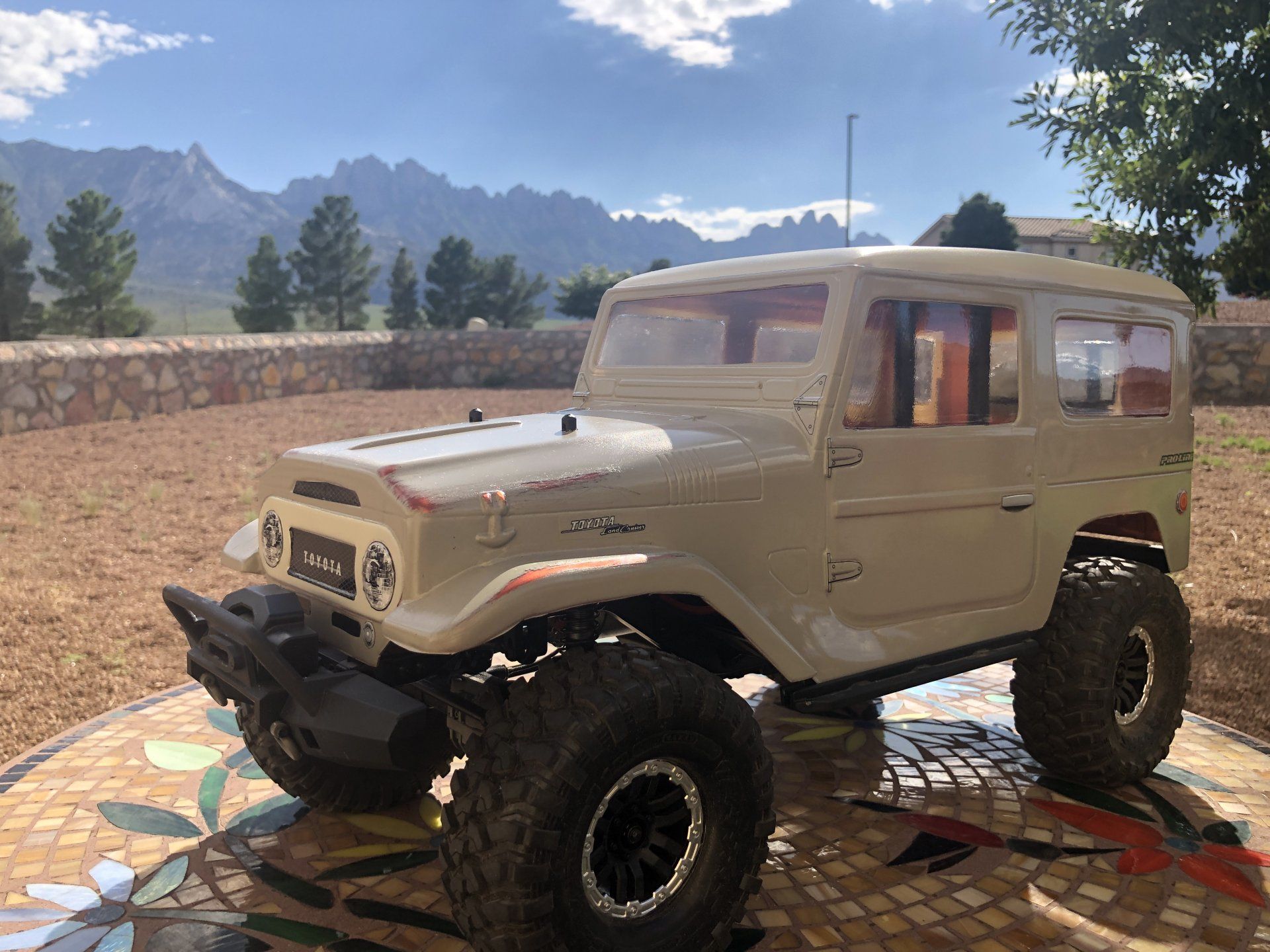

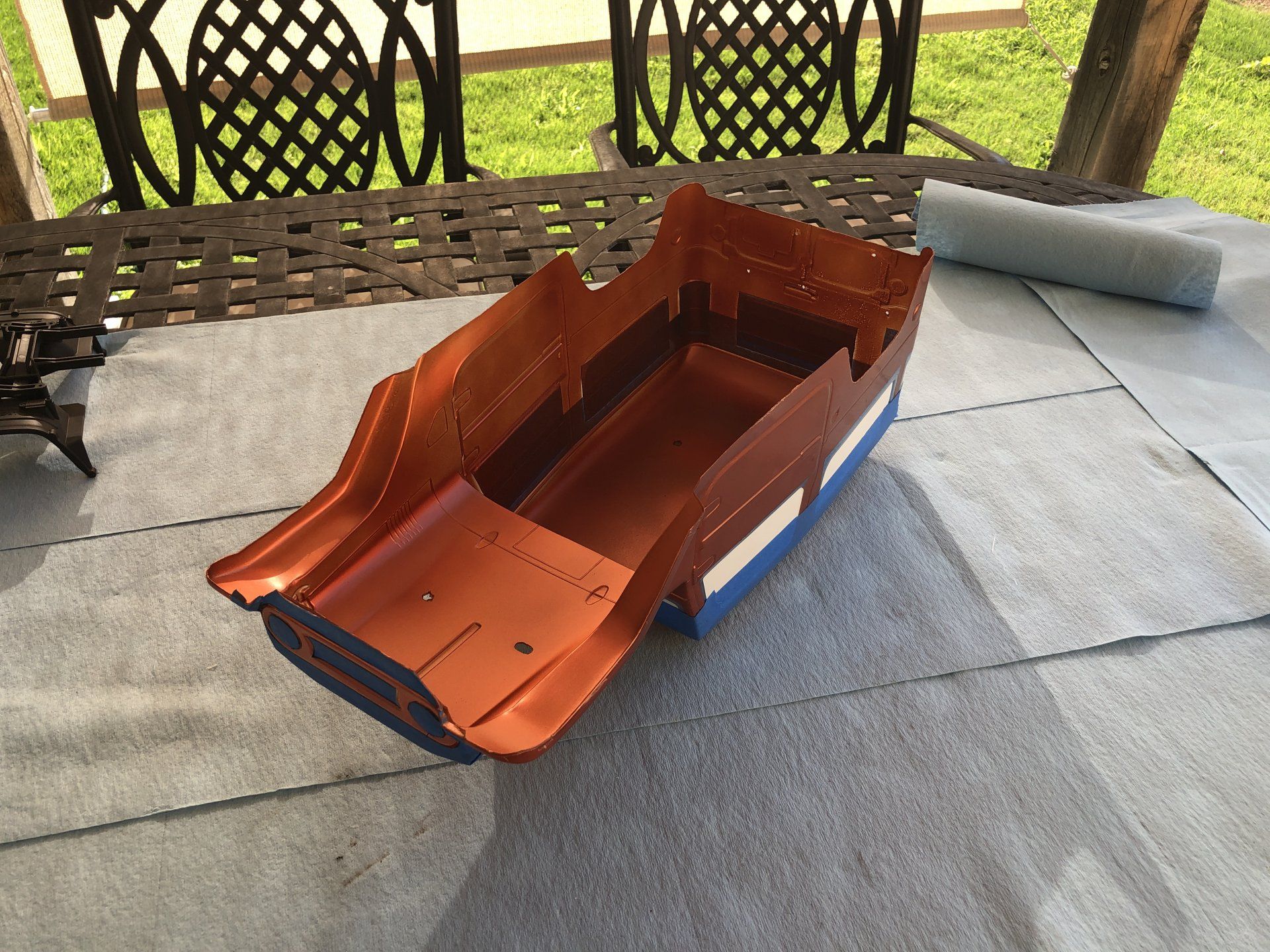

Spent the weekend building my RC 40. It’s a Proline body on a Traxxas TRX-4 chassis. Painted the inside of the body a copper rust color. Cygnus White for the top and bib, Dune Beige for the body.
Scratched up the body with a Brillo pad while the paint was still wet to give it some rust colored trail rash. I’ll probably put some white wagon wheels and a working replica Warn 8274 winch on the front.
Might also put some more trail rash on it.
I think it turned out pretty good.

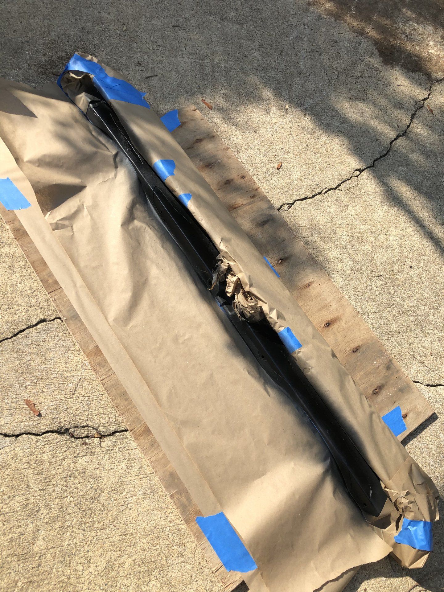

Preparing to install FJ40dash.com aftermarket dash pad. It’s a toss up for me now that I’m looking at one. Like OEM, there’s a piece of sheet metal for structural support. Unfortunately, like OEM it begins to rust right away. Took some Evaporust to clean it up, wiped off the residue w/acetone and painted it flat black with Krylon Colormax. The texture finish has inconsistencies that may annoy some. I’ll live with it knowing cracks will not be an issue.
Found a retaining bracket (Thanks @YellowJacket ). Stripper, Evaporust & now painted too.
Prior to installing the retaining strip:

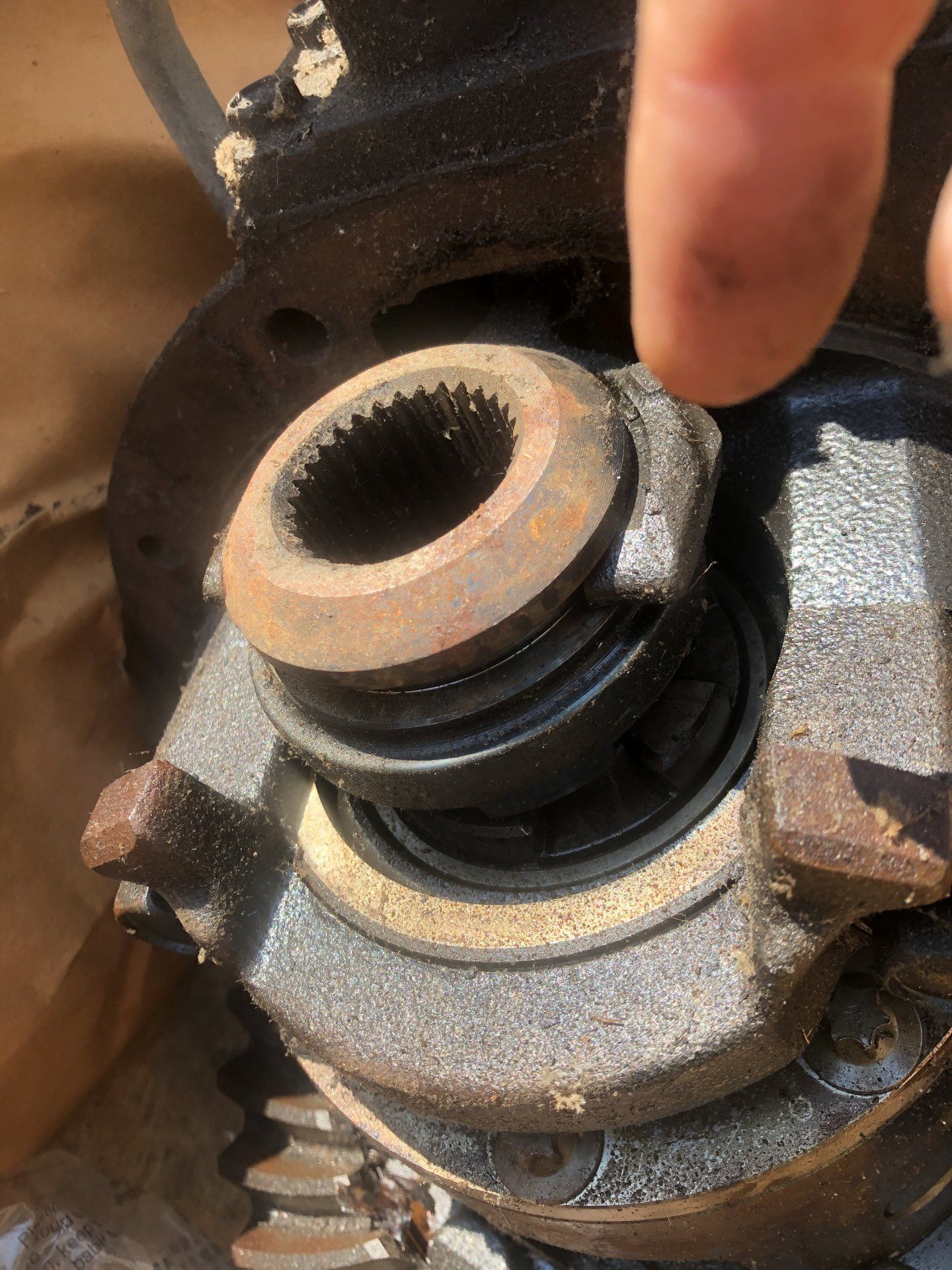

I received the elocker RCV axles and am having a problem installing the long side into the elocker carrier. The axle ends are not taper cut like the FJ70 NLA long side axle (that may contribute to the insertion problem) and it only goes into the carrier only so far. I've have to grind down the lower bell flat a lot. At least 1/8" to clear the lower side of the birf. The birf is close to the diameter of the old welded Long birfs that were in there, but somehow need a lot more clearance. I can turn the front driveshaft, but the end isn't even in far enough to be a spline misalignment before it clanks against something.
Any advice is appreciated. I've had the knuckle on and off three times, and won't reinstall until I can get the test fit into the bell/carrier to work. I know the birf itself fits, because I can fit the short side axle into the long side no problem.
Is the locker engaged? Aside from the actuator, the e-locker is mechanically similar if not identical to the cable locker. I had no problems installing the long splined shafts with the diffs locked. If your locking cog is misaligned, you could use a small pvc pipe or maybe a broom handle to realign the cog/engage the locker.

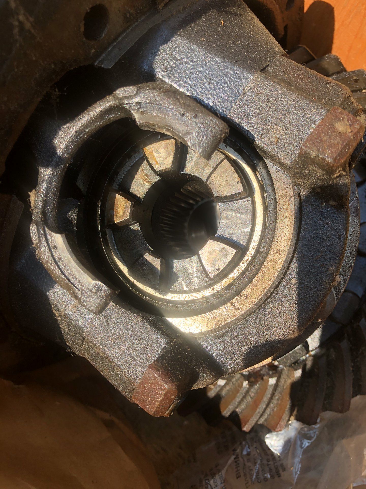

Many thanks. I had that thought way in the back of my mind, so far that it only faintly rose recently. I checked out that great thread and posted a query whether I could just turn on the ignition, then flip the locker switch to on. I wonder if it could be that easy? The thread mentions using a broomstick to move the cog. I guess they're referring to pushing it through from the passenger side and pushing the cog down/up?
I think if you see the how the cog is moved into place with the fork that holds it, you’ll understand how a disengaged locker could result in the cog being slightly off axis while the axle shaft is out. Engaging the locker beforehand eliminates this possibility and makes sure the splines are aligned too. So, there’s potential for two snags here. 1.) The cog has a bit of play while disengaged and resting on the clutch fork. 2.) the splines aren’t guaranteed to be aligned.
I have a spare cable locker and a spare long-splined front axle from a 70-series. When I performed this mod... there was no options for aftermarket e-locker/cable-locker inner axle shafts so I made sure to have a spare for the front (70-series) and rear axles (60-series FF axle). If I‘m at the garage, I’ll take a picture to illustrate what I’m talking about. You might make matters worse if you don’t know where to place and angle your aligning tool (broom stick, pvc pipe, etc). If I remember correctly, on a cable locker the cog can fall off the clutch fork completely while disengaged. The opening of the clutch fork is away from the pinion. The cog can move laterally in that direction toward the pinion and away from it.
Updated w/photos The locking cog has way more play than I thought and easily falls off the fork when the locker is not engaged.
Many many thanks for your super response. That WAS my problem. I used a length of pvc tubing to push the splined collar towards the fork. Got the axle in all the way, and managed to lock it by activating the locker on switch, then turning the front DS around and back and forth. Heard the loud click! Both wheels turned. Yahoo! The only bad thing is I stretched the marlin eco seal with all the pushing down on the axle to no avail, so will have to swap in a new one. Thanks again.
Nice @Blue77FJ40 I‘m glad you were able to get it to engage. Bummer about the eco-seal. Didn’t realize those things were so pricey.
