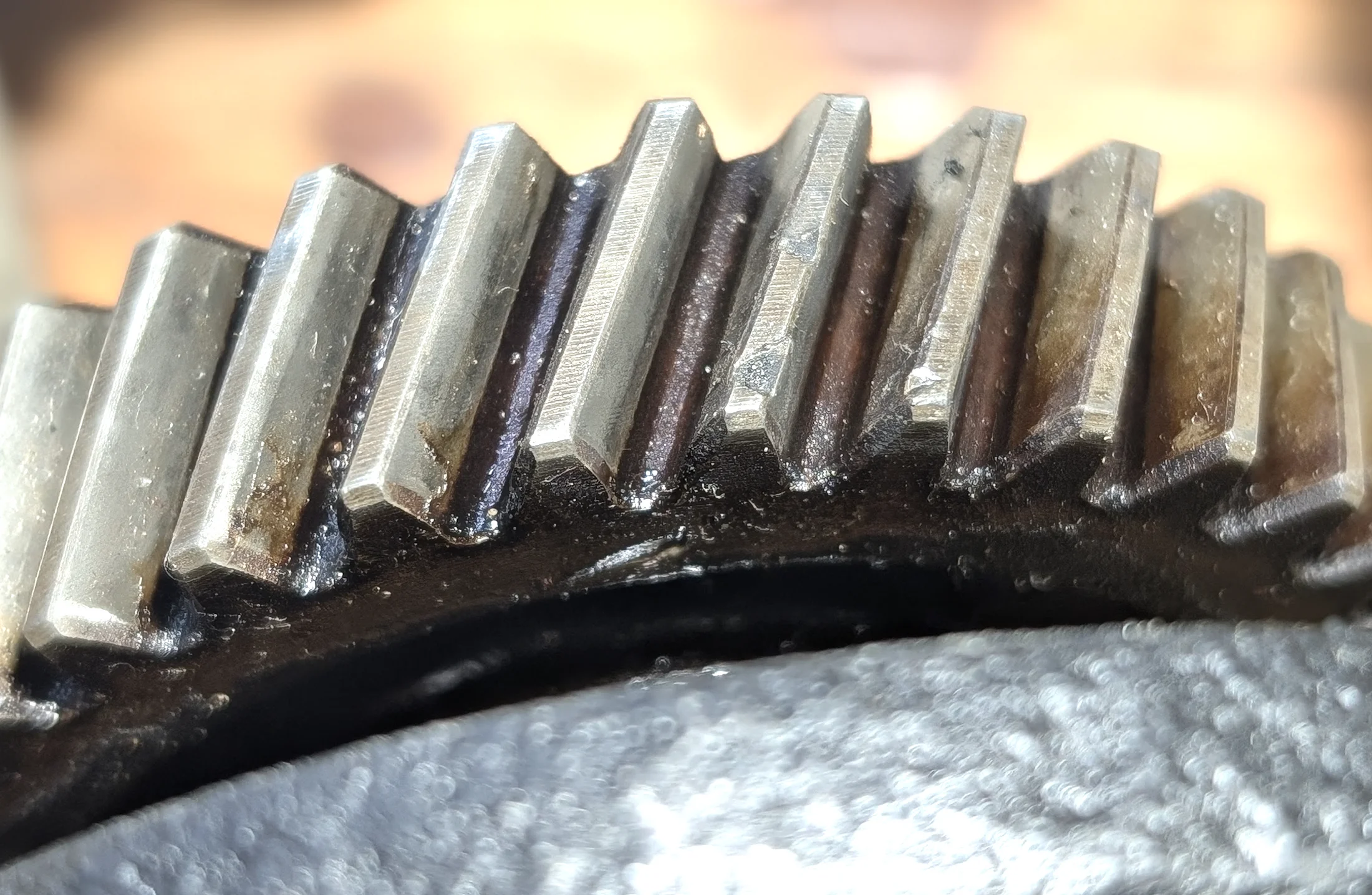

I also noticed a chipped tooth on the gear - unsure if it was already chipped or I did it it during transfer process to new pump.. We shall see if it makes noise. I stuck it in a press to make sure it's seated and I torqued to spec.

In my experience, yes that chipped gear will make noise. Joey used to sell a composite wrench to grip a replacement gear while installing it. If you do decide to replace the gear, be sure to grip it with rubber vice jaws or something non-metallic.
A nicked or chipped gear will absolutely make you think the truck has a rod knock.
Even the smallest defect is enough to make a foul-sounding noise.
I think the gear is still available new, or at least it was when I last did this. Honestly getting a new gear isn't a bad idea in any case since it can be a lot of faffing to move it over.
Yes, the gear is still available. As long as gear removal is not ham-fisted gear damage is unlikely.
If you want to go with a new gear, do remember to get a new woodruff key and shaft nut as well.
