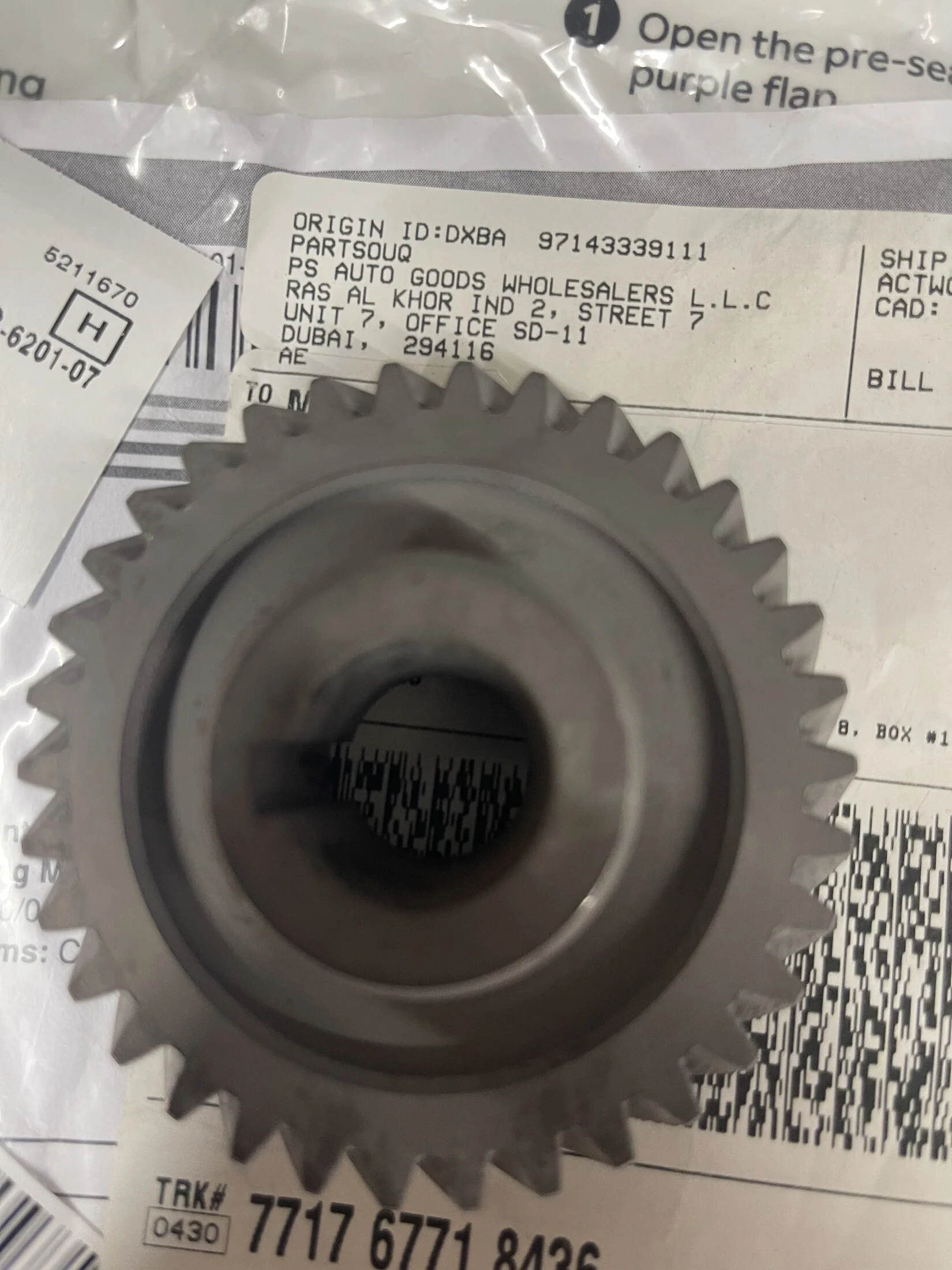

Arrival of the new PS pump gear. I continue to be amazed at the speed Partsouq ships. Dropped at my door at 830 this morning. Left Dubai last Wednesday evening.

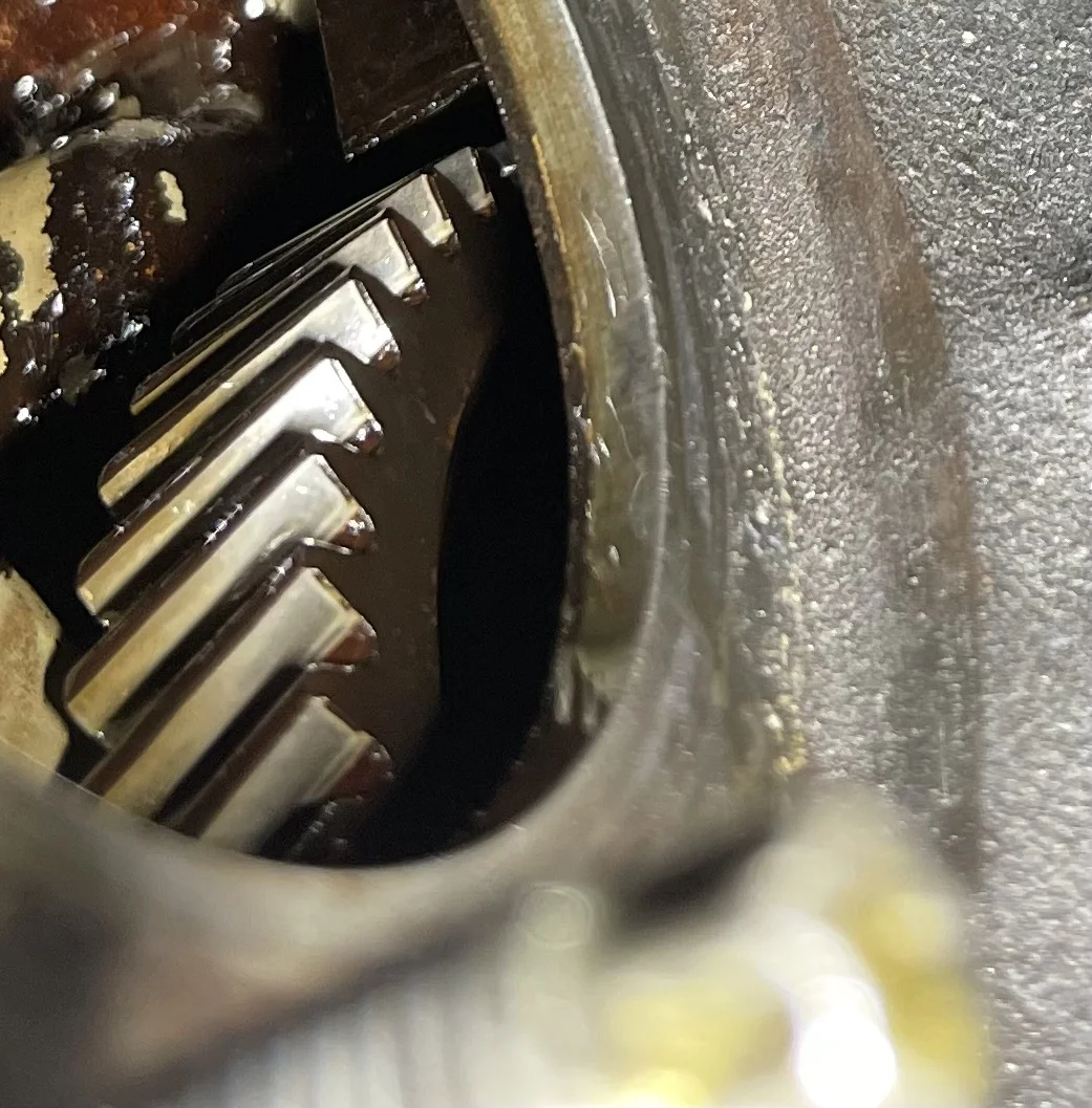

I sure hope this fixes the whine. If it does not, I guess it must be the oil pump gear which to my eye, also looks to be boogered up when I stuck my endoscope down there - BUT, with the PS pump pulled out of the block, the whine is gone. I guess at the least, if the whining sound is less, I will call that a win.
I'm wondering if the depth things are meshing is incorrect for some reason since I have a whine and everybody else with boogered up PS pump gears gets a tick. I'll keep you posted when I install it today after my worky job. FINGERS HEAVILY CROSSED.

Got everything buttoned back up and paced nervously around the truck for a bit and just finally decided to crank it. IT'S GONE! THE WHINE IS GONE. I'm still confused why I was not getting a tick but a high-pitched whine. Just the mesh creating high frequency vibes, I guess. Maybe each tooth had a miniscule burr on it. I'll slap the original gear back on the old pump and put it on the shelf for a whiny spare. I've been holding off on doing other things to this rig until I got rid of the whine. Feels really good. Have a good evening!
