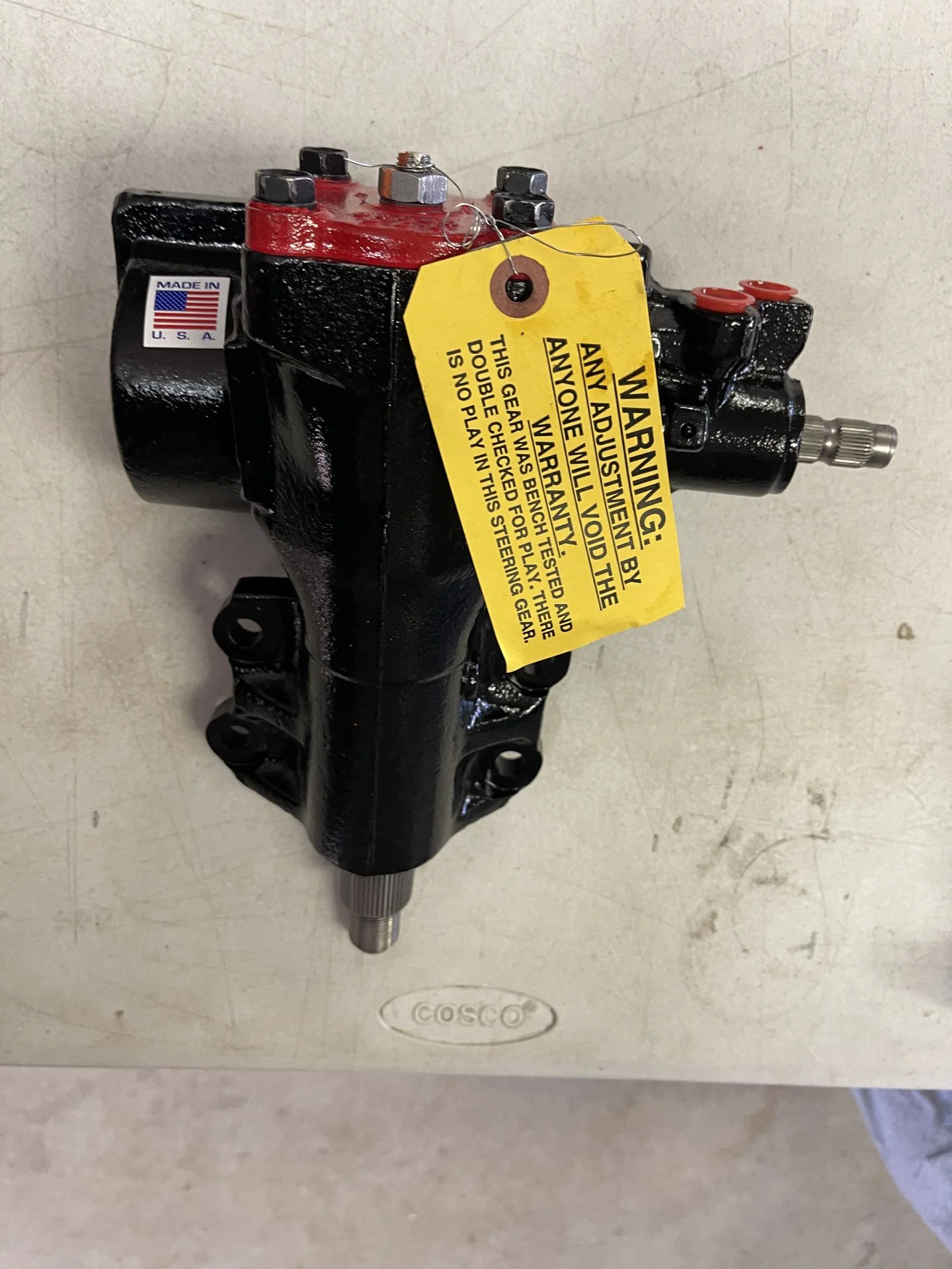

Just had mine done (no exchange) at 225K. Been using DTE24 for the last 100K+ and received the seal of approval to continue using DTE24 from RerdHead after the rebuild and inspection.
Just received the seal of
Just had my done (no exchange) at 225K. Been using DTE24 for the last 100K+ and received the seal of approval to continue using DTE24 from RerdHead after the rebuild and inspection.
Gotta love the made in the USA sticker 😜
Awesome! Thanks Phil!
