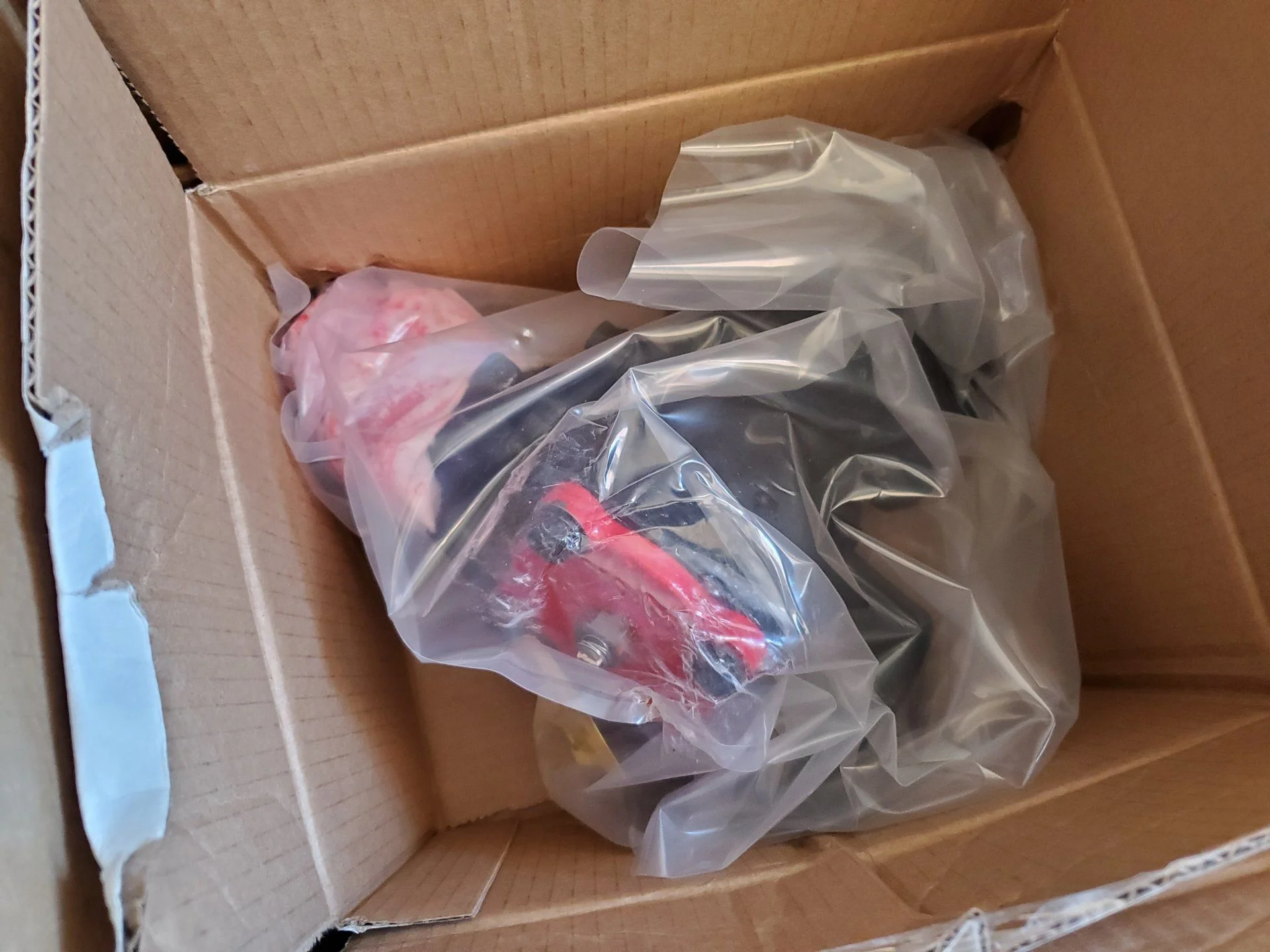

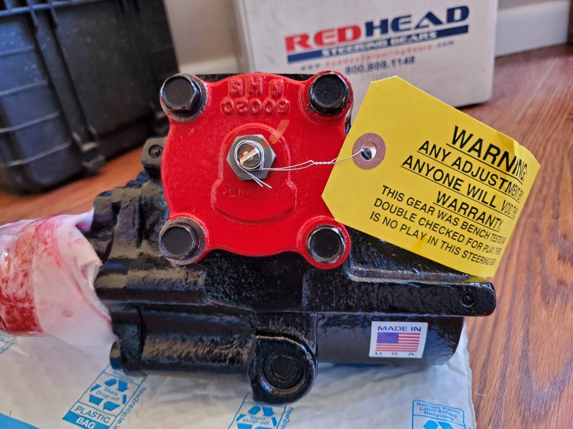

Placed my Redhead order today. After beating the 105 upgrade to death, I'm going with one of their off the shelf units (P/N 19721) with the $250 core and $70 flat rate 2-way shipping. I can't justify that 105 upgrade but I'm only running 33's and don't plan on wheeling it that hard. I am excited to get my Marlin Crawler upgraded steering kit installed at the same time! (just remembered I have to paint the Marlin ends and arms)
Received my Redhead Gearbox today. It's so purdy! Looking forward to getting this installed in the next week or so.
