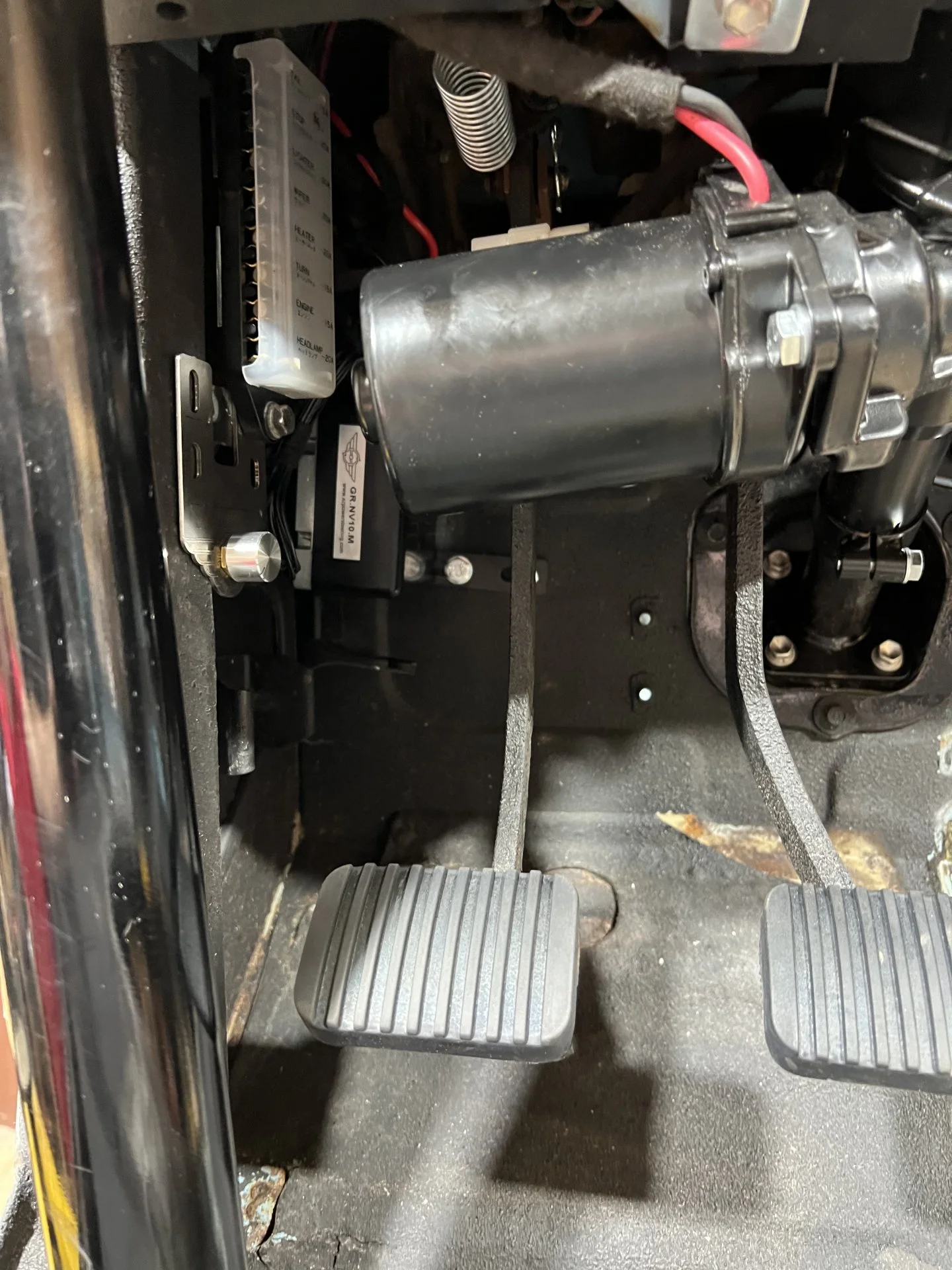

EPS is wired and control box mounted. Horn stolen off the 78. Got the wipers working.

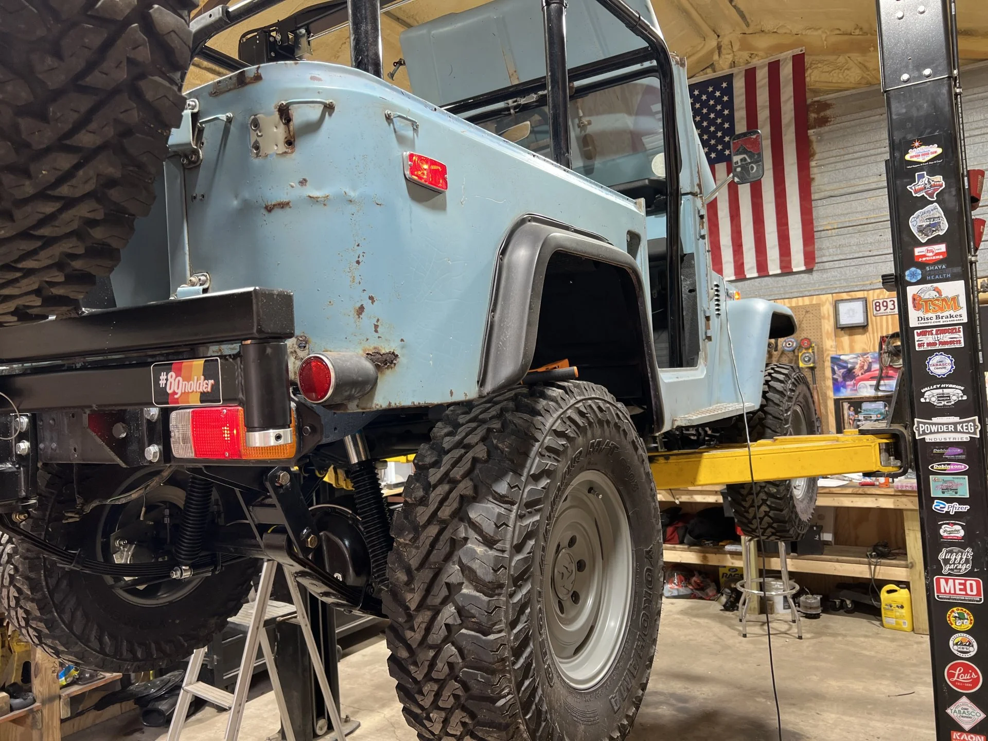

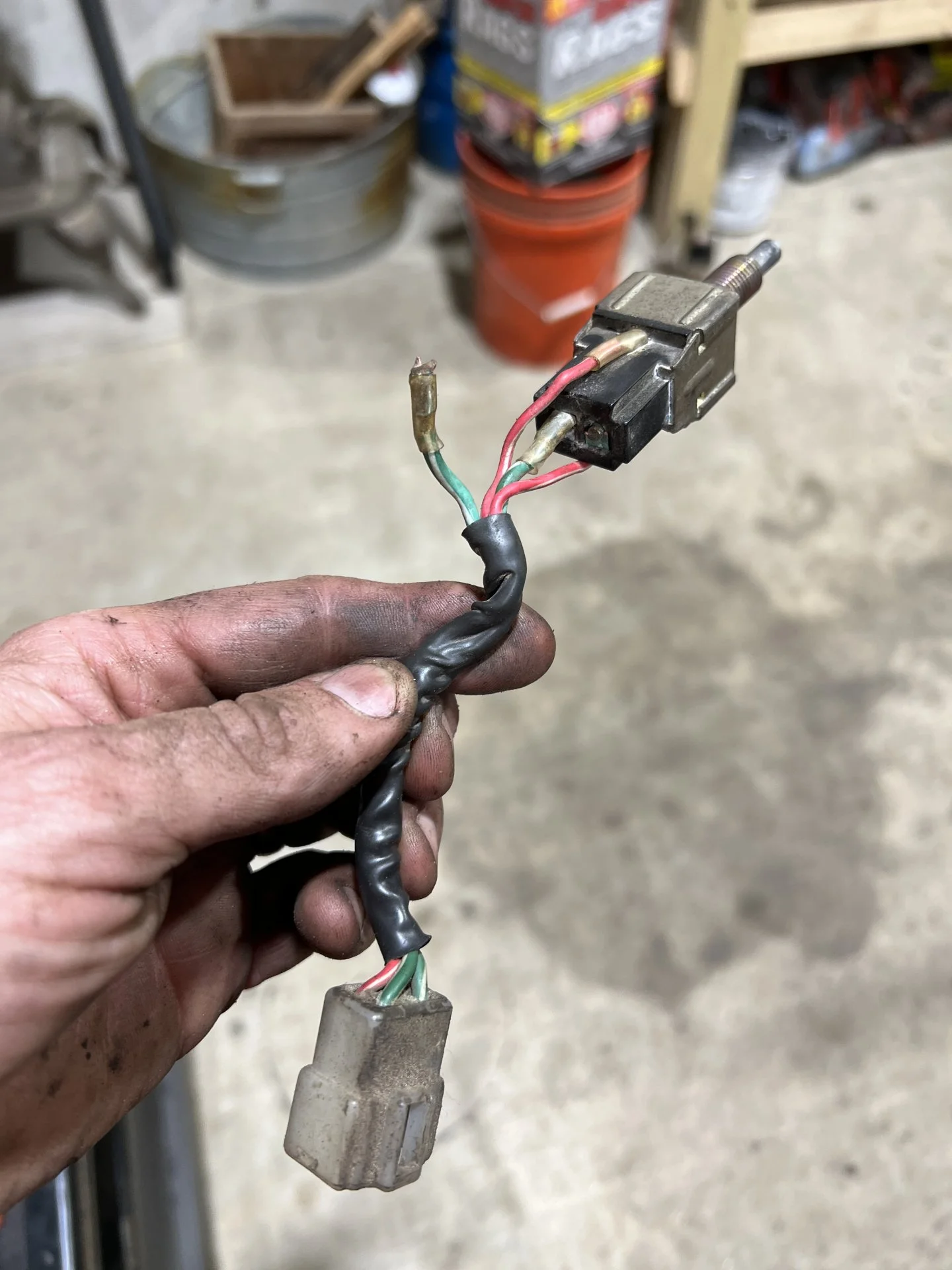

Bogged down wiring but it’s mostly up to date. The only things I can’t get to work are the blower switch (frozen but blower works), brake switch ( no click/what a bitch to remove) and individual blinkers.
The blinker relay is working because I get a good hazard but there is not enough ground it seems to make the side only blinkers work. I tried the roach clip on my Power Probe to the metal back of the front blinkers to ground it direct to the battery but still no flash. Open to ideas. May just need the rest of the ground cables. Dunno.
The aftermarket rear lights come with a plug that does not fit the harness and I tossed the old OEM plugs. Don’t do that.
Overall it was a very productive day. Very glad most everything works as advertised.

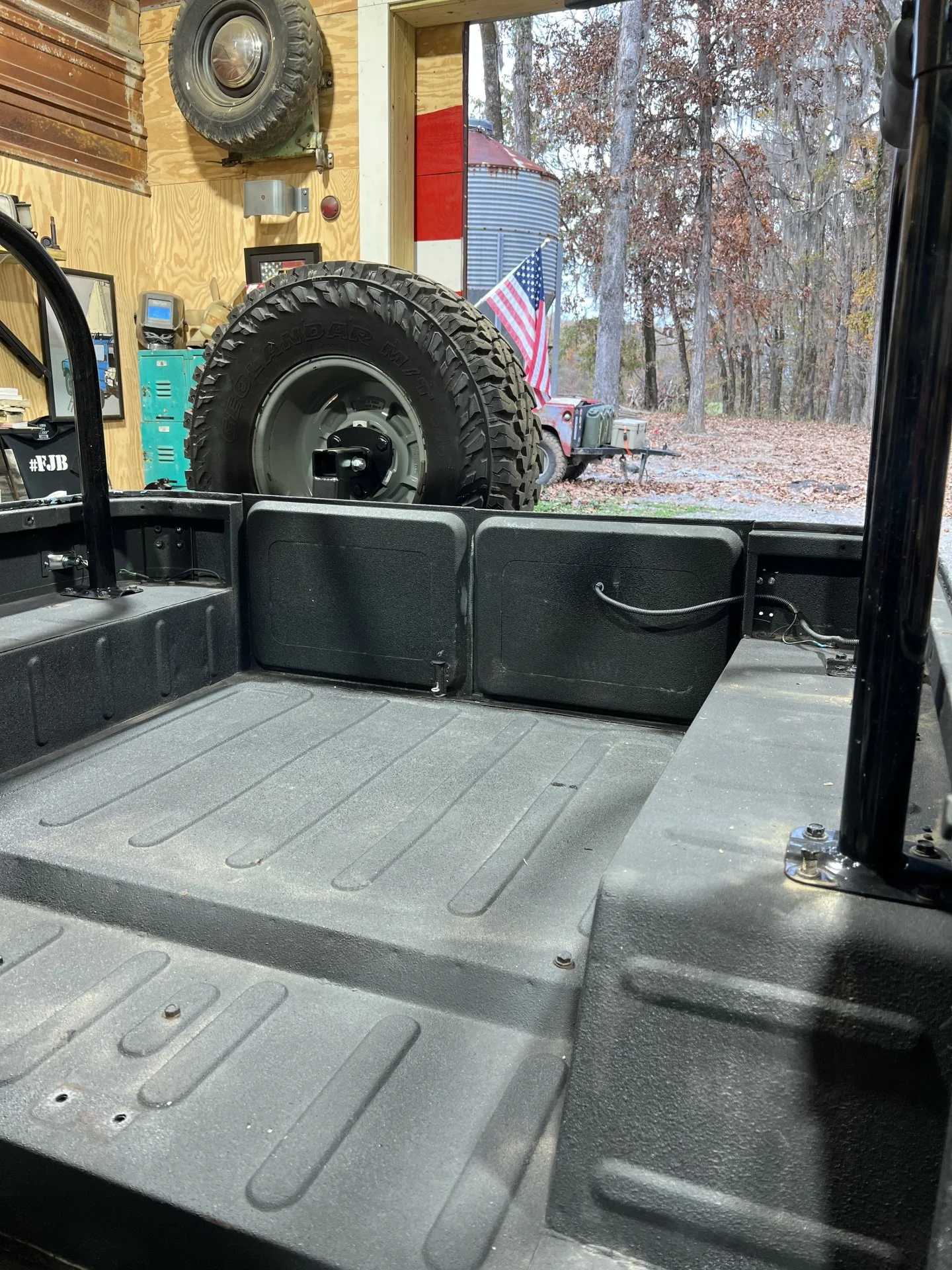

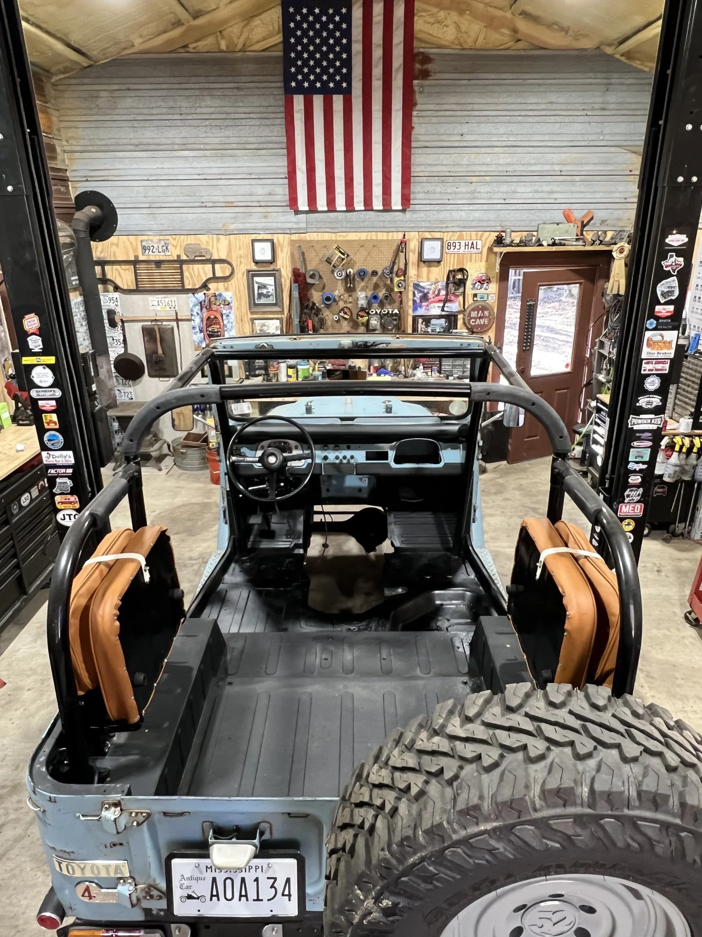

This AM i built out the front seats. Lined the cockpit and bolted in the rear seats.
We got a OEM FJ43/4 mat during the Mustard project that we did not use. I’ll trim the length after the wrinkles come out and use it on this one.
