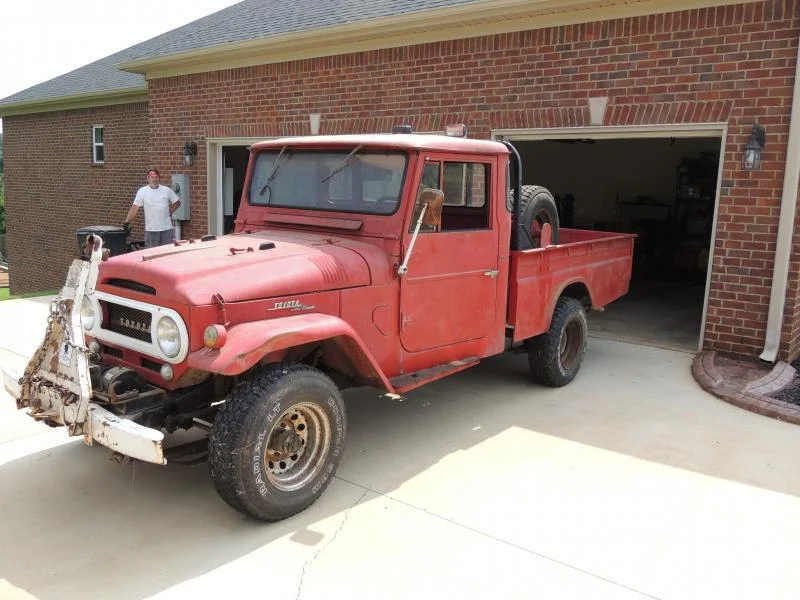

Thought I'd document the restoration of my late grandfather's 1965 FJ45. Here's the background... My pops bought the truck brand new in 1965. My Grandmother said it came in from Canada and was 1 of about 1,100 imported in 1965. The truck has (or had since we took it off) a Ramsey PTO winch and I'm not sure if this came from the dealership or somewhere else. At some point after he purchased the truck Pops installed an auxiliary fuel tank in the bed, a front tow bar, and two spare tire racks. The truck was used for hunting trips to land he owned in Eastern Oregon. Not too many years later Pops got sick with prostate cancer and the 45 sat for a long time. My father inherited pops 45 and really did not do anything to it. Drove it some and kept up regular maintenance. I remember going hunting locally in the mountains in the 45 when I was about 7 or 8 (about 30 yrs ago). Fast forward to 2001 - my father died of lung cancer and I inherited Pops 45. I was fresh out of the Air Force and trying to start a family on fumes for income so I did not have any money to put into the 45 Until now. A college degree, three moves to three states, and three sons later I am compelled from within my DNA to finally get Pops 45 back to it's glory. My grandmother is now 94 and not doing well and I want her to know I will be a good steward of Pops 45. I want her to see the passion I have for this truck resembles the passion my pops had. I want Pops 45 to be handed down to one of my sons in a condition for it to last a 100 more years...
So here we go! I'm restoring a 1965 FJ45 that has less than 30,000 moles on it! Sounds weird doesn't it? Less than 30,000 miles on a 48 year old truck...

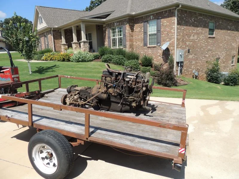

Check out the pics and the progress. I will be updating the engine and drive train so if you're interested in buying the F motor or original axles, three speed transmission, or Rear PTO transfer case let me know. All is original and very low miles!!!

The main reason for the swap is that the original set up is not practical for using the truck on today's roads. The cost for refurbing the old is more than upgrading to newer and more practical. It is a decision I have to make based on the budget I have. I'm done waiting around to win the lottery so a perfect restoration can happen. I've seen these 45's completely restored to original and yes they are valued in the 6 figures... these restos also cost $50 - $60k! that's not my focus and it would not have been the focus of my Pops. My Pops would have done the same thing I am doing now.

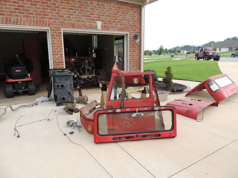

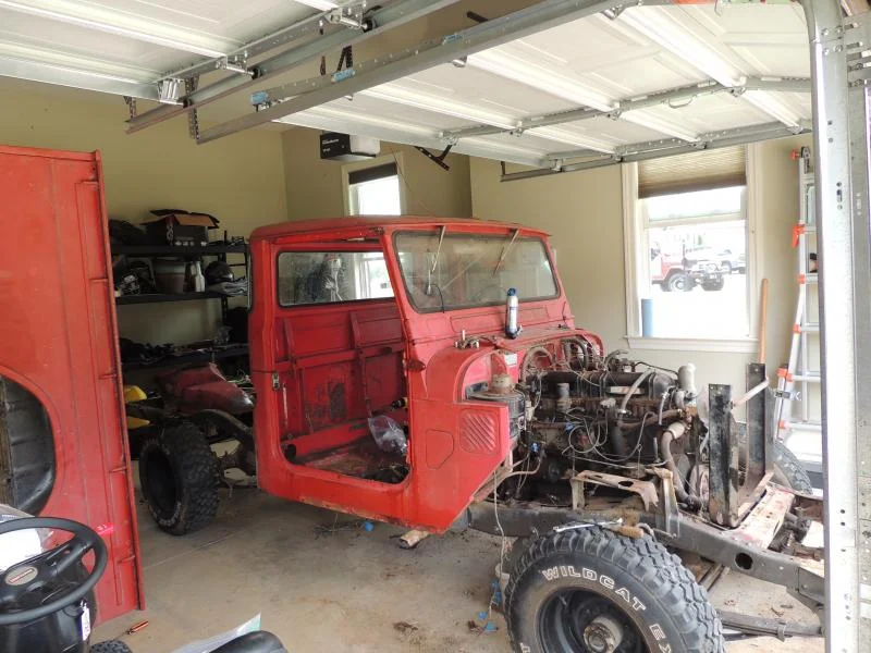

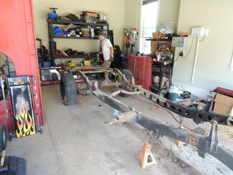

Now that we are down to the frame we are in a hold pattern until we get our "Toyota" replacement parts. :)
We need to make sure we have our frame ready with all holes, mounts, etc, then we are going to have the frame sand blasted and galvanized.
