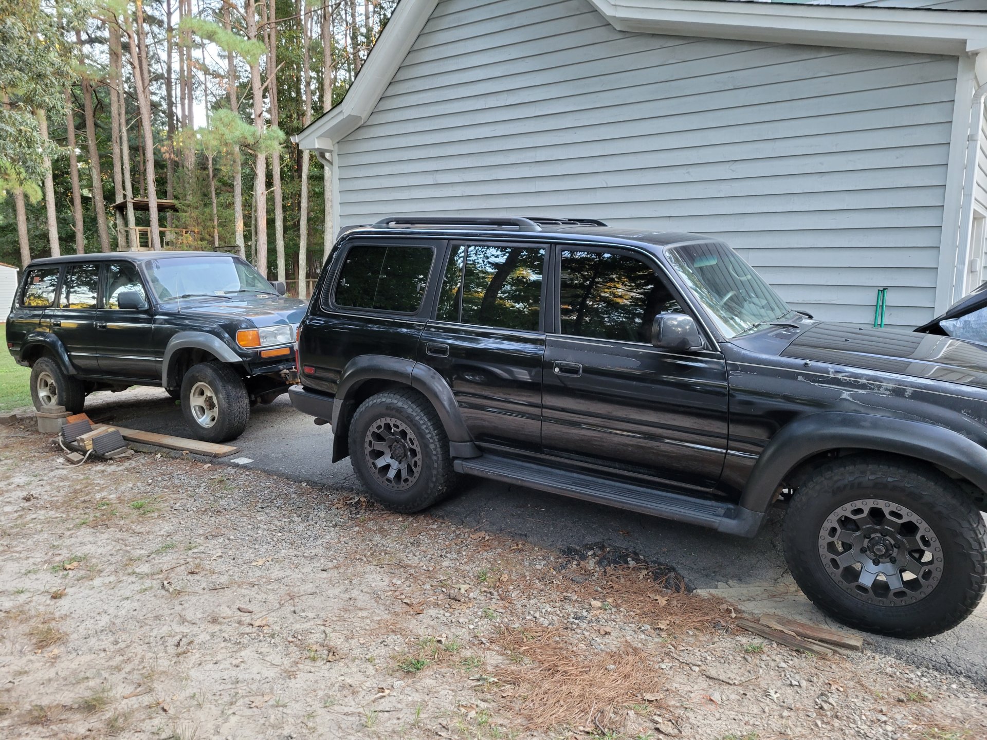

First swap between rigs was a quick door handle project after work tonight. The black 80 handle was cracked and the green 80 while dirty was in much better shape.
Will probably do a few more odds and ends like this while I continue to research the axle swap project

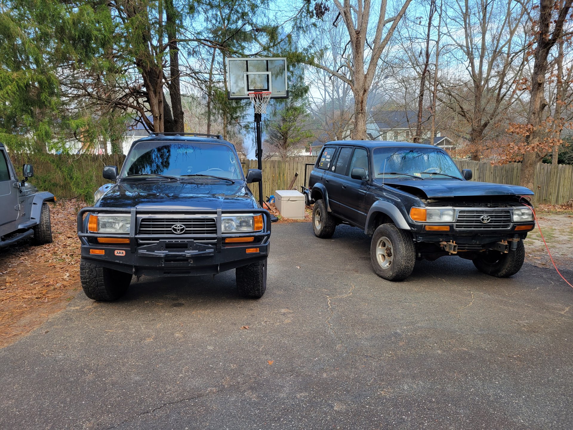

Found a used ARB bumper
The passenger side bulb wasn't working so I opened it up. It was corroded to the point that the bulb housing fell a part in my hand. I rummaged through my junk boxes and found an old fog light that had a 1156 socket in it. Drilled it out from the fog light and bolted it to the ARB housing... worked perfectly!!

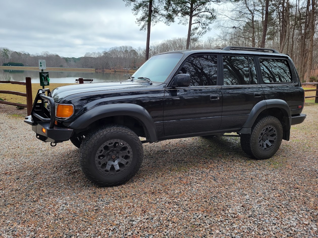

Carolina Squat!! I had 19 7/8" from hub to front fender before and this morning I got 22 3/8, so a full 2.5" although I suspect it will settle just a bit...
hopefully rear "complete" photos tomorrow and then some wheel shopping. I'm not a big fan of these, I really like the look of the factory 80 wheels or Tundra steelies on the black trucks.
Done! No broken bolts (thanks PB Blaster and heat) but it took SIGNIFICANTLY longer than I anticipated. It was a fun Christmas break project...
Before/After:
Stop by the neighborhood pond for a quick pic during the test ride:
