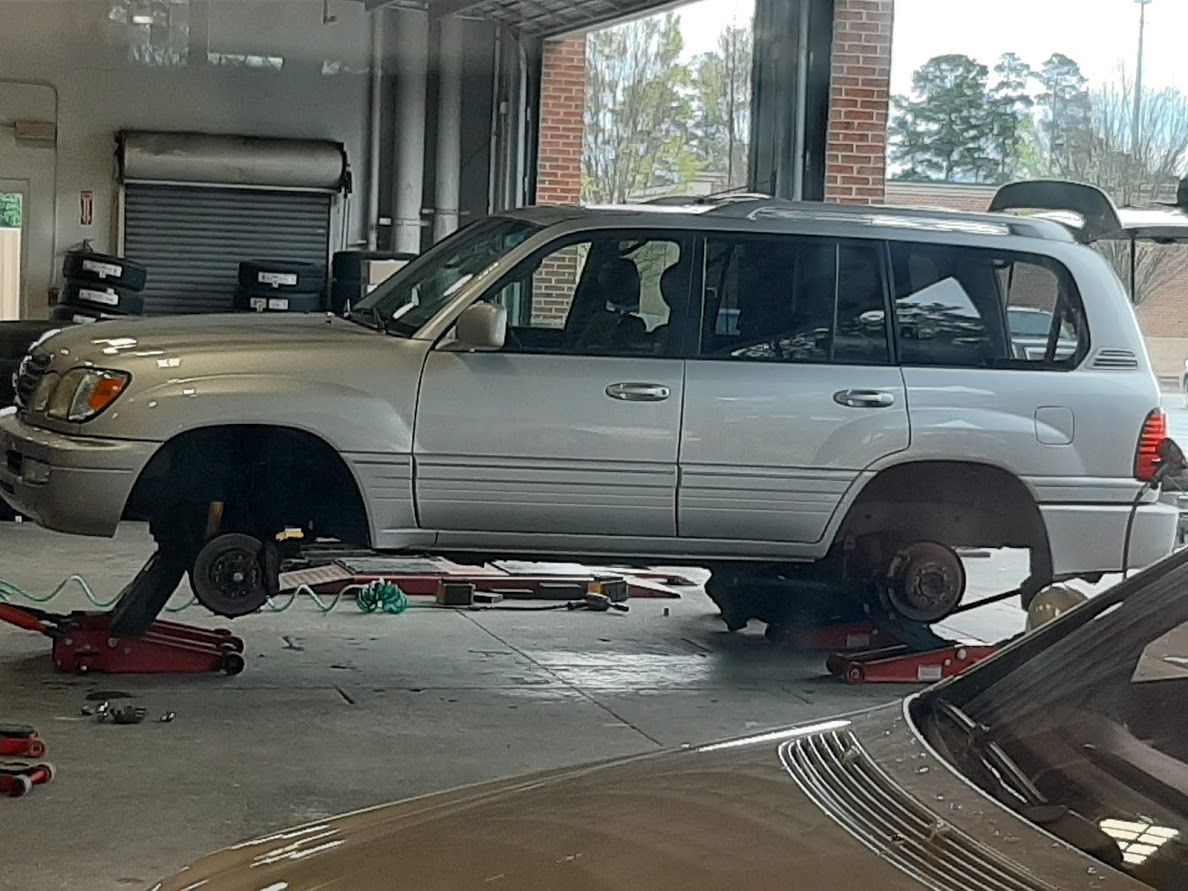

Stopped in Discount Tire and they were pretty slow so I got them to test my TPMS sensors. The scan tool was pretty cool; I'm seriously looking at getting one. ~$130 on Amazon. When pointed at the tire, the tool reported the 2 fronts working but the 2 rear and spare weren't. He plugged into the OBD and the ECU reported only the spare not reporting. I suspected they were all original (2006) so I told him to change them all. He confirmed they were the originals and the new ones are all working perfectly now. No more flashing TPMS!!

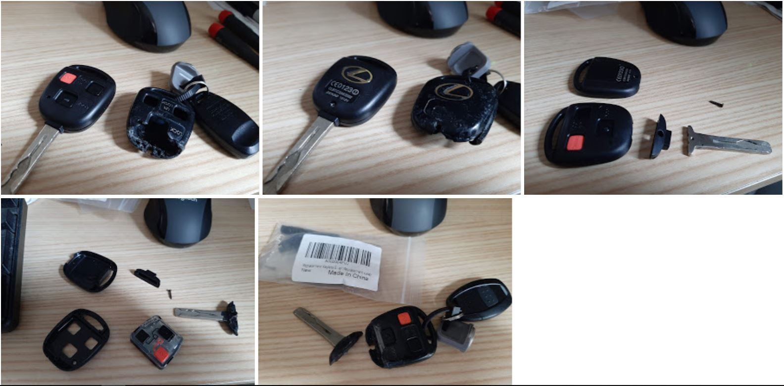

When you're locked up at home and Amazon is you're only means of escape... I've got some bulbs coming but this was a good rainy day project. The spare key was taped together and when I un-taped it... it fell apart. I ordered this. You can tell its a cheap china copy but for <$10 it is good enough for the spare key that stays in the drawer.
Way more than $10, but the titanium jobber by @suprarx7nut is money well spent. I hemmed and hawed over the coin for quite some time. Now that I’ve pulled the trigger, I love the damned thing.
I'll have to check that out. Sounds like a business case for daily use... When my original starts showing signs of going, I won't be using the Amazon china one again so this may be a good alternative. THANKS!!
