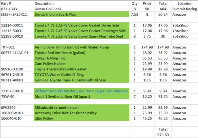

I've assembled the next list and ordered the parts; Amazon is showing early May delivery but I think it will make it before then...
11214-50011 Toyota 4.7L 2UZ-FE Valve Cover Gasket Driver Side
11213-50031 Toyota 4.7L 2UZ-FE Valve Cover Gasket Passenger Side
11193-50010 Toyota 4.7L 2UZ-FE Valve Cover Spark Plug Tube Seal (8)
TKT-021 Aisin Engine Timing Belt Kit with Water Pump
00272-1LLAC-01 Toyota Red Antifreeze (gallon)
90916-03100 Toyota Engine Thermostat with Gasket
96761-24019 Toyota Water Outlet O-Ring
90311-A0001 Genuine Toyota Type-T Crankshaft Oil Seal
6PK2240 Mitsuboshi serpentine belt
166200W101 Accessory Drive Belt Tensioner Pulley
166040F010 Idler Pulley
SK20R11 Denso Iridium spark plugs (8)
12157-10010 Differential and Transfer Case Drain Plug Crush Washer set
75W-90 Mobil 1 Synthetic Gear Oil (7 quarts)
I have really waffled over swapping all 8 Denso coil packs while I was doing this but have decided to wait. They look easy enough to swap if I get a failure in the future and have read that many have gone ~250+ so I'll try to get a little more life out of them.
Did I miss anything in my list that I should do 'while I'm in there'? I tried to read through all the 100-series FAQ's but certainly could have missed something. Any better suppliers than Amazon for OEM Toyota parts??
