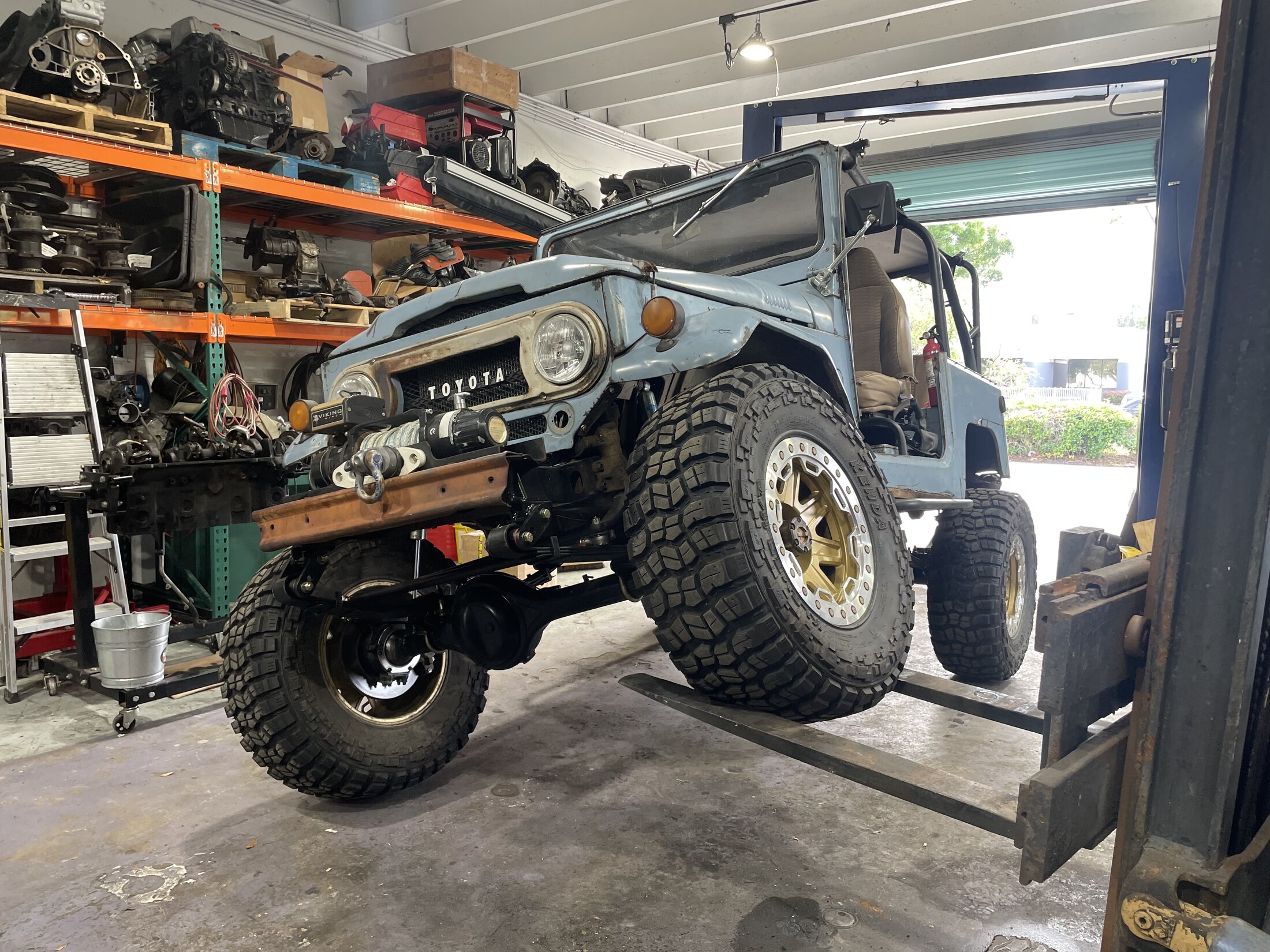

They were pretty comparable but together more than I thought was worth installing on this 60. I'd really like to go with 35's and maybe 37's one day and thought the SOA was the only way to achieve that. ...but I'm a noob so let me know if I'm missing something
Are you saying do the SOA AND a set of Dobinson's lift springs at the same time? That would be extremely tall and unstable.
