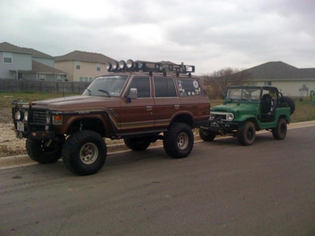

wheeled Frijoles Verde :rolleyes: and I got stuck on flat ground but my wife and kids loved it
Dang kling-on that thing looks huge!
I bet people were diggin the green bean though.
FJ40's always get more cred than 60's at least at Barnwell
this is right before I left ... Ya 40's get way more love for sure
Right on, the next picture you posted could only get better if you stood next to the 40 and someone smaller than you next to the 60.
Nice rides man

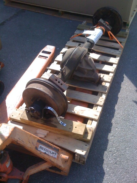

NEW PARTS FULL FLOATER BABY ... now I just need my 456's to be done and toss it in :steer::cheers::hillbilly: I'm tired of drivin my Mom's car:rolleyes:
Sweet!!! That one is already set up for SOA I see, very cool.
