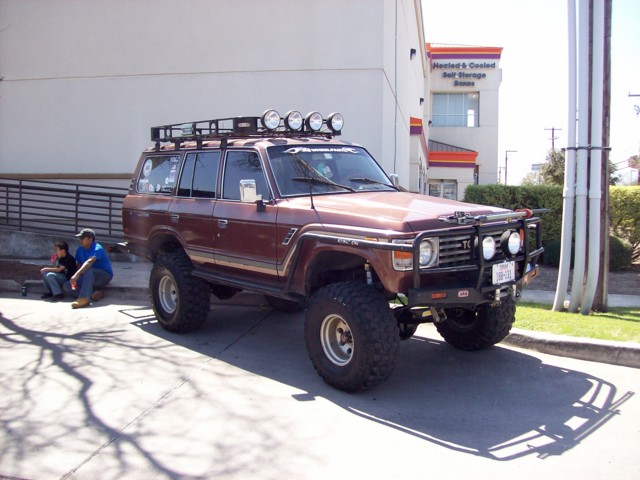

I think I need to move the axle forward a hole in the perches it looks to far back in the fender well :bang:
I noticed that. Did you not put the spring pin in the center hole on the perch at first?
It's in the center hole but I think the center pin is a bit farther back...the sping it also a in or so longer ... I'm starting to think they started out as bigger the one in springs :lol:

Power slot rotors from work :D V6 calipers ceramic pads and red caliper paint;) ... the rotors are stated to be 20 improvement in stopping power by them selves so I hope with calipers it'll be bad ass :hillbilly:
oh and a FYI I dont realy dont like the angle on the zero rate perches :frown: .... it not zero from stock like I thought its just Zero :eek: if I didnt have a LONG ASS Auto they wouldnt work so anyone else lookin at these Ruffstuff kit get the middle off set for stock and the big one for CNT's

I love your front shackle angle! that thing will have some killer droop!
Looks like a completely different truck now! Big improvement man:cheers:
ya I have to redo the shocks later cause I got 27 in shocks and it flexes way more then they can :lol: but I keeped with my first set up to be ready for round up 32 in fronts with Furd towers are not far off
