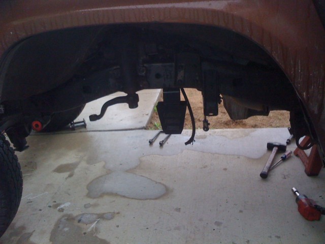

Used ruffstuffs "0" perches to match stock ... I need the piñon to stay low to clear the oil pan... Basicly the same as I did on patches ... My 40 will have a CNT and I'll do it under the truck this one is a basic SOA

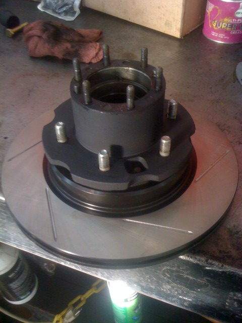

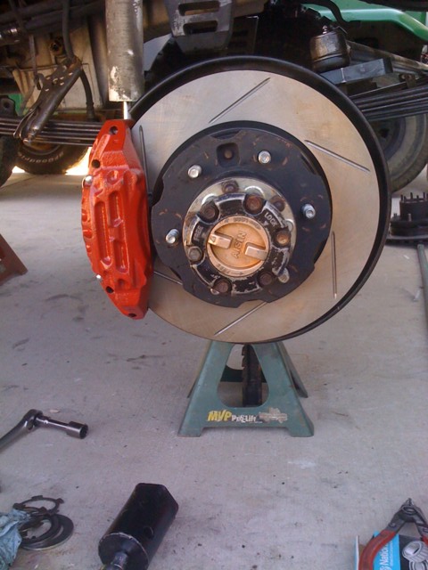

yesterday got the hubs cleaned and painted and swaped out the rotors with power slots... I was goin to put it all to geter today but baby girl is sick so she home with me... maybe nexted week

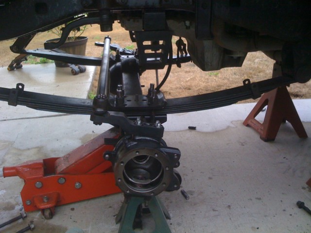

well finaly got a day off to work on my axle ... high of 25 today great .... got half way done instllin the knuckles and found out the ball gusset hit the fawkin knuckle even after I remove 1/2 from em ... and I left my grinder at work FAWK ... I guess I'll get back to it this weekend after I "clearance" the top gusset more what is it 5 weeks to round up... I better get busy ... why do I wait till the last second to do stuff :lol:

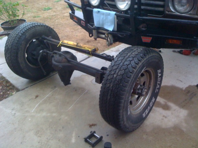

its missing something
so cool and scary at the same time

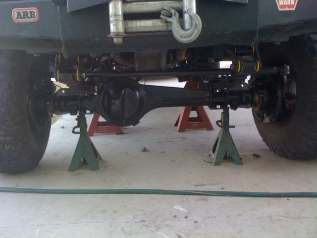

gettin close ... dont have pics but I have the the front axle all most done ... but I fawked up a bearing so I have to pick one up tomarrow
GETTIN THERE
Halfway there! Good work man, the hard part is over!
looks better already.

i was wondering when I saw those ball gussetts if they were gunna hit????:lol::lol::lol:

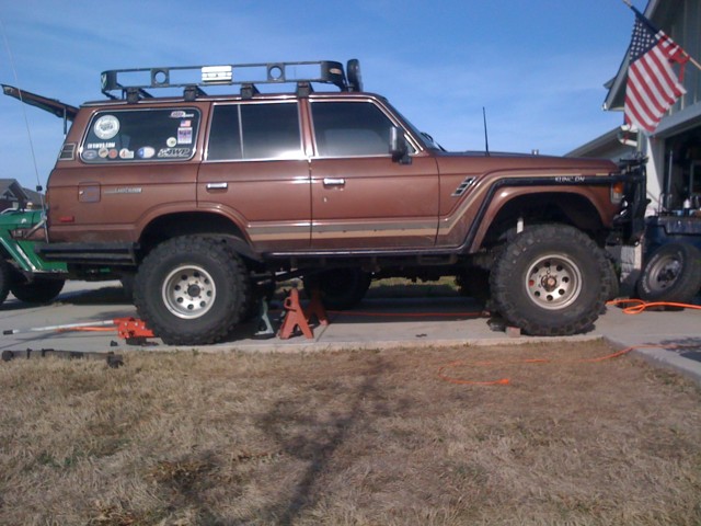

well almost there need to get longer shackles this week and get back at it .... shockles shocks shafts and she on the road ...2 weeks to go:bang:
man I want to try out the new brakes bad

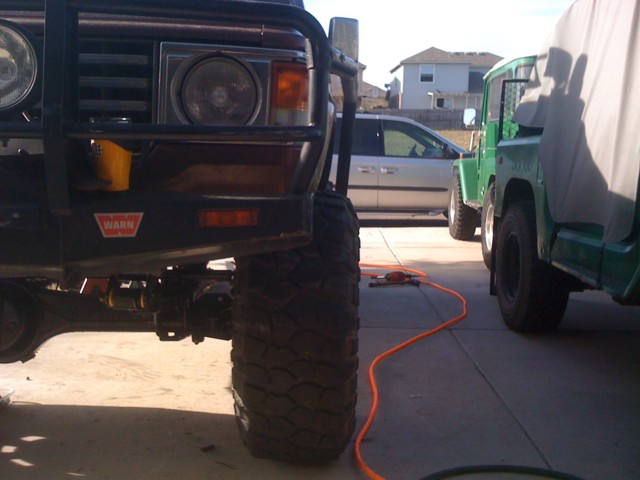

the 1350 stick out alot ... and I love how thw SOA looks from the front
and 24 1/2 in to the frame and Patches was 22 on 38's .... she's big :steer::hillbilly::meh:
