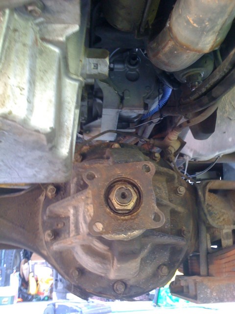

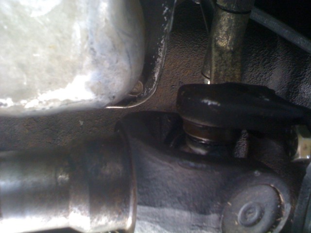

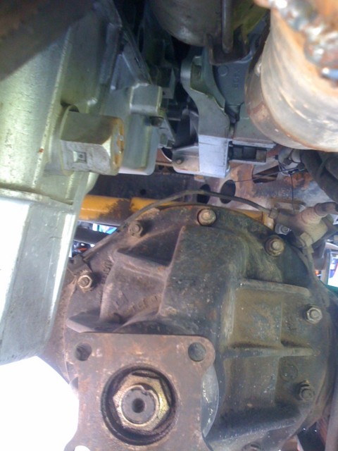

Ok so after the Veeate was put in my 60 it was put in to low and crooked just enough that the front shaft wont clear
I know I should have dont it myself... live and learn ...

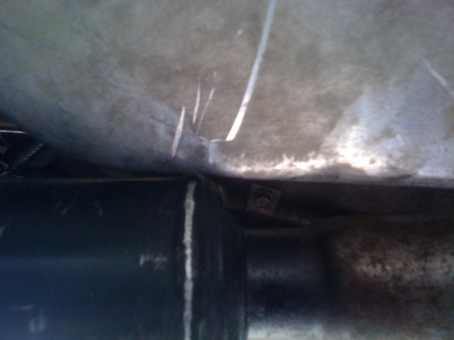

see how close the oilpan is
the yoke almost hit the oilpan .. and yes I know I could fix this with a Camero pan
my 6 in bump stop to make the diff stop hittin the oil pan
I flipped the shaft to clear the trans pan
but it still hits the pan ... SOOO more lift time

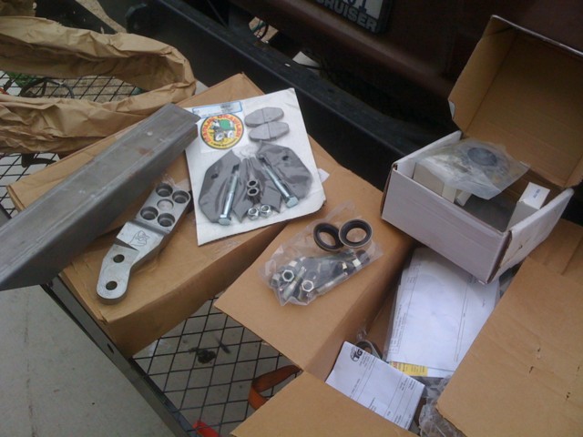

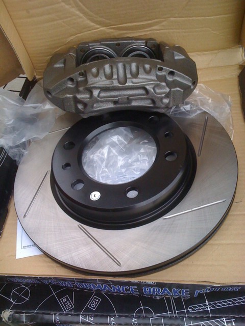

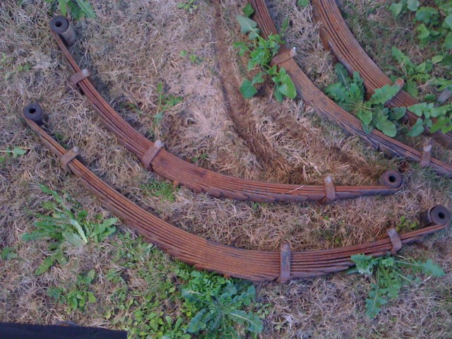

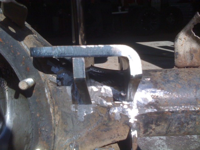

so I dug out my parts for the FJ40 Ruff stuff SOA kit , Marlin High steer, alxe truss. ball gussets, HD seal, Trail-gear knuckle kit and HD studs, V6 calipers, power slot rotors and 5100's

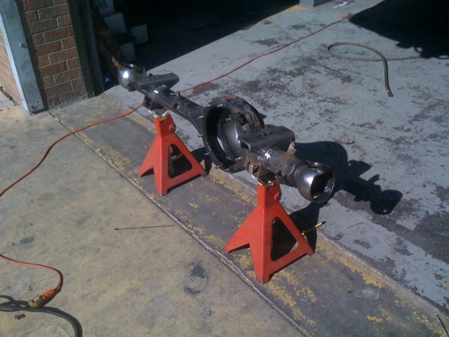

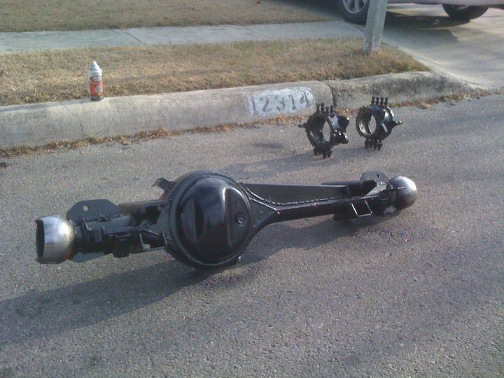

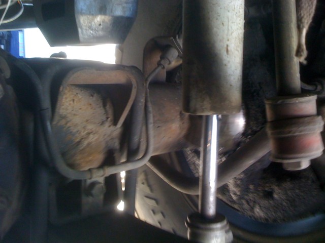

and this week I started striping the axles and started the SOA

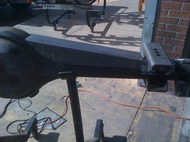

the mount took alittle gringin to fit but all and all VERY nice and BEEF
axle truss and ball gussets took alot of triming and grinding
and this is were I stopped today hope to have it all fit and ground so I can weld it up Friday ... doing this at lunch ...30-45 mins at a time
plan on stickem them under the truck nexted week
