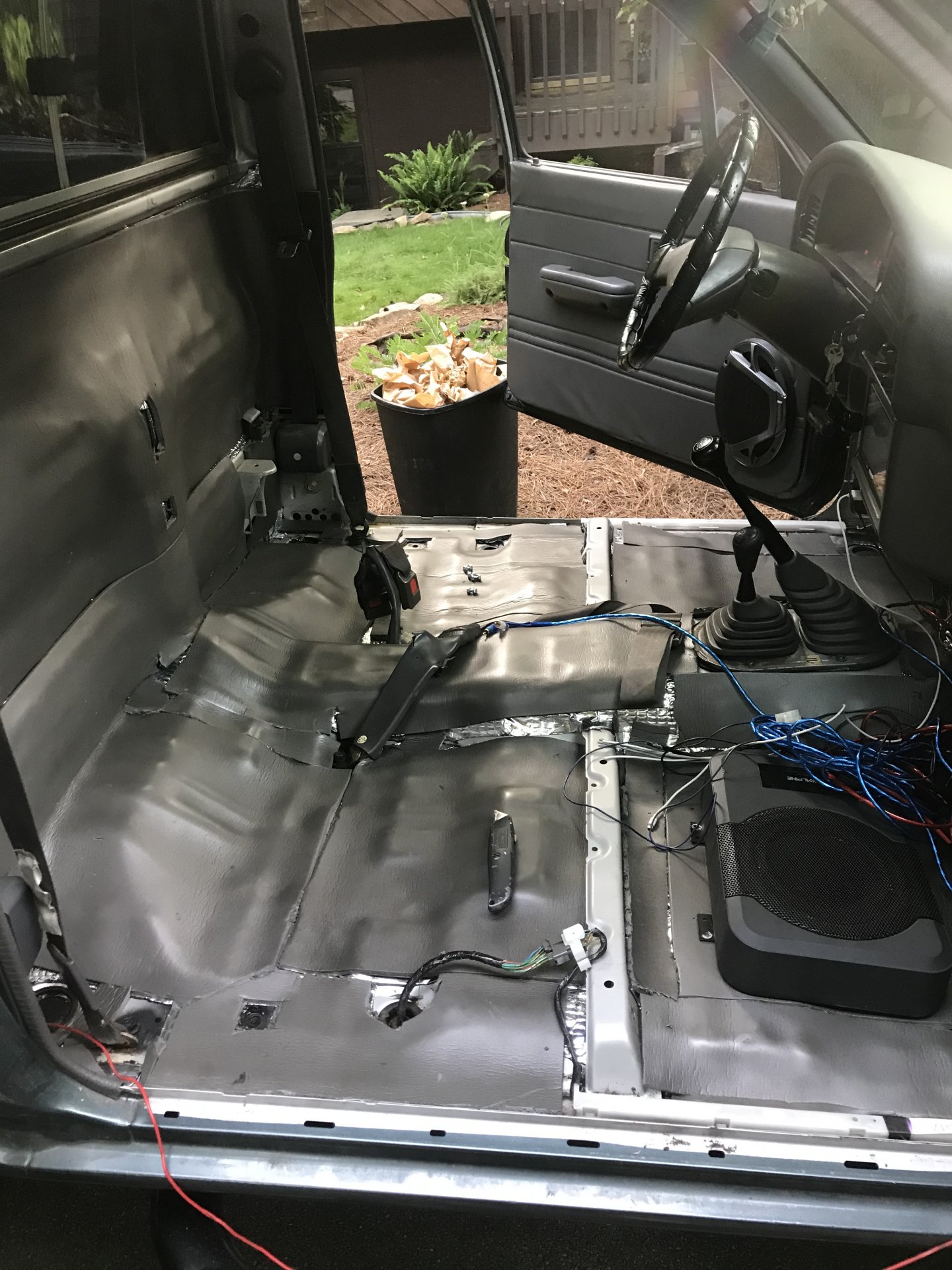

I insulated mine with a dense closed cell foam with a layer of offbrand Dynamat underneath. I’m not too fond of the edges, but I haven’t put much thought into fixing it since it’s aesthetics behind the seat. It did make a huge difference in sound and climate though.
