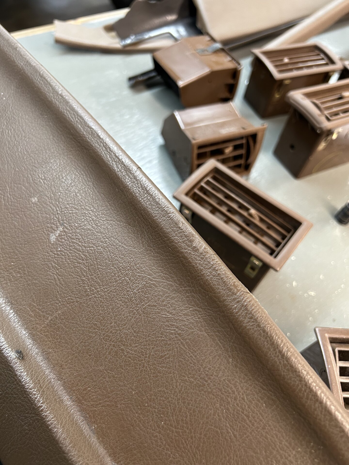

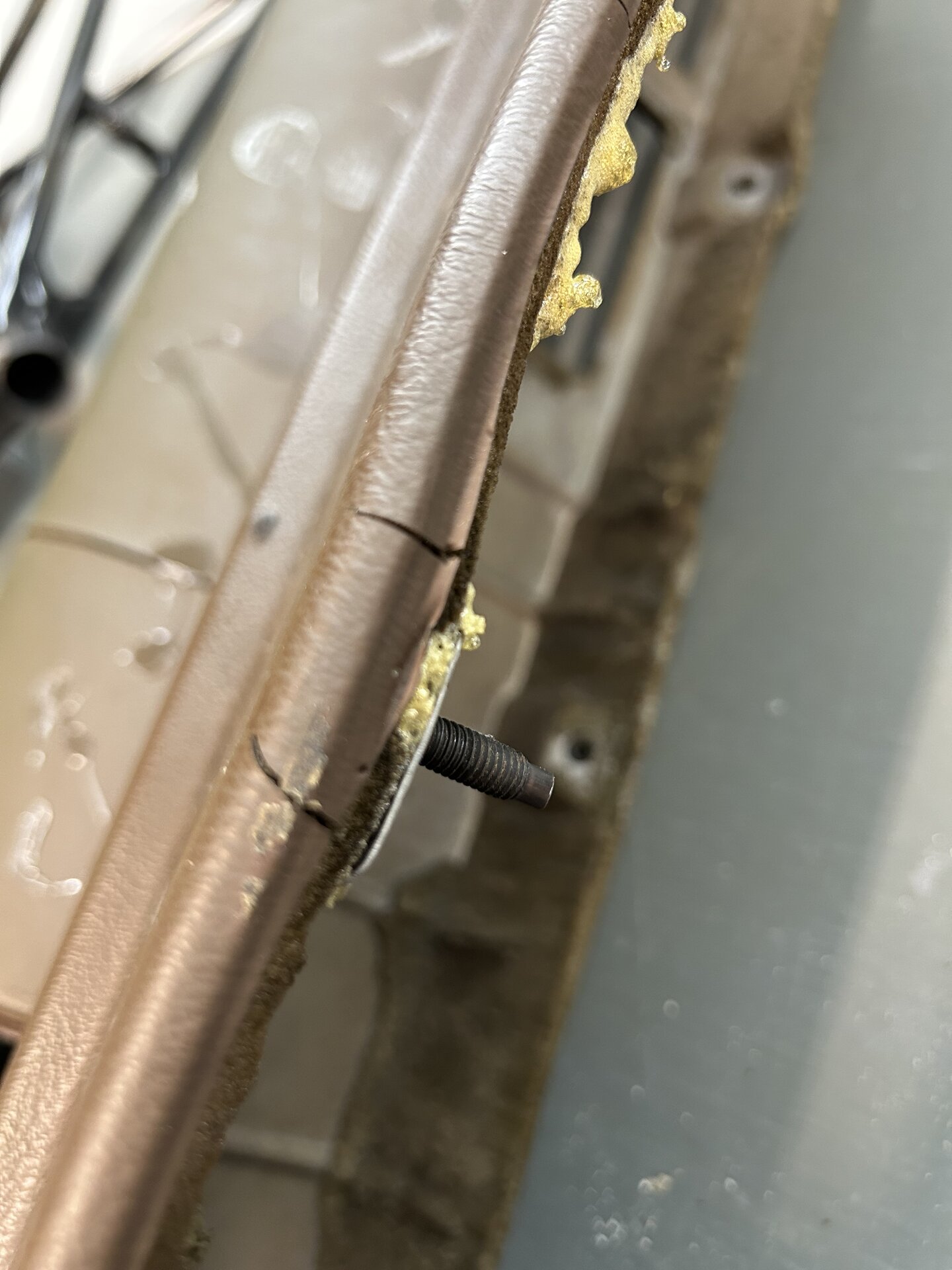

@yotadude520 I'm FINALLY getting around to installing that sweet OE dash!
Before I put the OE dash in, I'm wondering if I should do anything to slow the inevitable cracking. There are tiny cracks that aren't visible on the top - just forming from the underside. It seems like dabbing some adhesive of some sort (?) on the little cracks might slow them from becoming big cracks... and making it to the visible side. But, I have not idea what, if anything, would be the right adhesive here.
Ideas? Thoughts?
The first pic is the edge at the windshield - that bolt should tell you exactly where it is. The second pic shows the same spot - one crack has just barely made it to the top... barely

Have you thought about recovering it with new material?
Maybe some 3M 5200 Marine adhesive/sealant? That $hit is permanent. It will tear a chunk out of a boat before it will let the part come off.
That sounds like what I'm after - something strong, weather-resistant, flexible...
