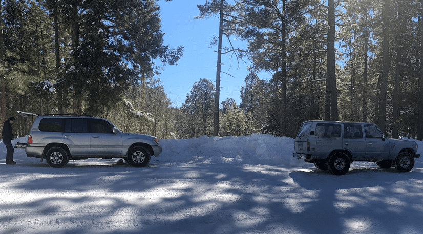

Most of my time has been taken up by the overrated chore of being a father. Changing diapers instead of oil, and dumping a bunch of money into new shoes instead of rubber boots has been quite the headache for me and poor ol' Peaches. But this dame has not let me down, and carefully carried my child and her mother up the Tucson Alps this weekend to see the beautiful views that Mt Lemon has to offer. My parents never took me to see the snow, I think in part because they didn't have a 4x4, and in part because Mexicans aren't generally winter folk, so it was imperative for me to introduce my young cub to the hostile temps of 37 degrees. Life should be rough sometimes...

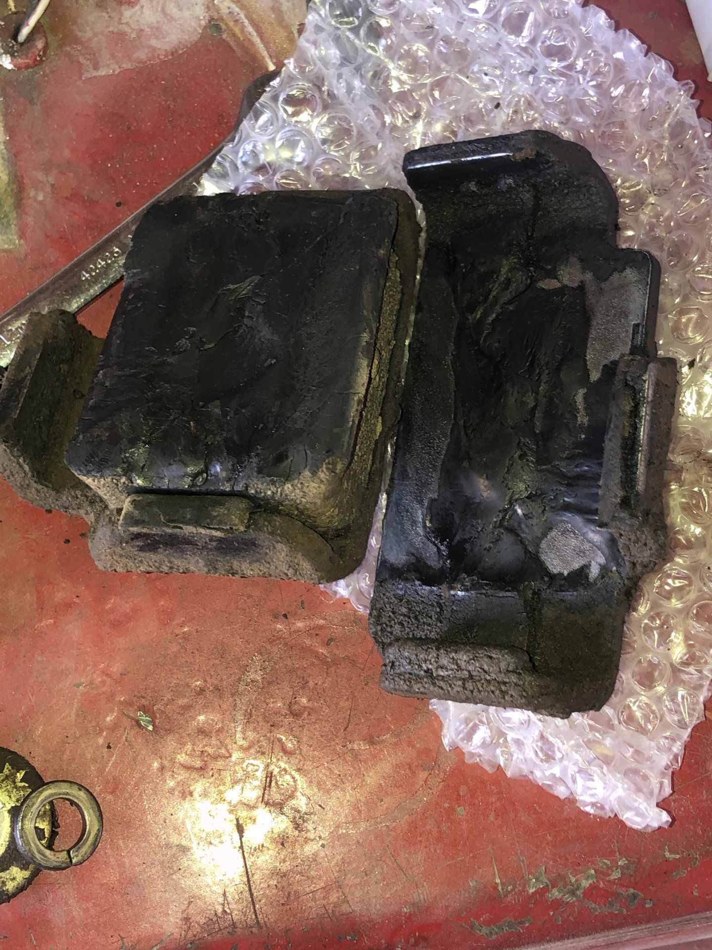

Quick update. I had been dealing with some crap motor mounts and finally got around to installing some Japanese made Westar mounts. Crazy to see a completely broken mount
the new ones were much better and my motor was no longer rattling with the fan hitting the shroud. Additionally, the install was not very bad, either.
i took the valve cover off and did a readjustment. Pictures not available. Awesome to feel thedifference with new mounts and correct valves.
