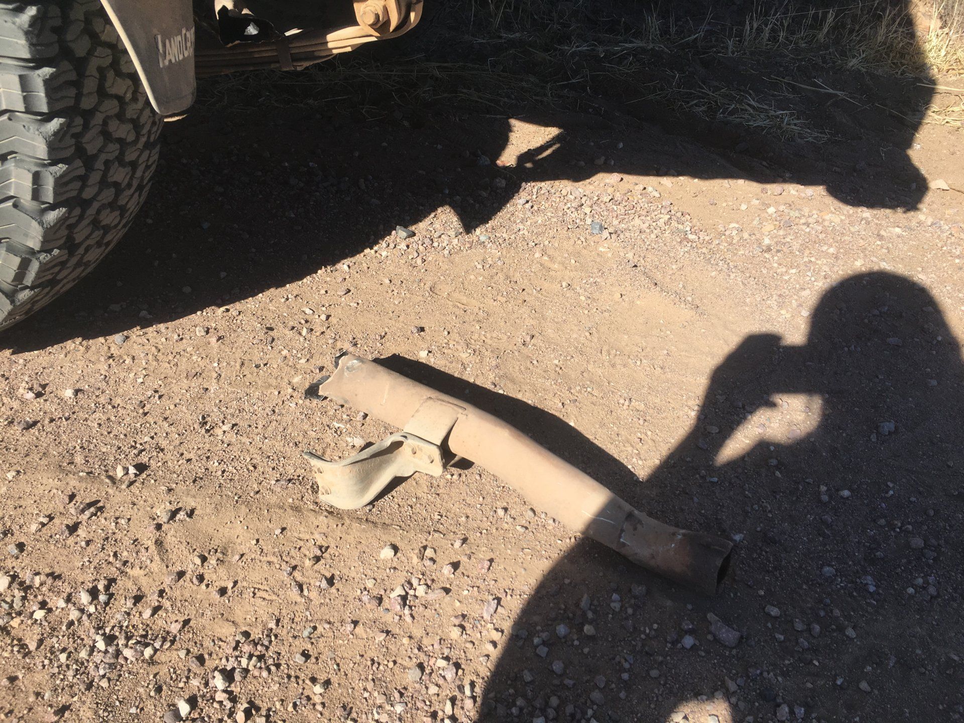

Did some light wheel east of Patagonia Lake and attempted to make my way to Parker canyon this past weekend. While out in the country, a green and while SUV was off in the distance, and as any Mexican knows, that ain’t a good sign. So I tried to dodge this “migra” agent, but realized my sudden detour was a dead end. As I tried to double back to the main trail, I reversed into an embankment, and peaches sounded awful. Miraculously, the Migra agent caught up to me and was kind enough to pull out his baton, and not use it on me! The issues was dirt getting packed into the tailpipe, which the migra cleared out using his beaner-beater. Also, miraculously, he let us go on our merry way without asking for proof of citizenship!
regretably, as we mosied on down the road, the sounds of disruption became increasingly evident, and lo and behold, my 3 point turn attempt resulted in tailpipe oragami! So I jiggled and wiggled the last bit of tailpipe and above is the end result of what can be called, a Mexican tailpipe delete mod.

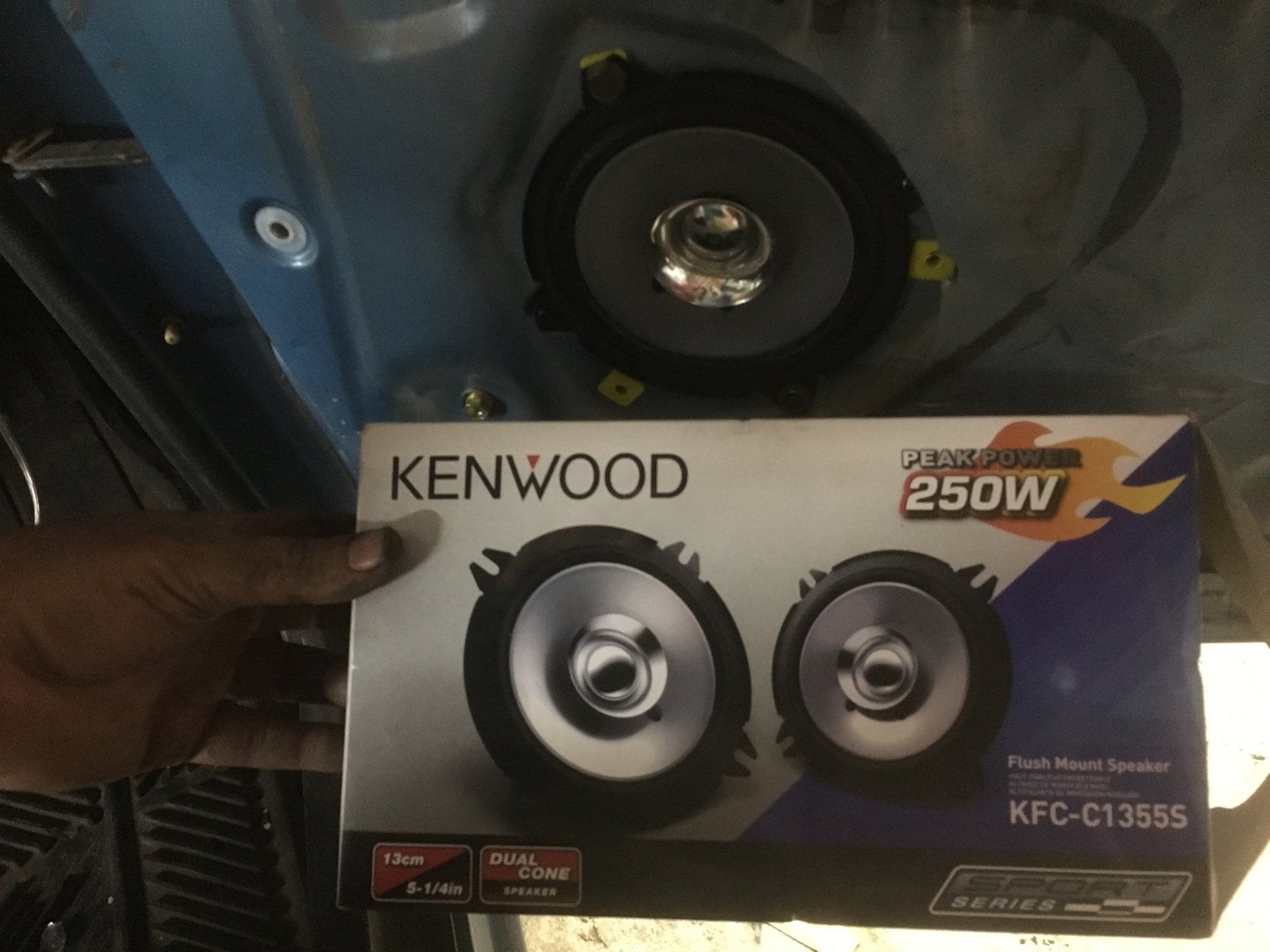

the local Pep Boys came in clutch with these Kenwood speakers that fit perfectly into the oem holes. A few new drill holes and boom: smooth sounds.

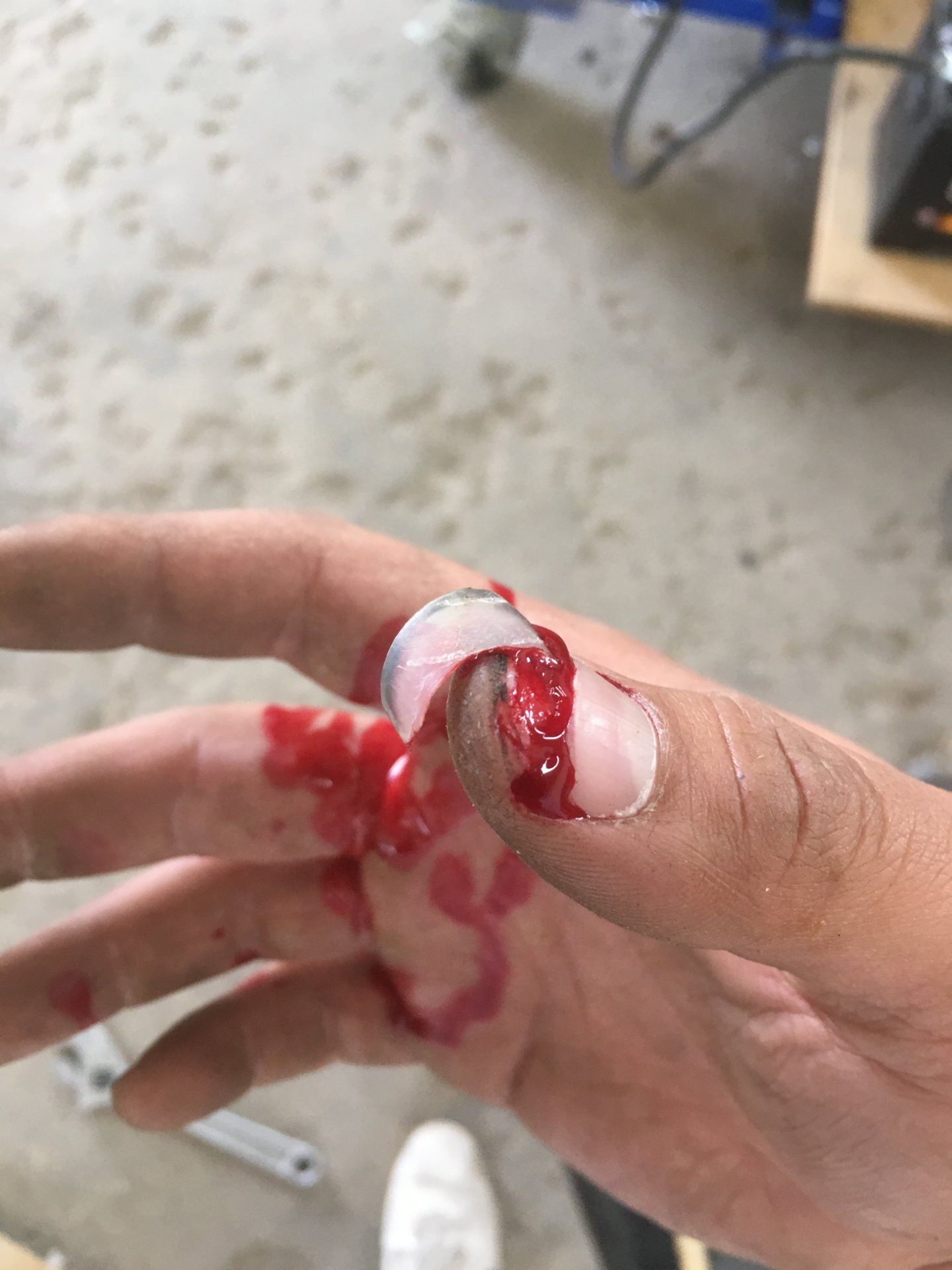

lastly, while working on the brackets to hold the new stereo in place, I used a steel pipe to straighten out the previous brackets and had a bit of an accident. I yelped like suicide bomber, but these land cruisers take blood, sweat and tears
Damn son! Gnarly...
@Dimples , Healing like a lizard!

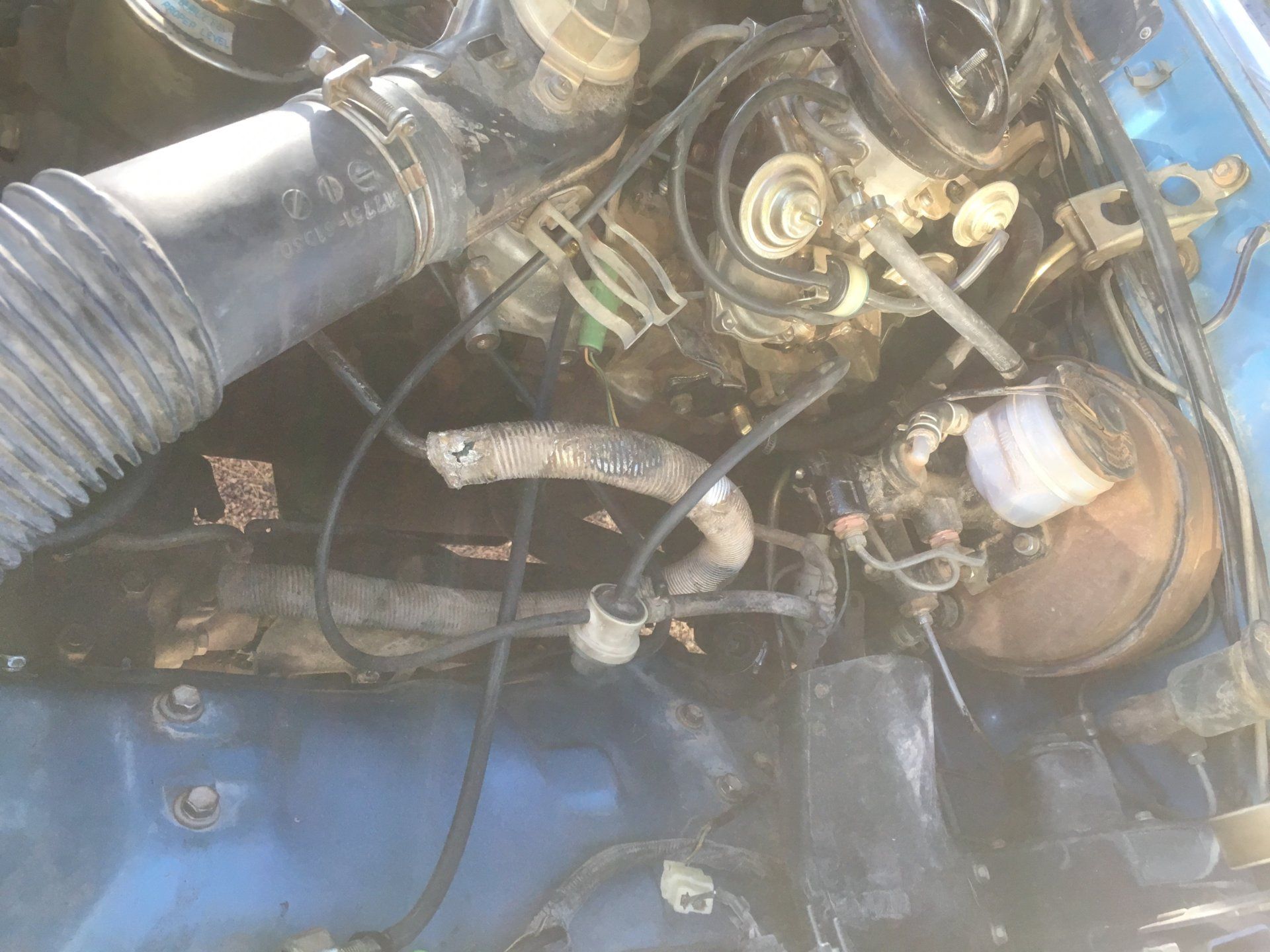

This is the clusterclunk that was on my beautiful motor prior to disassembly. Obviously very ugly, and not surprisingly, probably wrong. The vacuum line wiring was such a headache, with the rat's nest of hoses, and Arizona desert dust powdering the engine bay like an 80's disco party.

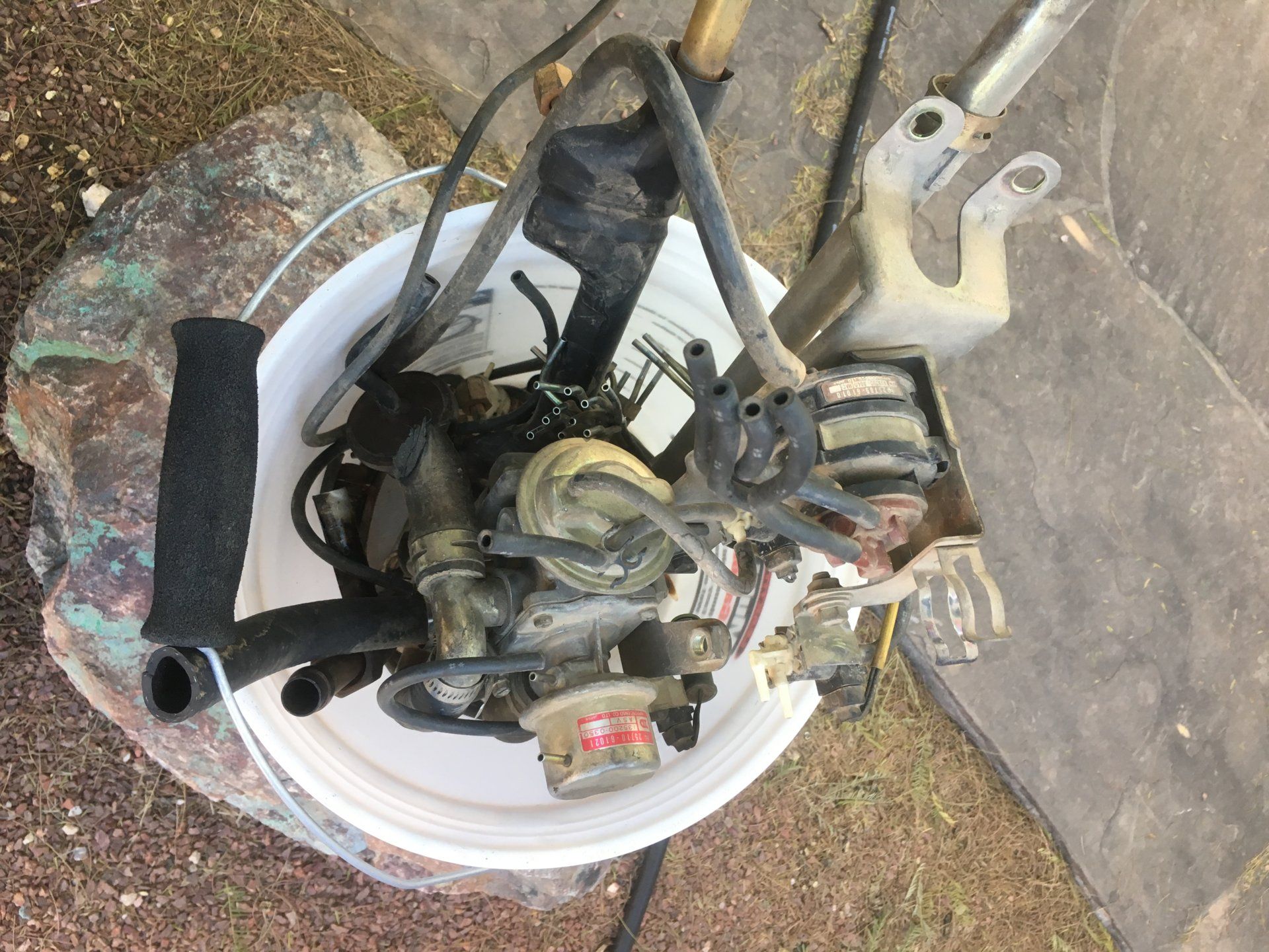

Lastly, I wont be needing this googly-gop. Making a trip to the recycle bin to toss all this unneeded, perfectly functional smog equipment. Glad to see it go in the garbage. See you hell, Global Warming.
