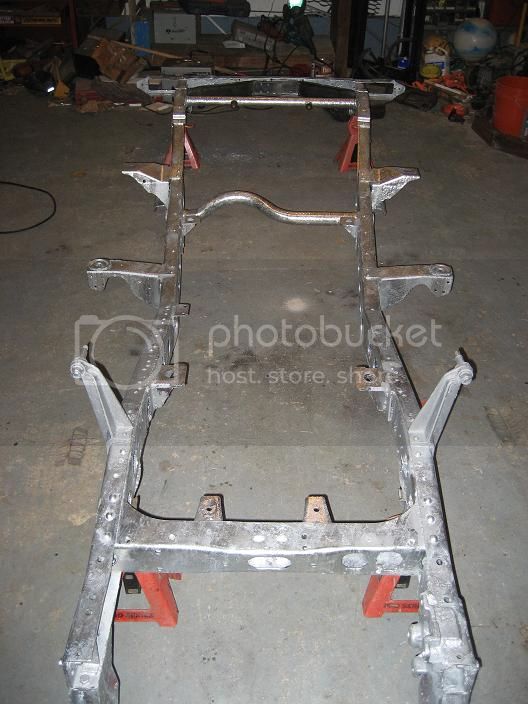

I am just getting ready to mine.... here is the processing I will be following:
- Sandblasting
- Double Dip Galvanizing
- Retap all weld nuts
- Sweep blast to remove any zinc oxide
- Power coat
Total cost is $900 for all of the above performed across 2 shops.... I will do retaping of the holes.
Figure it will outlast my grandkids with this technique

"Sweep blasting" please explain
Sweep blasting is similar to sand blasting but at a much lower intensity. It is used commonly for galvanized products that will be coated or painted. It removes the oxides that form on the surface of the zinc galvanizing and enables the coating to "take to the surface" it also roughens the galvanizing up a bit to provide better adherence. If done properly it should only remove about 10um of thickness from the surface. It is typically done at lower pressures (ie. 40psi) and finer media than what is used for sand blasting. This is to control the amount of zinc removed and not damage the integrity of the galvanizing layer. It gets its name because of the nozzle handling technique, where rather than directly swirly or slowing moving the nozzle, you use a sweeping motion over the surface. It was set out as a requirement to me to by the power coating company that will receive my frame from the galvanizer and indicated it would need to be sweep blasted... They are charging me $150 to sweep blast, where as the initial sandblasting was $275.

Rays Custom Rides, north of Hillsborough. Paid 650 which may be a bit high but this frame has more welded to it, older POR 15 had to be blasted off and I really like these guys. Probably will have them paint the body panels when ready this spring.
It cost me $250 to get mine galvanized and I had it back the same day. Seemed like people were wondering the cost. Saved a lot of prep. They dipped it in HCL to etch it and molten zinc to burn everything off. Came out nice.
