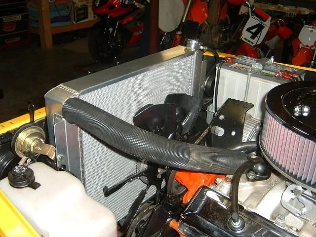

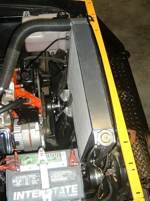

I am using an aluminum 29" radiator from Summit Racing along with a Black Magix Extreme electric fan I have never gone over 205 degrees, even on a 100 degree day. Most of the time I run around 190 degrees with a 180 degree thermostat. See pics below.
Radiator cost = $179, electric fan = $250, new thermostat & hoses = $45 ...having a properly cooled V8 in a landcruiser, PRICELESS!

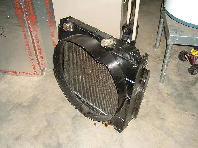

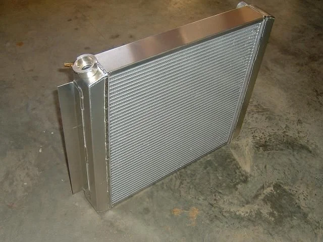

...gotta a star...more pics

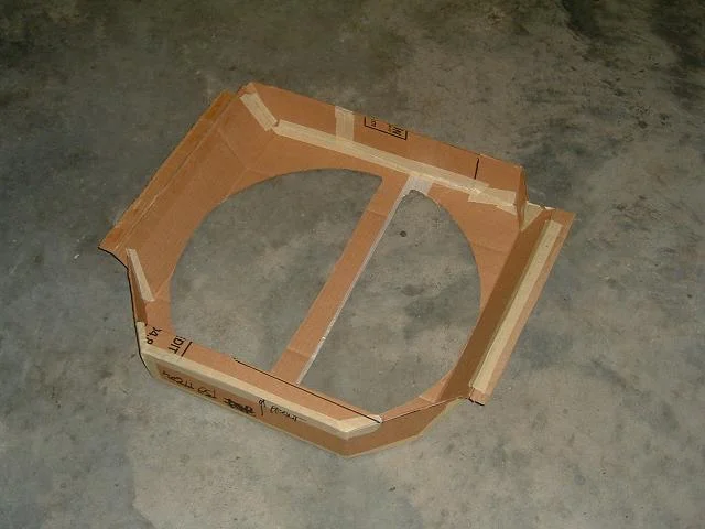

...and my planned shroud. Can anyone recommend someone that could make this from say 0.060" aluminum for less than my first born?
