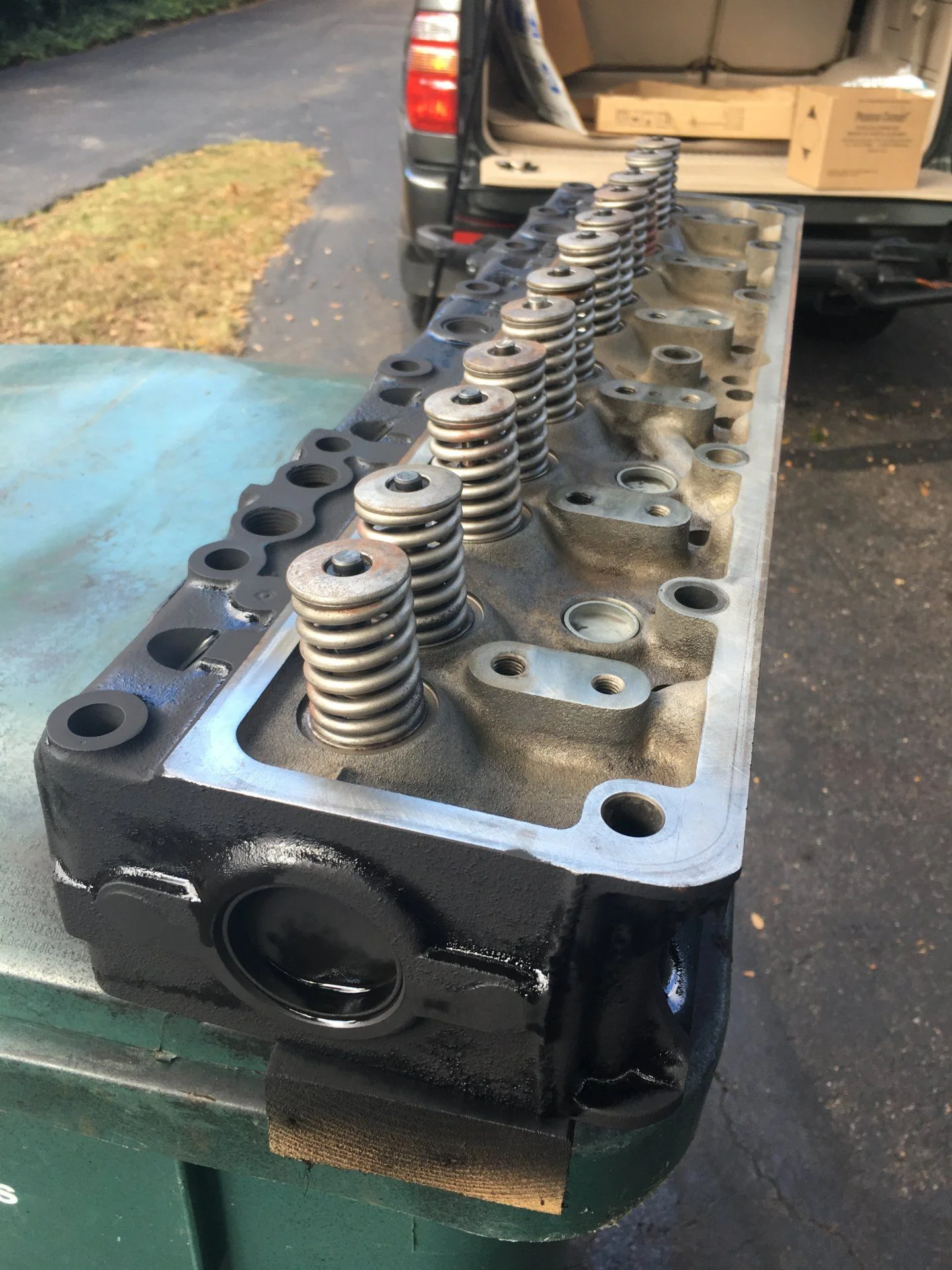

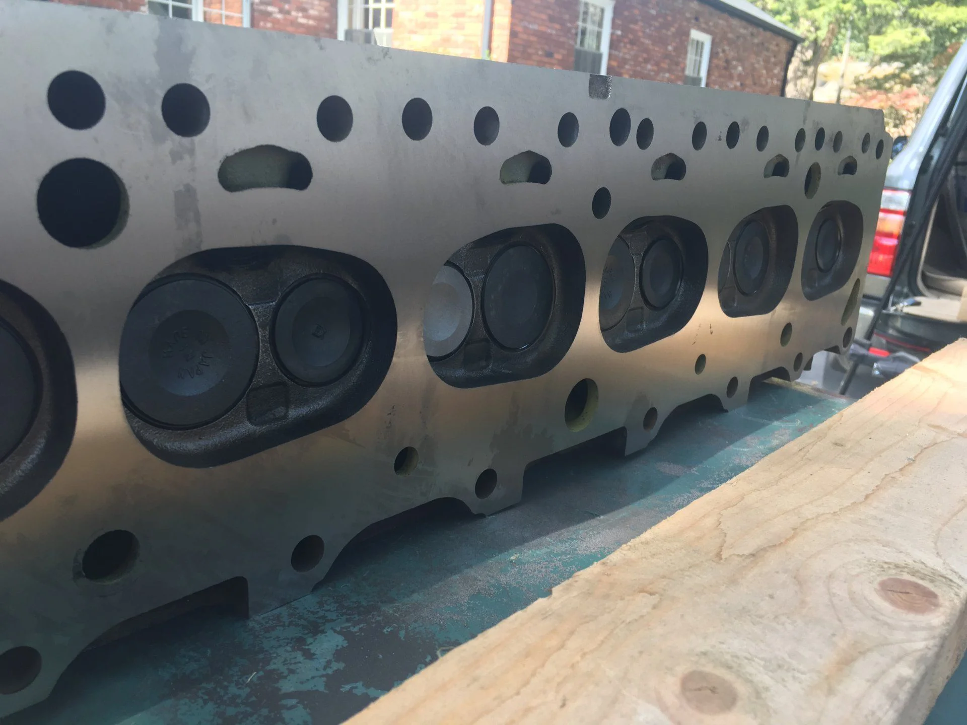

Also worth noting - Blue saved the life of a 40 through the organ donor program. The 40 had fallen victim to an ace crackhead mechanic that rebuilt its cracked head (but didn’t fully fix the crack), put the head gasket on backwards (so there was no oil flow), and then left the valves so loose that a pushrod was able to jump track and get mangled.
Blue’s head was rebuilt (with the better valves & springs from the 40), and assembled w/Blue’s pushrods & rocker assembly.
Successful head transplant!
