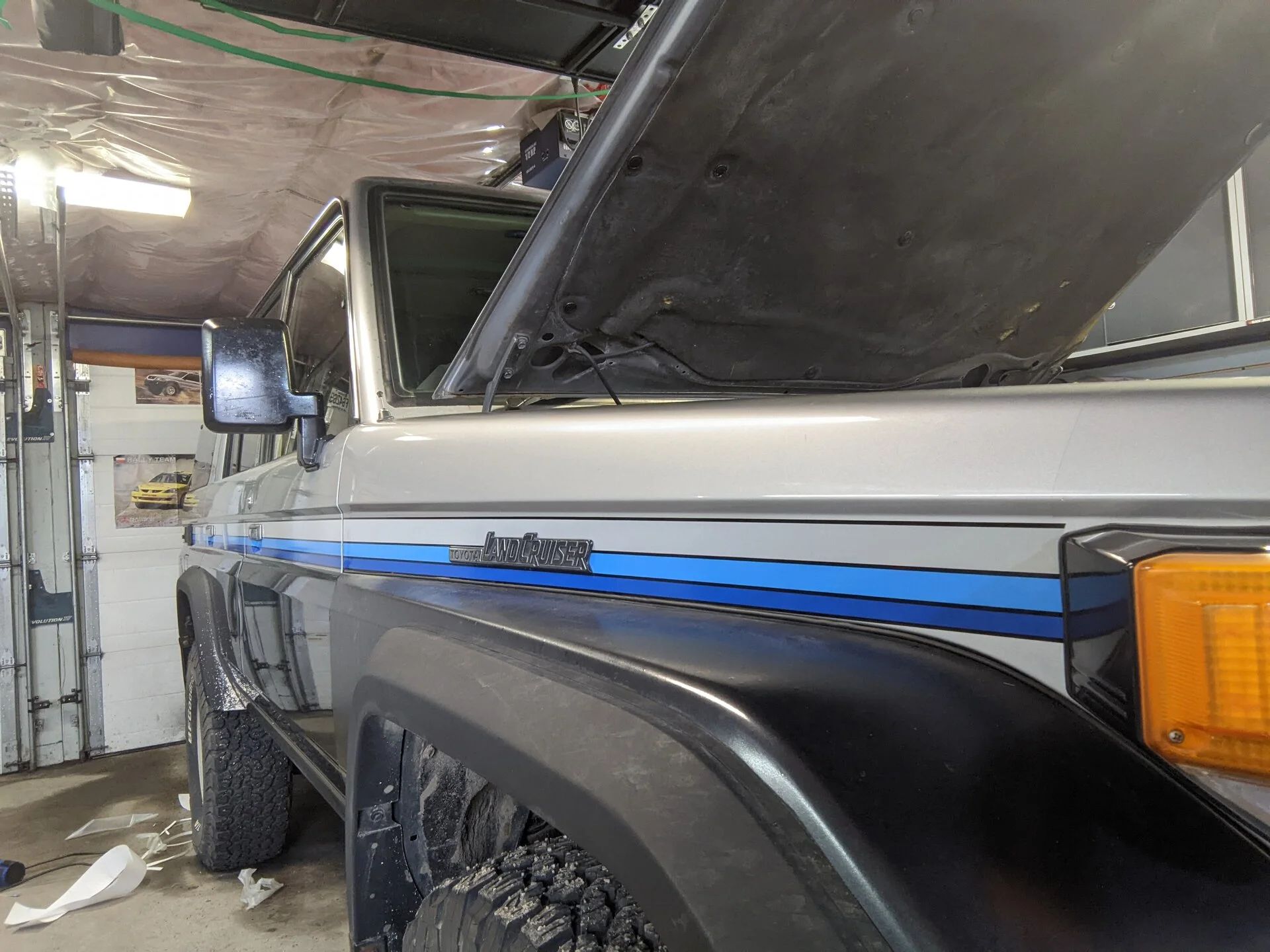

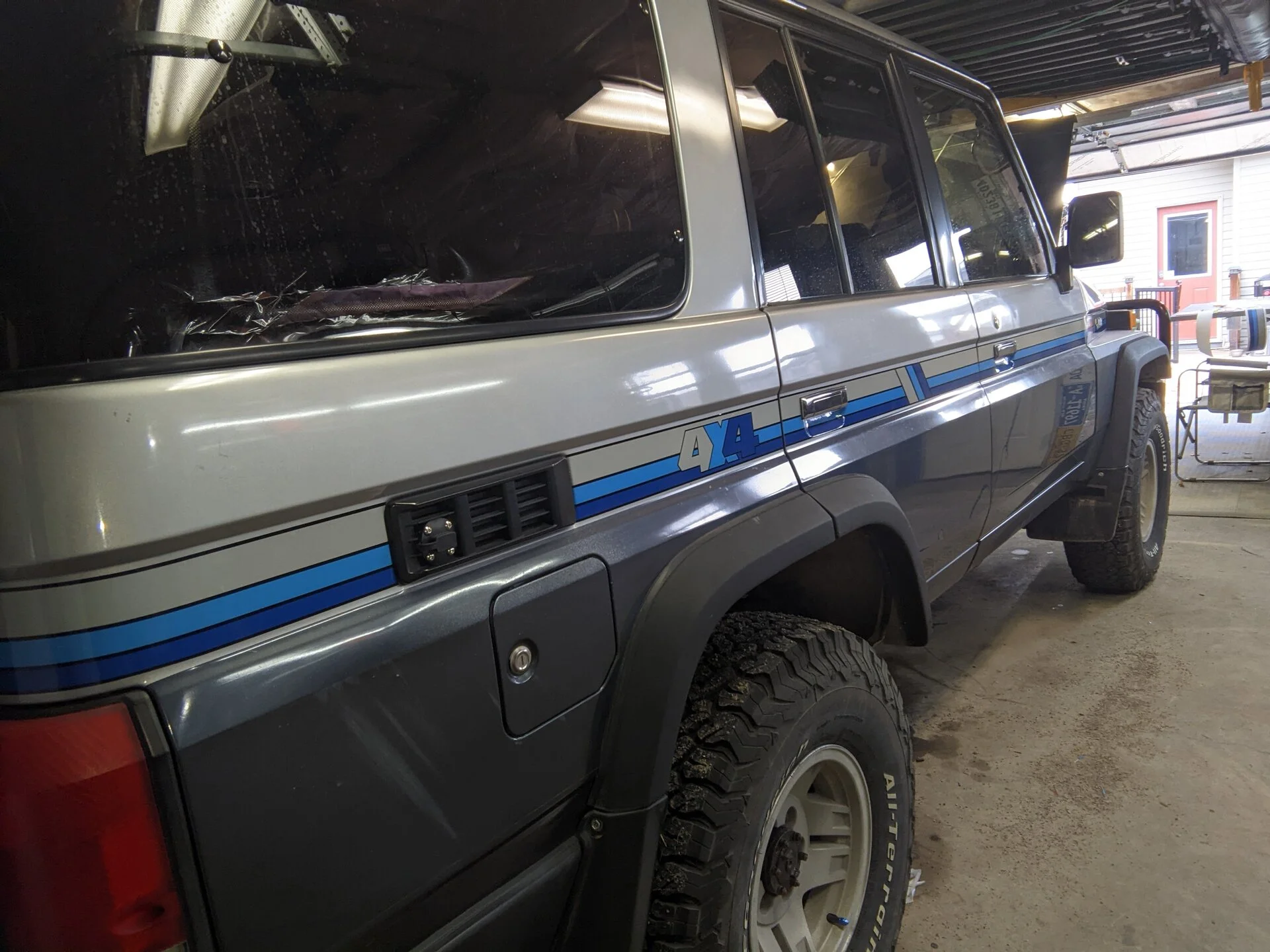

Oh man door handles were tough. Decided to go into the scoop below the handle with the stripe. Some conservative heat gun action did the trick.
RHS is now complete.
Oh wow this is painful. If anyone ever decides to tackle stripes, think long and hard about putting it at the beltline. Door handles, badges, intakes... It's all in the way. I think aesthetically it's the right place, but holy crap what a giant pain in the...

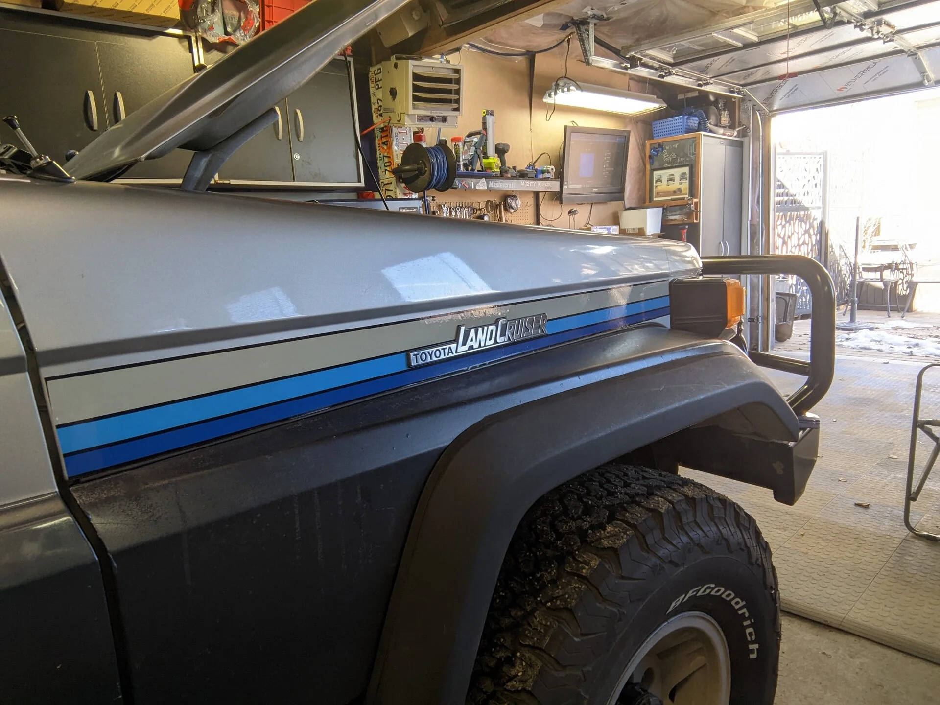

Front fender on RHS is done. Working on the door now.
Man... I hear you. My wife will often comment to me about my patience, but I am 100% convinced that this would test mine.
That said, I will be honest - I wasn't sure about the whole idea as I don't even like stickers or dealership stickers, etc... I spent hours when I got my land cruiser removing them.

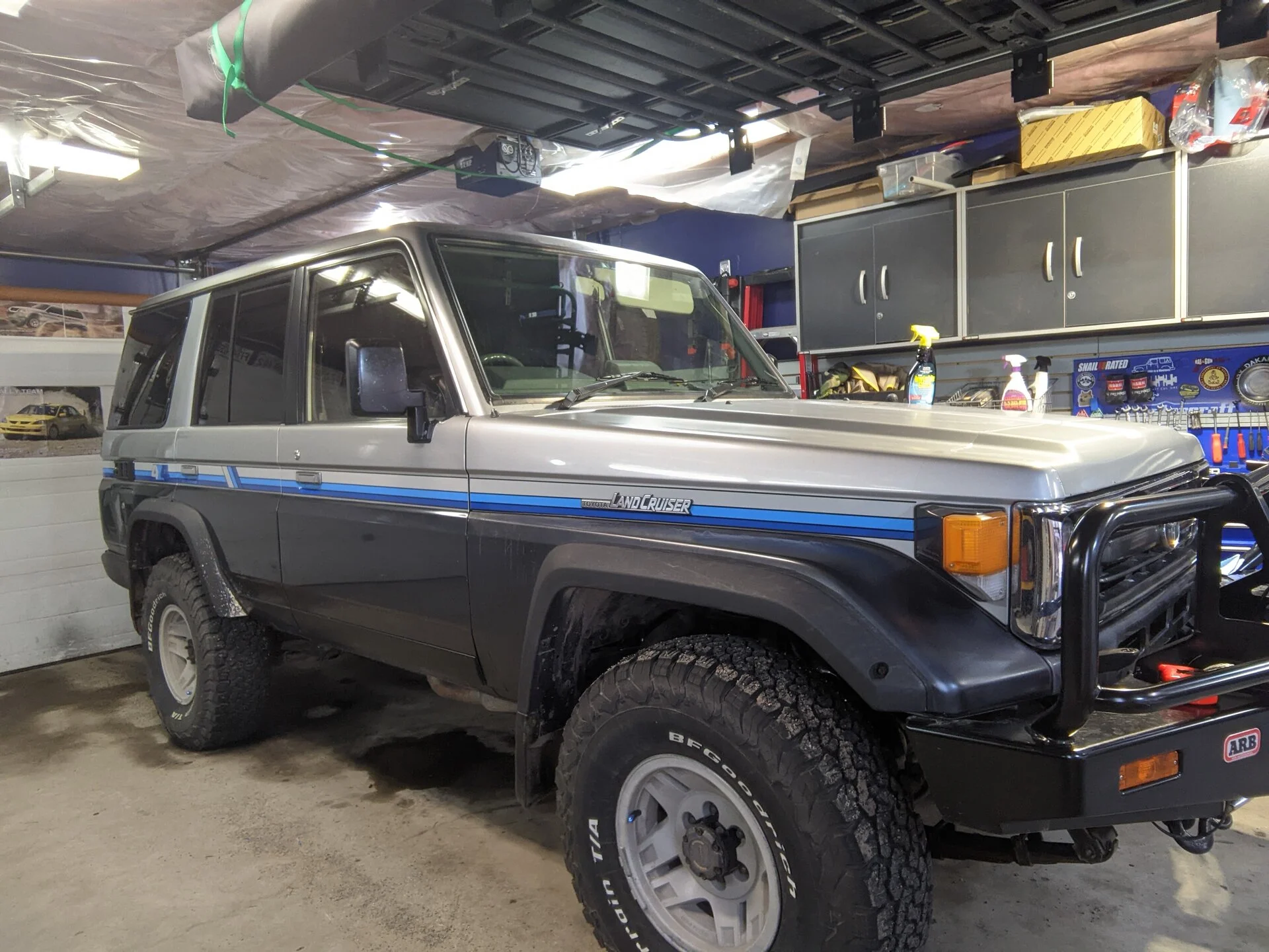

Looking at the one fender done, I have to admit, that looks really good on there bud!! :bounce:
I definitely think stripes are a hit or miss, but in this case, the two tone always seemed to be crying out for something to break up the belt line, which always looked too low to me where the silver started.
I think this little add on will allow me to accept the two tone, until such time as I get a full respray. But that might be a long time coming, if ever. I'll redo the hood and roof, finish the wheels, and call her pretty enough for now. 😉
Also, everybody knows that stripes add horsepower. 😚

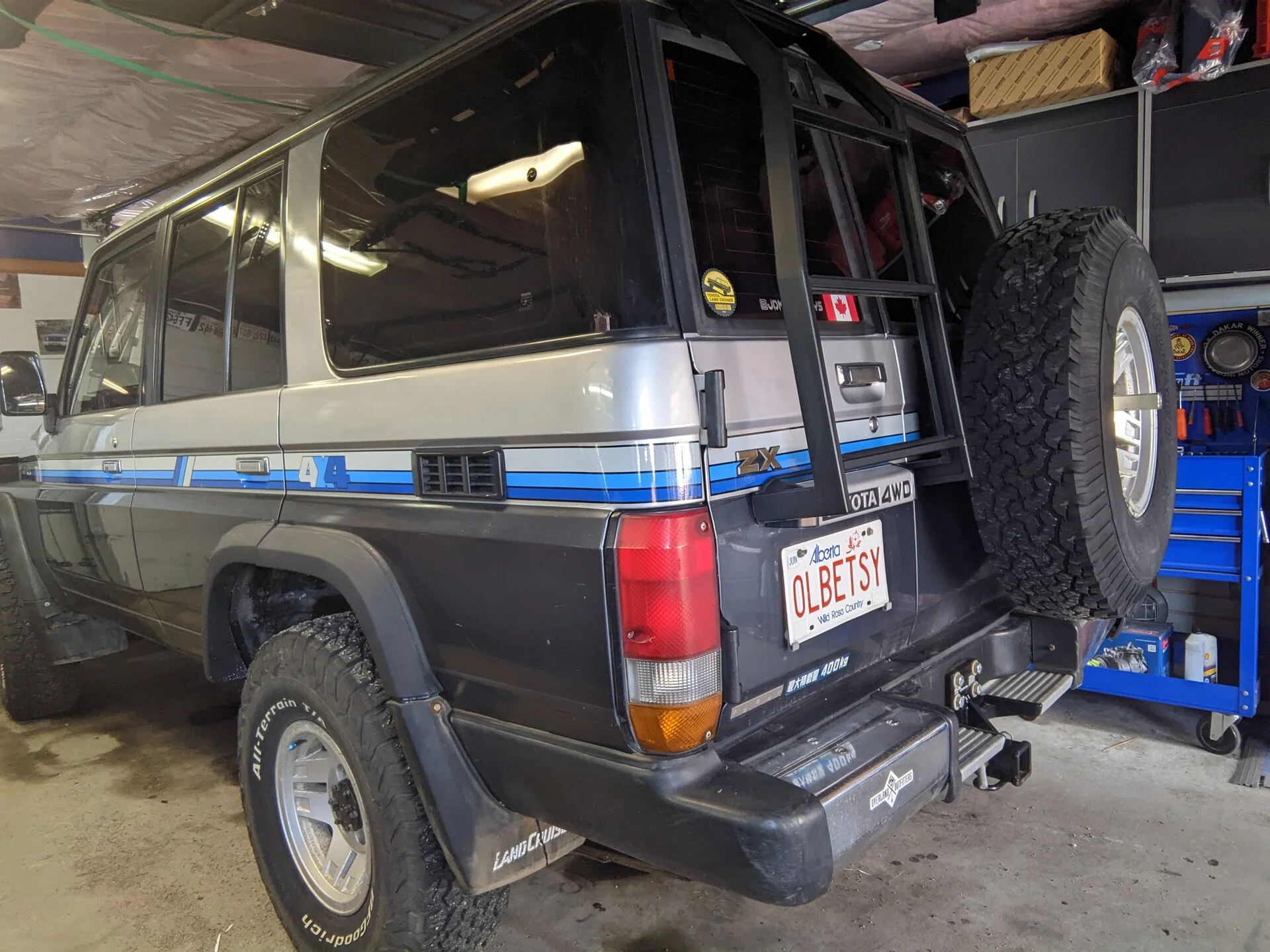

Oh wow the corners were tricky... Bottom radius is different from the top so some pulling and stretching was necessary. Still not quite to my satisfaction but I only ended up with about 3 inches of excess material when it was all finished so I couldn't take too many chances. It's so so.
But overall I'm happy with the retro vibe. It might be more leftover 80s than early 90s, 😂 but I'm old enough to be considered ummm... experienced in both. As well as the decade before. 😉

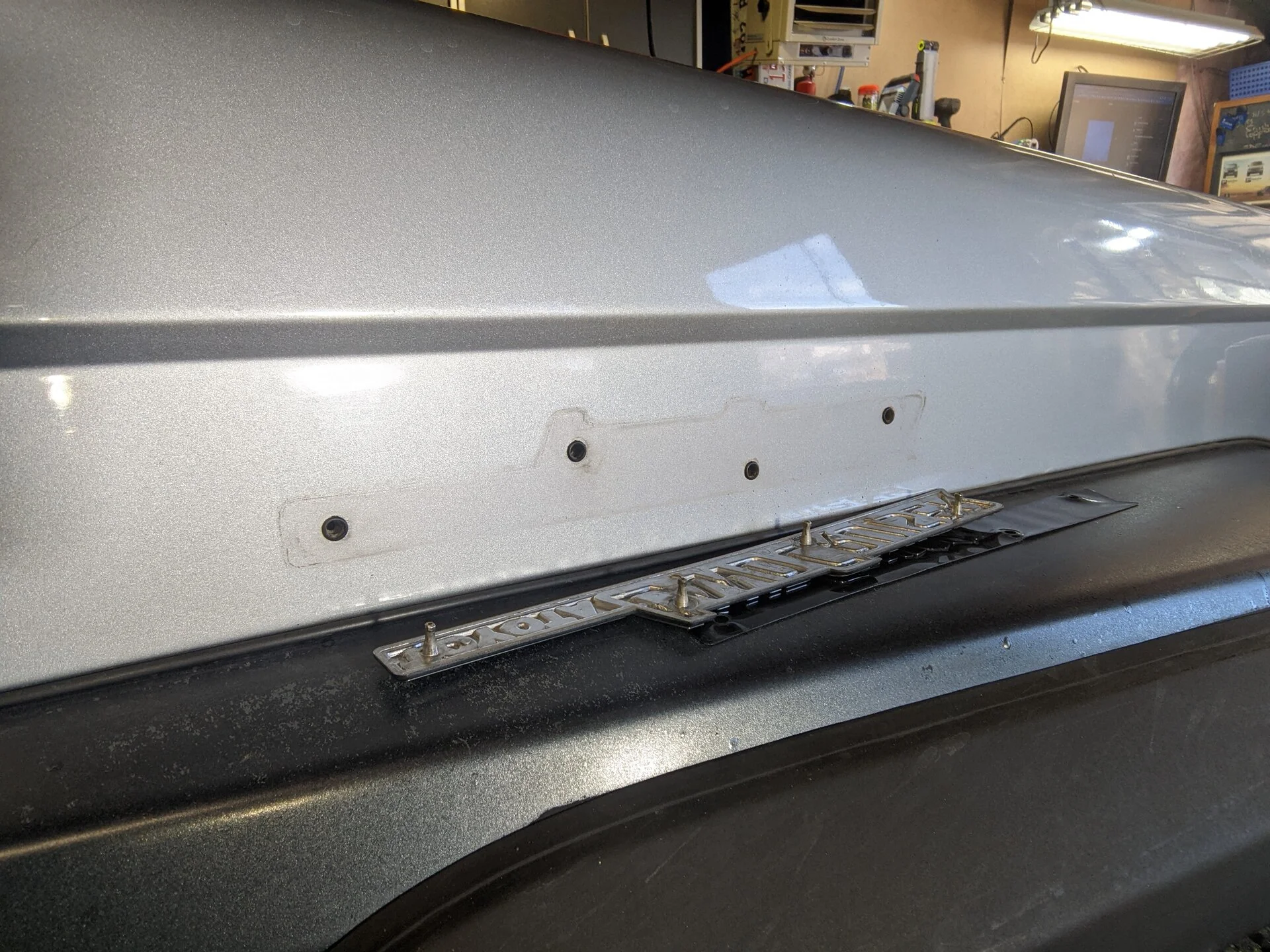

For those wondering. The side badges are pinned and easily removed with a plastic tool.
But the zx badge on the back is taped.
Overall I'd put this job up there with bodywork. Finicky, unforgiving, and endlessly time consuming. Even after you lower your standards, turn the lights off and squint ever so slightly. 😎
Time to take her out and put on some c&c music factory. No. Maybe van Halen. Pre-Sammy. 😂
Oh wow the corners were tricky... Bottom radius is different from the top so some pulling and stretching was necessary. Still not quite to my satisfaction but I ended up with about 3 inches of excess material so I couldn't take too many chances. It's so so.

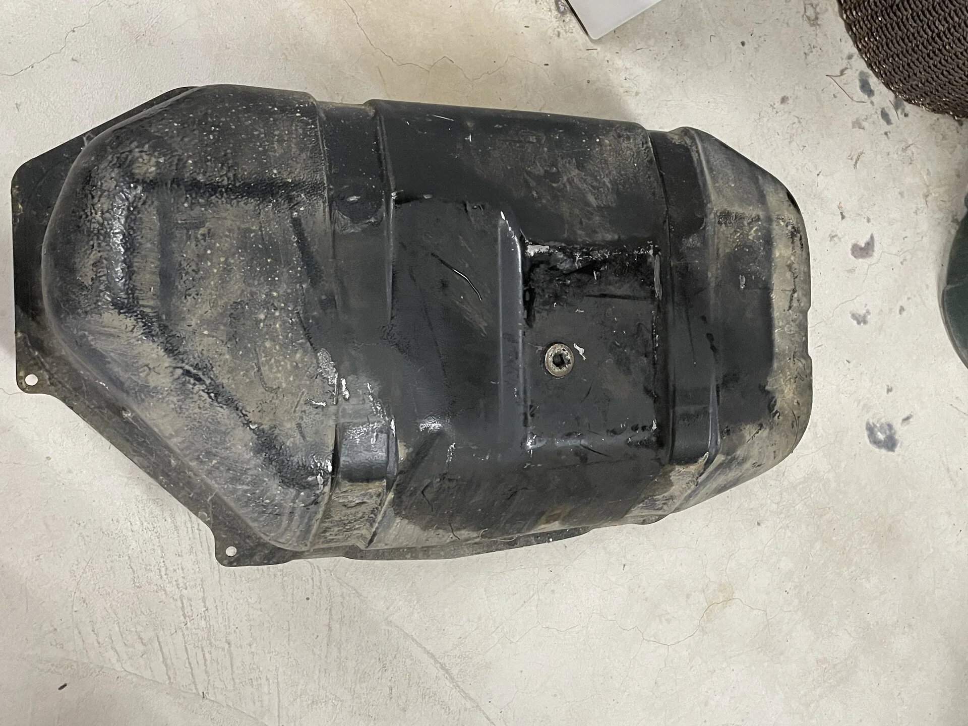

So the good news is that the tank is clean inside. No rust at all! The bad news? I just got fuel the other day. So I had to somehow find a place for 80L of the "good stuff", and I also had to get it out of the tank. My shake siphon ended up in the bin. My fancy new vac-siphon sucked up fuel and then dumped on the floor. Finally, I resorted to the drain plug and a bucket.
So my afternoon was as follows: Fill bucket. Drain into jerry can. Repeat. Repeat. Repeat.
Also got all the lines except the main fill tube off the tank. Sending unit is out. But the mini-highway of tubes, valves and pipes coming off the fuel filler is in rough shape too. So much so that I'm worried I may not be able to get the rubber lines off without damage. I couldn't find this item when I ordered my suction tube etc yesterday. So today I did some more digging, and supposedly stock exists in japan? I'm waiting for confirmation from the supplier, and then it'll also be on the way. Fingers crossed.

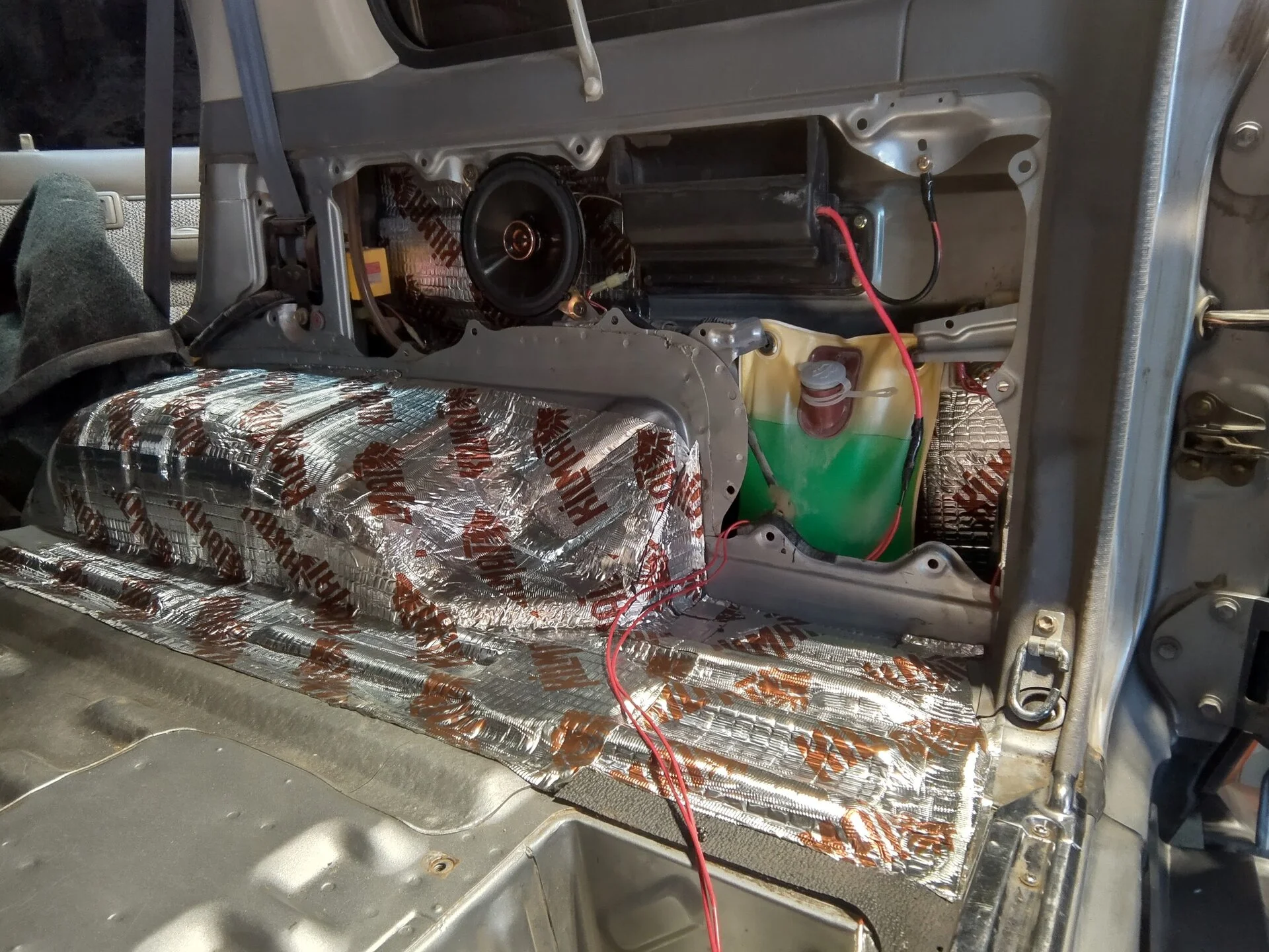

While I was babysitting the buckets, I decided to take advantage of the empty space in the back (all my drawers, elec system, third battery, water tank/pump, carpet, insulation, etc are out and sitting on the table in my garage) and do some more sound deadening. I had planned for this all along, but didn't want to pull everything out at the time to do it. Now that I had to? Well, may as well make the most of it...
Right rear wheel well is now covered in Kilmat. Back in Dec/Jan I put some on the inside of the outer walls in the back, if you recall.
Tomorrow I'll do the other side and then see how much I have left for the floor. Still want to put a square in each door, but I have enough apart right now as it is.

Thanks. Mine is 100% clean on the inside. We'll see how the outside fares tomorrow hopefully, when I take it down.
