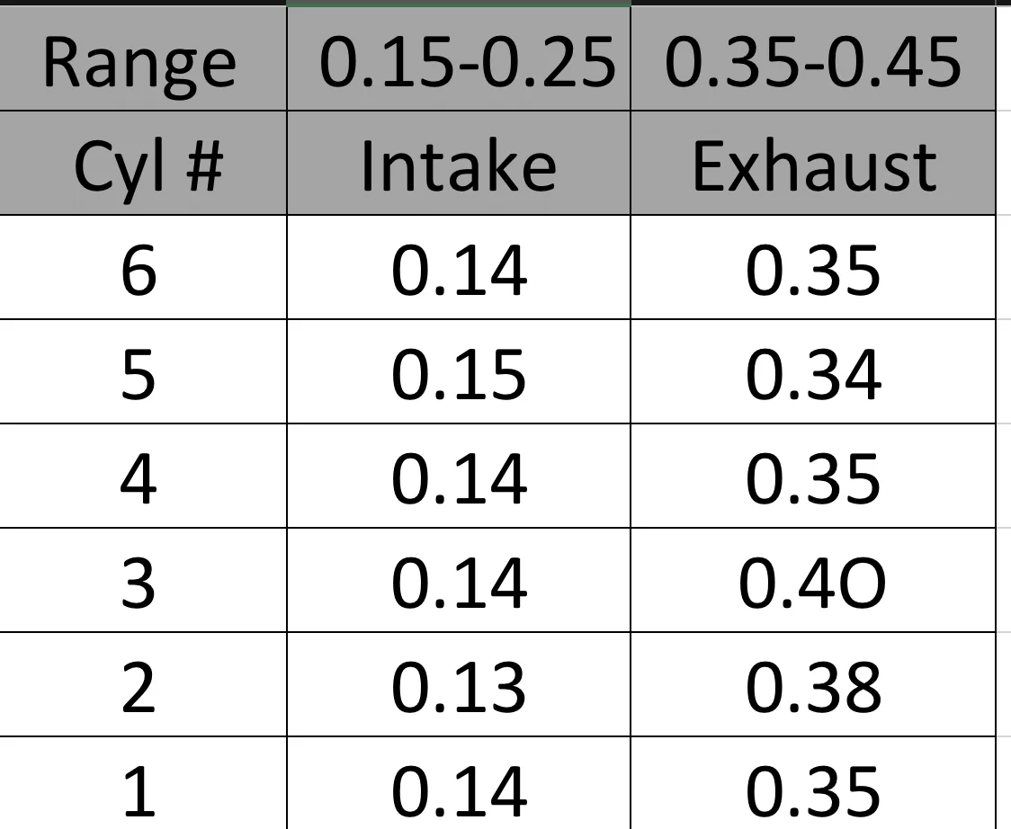

Here are my valve clearances from a year and a half ago (maybe 15k kms or so?)
Any insights from the gallery would be appreciated.
