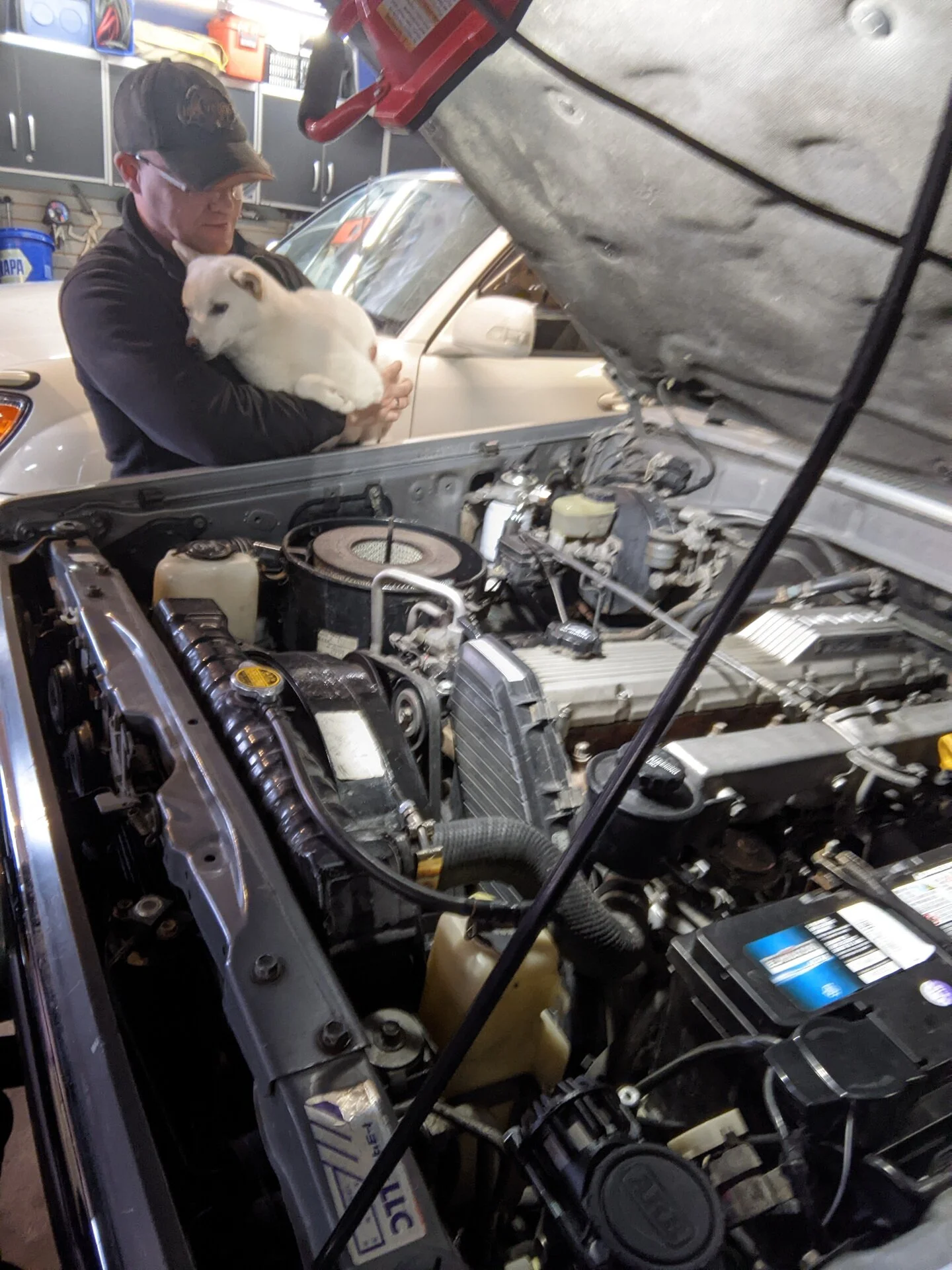

My buddy came by and let gave my little pupper a boost to look at the goings on while I reinstalled the glow plugs. She didn't seem that interested...
Fret not Phil! She is still young yet... a few more trips in ol' betsy and she will be excited every time she sees it! 😜

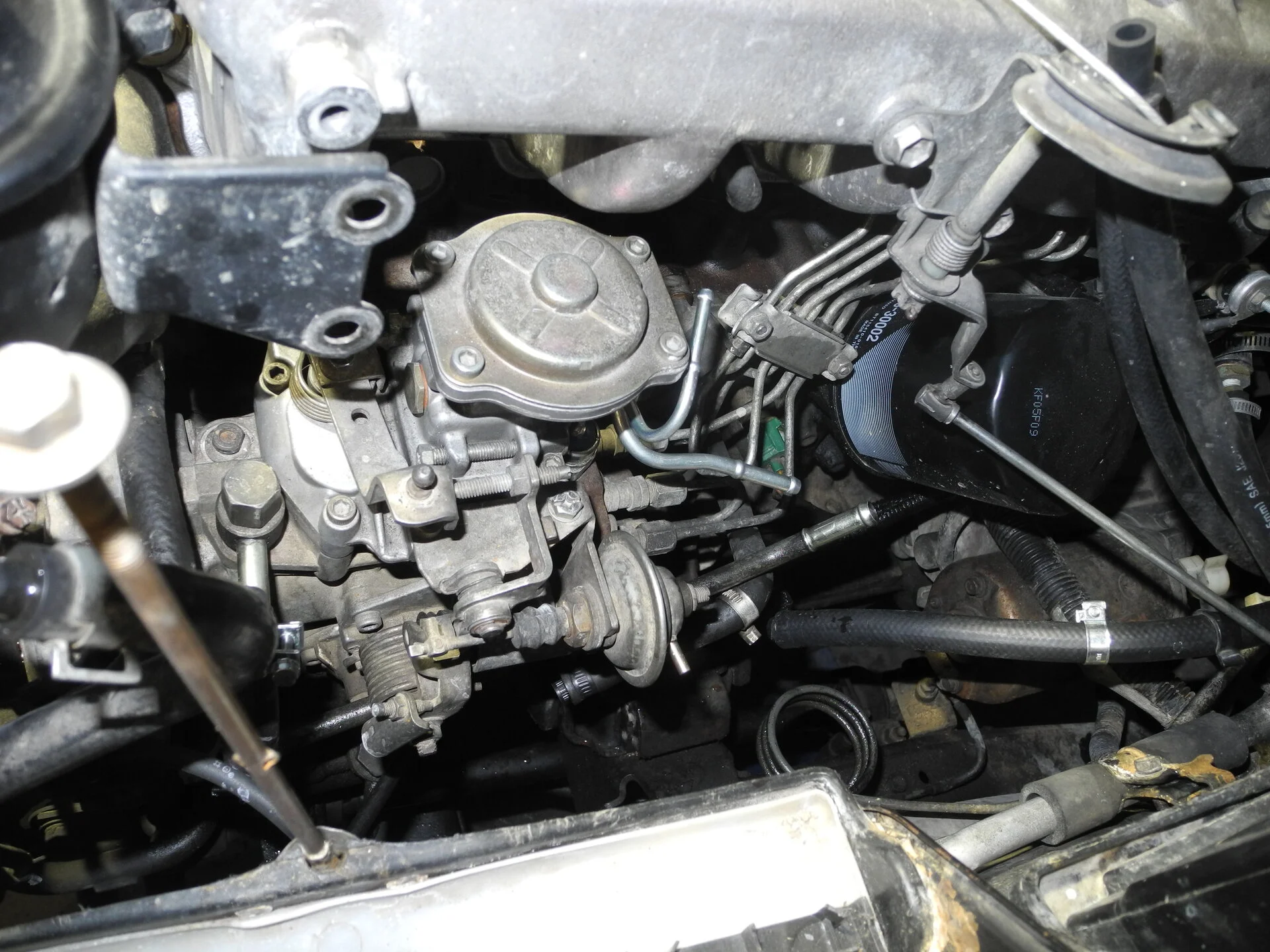

Today I ordered a flat puller so I guess technically I'm closer to pulling the pump?

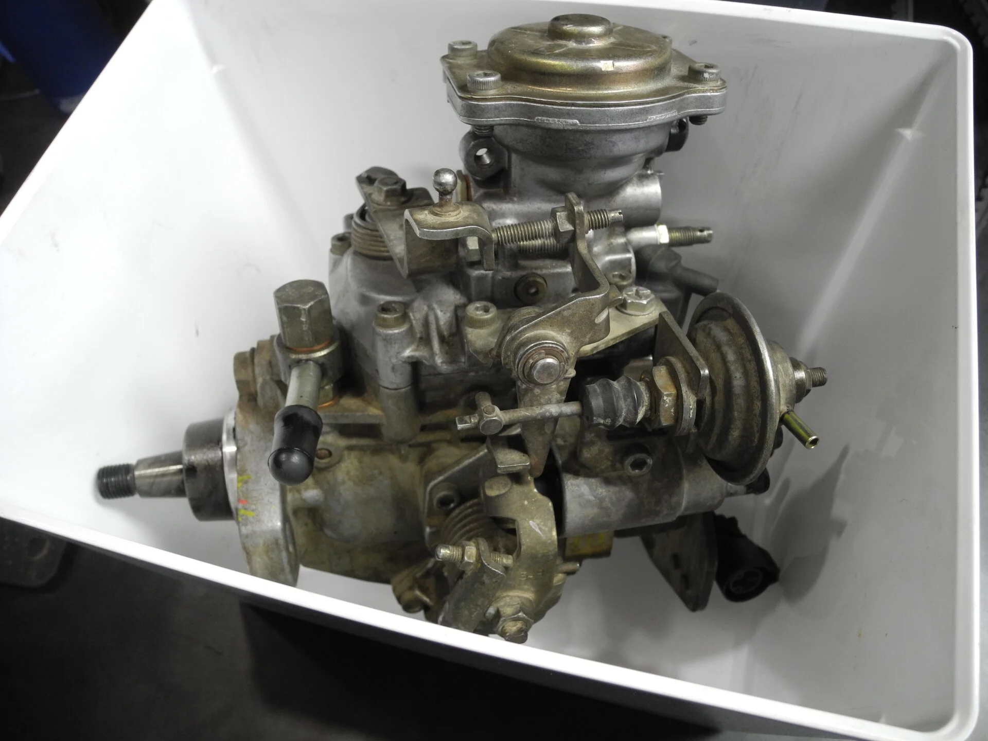

That was a messy, difficult process but today was a productive one... undid all the hoses etc going to the IP...
Timing belt and all associated bits got pulled, along with rear cover (small weep behind it).
Still need to pull the waterpump.
Then I got after it with my puller, and suddenly there was a pop, and the drive gear let go of its grip and before I knew it, this was sitting on my bench...
I'm sending it *somewhere* this week for a full go-through/refresh.

Huge congrats on getting your injection pump out! We are all super stoked to see the end of the story.

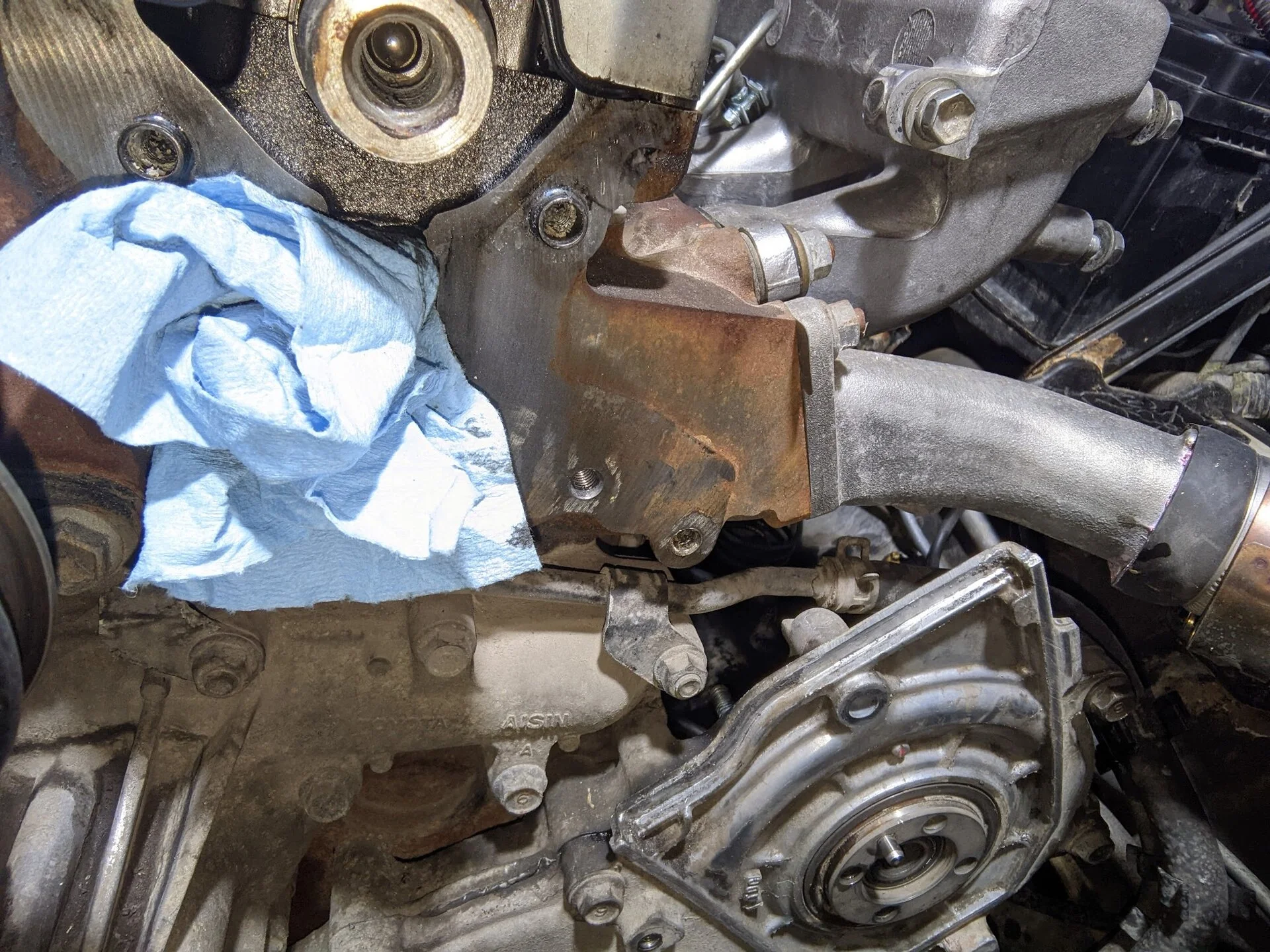

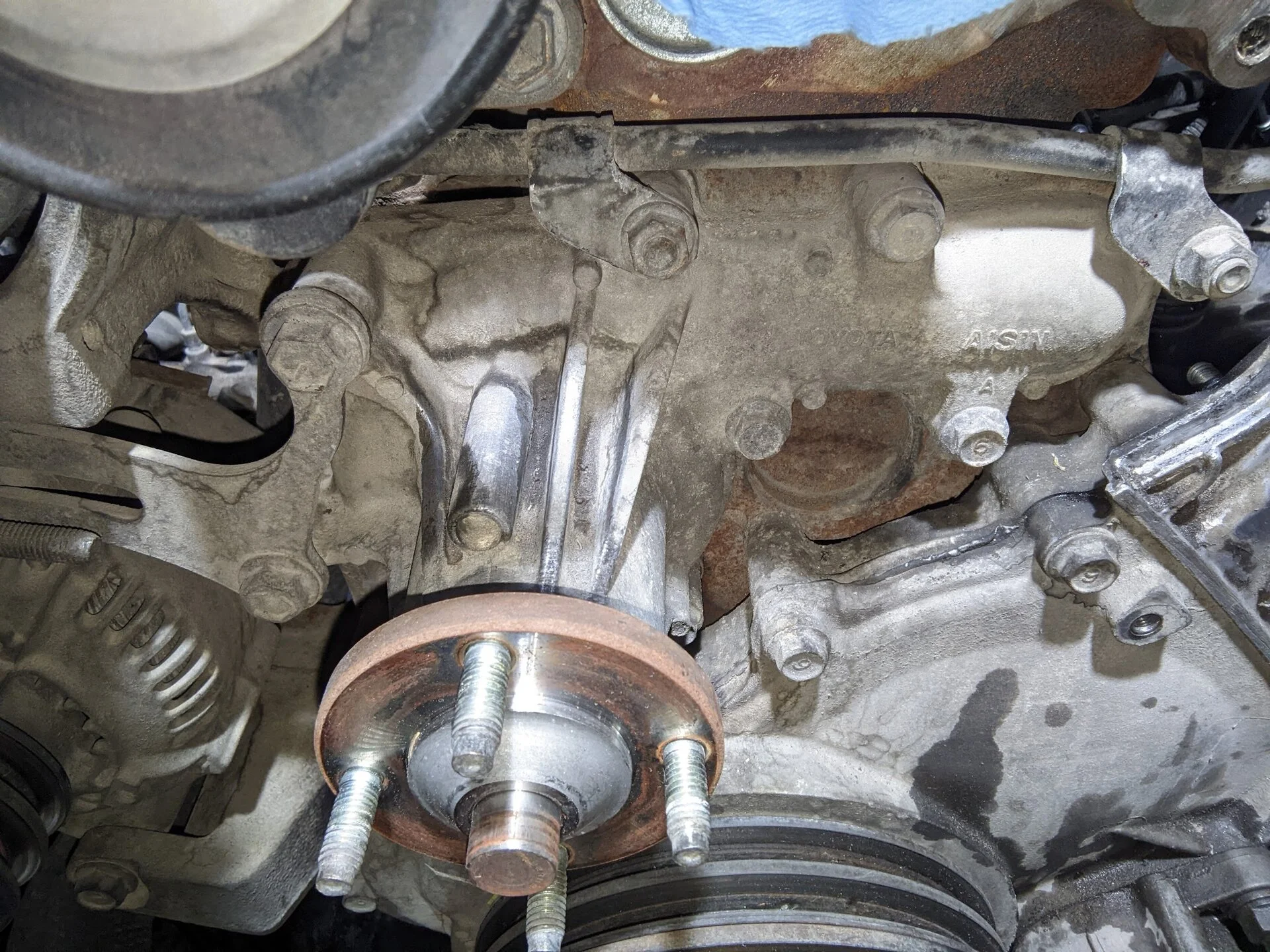

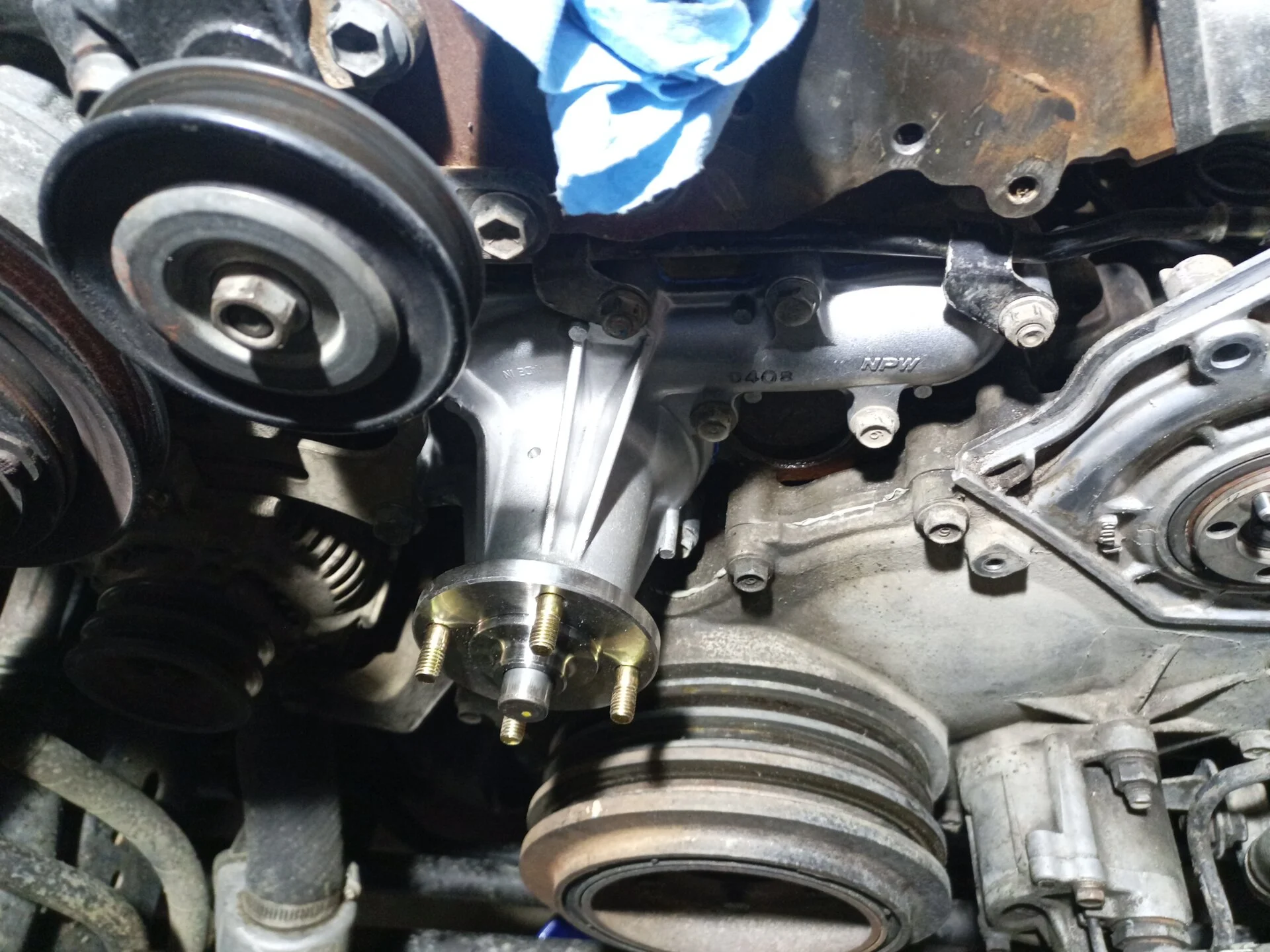

Water pump is now out! It wasn't terrible to pull, but did require the alternator bracket to be loosened off (two bolts on left) , as well as a hose guide (up behind the a/c pulley assembly, accessible form the top). The old water pump didn't look terrible, and spun freely, but I'm not planning to go back in there for a while hopefully, so I may as well knock off the maintenance list?
I am planning to drive an hour out of my way tomorrow evening to drop off the inj pump at a reputable shop that is not too far. And then I hurry up and wait for parts and the pump...

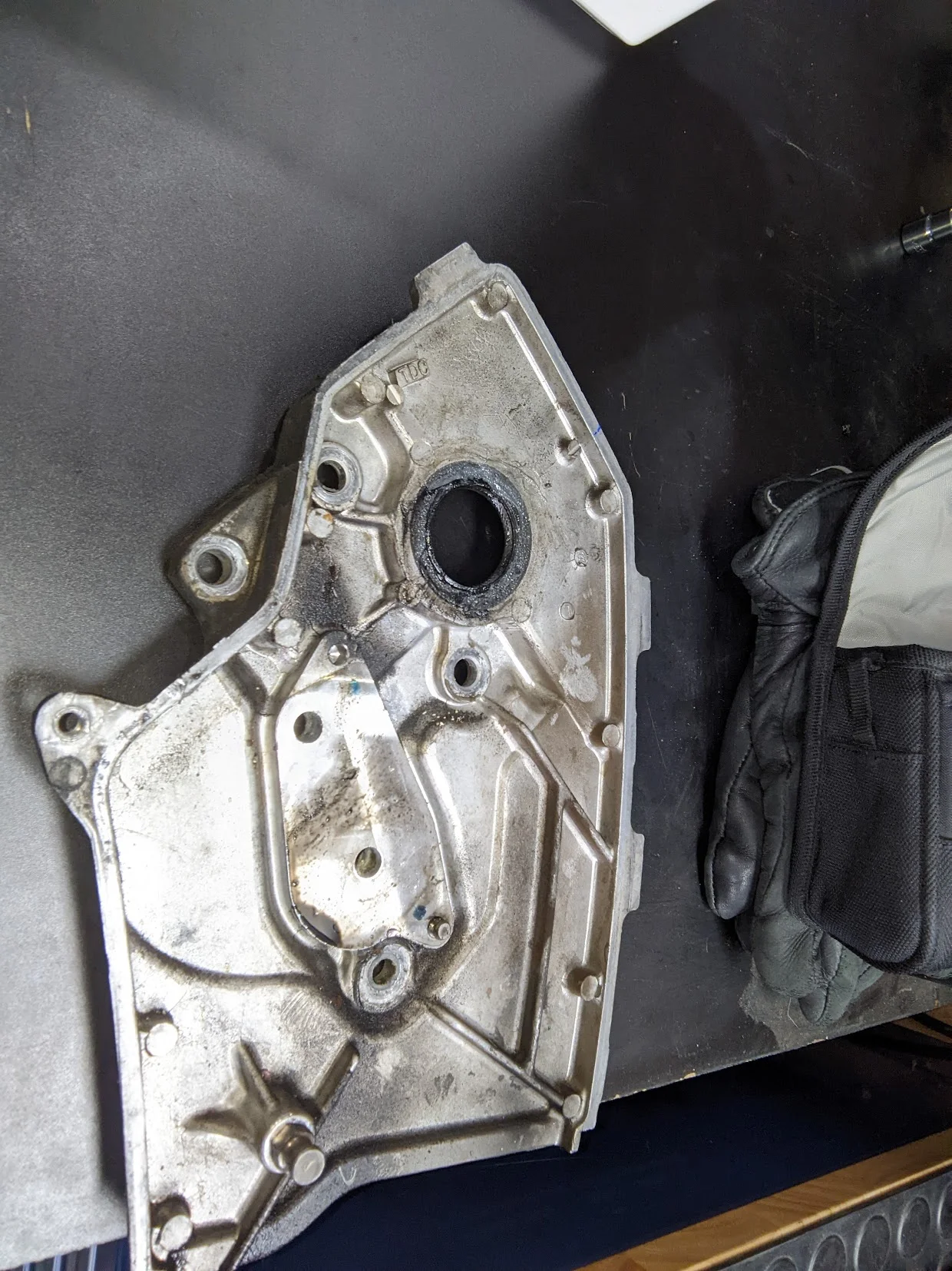

I did start cleaning, and found a lot of silicone gasket on the back side of the timing rear cover. I'll have to check the fsm and see where exactly its required, if at all. But it was leaking slightly, so I guess the sealer was no longer doing the job it was supposed to? Belt hadn't gotten contaminated yet, but it would've been just a matter of time.
New wp/gasket!

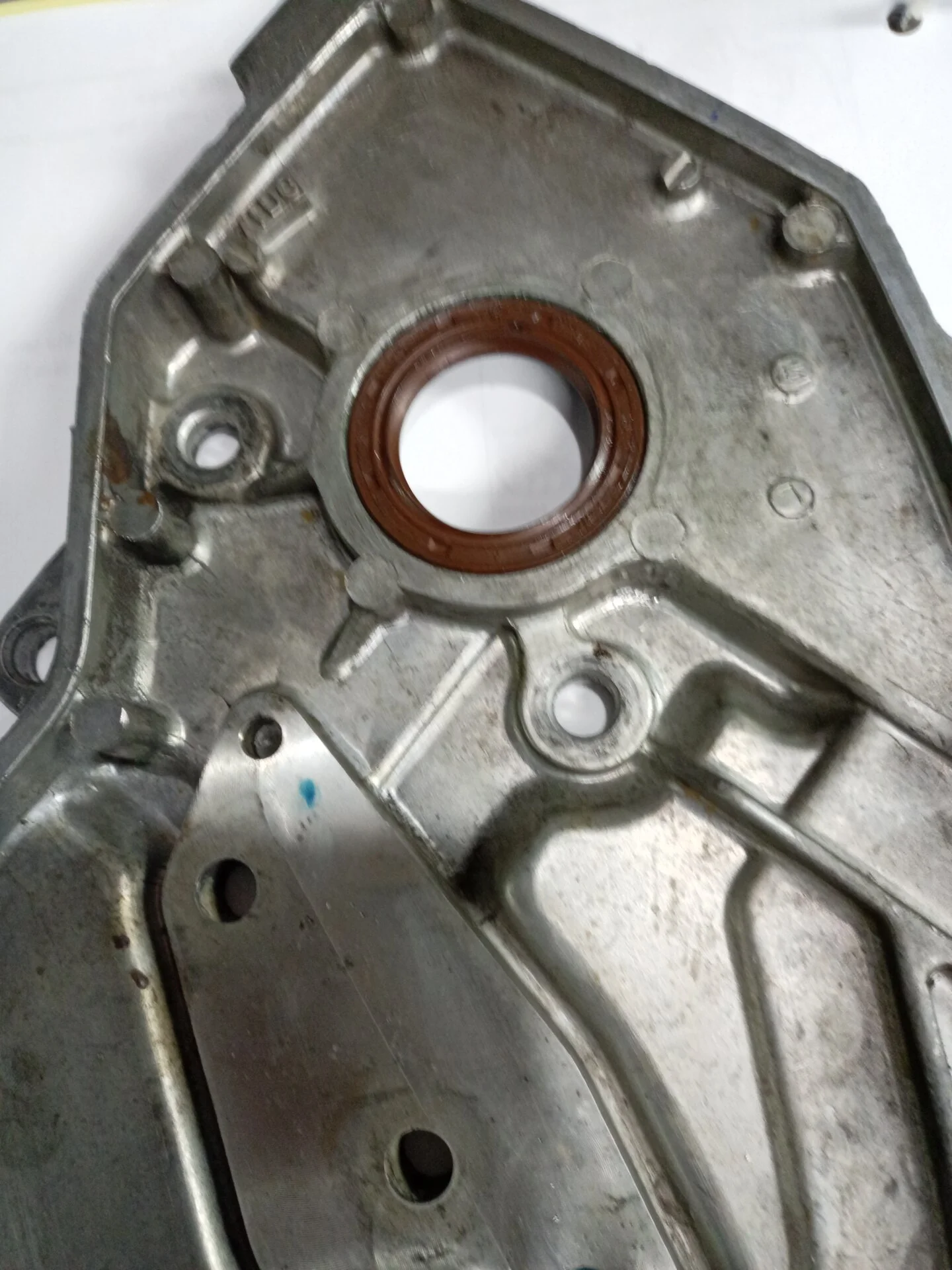

Then it was time for a new oil seal on the injection pump drive gear. The FSM advised a small screwdriver to lever out the old seal in the case of replacing it in situ.
Nope. That wasn't happening. I ended up firing a small self drilling screw into the seal and then pried it out using a small pry tool. Then it POPPED out so quickly that it fell into the jug of coolant down below. LOL. Isn't that always the way?
When I put my new seal in it went in slightly crooked, even with a seal driver, and I had to go a little further in than I wanted to. FSM says to install it level with the face of the lower cover. But I'm in about another seal's width. I'm pretty sure I'll damage it again to get it out, but it's sealing the inj pump from the other side of the cover, so I'm thinking there isn't really "too close"?
Finally, I put a new seal in the upper back cover of the timing setup, where the camshaft comes through. The previous owner had silconed this all to hell as well, but if the seal is in correctly, and there is sealant where the grooves are made for it, it seems like extra mess to me?

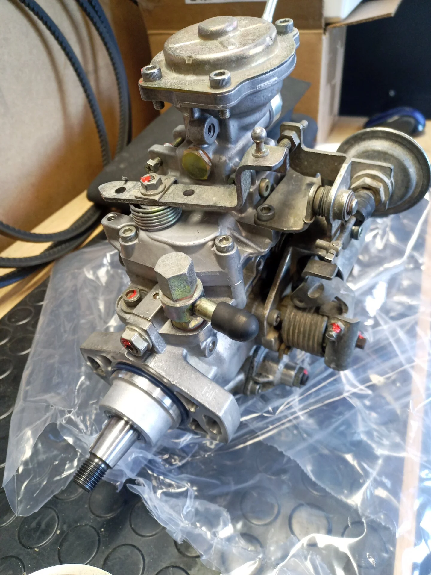

Pump is back! Finally back from the rebuilder...

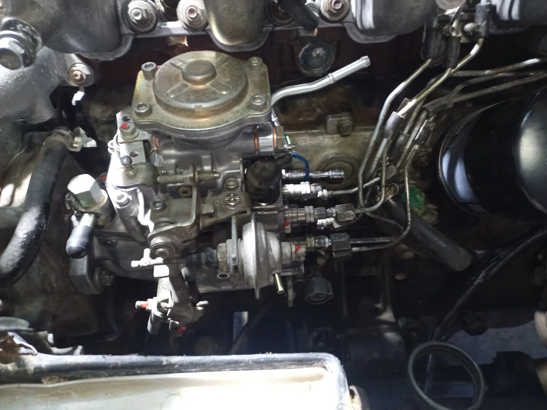

But it ain't gonna install itself! Although I wish it could. Man alive what a painful job. The injector pipes are poking you, the drive shaft key won't cooperate, the f/c solenoid wiring harness is trying to escape and meanwhile you're leaning in with this heavy, unbalanced awkward lump, trying to be gentle. Arggg..
I finally decided to rotate the crank a tiny bit in order to get the shaft through the hole (let's not mince words here) and my inspection mirror confirmed that it was settling in place.

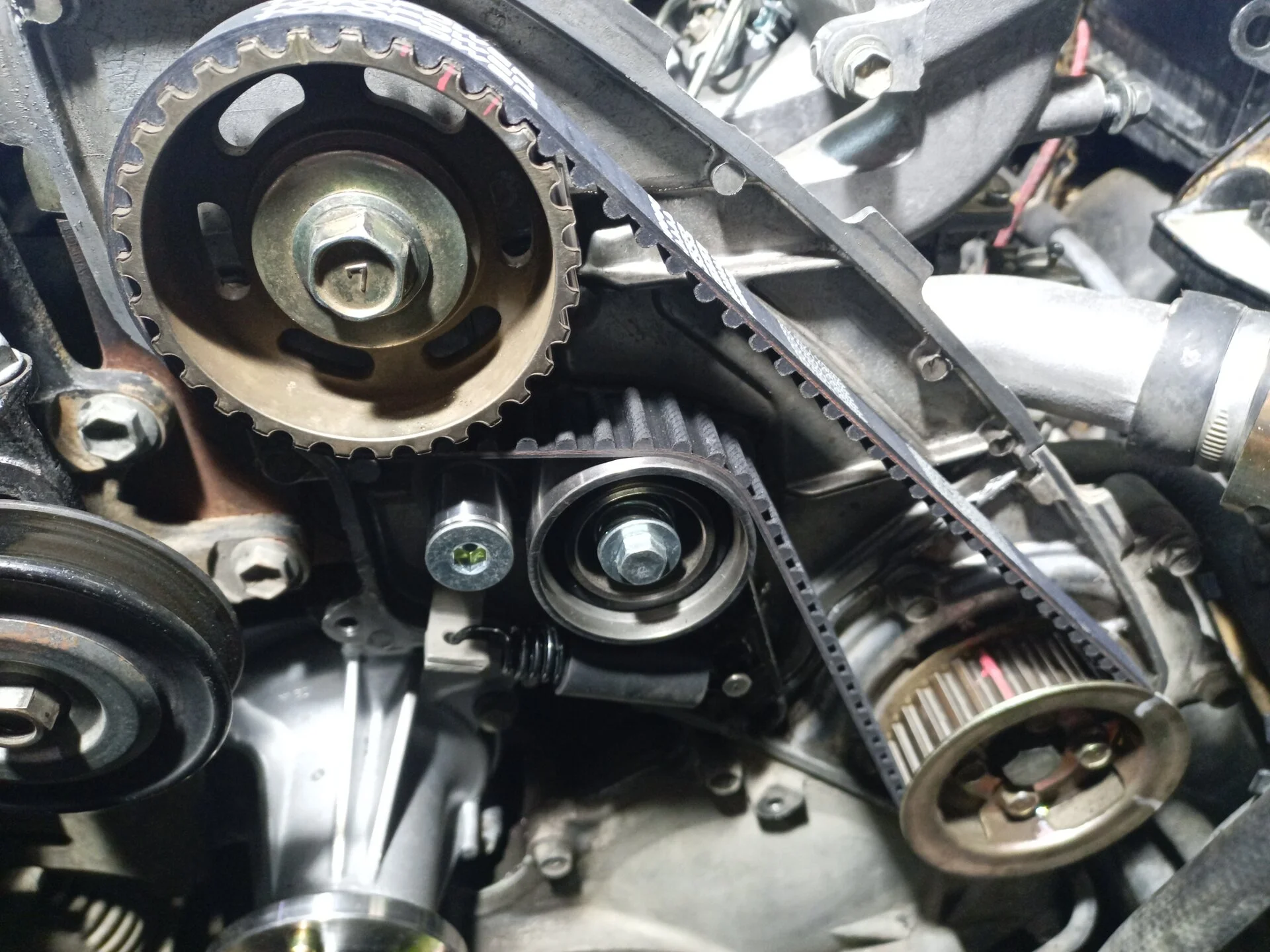

Set the timing to 1.08, did up the rest of the bits, reinstalled all the things that had previously been in the way.

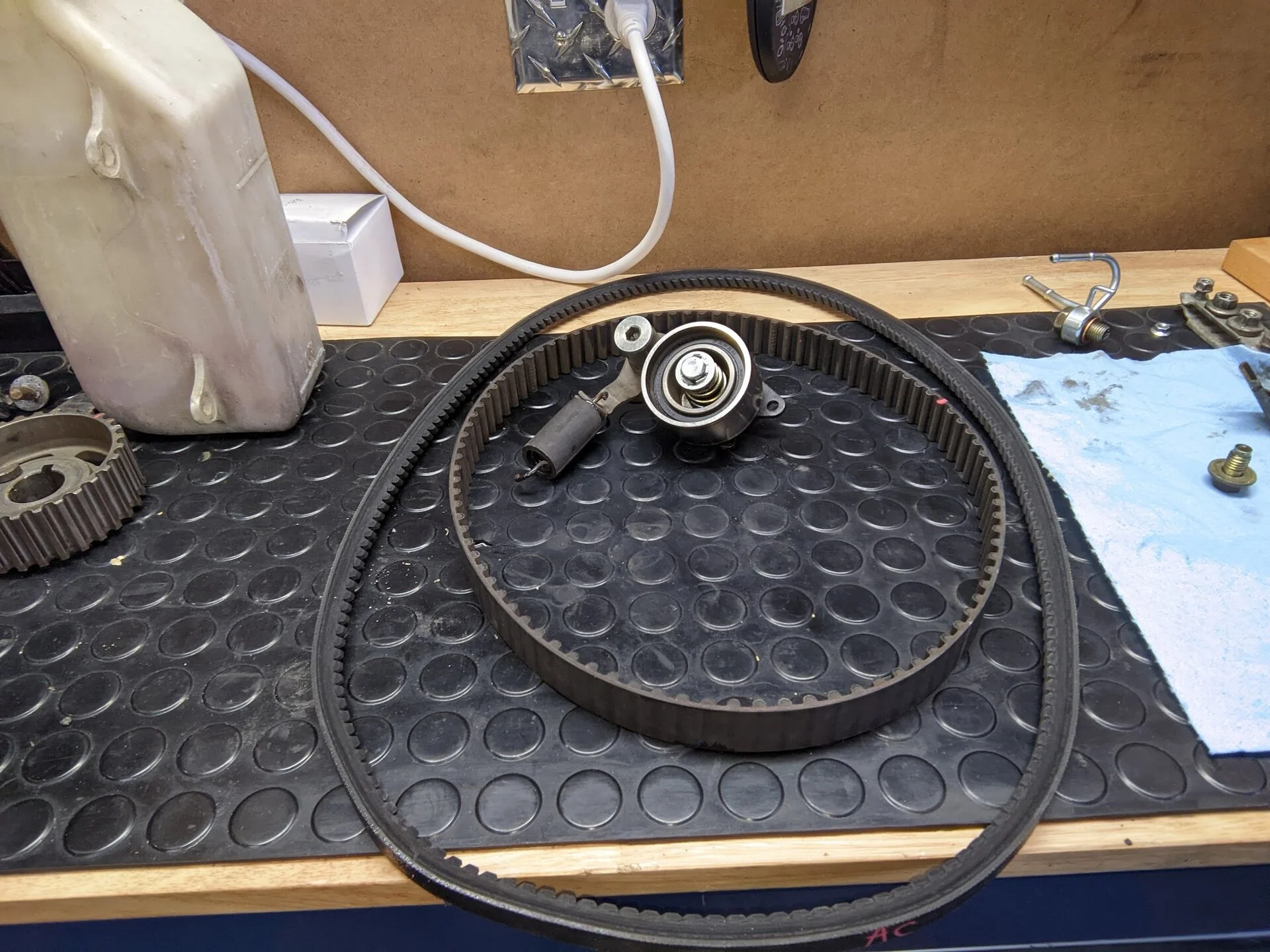

New timing belt, tensioner, pulley, cover seals, new access belts all got installed. (Old one was only 50k km ago, but 9 years... so...) Topped up the coolant, and then crossed fingers and toes while it cranked it over.
I've done quite a few timing belts st this point, but I ALWAYS have that moment of doubt just before I turn the key.
Fortunately all rotated smooth and she started ... With a giant smoke show!

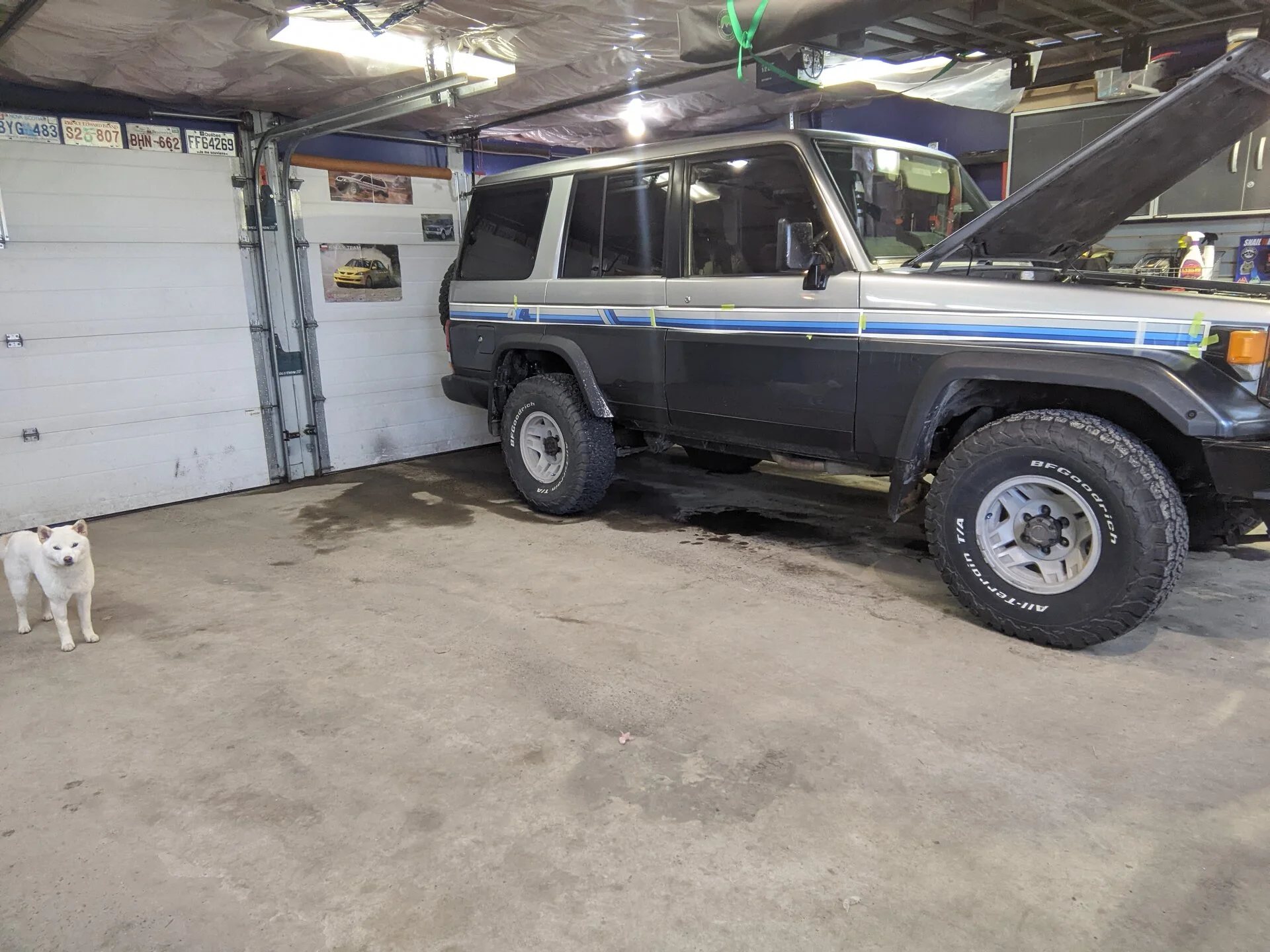

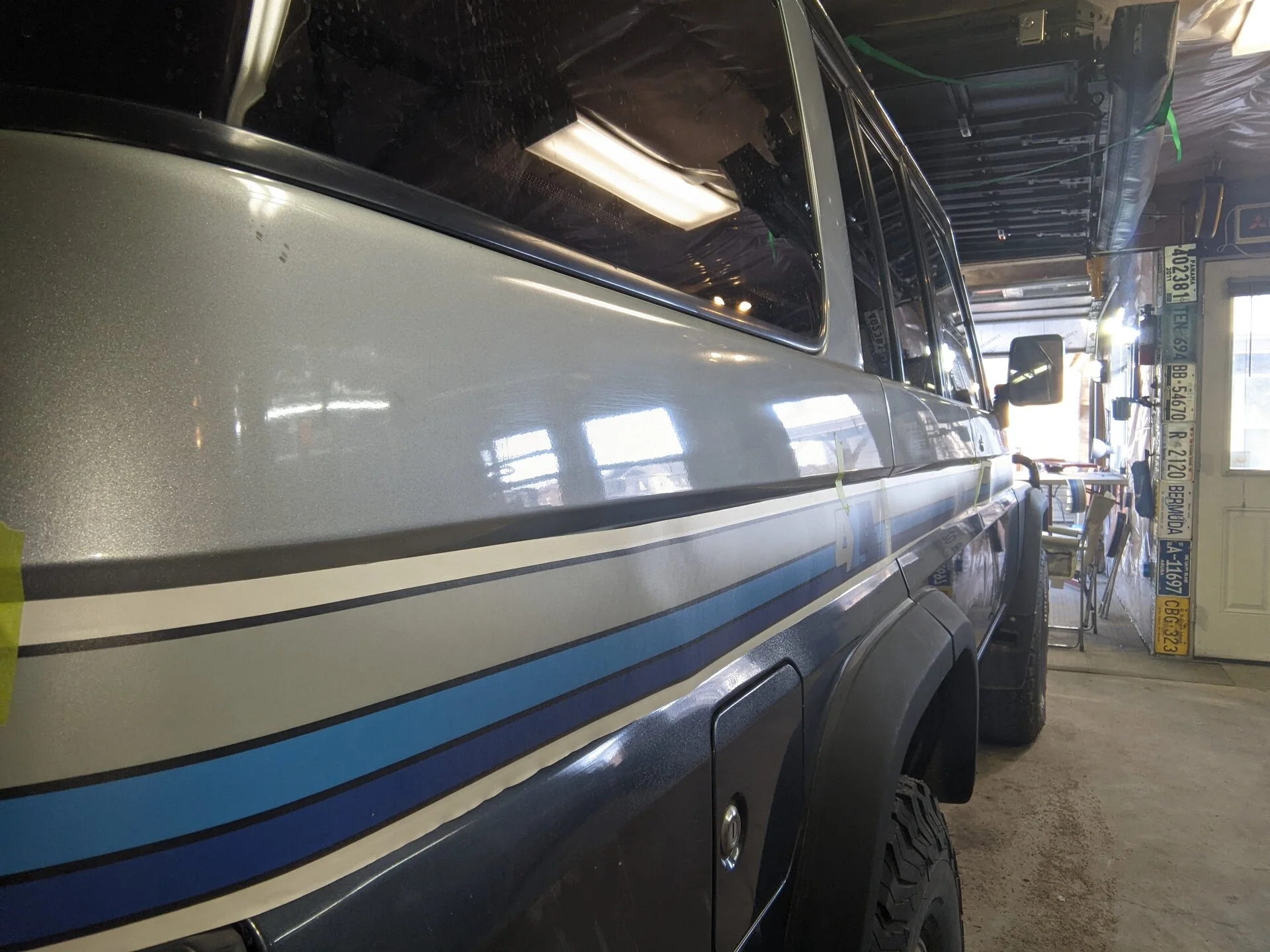

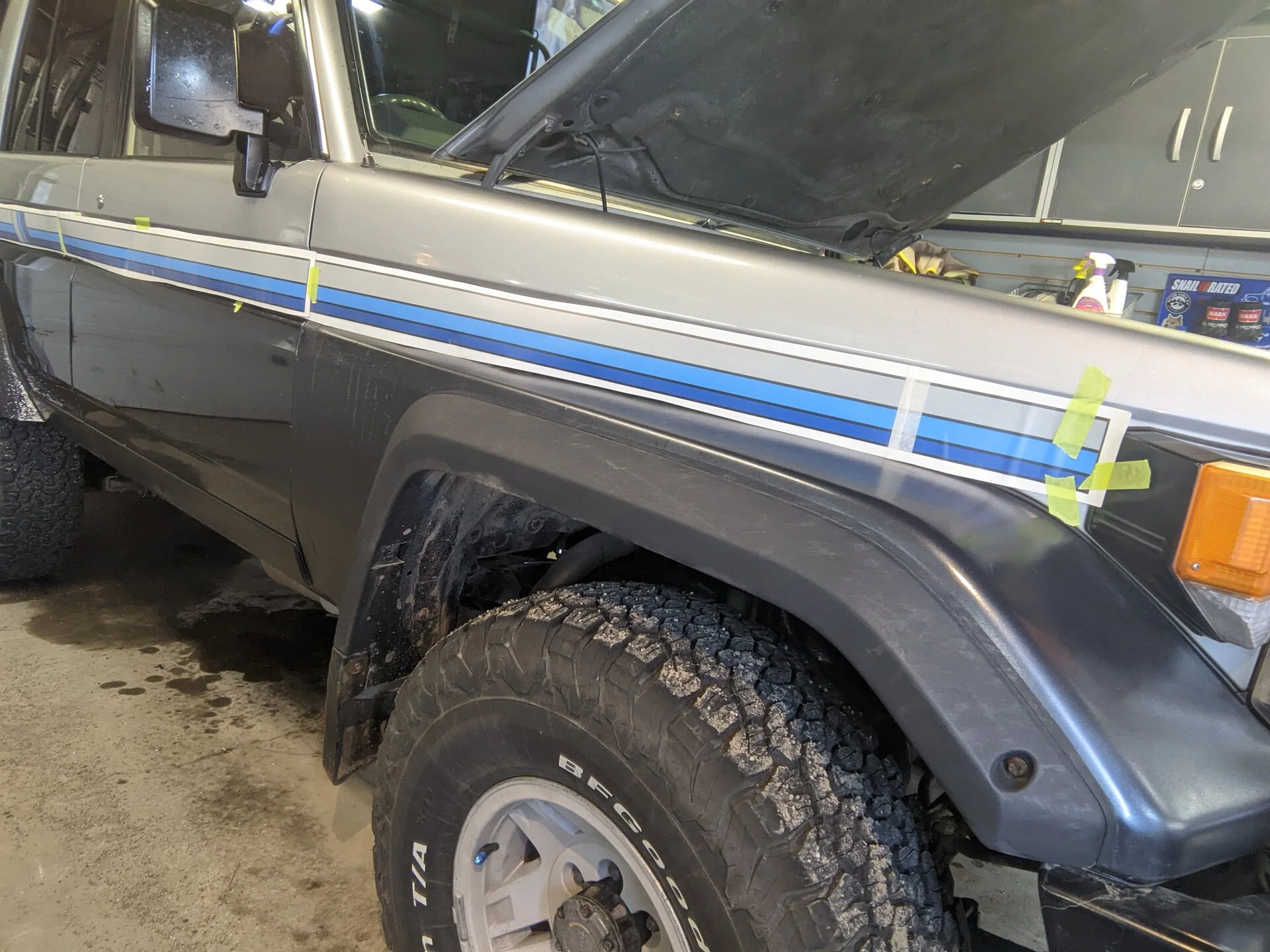

And since I'm making mechanical progress, I thought it might be fun to put some lipstick on this pig? The stripe project has begun. Note, I bought stripes for a troopy so I could have enough extra for errors, and to be able to have enough leftover to wrap around the back.
Here is a mock-up - note there is white backing still attached and it's held by masking tape so... Lower your expectations. Lol. Even lower. 😚
I look at that and all I can think of is how many different ways I could screw that up. 😁

Oh wow this is painful. If anyone ever decides to tackle stripes, think long and hard about putting it at the beltline. Door handles, badges, intakes... It's all in the way. I think aesthetically it's the right place, but holy crap what a giant pain in the...
Front fender on RHS is done. Working on the door now.
