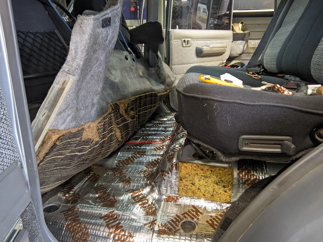

My entire rear floor (under back seats) is now covered in killmat, (under the carpet/oem insulation), along with most of the cargo compartment and the wheel wells. Not sure if I'll notice much difference or not, but I'm imagining things will be quieter on gravel at speed?
Still need to do the front floor and doors, but I'm not in the mood to pull the front seats right now. I can do that once the rear buildout is put back in place.

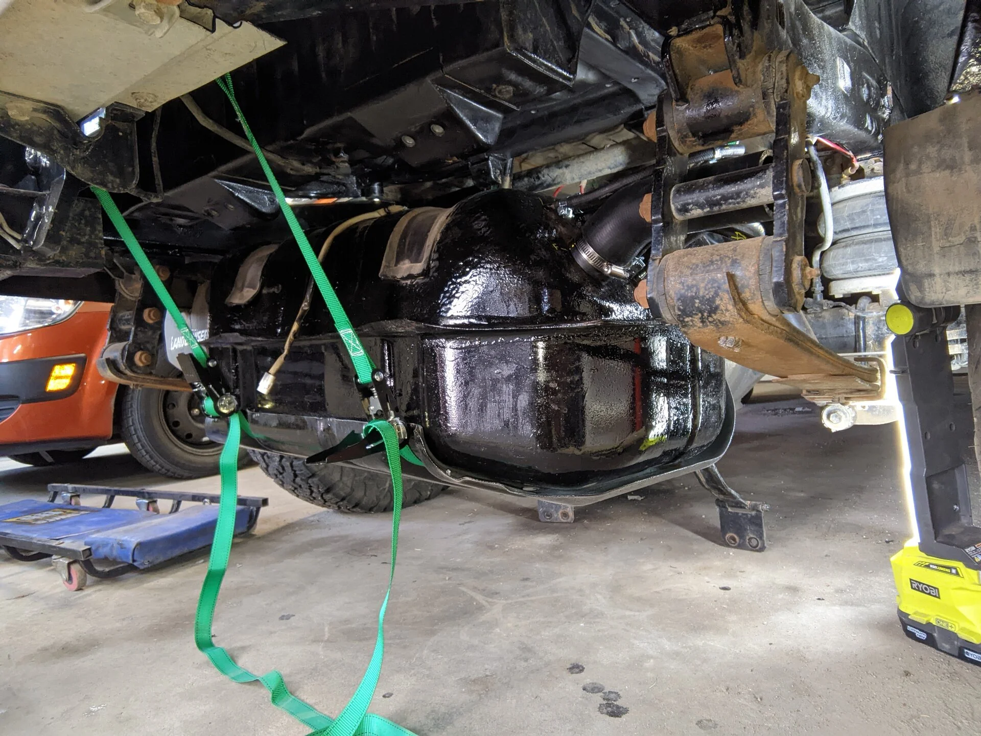

In other news, got the tank down today. It was about as unpleasant as I imagined. Dirt in my eyes, more fuel dripping down my neck, etc. Lol.
On the plus side, tank isn't bad at all. Needs a good cleanup and of course more por15 but overall in good shape. I'm glad I ordered the fuel fill-assembly. It might have been salvageable but I'm glad I won't have to worry about it. Skid plate looks good too. And all bolts came out!
Even the floor underneath looks good! This rig was media blasted and coated before I got it but you always have nightmares about what could be lurking, unseen. There's still factory paint there. I'll coat it anyways because it's accessible. But aside from yours truly photobombing, it looks pretty good! 🤣

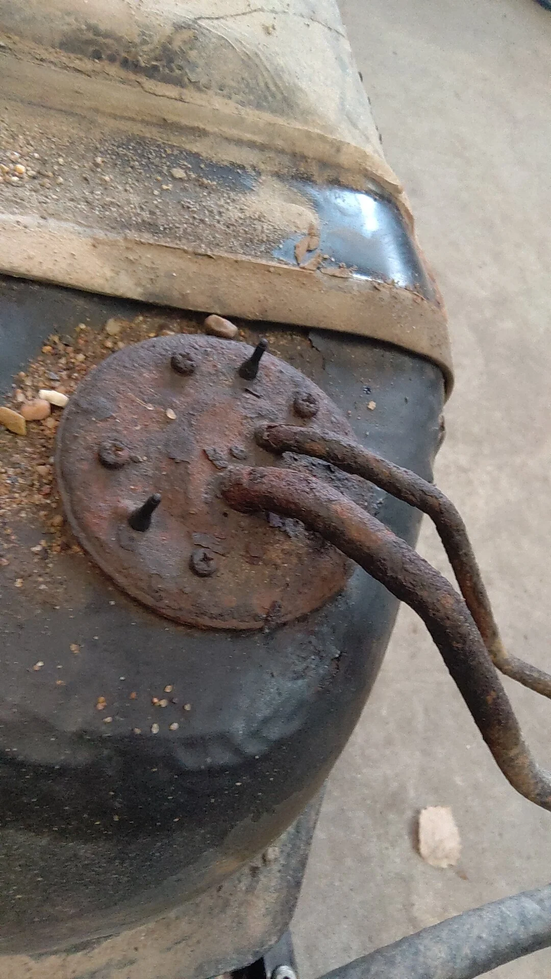

The suction tube however looks as bad as I suspected. Well... Hoped I guess is a better word? I'm thinking this is the last piece...
Bottom of tank is now looking better. Hit a few places with my flap disc, and then coated with POR15.
Cleaned up the floor where the tank normally butts up to, and then took the opportunity to do a little sprucing up.
And finally we painted the inside of the skidplate.

Well... Suction tube and filter is on hand. Unfortunately I've hit a snag. Amayama, after processing for a week, is now saying the rubber tank hose and vent assembly are both out of production. Partsouq doesn't show any availability whatsoever.
And I had to cut the rubber line to get tank out. So... I'm open to suggestions. 😔
Can't find either of them anywhere. So... Ordered a length of 2" hose with two slight bends, and am hoping to cut it in just the right place so that I capture the spirit of the original. 🤣 Meanwhile, the vent tube assembly is cleaned up, wire wheeled, and POR15'ed. How is it that I can wear nitrile gloves. And STILL get that $hit on my hands? 🤔

All right. That was the most frustrating thing I've done in a while. I wear xl gloves and my hands aren't made to get where they needed to get. The tank wasn't really happy to go back in place. A jack, ratchet straps, pulling back wheel, jacking up the truck more... All the things I could do made virtually no difference. Eventually I got it in place. My carefully cut fuel filler hose worked fine. And my 19/32 hose (couldn't find ½ inch on short notice) fit perfectly on the overflow tubes.
