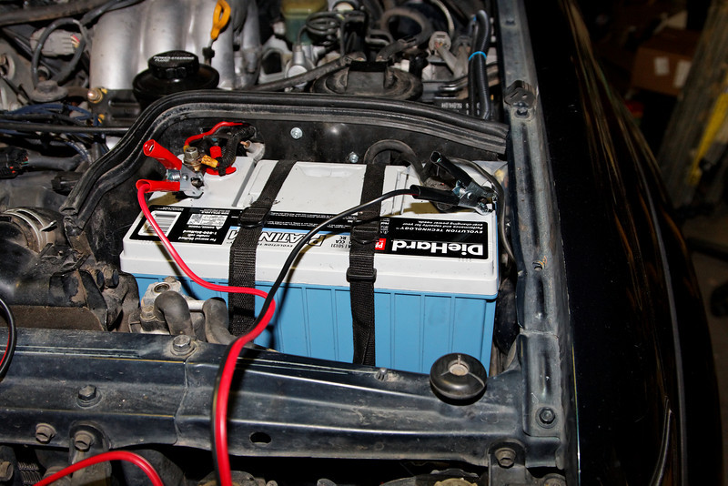

well that's how they look in my 80, but they look smaller and lighter on the shelf. don't be deceived!! it is one big batch! took a little finagling (read trimming) of the battery tray in my rig.
It looks like the stock battery hold-down bracket is no longer an option?
they look like this... :D
i think you could fab a longer crossbar if you wanted, maybe. i don't know since i didn't have any stock tie down for the little battery when i bought the rig and had to fab one that didn't work on the new one.. but those two nylon straps go through slots i cut in the box and and are a loop holding the batt into the box. very sturdy. i like it.
I should show you what I did before last years Oct Moab trip. Really cheap, but the battery has not budged one bit. I might even have some of metal left over. Remind me to take a pic this weekend.

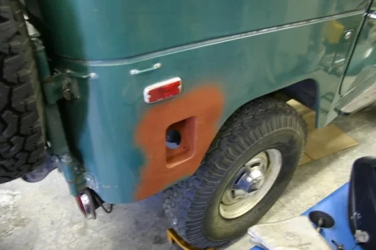

And the first body modification. :frown: Fuel door:
YouTube - fuelDoorOut.MOV
Just because I need to prove that I can do something more/better than just cut a hole in the side of a pristine bodied cruiser....
The picture of it with primer makes it look crappy. Get some green paint for it pronto! Then my bodywork will look OK. :grinpimp:
