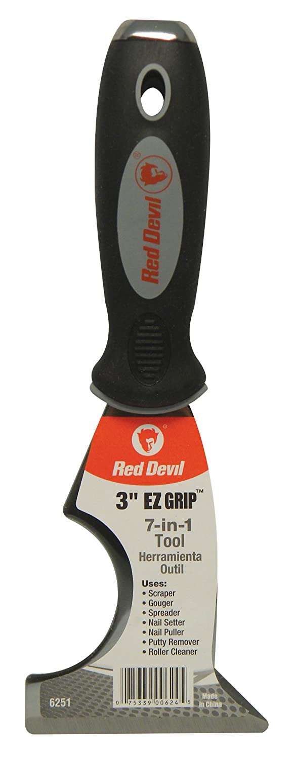

I found a cheap version of the SST tool at a local autoparts store. You won't damage the pan with a putty knife if you're careful and cut along the block side, if possible.
