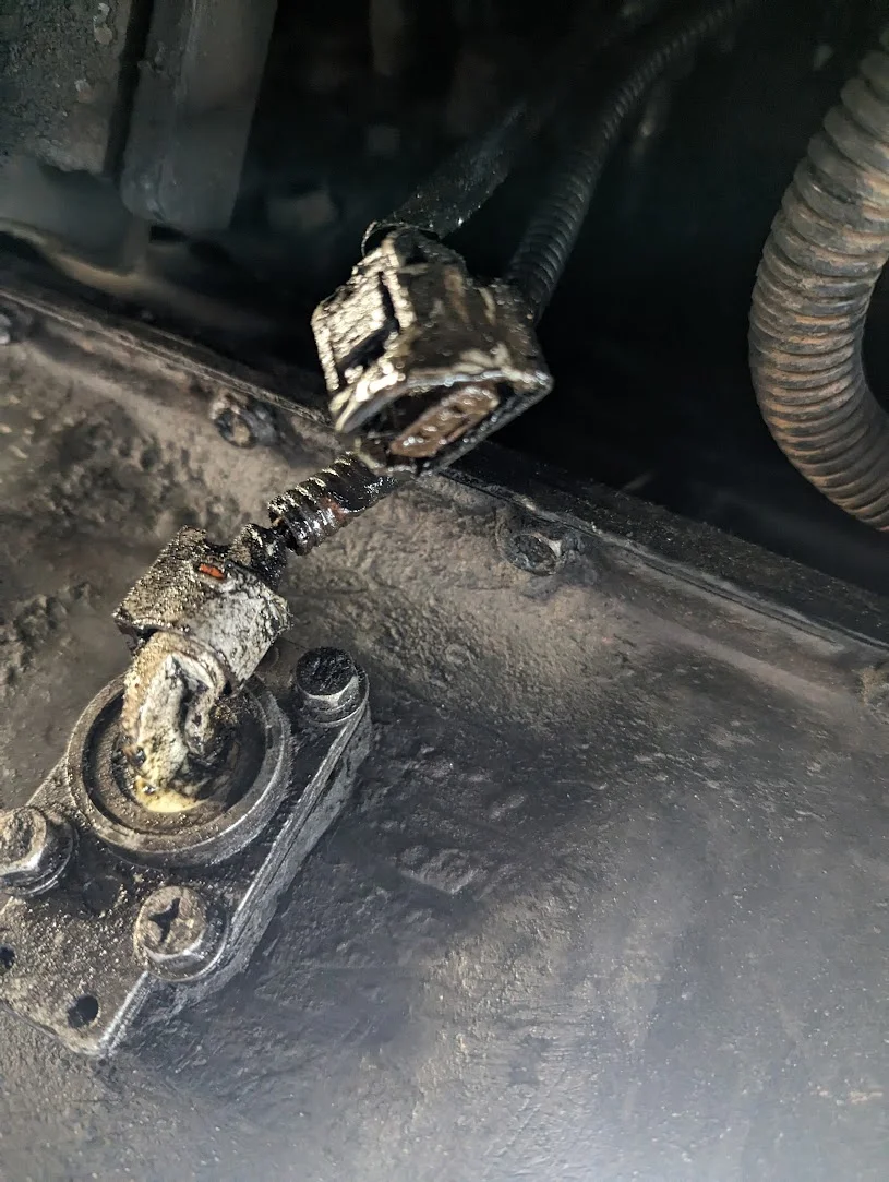

Yeah I am pretty sure it is triggered by oil level. All I have is the "oil pressure sender", nothing in my engine bay seems to function as reading oil temps.
This is the sensor connector on my oil pan. (don't know what the orphaned plug hanging there is)
Yuck. I'm sure you did this already, but clean that thing off. All that oil in the connector will cause all sorts of problems. Hopefully the oil did not wick too far up into the harness.
All that oil in the harness would also make the dash light both intermittent and ambient temperature dependent.
