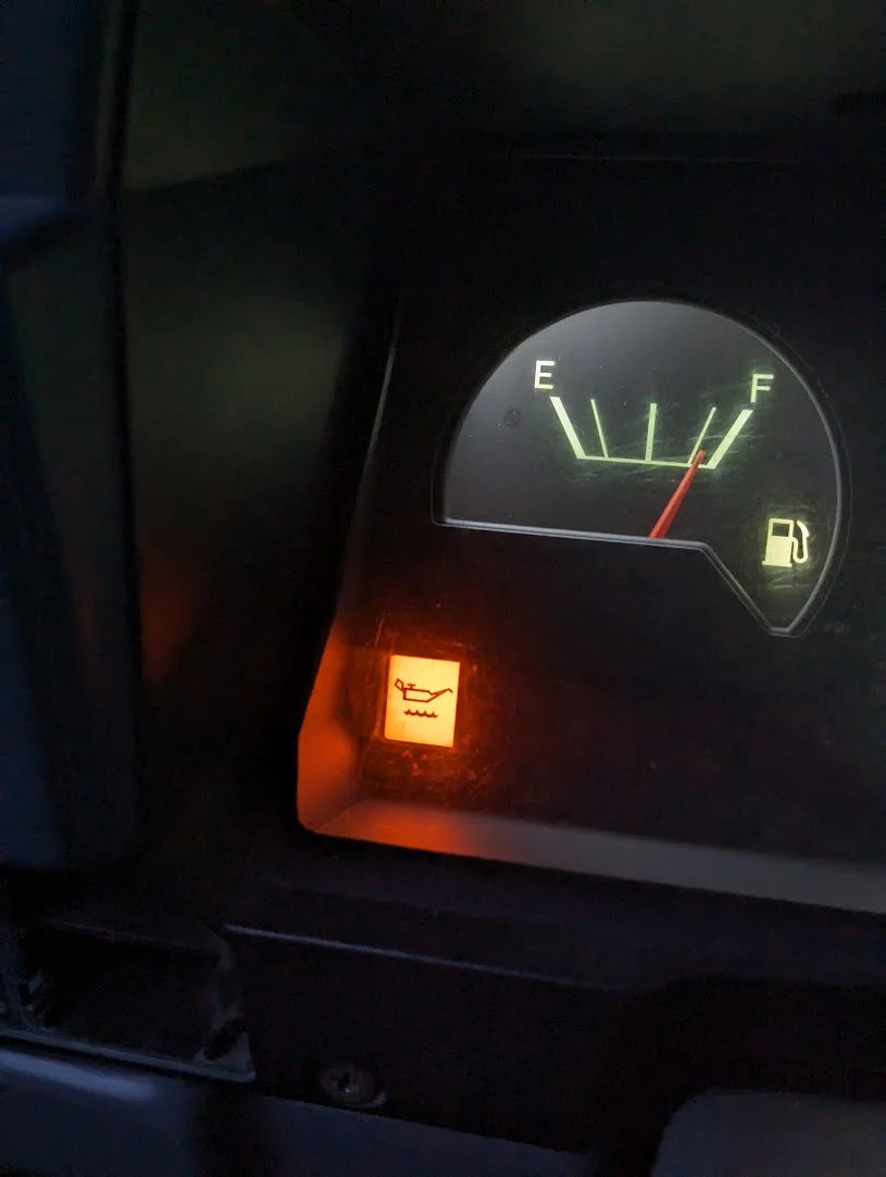

My 1995 HZJ75 Troopy does not have an oil pressure gauge, it has this light. What does it mean?
Low pressure?
Low volume?
Time to change?

So are you saying this light is for oil level?
PS: I don't know if I have this plug on my oil pan - I can look tomorrow.
Google research seems to indicate that it is a low oil level warning light - not low oil pressure. I'll check the level tomorrow. (and for the plug)
@woytovich
Correct. This is your engine oil low level indicator that comes on when your oil falls below a certain threshold (in my experience, just above the L mark (cold) on the dipstick to allow for early enough mitigation).
If this light was functioning properly, it will come on when the oil level is low, and may go out temporarily when you take a corner a little fast, park on slight incline, or during warmup when it first start to come on.
Check your oil and add till you reach the F mark and it should go away. Otherwise, it's something else :)

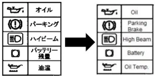

In the parts diagram, that light is translated as "oil temp" for my cluster. Perhaps it varies from cluster to cluster.
Interesting. Could be the way they phrased it/translated it. Also curious how they labeled the first symbol simply as "Oil" with no other indication on what's that supposed to mean. Oh well.
My understanding is if the symbol depicted the little waves ~~~ under the oil can symbol (like it is in the OP picture) that would be a reference to the oil level, also evident by how the light operates, but I digest digress. 😊

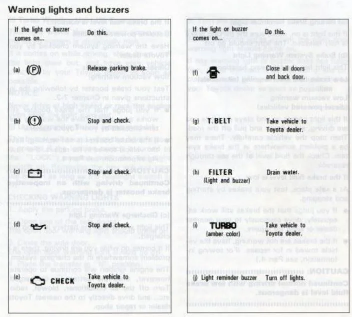

I also looked at the 1991 70 series owners manual (the one in English posted on the cruiser cult site) but it doesn't show the oil can symbol with the waves under it. Only the oil can without the waves which means "stop and check". Not saying you are right or wrong. Toyota likes to mess with us I guess.

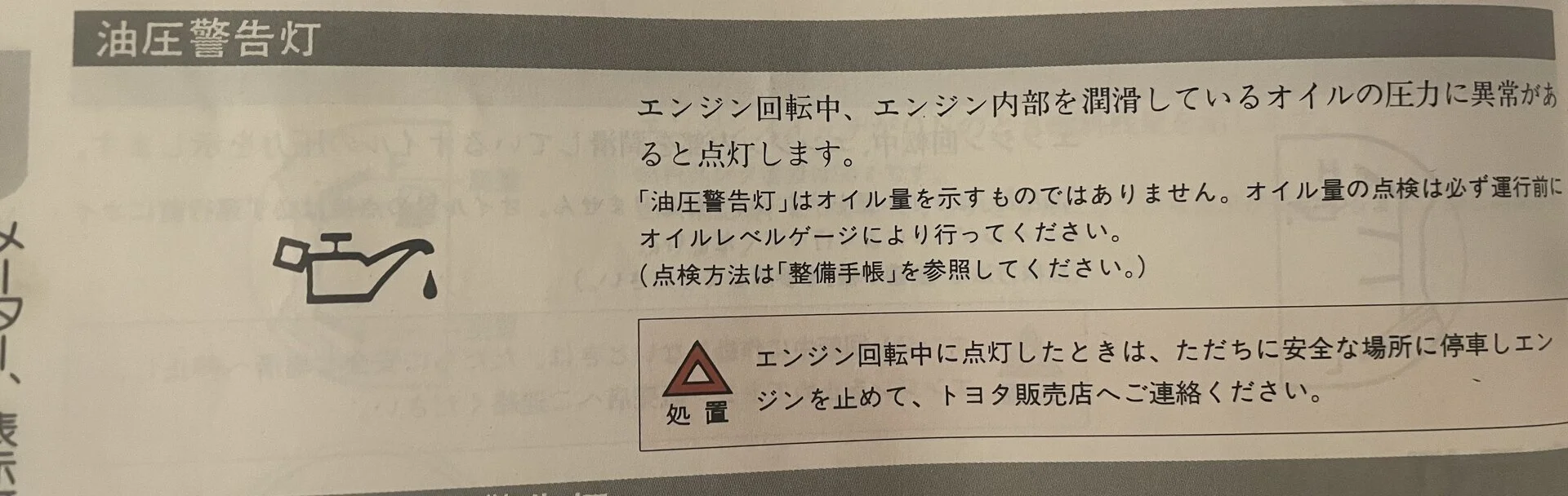

From my JDM owners manual. 1992 JZJ73 ZX model. I have the drippy oil can, not the swimming oil can.
It doesn't help to answer your question, but perhaps helps with more information.
I’d try to find an applicable owners manual with the swimming oil can and see what it says.

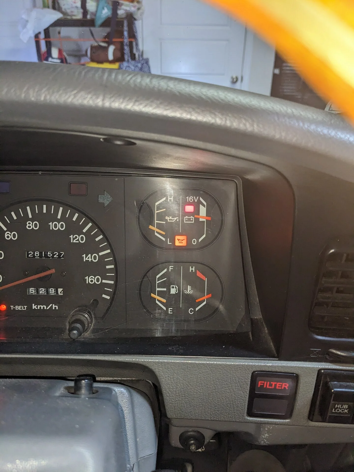

Well. I went and took a picture of my cluster, and here, it is a low level indicator, since the oil pressure has it's own gauge. You would think they would settle on one symbol and move on but no. :)
The section of the cluster-meter for oil is the oil pressure. People always ask if their oil pressure being low is bad at idle, I'm sure you've seen the posts.
The separate light in question is for oil level as I understand it. It should only come on briefly when you first turn the key on. I would check the dipstick first to confirm and go from there.
Again I am not saying anyone is right or wrong here. If you look at the diagrams and do the translation....it comes out to "oil temperature" if you have the waves under it. I had this confirmed by a Japanese speaking boss as well when I was making some illustrations for my own notes.
However it seems like Toyota is using that exact same icon with the waves for simply saying to check your oil if it comes on.
