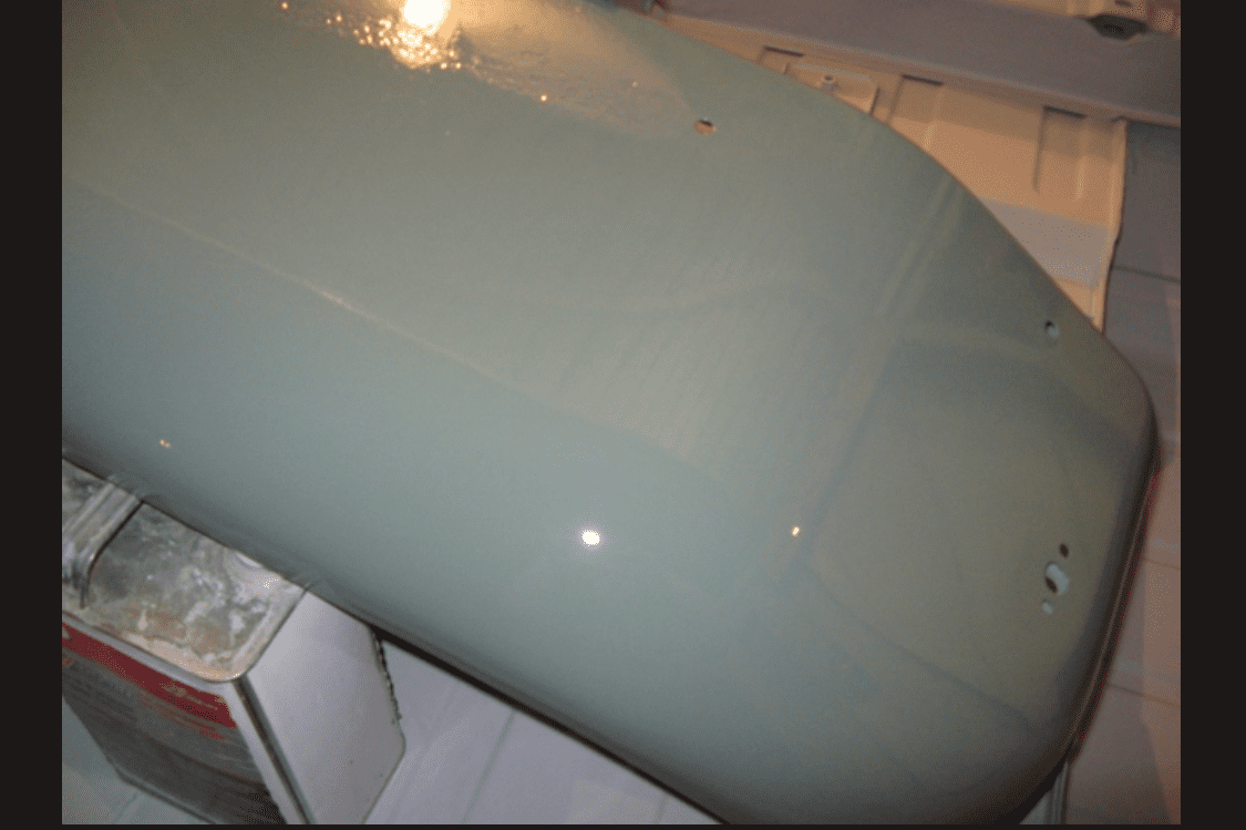

I like this color, not sure if it's the 854 Sky Blue, from what I can see from one sample chip taken from paintrep.com looks much darker. What's your take on the light blue on the FJ40 pic. Thanks!
My 1976 Sky blue found under a good layer of bed-liner...Your sample looks a little darker. But could be a "digital color translation" issue..

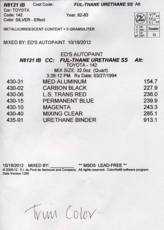

Pablo, how did the 142 silver work for you? Is it close to the original 1434 gray metallic. I am getting closer to needing to pait trim parts for my 1977 FJ55 (originally a one color pig) painted back to 854 blue

I hope to get up to the painter's place and see the 40 soon. I will try to get a pic of the 142 compared to a factory bumper I ordered for the 40 and post up pics...

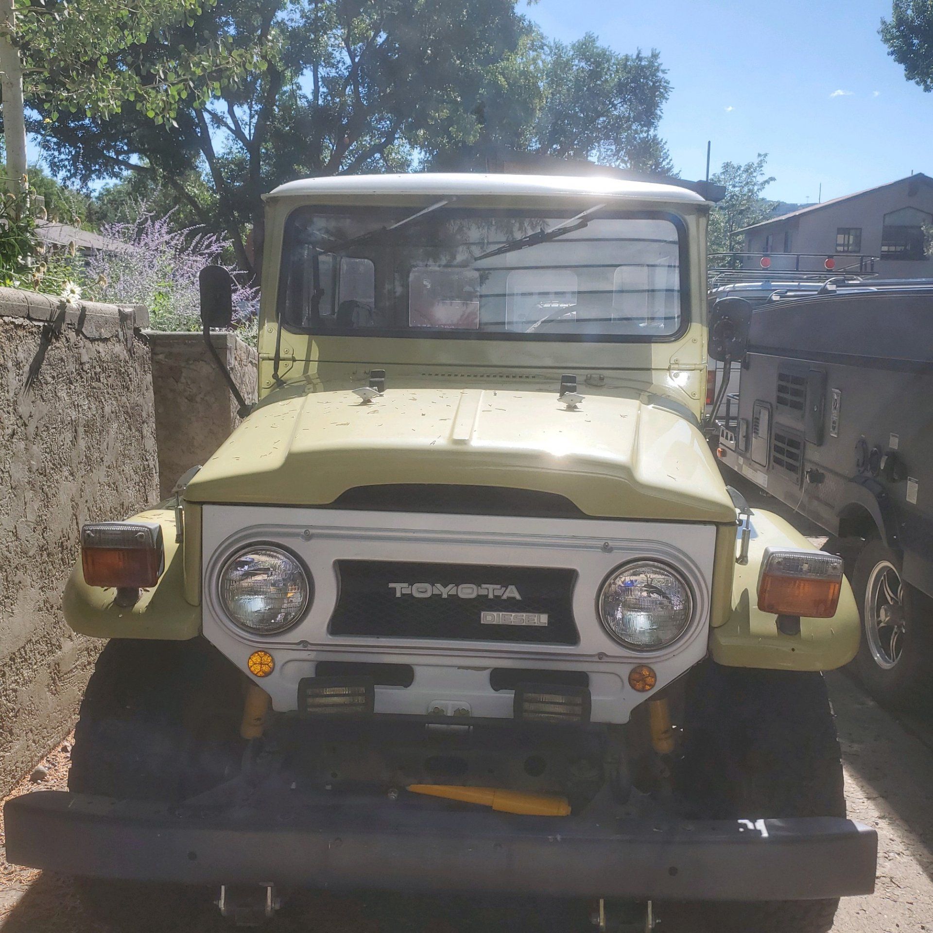

I have a question on Yellow as well. While my 40 has been repainted (poorly) at some point I do believe that by looking the harder to paint sections it looks to be the original color. Yellow 532 is my best guess. Thoughts? (Is it Mustard Yellow?)
Looks more like Lemon Yellow or Sunny Yellow.

I know that it exists out there... I've seen pics of others in the wild.

That's a bastard vehicle. It has 75-up front turn lamps and 74-prior hood, windshield frame and doors.
@cruiserdan - does the fact that it comes from ROW (Costa Rica) change its bastard status any?
It's a 75 BJ40, at least to the best of my knowledge
