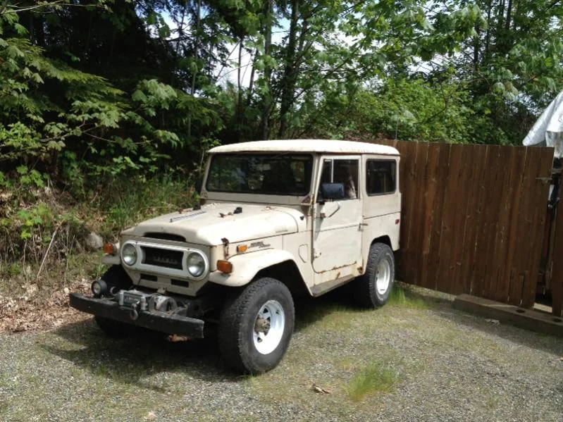

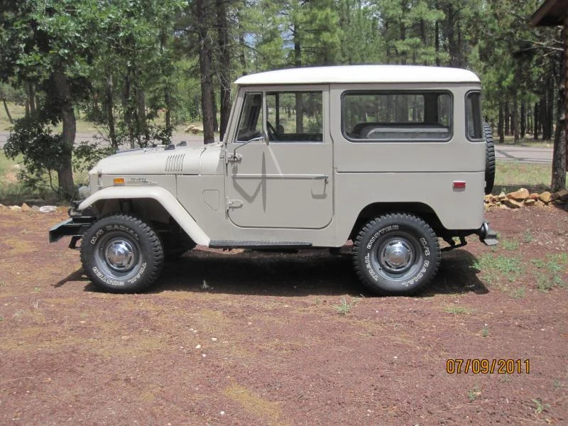

Pretty sure i have original color on my 1970. It is crappy and repairing rust and restoring, but want to stick with how she came.
Folks agree Coronado Beige?
Looks like it..T451, only 1 type of beige in 69-70.
Thanks!
