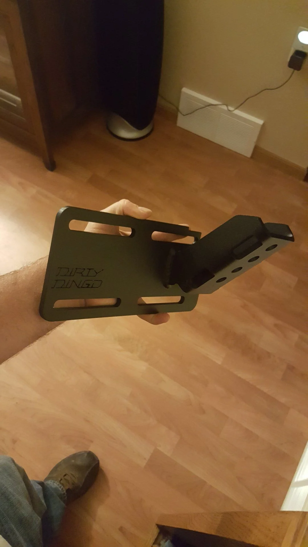

The next trick piece that i had to run was to make up for the 2 inch difference in the engine mount locations. After a while of stewing on it, deciding if i wanted to just cut off the mounts on the frame and relocate, i ran across these.
Dirty dingo slotted mounts.
full
Luckily for me these worked perfect as they are the same mount design i had.

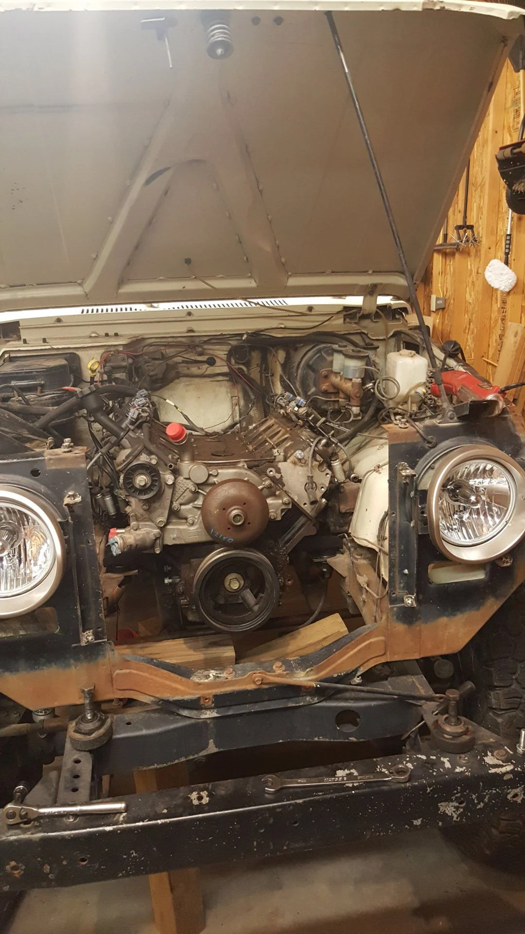

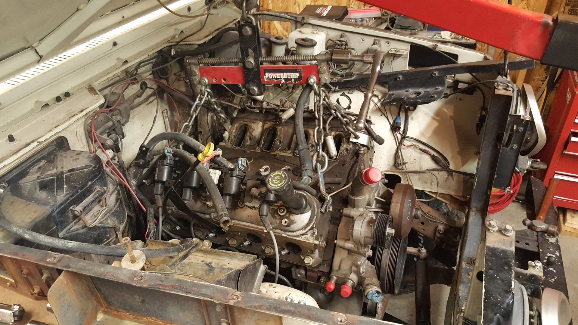

So after i got all that solved, on to getting the engine bolted in.
full
full
I have some minor tweaking to do to make everything work the way it needs too. As of right now the only issue im running into is the driver side manifold hitting the factory steering box. Originally i was going to do the engine conversion and swap to power steering at the same time, however with the events unfolding the way they did, i will end up doing that part later. What im going to be doing is offsetting the engine and transmission about and inch offset to the passenger side to accommodate for this.
At some point in time i will be cutting the mounts off the engine and transmission and shifting the whole assembly backwards an inch or two to have more room up front. Also my shifter when put in 3rd gear currently bounces off the dash, so it'll help correct that as well.

Beautiful family, next time keep your mug out of it, just teasing :) Moving on, Devil's advocate...maybe wiser to add the power steering box now and be done moving motor mounts down the road. Mine was real close on the pass. side for fitting the a/c condenser line fittings, moving the motor more to the right seems problematic. What type of exhaust manifolds/headers or you going with?
Something I wanted to mention, I'm using a 2004 truck motor and the exhaust manifolds dumped right out on the frame. I went with block hugger headers to make it work, if you need or want to try the truck manifolds, you can have them for shipping if needed.
Reason for currently not doing the ps swap is time crunch, once is start that, it will be done right the first time. The majority of everything im adjusting is adjustable, so it can be moved back by simply unbolting and shifting, nothing that will be solidly put into place. Plus once i do the ps conversion i plan on adding a sleeve plate to the frame, and im not currently setup in my garage for doing the heavy plate welding yet.
Currently im going to try to fit the manifolds that i have (2002 Tahoe). its not set in stone that im going to be using those yet, was looking at block huggers as well, but i'll then run into manual steering box (see problem #1 lol)

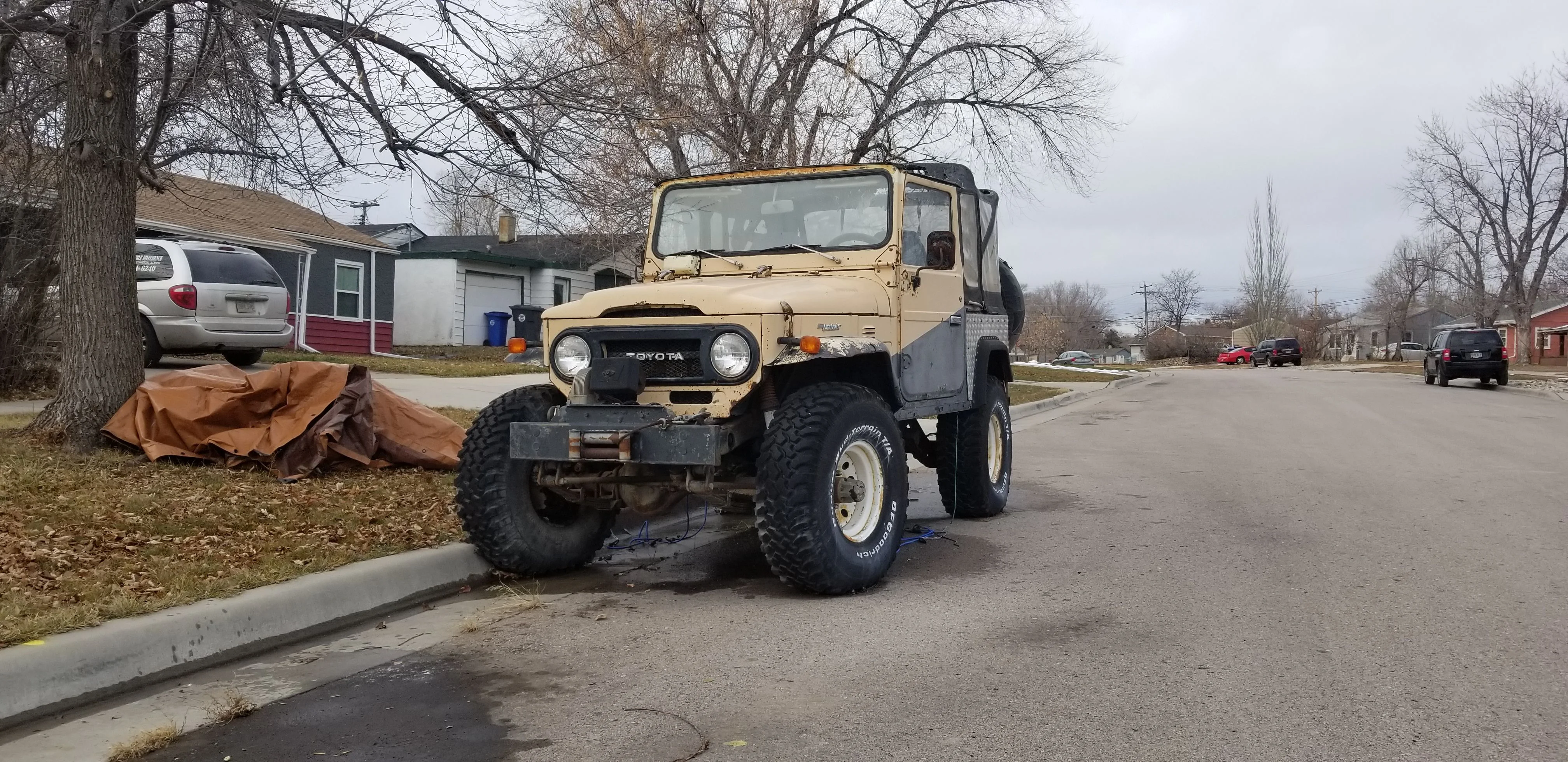

Secondly i ended up with a 77' FJ40 this past November due to a friend getting ill and selling it to me for a very very fair price. So currently my time has been spent getting that back up to running/driving condition.
day i brought it home
current condition, still needing to work out little bugs, but im close.
