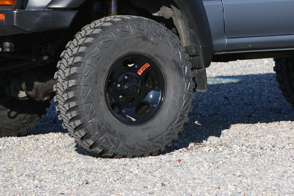

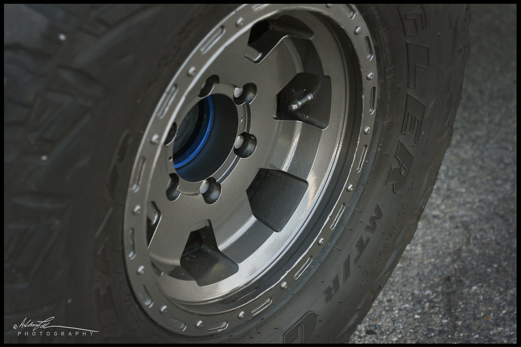

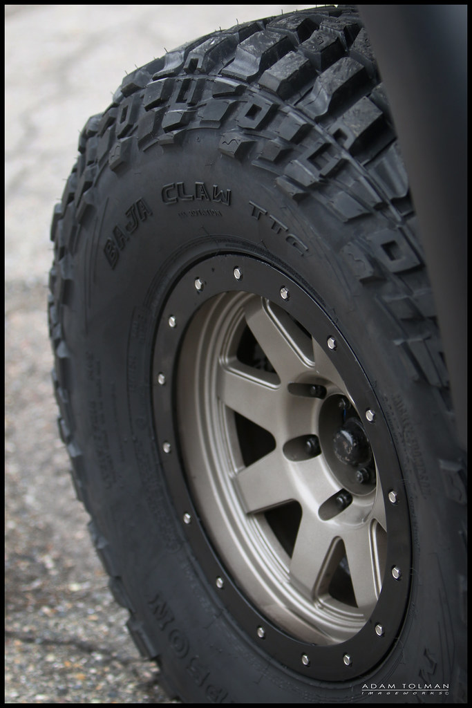

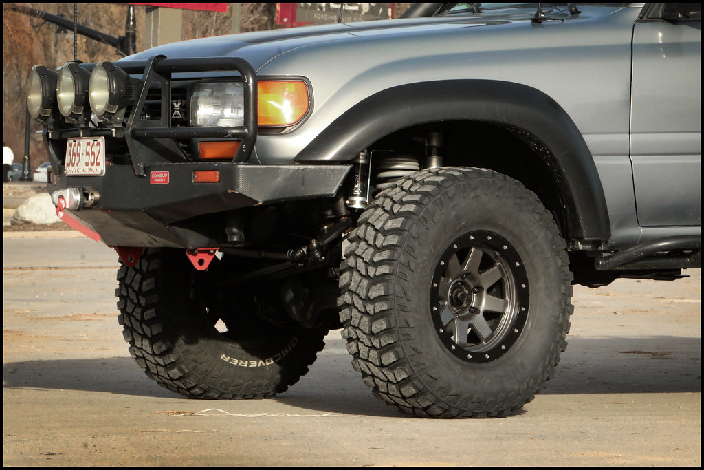

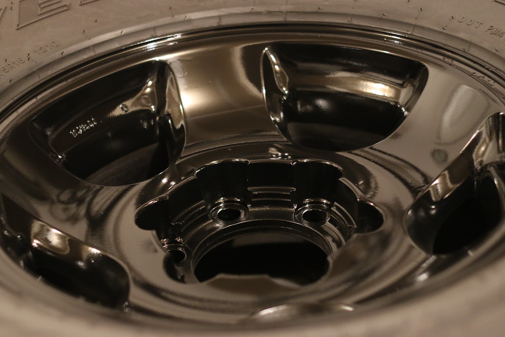

If you're on a budget, just paint the wheels yourself. It's not difficult and good results are possible IMO. I have rattle canned several sets of rims using VHT paint. I like the finish and results of the VHT paint better than others I've tried. Don't even have to remove the tires. Put index cards around the edge of the wheel to mask the tires and paint away. Here's a few examples of some of my painted wheels just for an example of how they can turn out. Whether or not the quality is to your standards is up to you.

Tires!
Powdercoating by a good shop CAN cost $300, $350, $400 or more to do a nice job. If that happens to be the case you could even search around and see if you can find a set of wheels in good shape for less. Like if you found a nice set of used wheels for $200....grab them and get new tires put on them. Done and looking good for cheaper.
Or do what everyone is saying...have new tires mounted and if you just have to paint them, put index cards all around the bead and then spray paint the wheels if you are any decent at spray painting.
