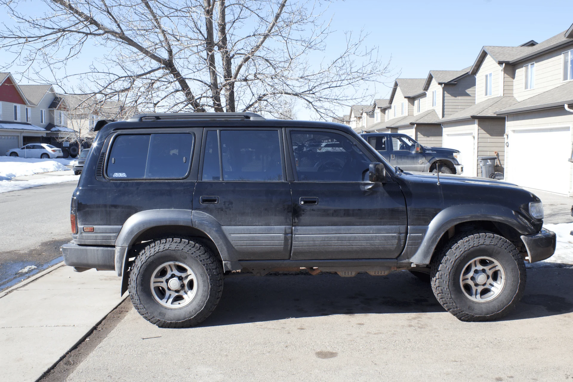

A nice little poser pic to get us started here:

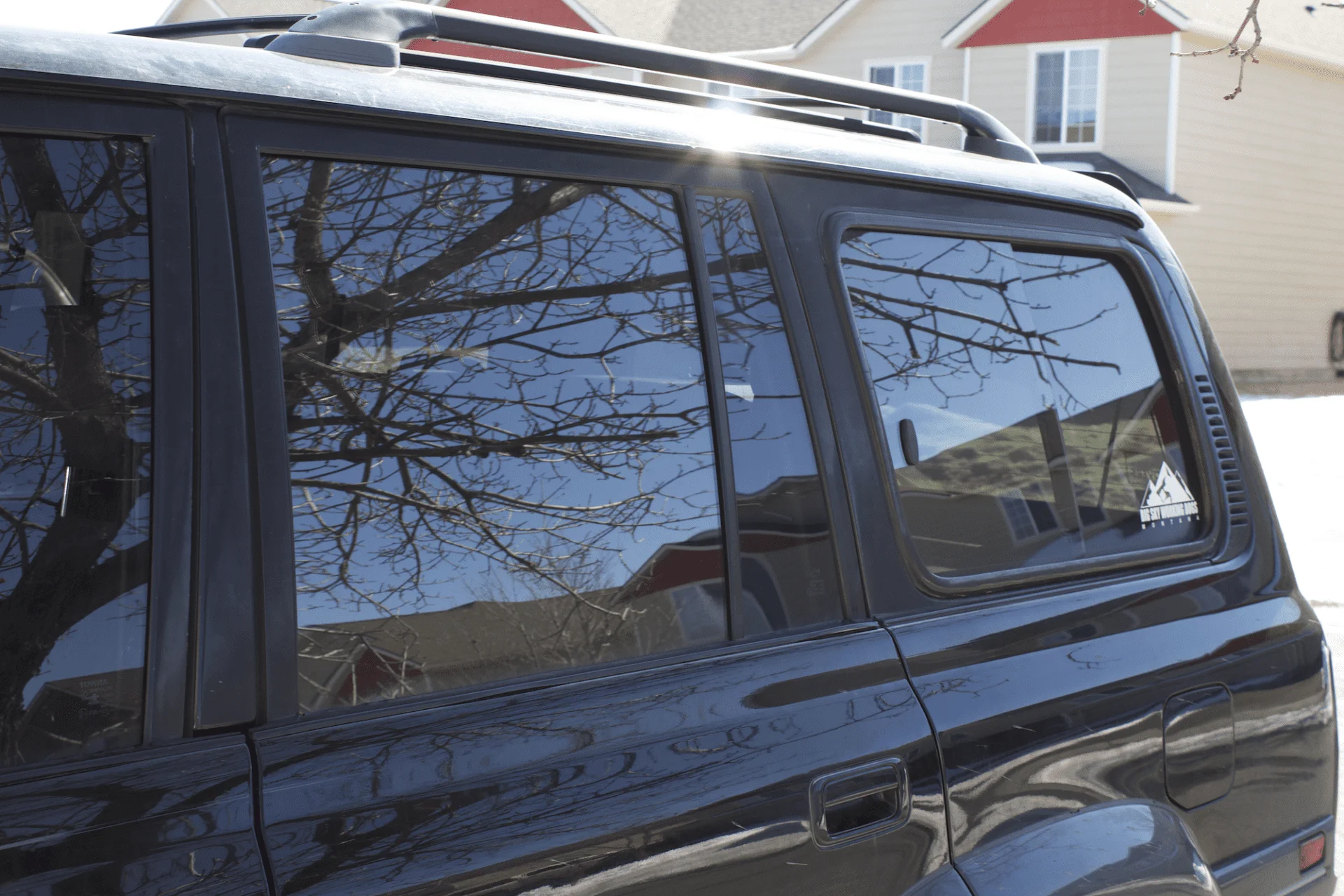

A couple pictures of what the tint looks like (30% ceramic on front windows, 50% ceramic over the top of the factory tint on the rear windows):

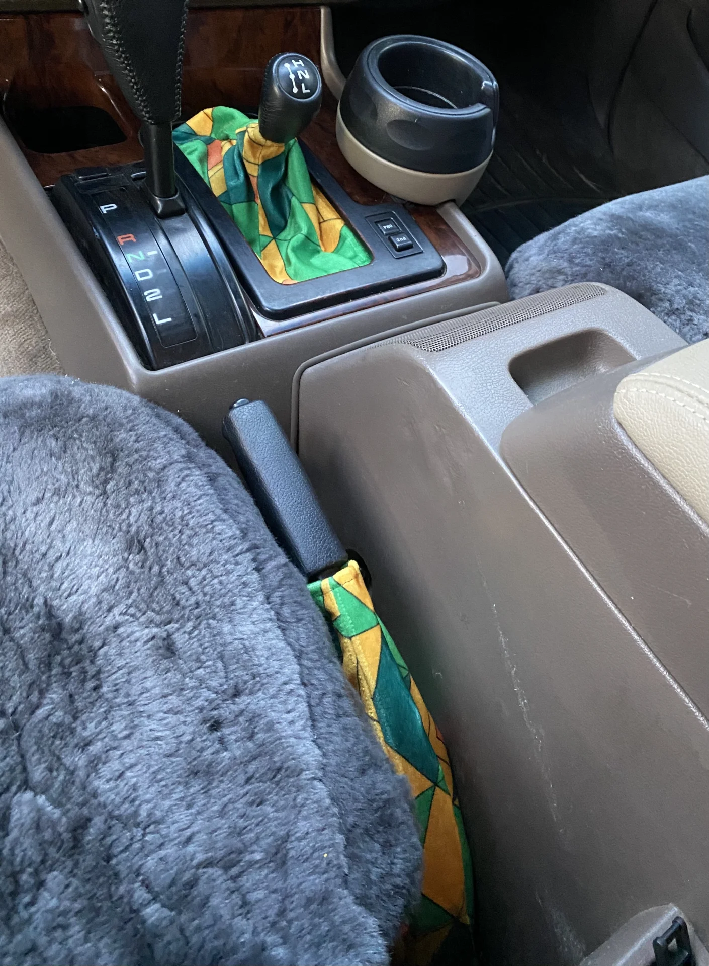

Sewed a new e-brake and t-case shifter cover this week. Haven't done much on the lexus lately, but figured after 23 years of soda and coffee and snacks being poured on them, it was time to make new ones.
It was super easy-- I pulled the center console, and took off both boots. Ripped the stitches, traced the pattern, and sewed them back up. A couple hours of work, a ton of vacuuming the disgusting snacks left from the previous owners, and voila!
I know it won't be everyone's taste, but I like it, and luckily since it's my vehicle that's what matters 🤷‍♀️

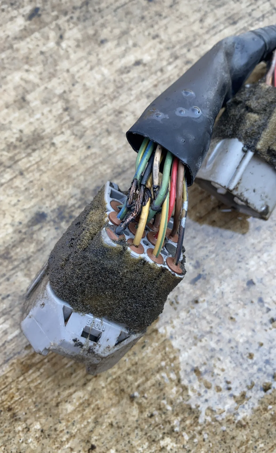

Had some electrical problems with my CDL. I would switch into low, and sometimes immediately, sometimes after a few seconds, the gauge fuse in my dash would blow. It seemed to be intermittent, which lent itself to a short somewhere. I tore apart the inside of the vehicle, enlisted some friends smarter than I, and eventually we landed on pulling the trans wiring harness out. It was covered in muck, and I sat down to clean the connectors off when lo-and-behold, my short appeared. These 3 wires went to the CDL indicator switches and explains why my CDL relay would chatter and my CDL/ABS indicator lights would flash on and off at random intervals. Fixed the wiring up (a new harness isn't available, as it turns out) and everything runs smoothly, just need to get around to putting the replacement indicator switches I bought in. Wiring shorts suck.

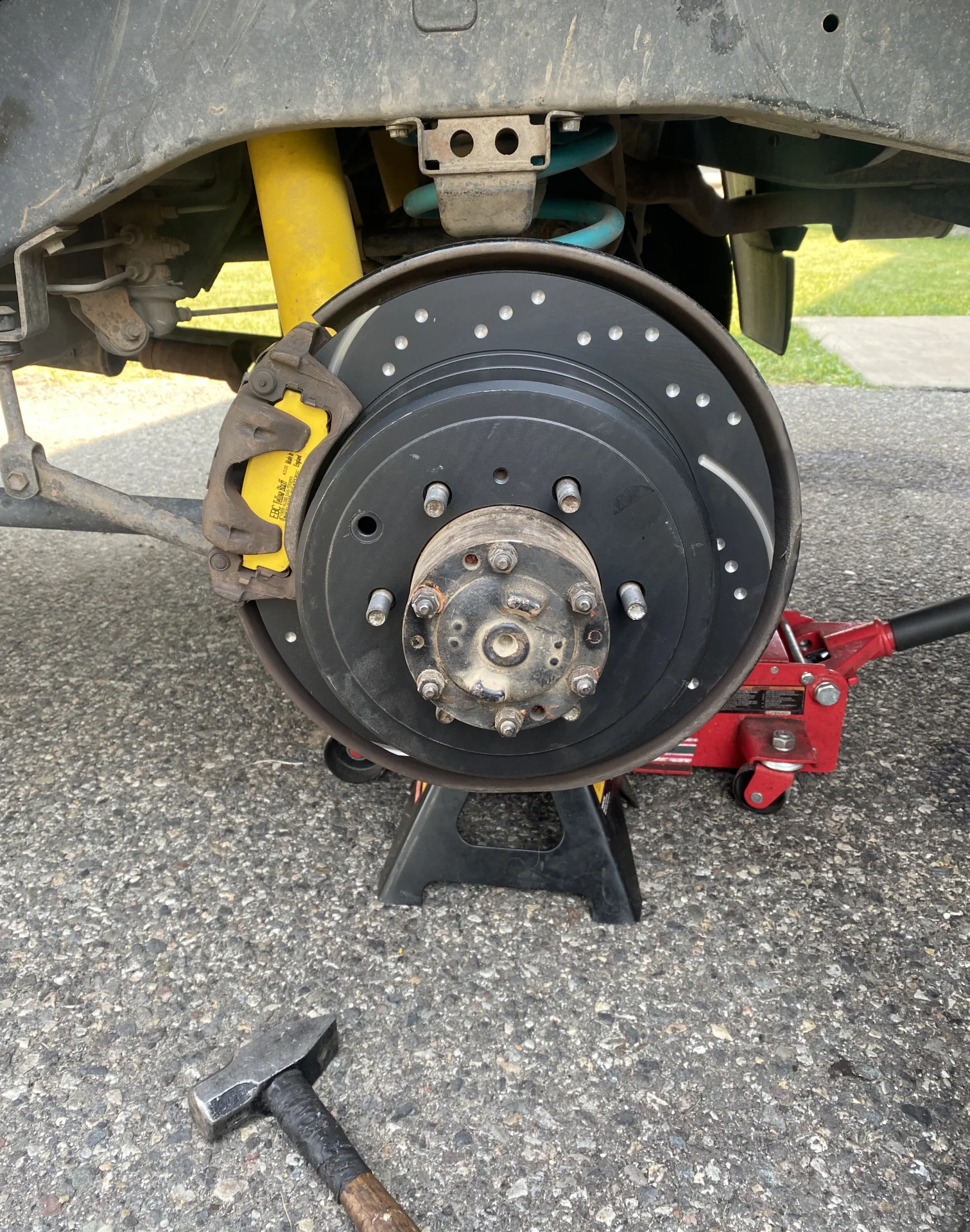

I also just put on new rotors/pads. I went with the EBC slotted and dimpled rotors front and rear, and the EBC yellow stuff pads. No complaints so far, but it's only been a day. Definitely brakes much harder than the OEM pads/rotors, which I prefer. Pretty easy installation, I decided I'd repack the front bearings while I was in there which added time to putting the fronts on, but the rears took me maybe 45 minutes total? Super easy upgrade. I think it cost about $600 for all 4 corners rotors + pads.

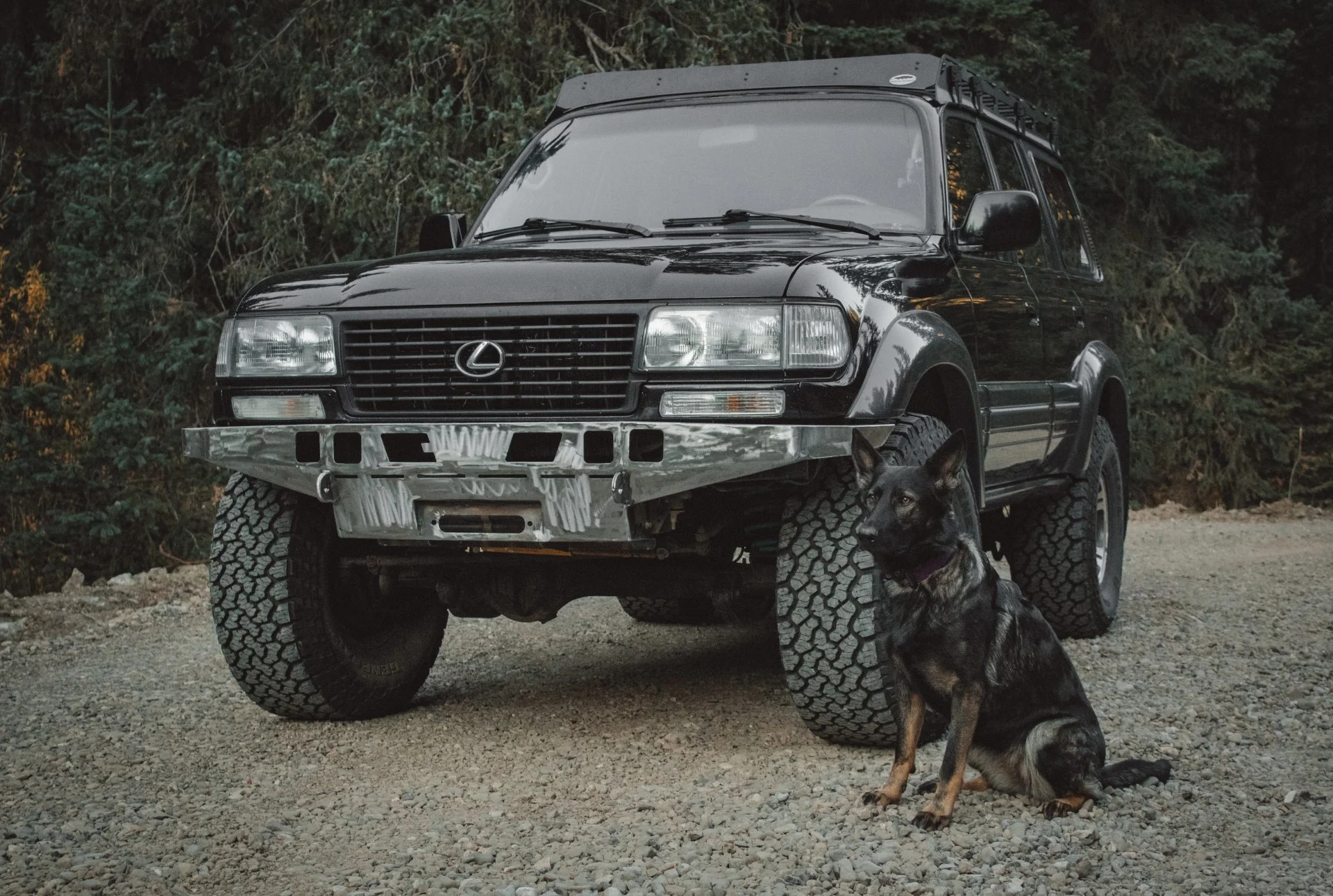

Finally got my Coastal Offroad bumper welded up. I was able to just bend the A/C dryer out of the way for it, for my first welding project I don't think I did too bad-- some ugly welds hiding on the inside, and all the nice ones (along the outside, when I got the hang of it) are all ground off, of course. Apparently the center section with the C O logo is upside down, but I think that it looks better this way with the angled headlights on the lexus.

That bumper looks great and tucks in nicely.

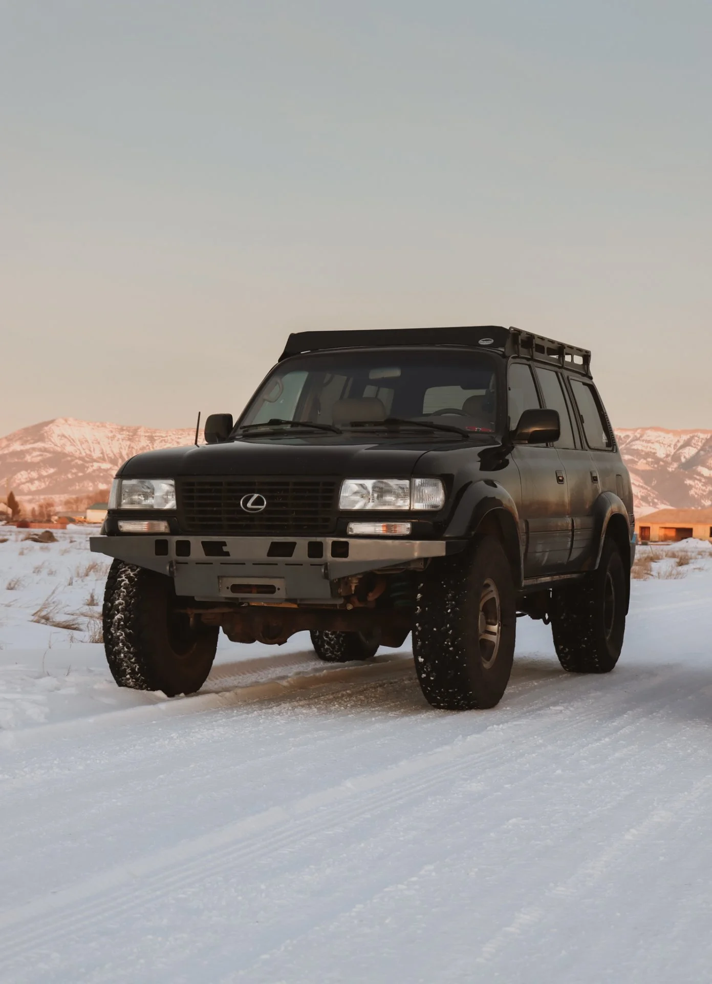

Got 5.29 Diff Gears installed, put in new front row window runs, and put in an Alpine ILX-W650 head unit. Also got my bumper powder coated (in October, but haven't taken any pictures of the ol' girl until now).
