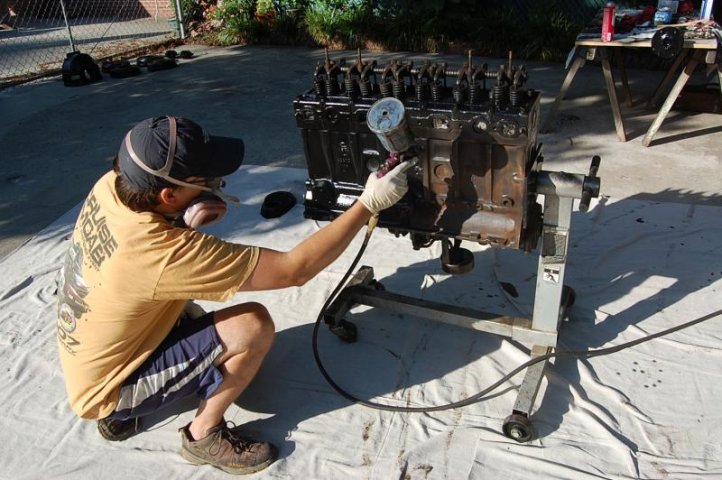

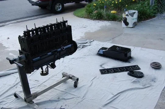

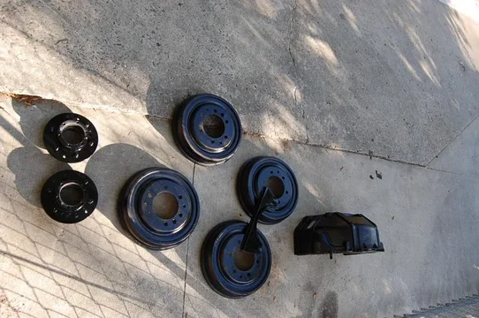

In the time since our last update, we have done lots of blasting, wire wheeling, degreasing, and painting.... it doesn't make for the most exciting pics but I will share what we have :cheers:
blasting
grinding
painting

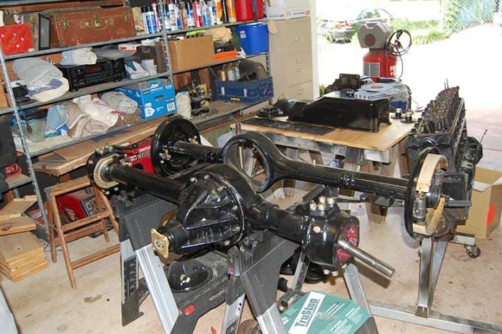

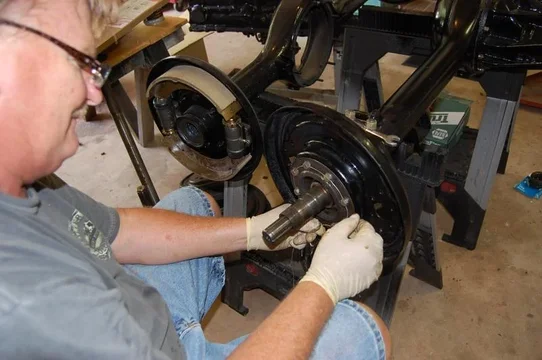

Steve-O's first axle rebuild, new bearings, seals, brakes,bolts, etc. :beer::beer:
We also freshened up the diffs with new seals and pinion bearings:cheers:

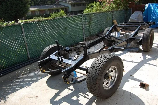

Installed the new Old Man EMU springs, bushings, spring pins...... she should ride like a dream now!! Also married the axles and frame back together, that is the kind of progress we like to see:bounce::bounce2:
Took an old set of 32x9.50 TSL's mounted on stock rims that I had lying around from a previous project and decided to use them on the LV for the time being as we couldn't find any "old school" tires in the size we wanted. We gave them a quick blast and then painted them using the same Eastwood extreme Chasis paint we did on the frame.

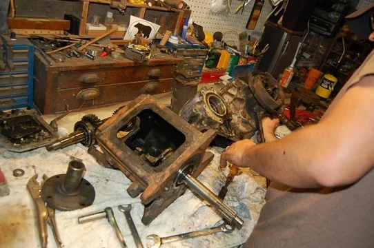

The last messy job left from the drivetrain is the trans/t-case and we started disassembly on it last night. We have a rebuild kit for the T-case on hand, but have decided to not do the trans. as I don't have the proper tooling to attempt that job.
Although as it turns out the trans. was shot, when we went to pull the t-case off of it the complete output shaft and bearing slid out with the t-case. Also the needle bearing where the input and out shaft meet up completely discentegrated.....lucky I have 3 or 4 spare 3spds in my parts shed so we should be good to go:beer:

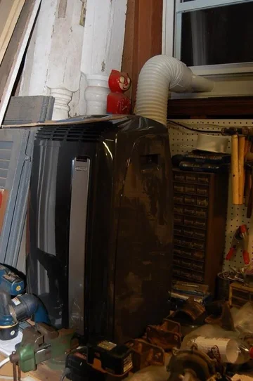

No more heat stroke for my poor 58 year old dad, I think the 100* heat was starting to get to the guy:o In his eyes this is a thing of beauty!!!!
Now we have the chassis in our newly A/C'ed garage this will surely help speed up our progress:cheers:

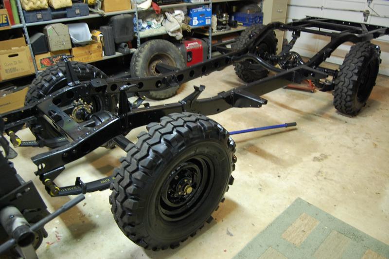

well it may not seem like much progress but it sure felt good to get the new tires and rims on the chassis tonight...... given it was a Friday we couldn't work to hard :hillbilly:

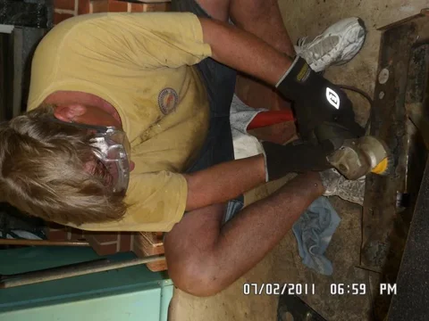

but Steve-O did get in some good ole wire wheeling...
2 straight hours turned Steve-O black
and if you didn't know wire wheeling is a blood sport :grinpimp:
